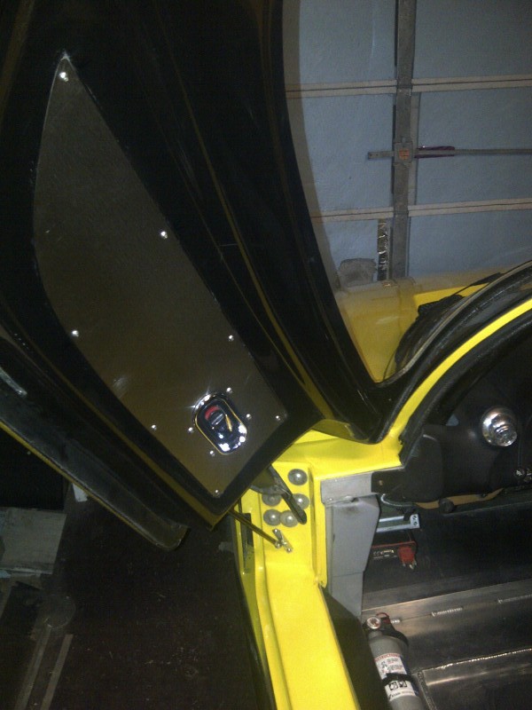

Mesa's door struts work great plus they are easy to access. All the struts I've used lose strength after a while and you have to replace. With the struts in the door it makes it much easier to access. Plus the doors move more linear, less acceleration at the end of the travel. FWIW, I've tried both solutions over the long haul.
