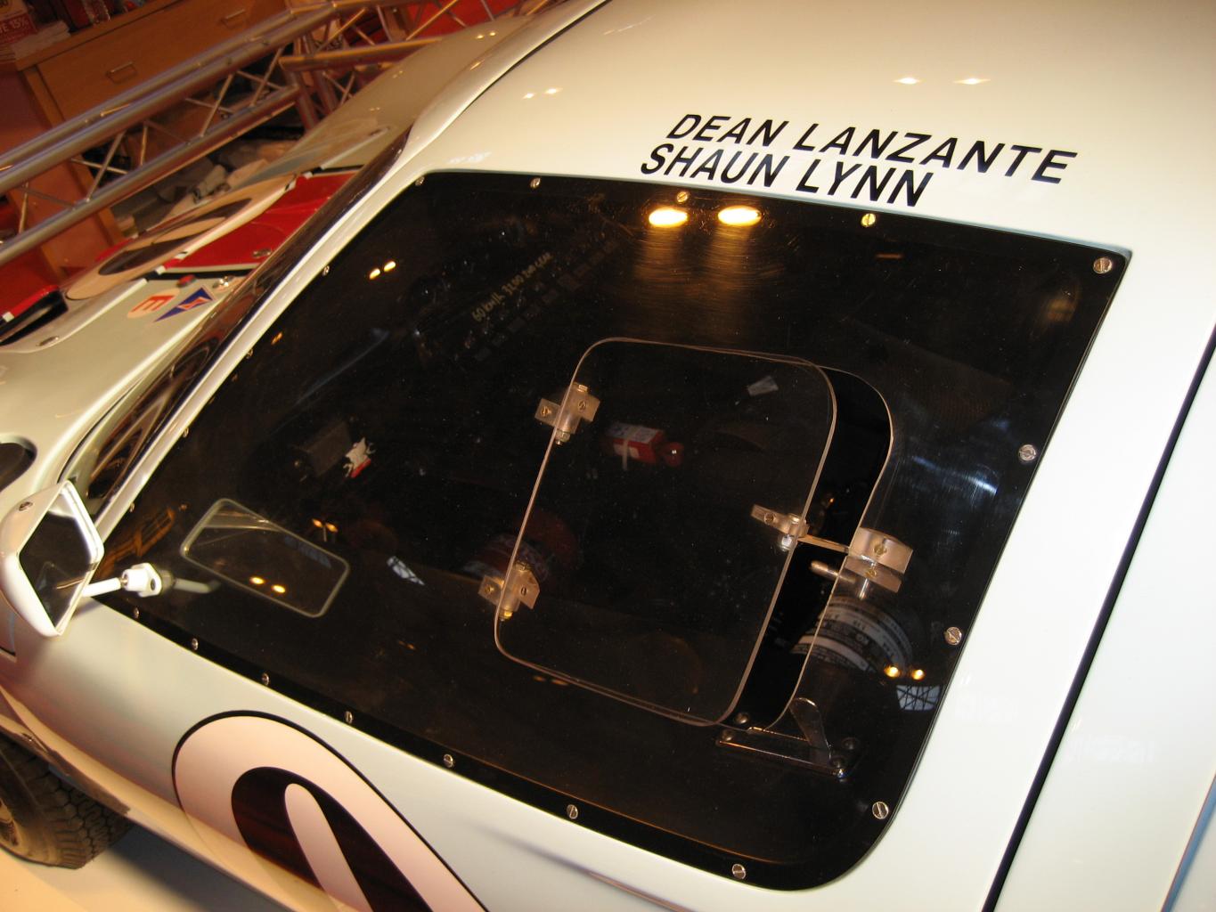

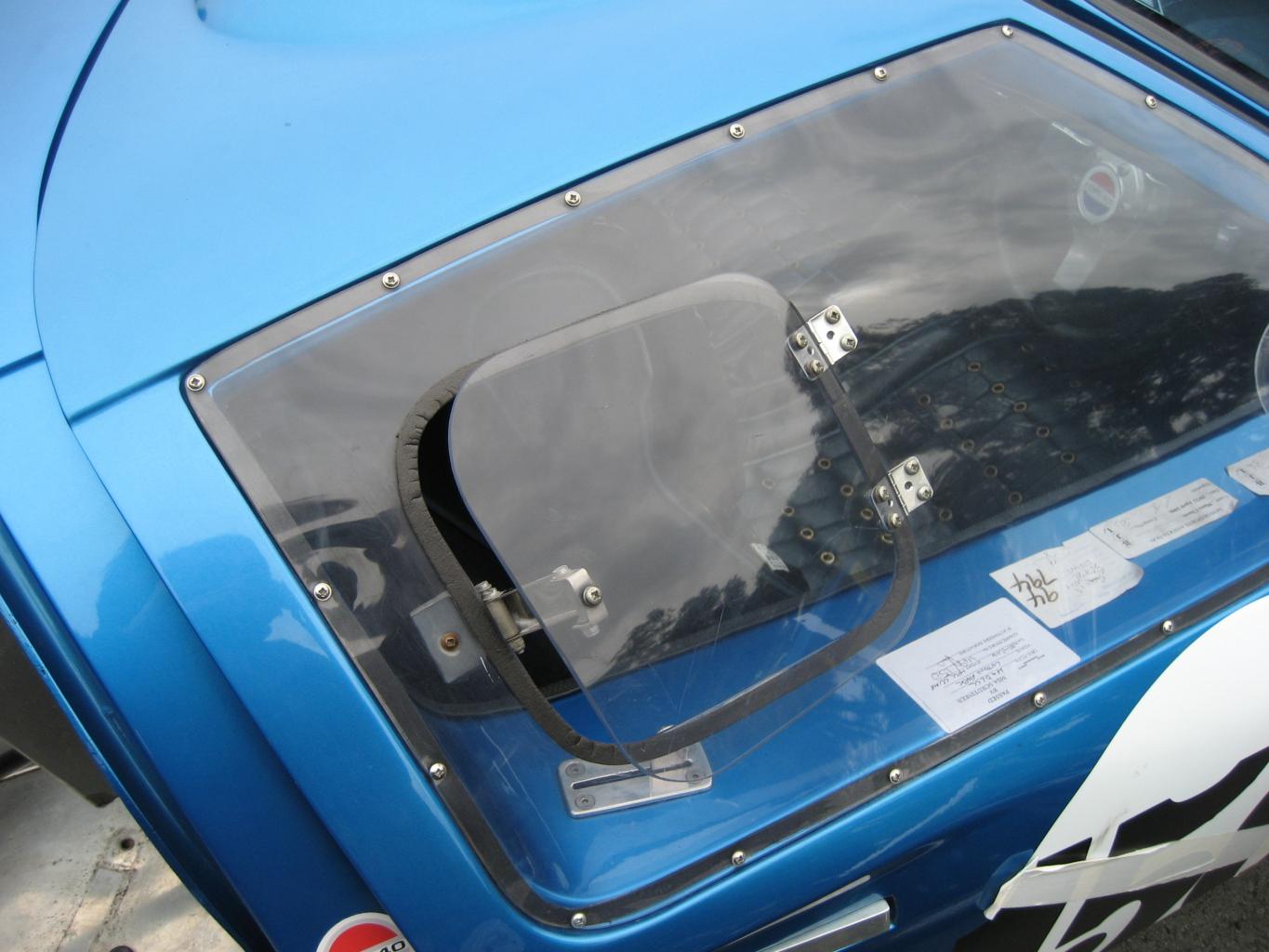

If you take a straight line from the top of the rear window across the bottom of the rear window to just before the rear spoiler Kicks up, an original rear clip will be flat and straight. The replica will have about 1.5" of kick up that is apparent at the bottom of the rear window.
