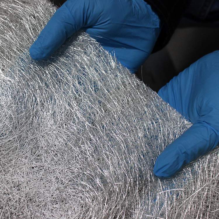

I needed to add about 3/16 of an inch to the door's length in order to close up the gap and make it uniform. I ground back the edge (inside so the outside surface was left unmolested) so that it had a very low angle. Instead of 90 degrees, it was now about 30 degrees. This left me with a nice wide area to add fiberglass to so that it would bond much more to the door's inside surface than the end edge of the door. Then I added a few layers of continuous strand mat to the surface and back onto the parent door surface area about an inch wide and a 1/4 thicker than the original door thickness at the edge. This will anchor the added material on the edge much better than simply adding length to the edge. Now being careful to maintain the new edge where I wanted it I hand-sanded back the area until I had a nice new edge that extended 3/16 inch longer and a bit thicker back away from the edge so it looks good from the outside but in sort of a wedge shape. This made the edge pretty strong and no less durable than the original fiberglass edge.
I finished the newly finished inside surface with Bondo to just make it smooth. Don't add bondo to the edge (end of the door), it won't survive because it is not hard enough.
