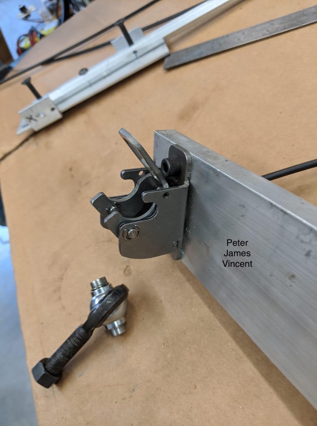

Then I have this photo from a guy named Peter Vincent..

Got another one. Looks like Scott implemented Peter Vincent’s latching mechanism. Here is a nice write up on Post #694…

I would say yes, Kurt’s and Stephan’s approach could possibly be installed easily as long has the strut mount can be unscrewed without access behind the body. But as Scott states, the pressure on the pin may be so great that you can’t pull it out when the door is closed.
Peter Vincent’s latching approach is more complex and based on that video Scott posted you probably need access behind the body for the cable pull.
I’d also be worried about scratching the doors and body up if it required door removal. My guess is realigning the doors may be a tedious and a difficult process.

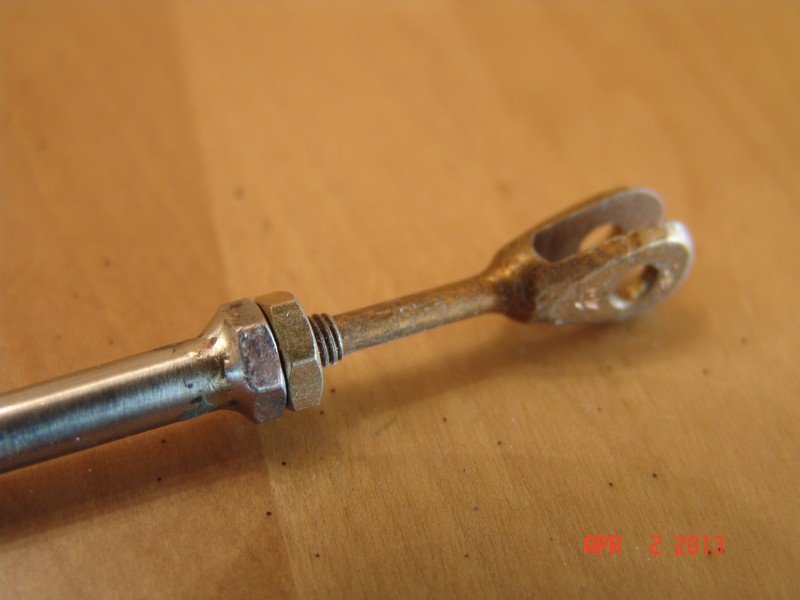

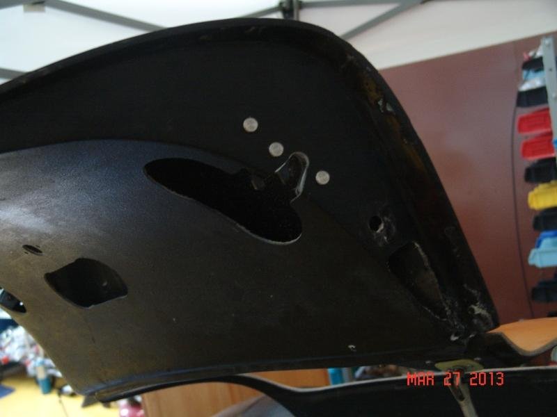

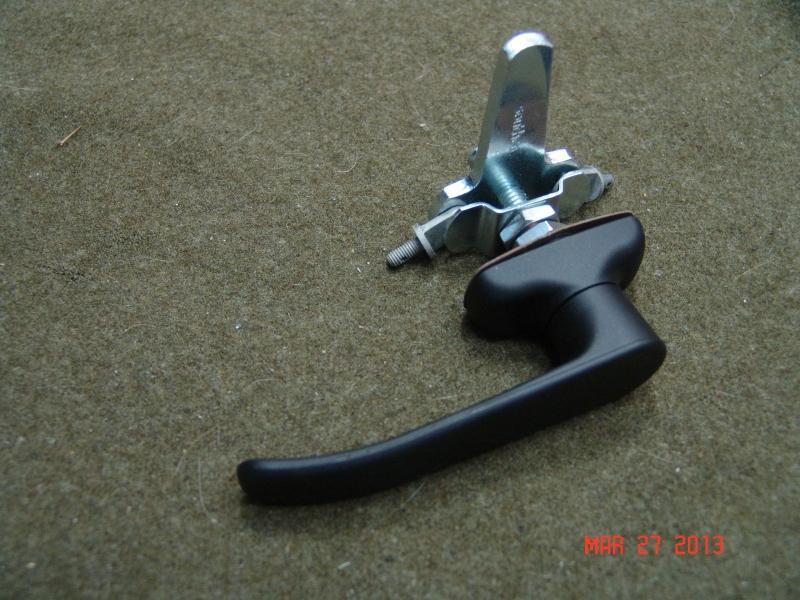

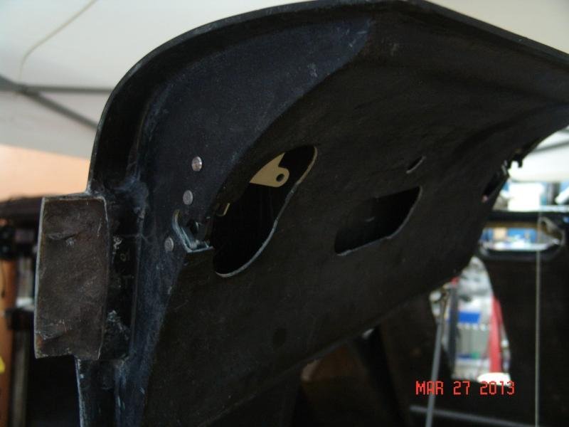

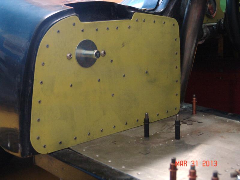

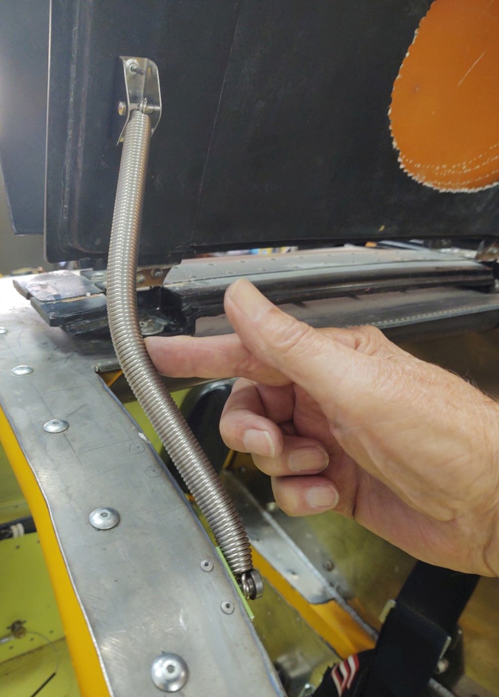

I used one of these latches and corresponding striker. Southco has a very wide variety of choices and release locations. For an interior door handle: https://southco.com/en_us_int/latch...4MTQkbzEkZzEkdDE3NjI2NDg4MjkkajQ1JGwwJGgw&p=2
I used a simple, non-locking rotary handle that was connected to the bear claw larch mounted on the rear edge of my driver's side door. the striked is mounted to the body.
