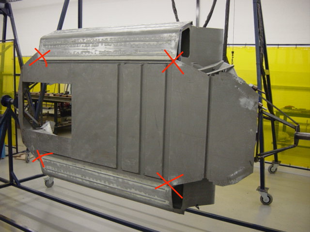

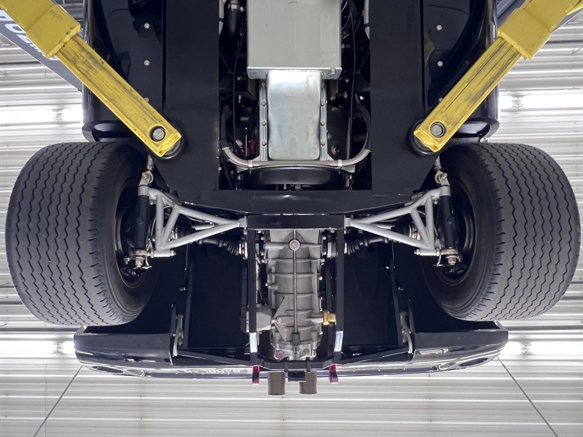

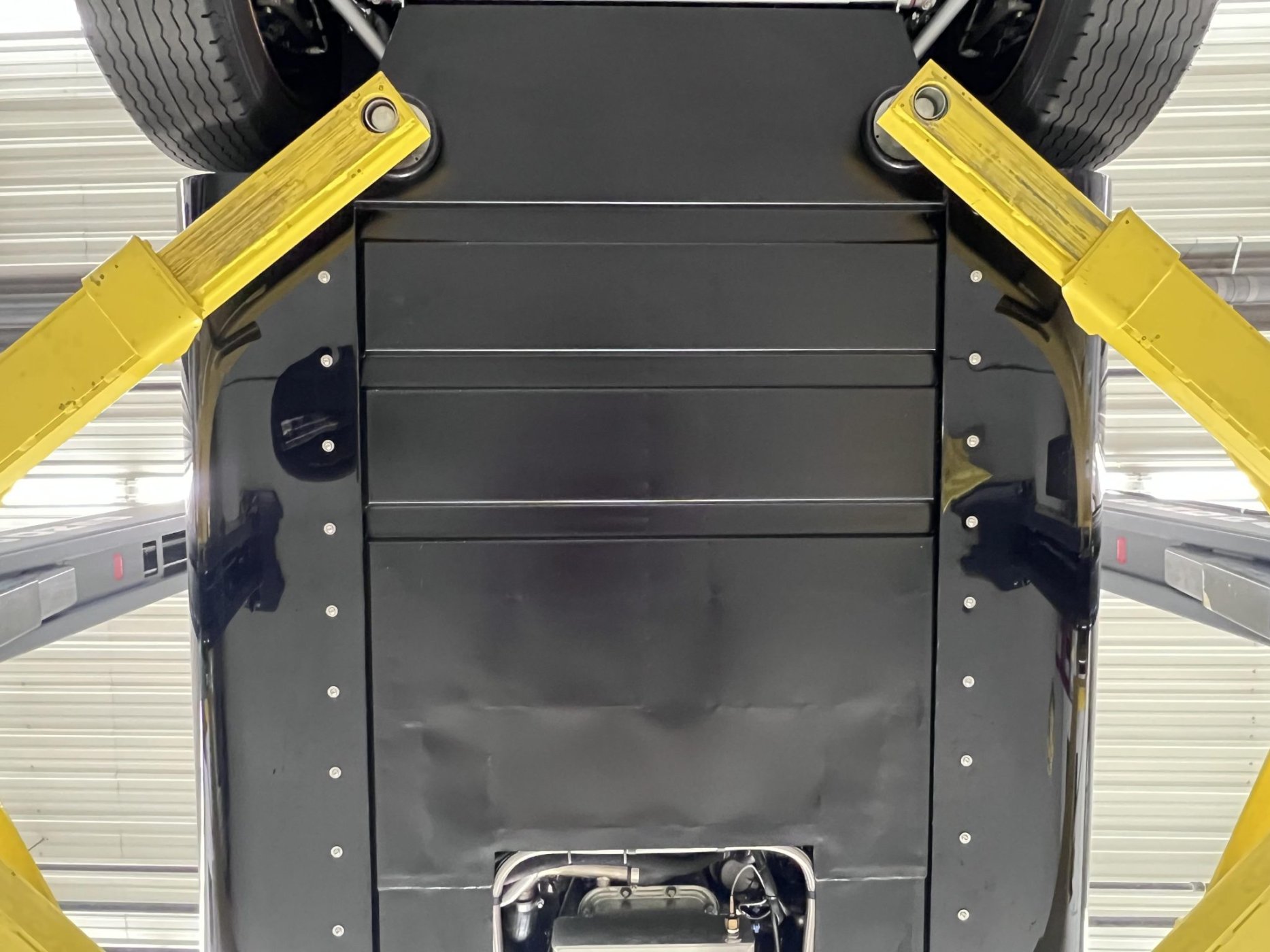

Lee Patterson
You should never lift the tub in the middle using a 2 post lift. The tub jack points are at the front and rear corners on the outer edges. Block with wood and a rag. You can also jack the car using the sub-frames with a lift bar in the quick jacks.

From BAT.

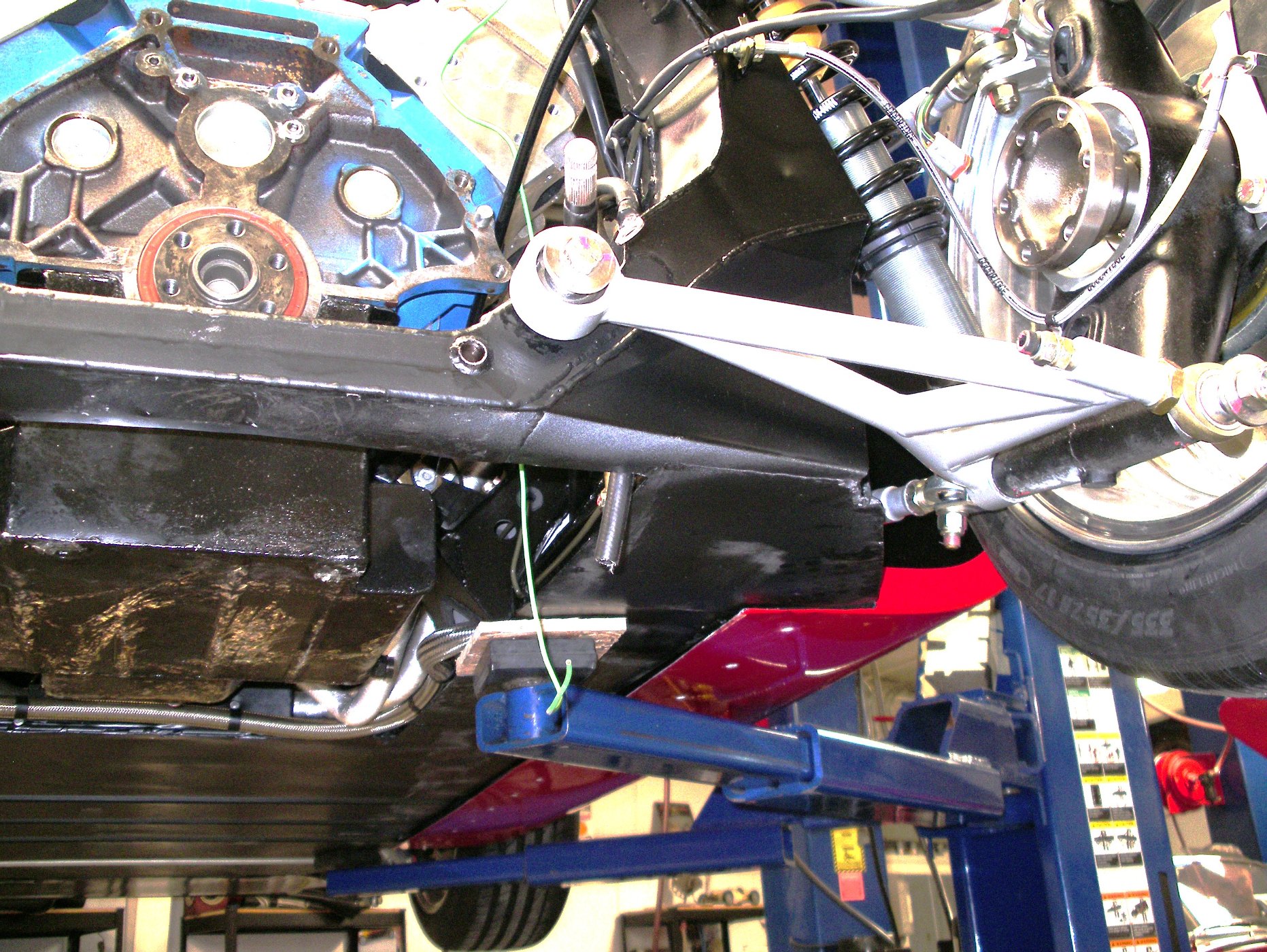

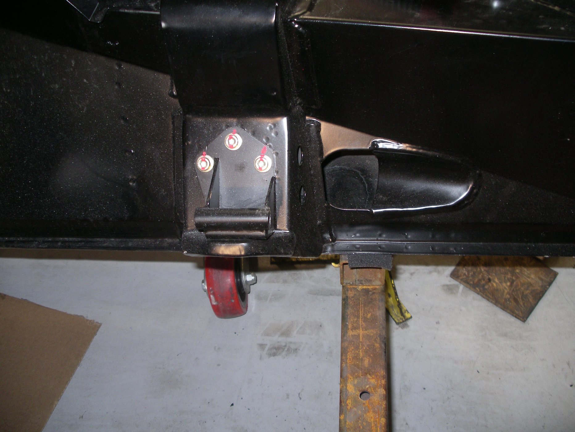

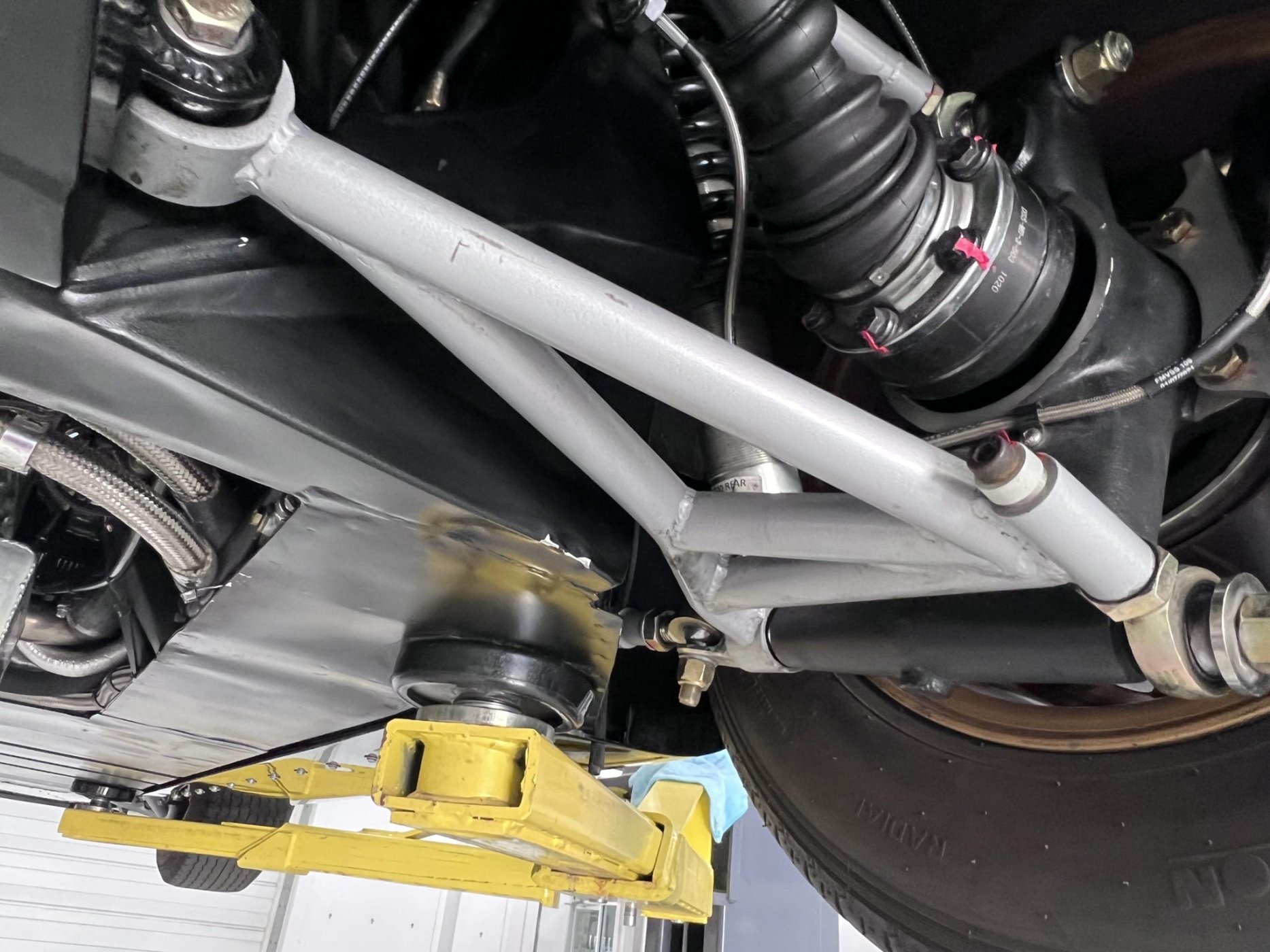

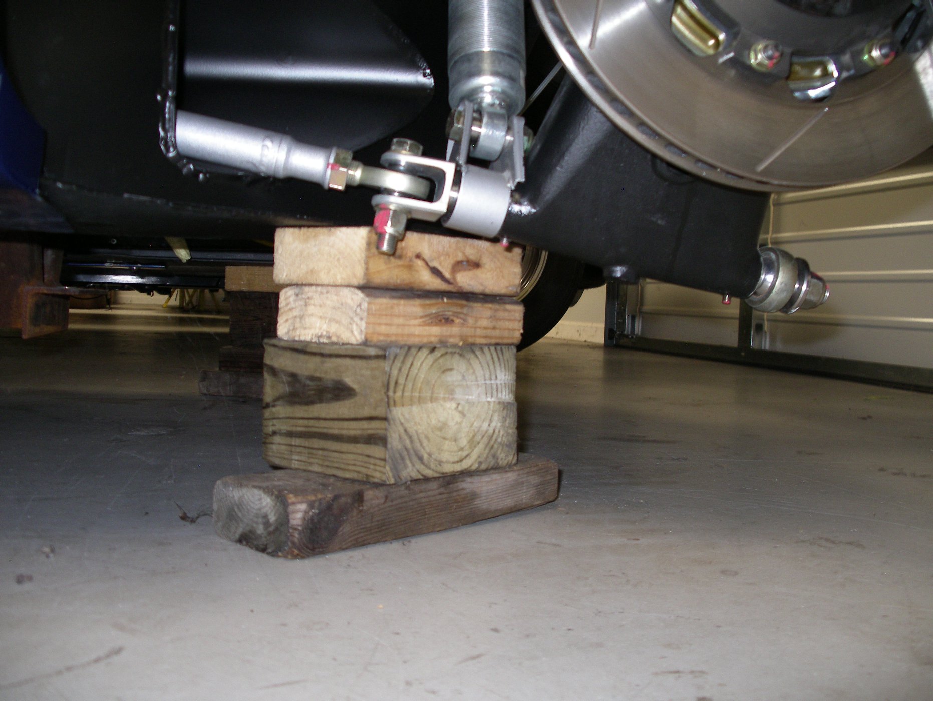

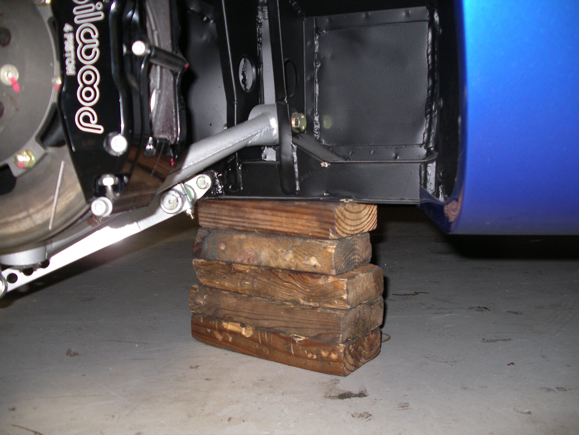

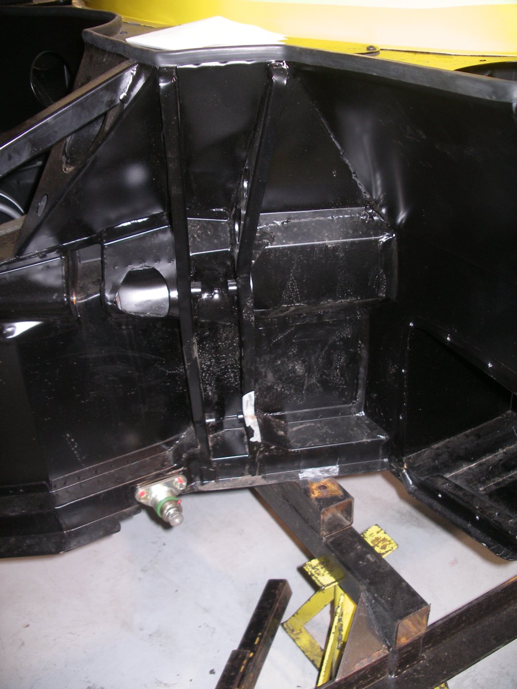

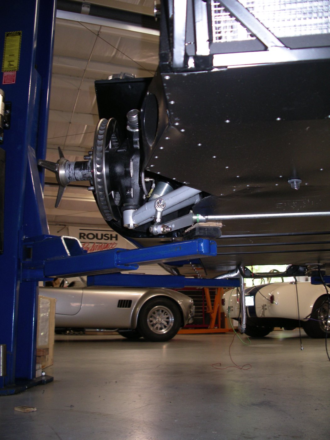

I always try to get to strongest areas which are usual the reinforced spots.
Front: rear pic up point for lower control arm
Rear: Horse shoe would be the best but with a 2 post lift sometimes hard to get to
Alternativ: below engine mount - don't have better pic :(
Always make sure to spread the load by using some wood.
