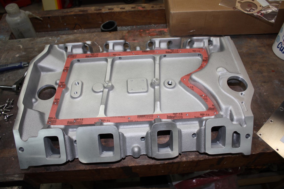

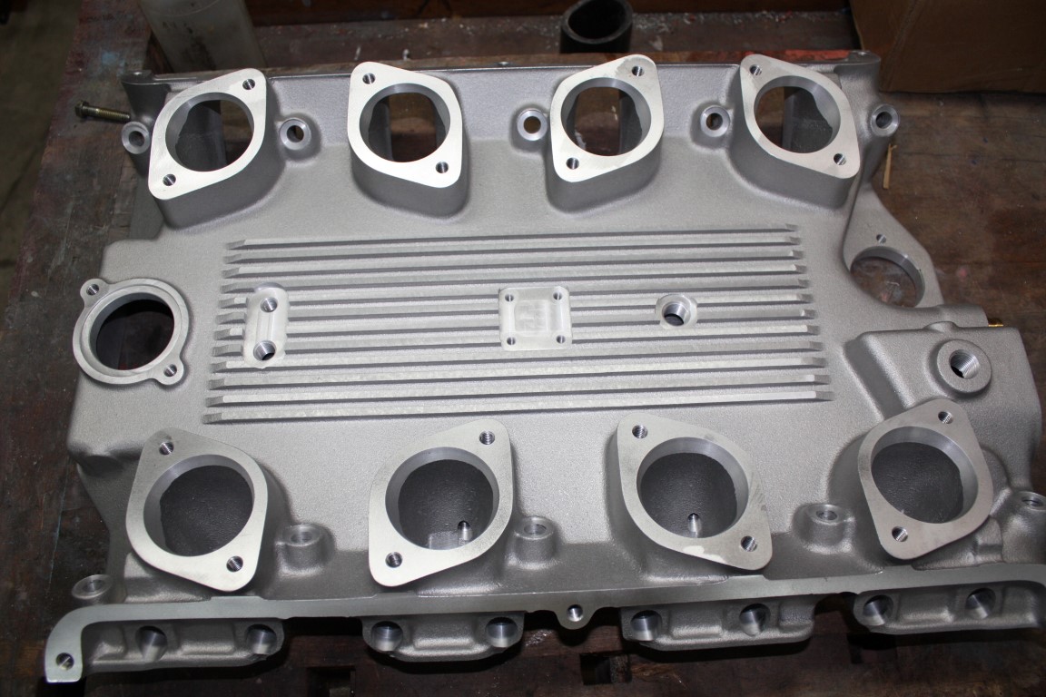

For those who have never seen it, this is the underside of the new Blue Thunder manifold. The plenum plate has been removed to show the porting. It is held in-place with a bunch of hex screws. I sealed it well and it does hold a vacuum without issue. The plenum doesn't extend all the way to the galley vent hole at the rear so the standard road draft/PCV setup is used. There are three pipe thread taps into the plenum on the upper surface. In the top view, you can see the vacuum ports in the individual runner area.

Nice manifold!
I have an older blue thunder manifold. Simple, but works and fits superbly.
I don't see any issue with mounting the IAC remotely. Given all the 'stuff' that has to be mounted on the manifold, it's a relief to have the option to mount the IAC off the manifold. You are effectively introducing a controlled air leak past the throttle plates, so as long as the control is there (so no leaks) there should be no issue in doing this.
