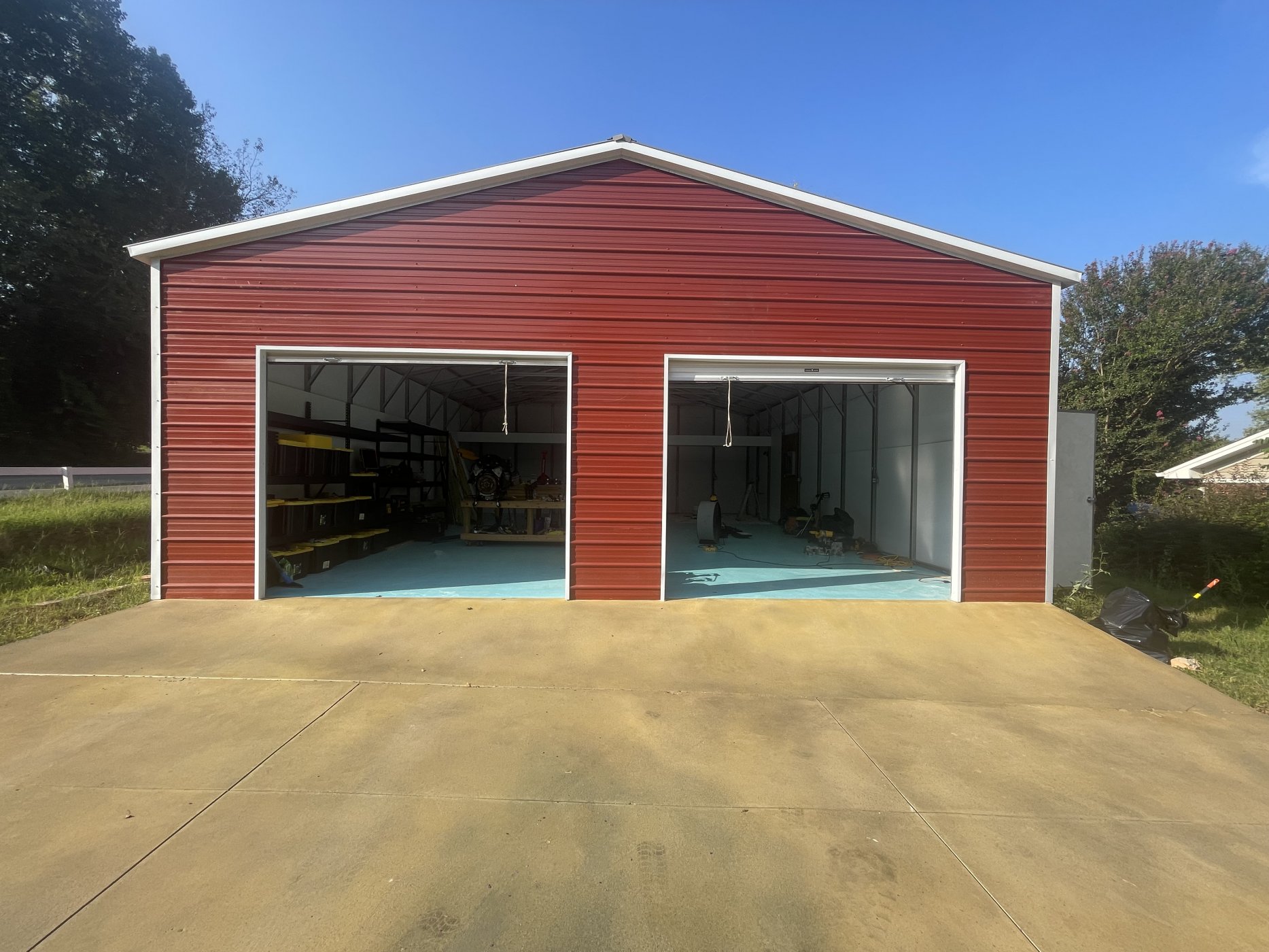

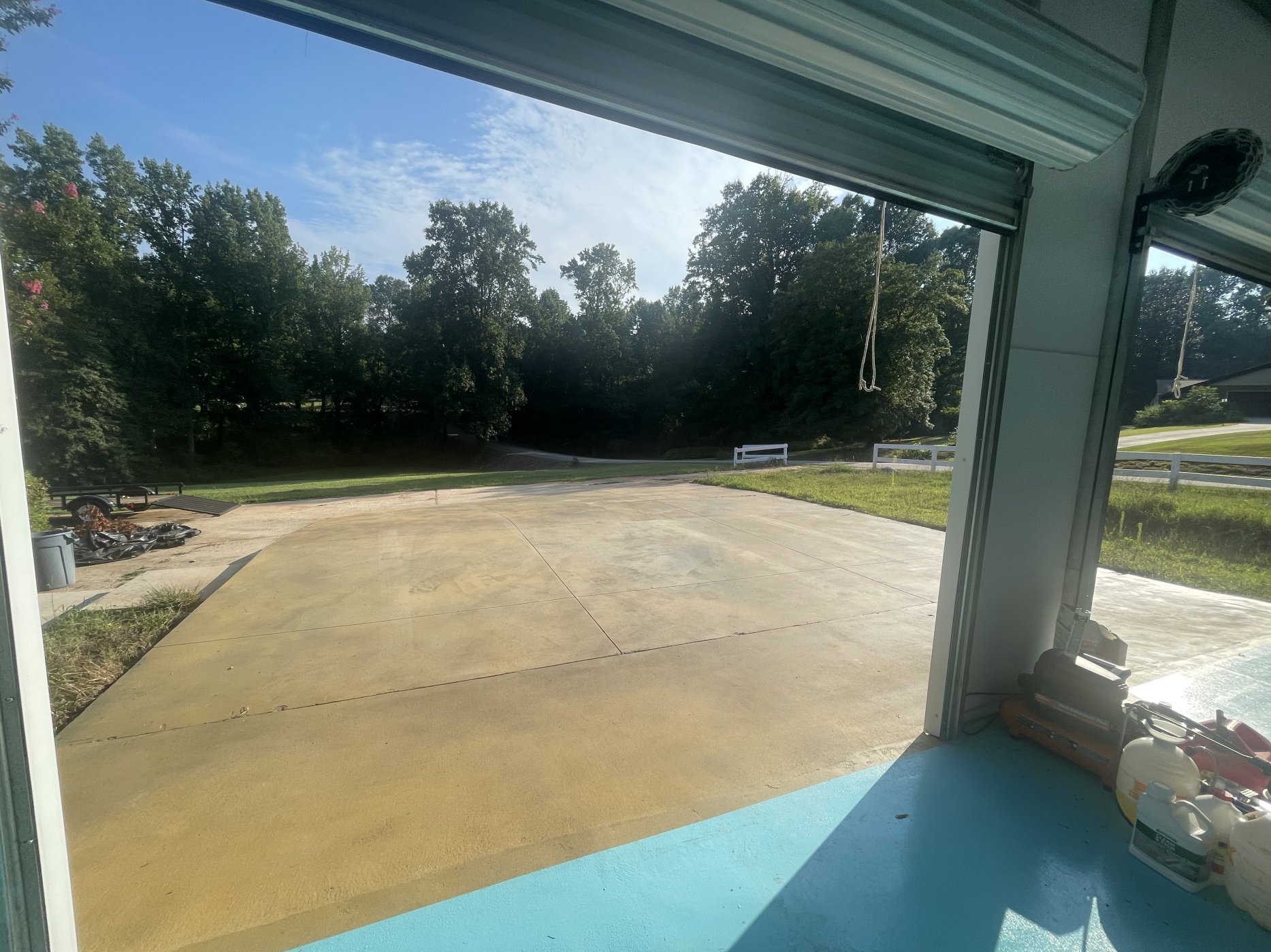

hello all,
Well it has finally happened, I have been asked to send tires!
As I go through the panic of finalizing the size and manufacturer of the tires, scrambling to finish the shop I’ve built for the car, I figured it would be a good time to start my build thread. :Do_O:cool:
There have been some build stuff already happening and as I figure out exactly how I want to do this build thread I will share and catch up the thread.
I am super excited and can not say how much of a privilege it is to be part of this community, looking forward to everyones advise and support!!!
LETS GOOOOOOO!!!!!

Awe, so sorry, I‘m in Greenville, SC (fun fact, there is no beach here lol) and I am building an SL-C. Am I in the right place for this thread?
Here’s the beach :p
Thank you Joel! Hoping to have it finished up this weekend.

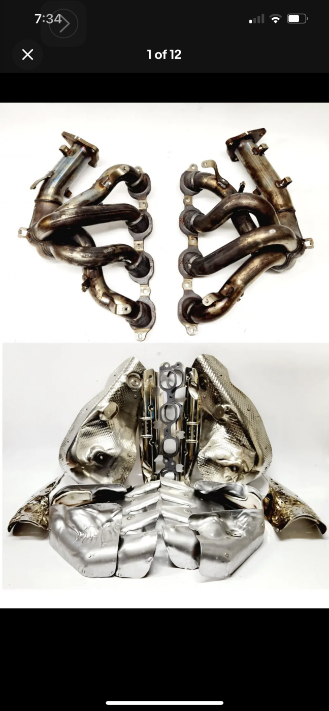

I did want to ask if you ever had a chance to play with a set of C8 headers? They look like the perfect core for a custom set of cut and paste headers. I have been lusting over the custom long tube headers that Scott (S2 build) and Stephan have put together, just amazing! Unfortunately I don’t think my tig skills are there yet and the pocket book would catch on fire for what I would assume having a custom set done would cost lol.

Hi Ian, the C8 headers are probably a different bolt pattern than the LS. I know the LT1 and LT4 are different than the LS. Also IMO they probably would not clear the frame or body. You may want to check Geoff’s SLC build thread out. His headers travel straight back making fitting Exhaust a bit easier.

Hi Ian, thanks for the compliment! Regarding the C8 headers, I looked at a bunch of different ones online and tried to do rough measurements. I came to the same conclusion Joel did above. You can cut off the flange and weld on an LS flange, but it looks like they wouldn't clear the frame regardless of which way you flipped them. I could be wrong, but didn't want to buy a set and have to return them.

you are 100% right that the LT heads are very different than the LS heads. My remarks about cut and paste were meant more along the lines of using the headers as a base for a custom set. While I don’t tig weld as well as some on here, I can manage.
I checked out Geoff’s build, those are some well thought out headers! They look quite efficient for space and function. I have no doubt that following suit would be a good idea… (foreshadowing:p)

did you look at flipping them upside down so that the end is low not high?
My thought is that if I take the LS7 headers I have and use them for the head side flange and adapt the tube shape to the c8 headers. The C8 headers, now upside down, would exit low with a slight up angle, much like I have see builders make for the exhaust adapter for the LS7 headers.
I am positive that there will be hiccups and issues, there always are lol. But that’s the fun right?!?
So, in all honesty, I quickly read both y’all’s reply’s this morning while working and let your fantastic, level headed advise sink in…. Then I bought some C8 headers hahaha.
I have no doubt that this is all going to result in a healthy amount of “I told ya so” for you both, but I’m the type who likes to know what hitting your toe with a hammer feels like before deciding it’s a bad idea
All that said, I picked up a set of factory C8 headers, complete with heat shields For a few hundred bucks. I think they have a lot of potential!
I think it’s going to be a fun experiment! I am a confident fabbi and this wouldn’t be the first time it all went sideways. Let’s see what we can do!
