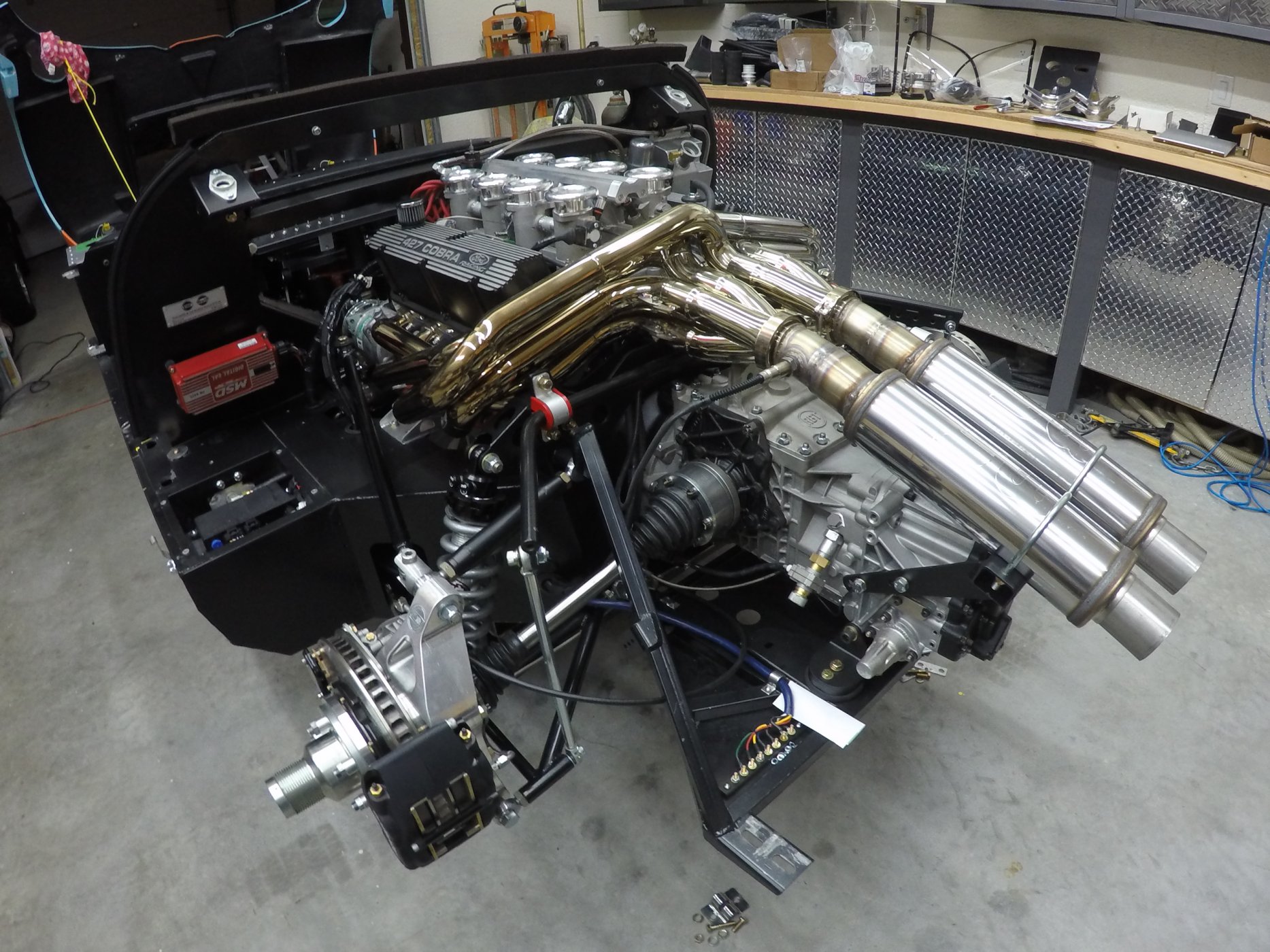

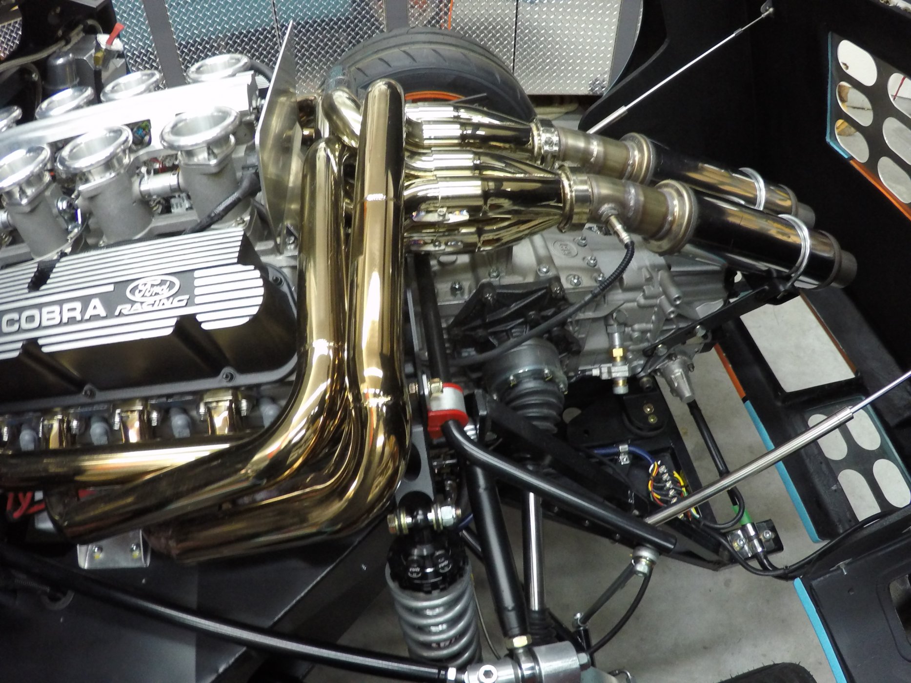

When the time comes for your exhaust you may give GP Headers a call, ask for Zack. They made my exhaust system and I was very happy with it.

These guys have everything you need. Have a look at other's headers for an SLC and an LS engine. Estimate the number and type of bends, 90 or 45, etc. Get a few extras of each and a length of straight tubing as well as a couple of 180's. They also have flanges, slip-on collectors, etc. Watch their clearance/B stock, sometimes they have a really good deal on a box of tubing you can play with. If you get the correct diameter and gauge you can use it later to build your headers. I used 16 gauge (.065). It's a little thicker wall so heavier than 18 (.049) but I think it is easier to weld.
I still recommend mild steel if you are new to welding tubing and have them ceramic coated. Do coating BEFORE you run them on the engine. If you want to do stainless read up on purging the inside of the tubing. Necessary for stainless tubing.

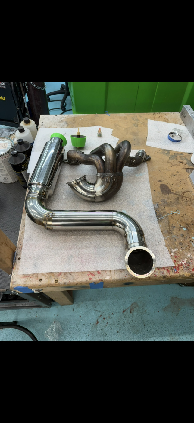

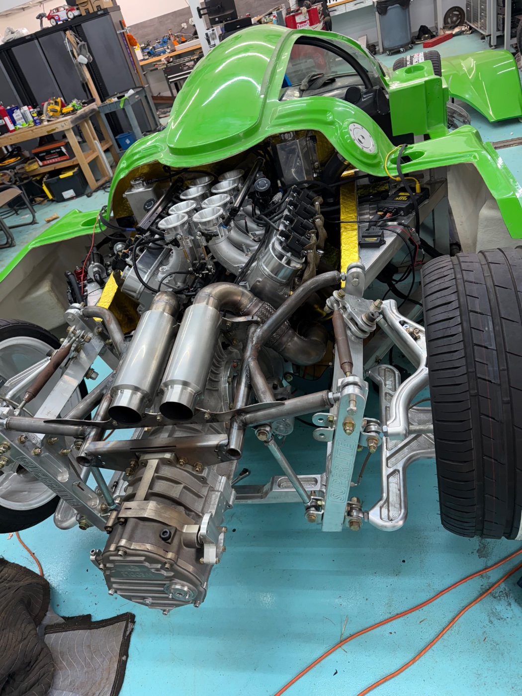

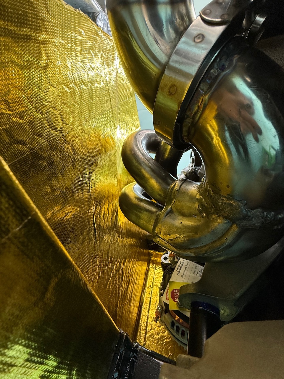

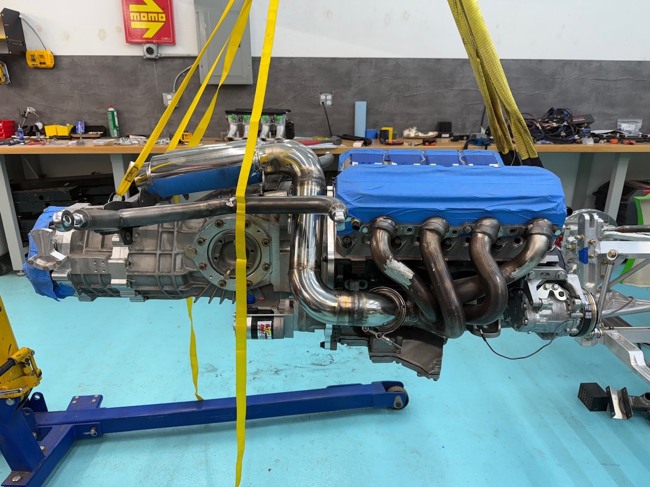

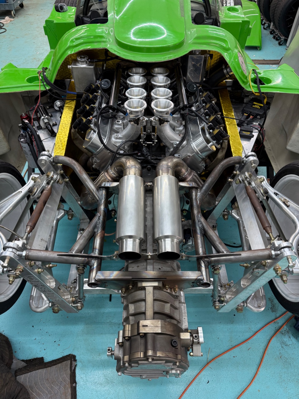

Thanks Mark, it was not all that difficult to be honest. I used 3” ss throughout, one v clamp and the flanges from my ls7 headers. If I hadn’t had to re-make the exhaust pipes 3 times I’m sure it would have been fairly cheap lol.
I have to say it sounds amazing, and the primary’s are within half an inch of being the right length for my setup.
I like the headers you have picked out but I would honestly go with used, you have to cut them up so much it really doesn’t matter what they look like, your going to put a grinder on 80% of them lol.

Here’s a good picture of mine so you can see what I did.

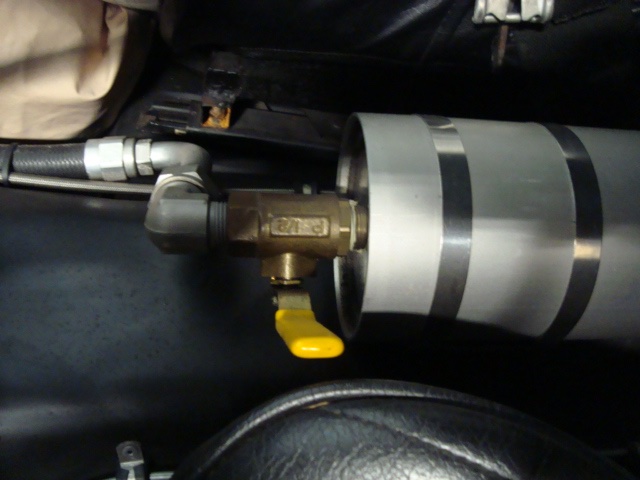

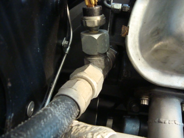

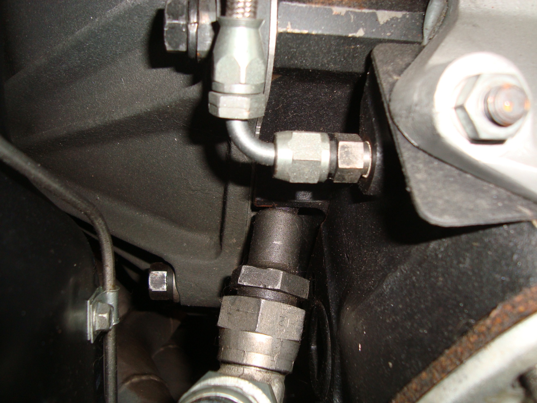

I have raced with an Accusump in a small block Ford for over 40 plus years, never lost a bearing. Maybe due to no unpressurized starts, but pressure in the turns is always up. I manually operate the unit, (yellow handle), not sure I would trust an automatic operation though. I had lost engines prior to using. Maybe just coincidence? Tapped into the rear of the main oil galley, so feeding oil from the pump and also from the rear.
