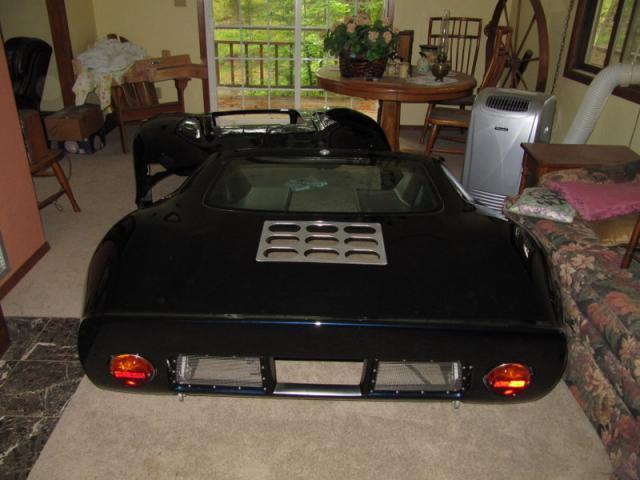

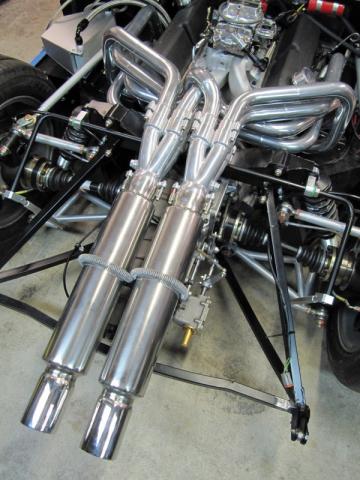

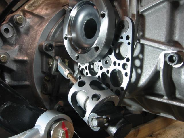

Thanks, that's a great help. I have a bottle of PAG46 will that work? Can't wait to drive it, yes it's been long, long build. Pictures just because. The slave bracket is my tribute to 60's technology before Solid Works and CNC. Body parts have been in the living room for a long time.

Rich,
Good luck with your first drive.
P.S. I really like the swiss cheesed bracketry. Shows alot of attention to detail.
