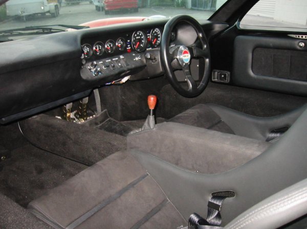

The DRB's here in Oz use a flush mounted handle set conveniently towards the front of the door, with a cable connection to the catch. There should be some generic handles of this type available from family sedans over there.
Dalton
I like that DRB design that Dalton has shown.. I'll be looking into that one myself..
