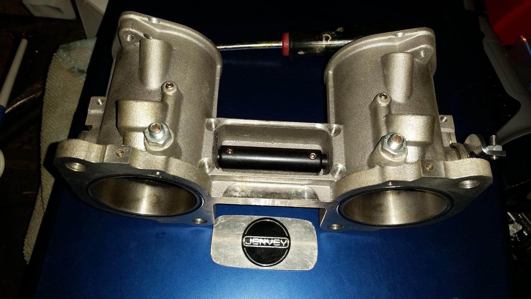

Installation of Jenveys with Emerald ECU on my 302

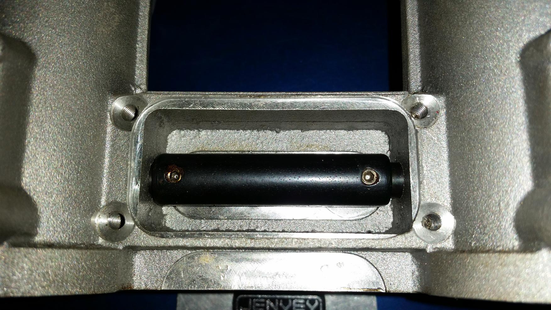

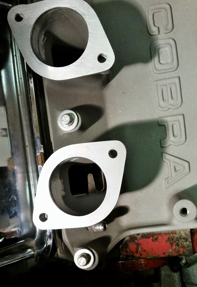

I fitted the intake manifold, but was suspicious of the fit as the lower part of the gasket looked a bit loose, sure enough I can get a feeler gauge in there. Not just in one place, but each cylinder. The top part of the gasket is sealed but not the bottom as though the angle is different.
As I see it, the possibilities are;
The cork gaskets at the ends are preventing closure. I doubt this as I would expect it to pull down in the middle, but it hasn't.
or The angles are slightly different, or slight discrepancy in dimensions in which case I may need to remove heads, replace gaskets and try to tighten heads and manifold together. Maybe a thicker intake gasket would help as well.
I'll have a closer look tomorrow.
Any experience of this / comments from you guys?

So with the help of Jacmac and others I established that the clearance at the intake manifold ends was too small for the cork gaskets so I used instant gasket to finally install it. This weekend I fitted the hp pump, filter, and surge tank, made up all pipework up to the PRV. Just the return pipes to do now.

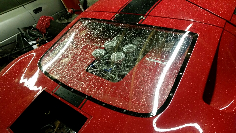

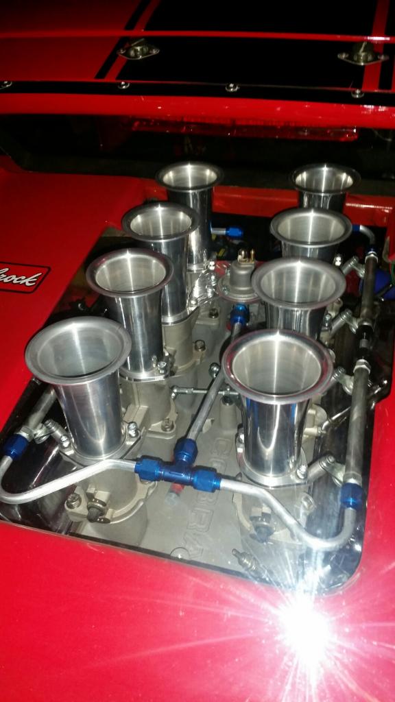

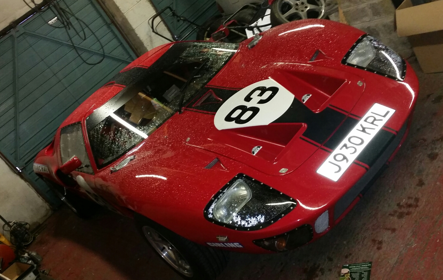

Cheers Jimmy, last week was MOT so first time on the road. Drivable in top gear but doesnt rev, masdively overfuelled but I'm learning to adjust to the point where it will drive a bit further to a rolling road.
A few pictures.

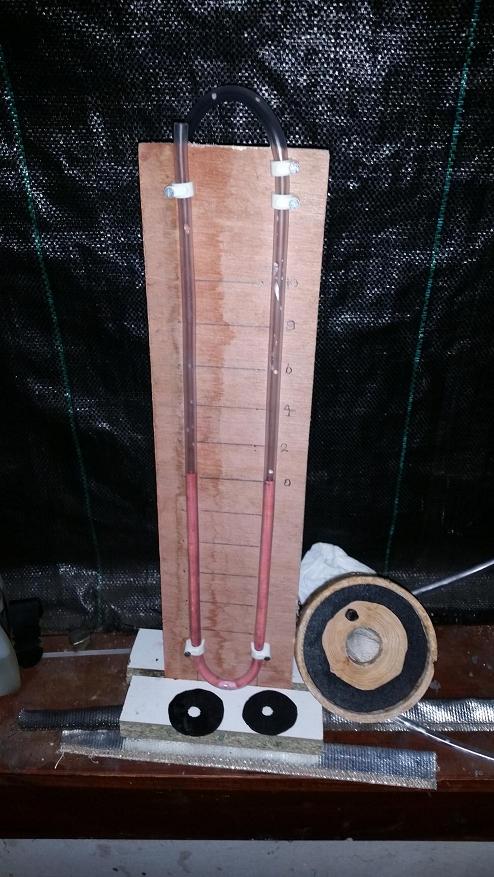

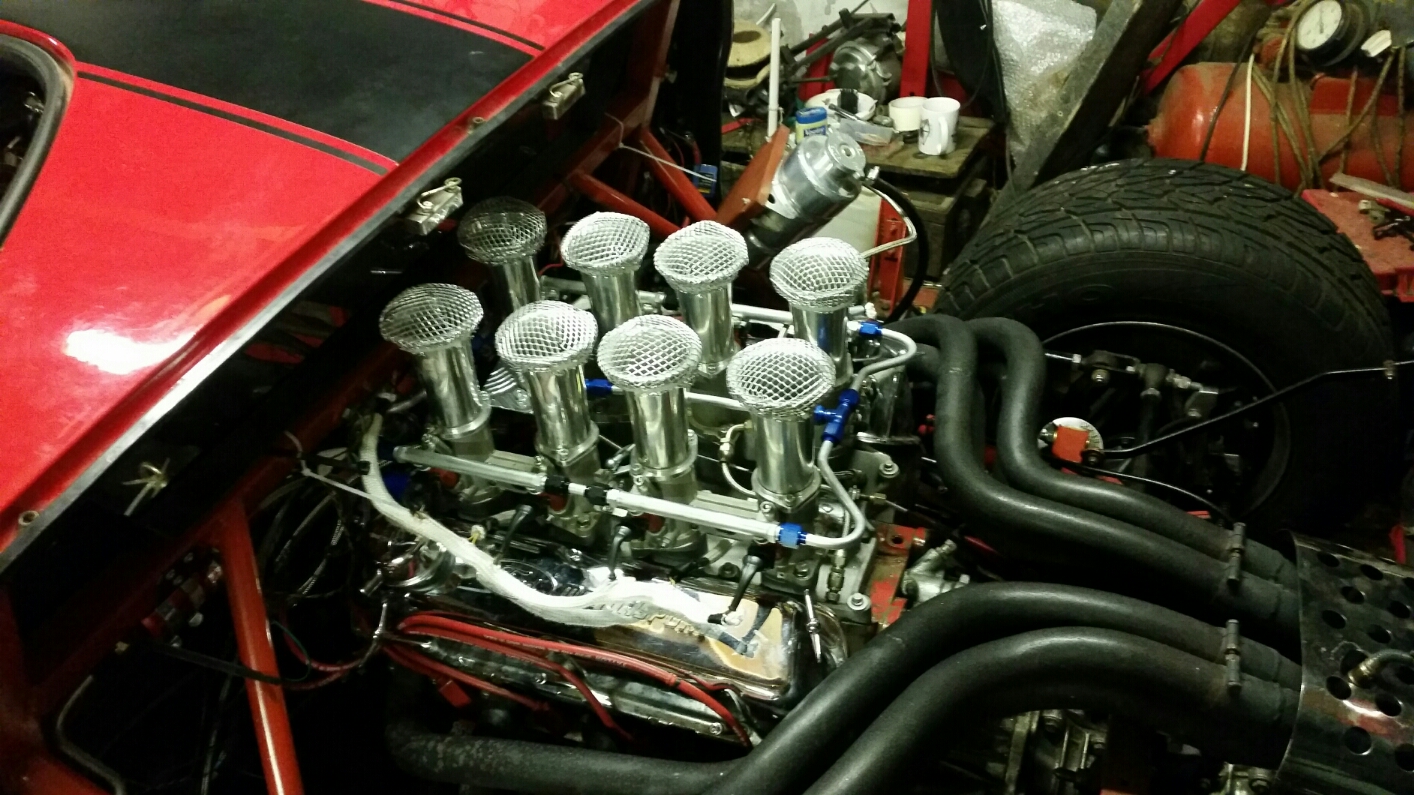

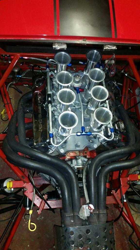

On Friday, I had a go at balancing the TB's at idle. I made a simple manometer with a wooden lathe turned cap with a 1" hole. Coloured the water with some red syrup. A couple of rubber washers with 10mm and 8mm holes over the 1" turned out to be what was required to get decent readings.
At first I found that number 5 TB had a reading of 7" compared with 2" the highest out of the others. Since its brother number 6 was only reading 1.5" there was clearly something amiss. So I removed the TB pair, and found that there was play between the spindles. The Jenvey nameplate is removable and reveals a cavity with the spacer connecting the pair of spindles together. Problem was a loose grubscrew, so easily fixed.
Once I did that, I was easily able to balance the TB's within about 20% of each other, which I felt was good enough for starters. Maybe I will try to get them a bit closer once I have reasonable basic ecu settings.

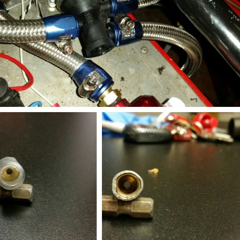

A few changes in preparation for driving to Goodwood in a few weeks. First I was never happy with the voltage reading. It never seemed to hit more than 12.5 volts and any thing switched on it would drop to 11. The meter was measuring voltage at the end of a chain of instrument light supply wires, so I changed that, while it cured the voltage drop there was still not much charging going on, so I got a new alternator. Now it shows 13.5V at tickover so I am happy with that now.
Dave Bilyk
Dave Bilyk

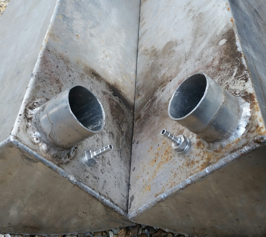

New Facet Red tops installed. I also put an orifice in the return to the diverter valve to get a small back pressure in the surge pot. Hole is about 1/16" and gives a back pressure of 1.5psi but only with hp pump / engine running. Havent quite understood that yet. Before the orifice I tried creating back pressure with the Malpassi Filter King but as I expected didnt work so I moved on to the orifice idea.
