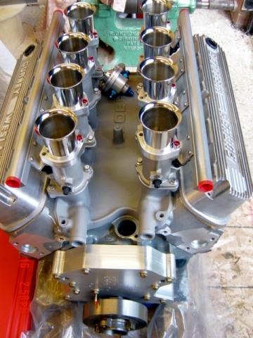

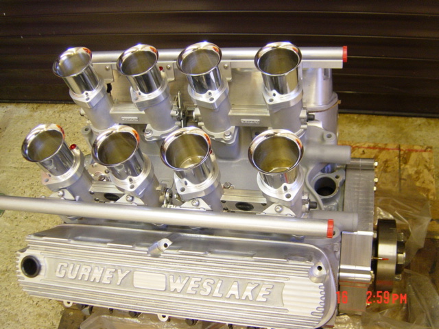

My 427 stroker motor is based on the Fontana aluminium block and with an intake manifold from Cobra Restorers and Jenvey 50 IDA throttle bodies with 4" velocity stacks all of which are tilted inboard on the manifold by 8 degrees to improve air flow and produce a similar look to the Gurney Weslake arrangement. The linkage between the two banks was a bit fiddly to set up but the TB's are very easy to individually balance and they have been completely reliable in service.
A friend went for TWM TB's on his Safir and I must say they are a very neat and exceptionally well engineered design, particularly having the fuel rails running down the centre, unlike my Jenveys which have the injectors mounted outboard. When I questioned Richard Jenvey about his design he said their outboard position gives improved atomisation - no idea if it is true. Does anyone have an educated opinion on this?
A friend went for TWM TB's on his Safir and I must say they are a very neat and exceptionally well engineered design, particularly having the fuel rails running down the centre, unlike my Jenveys which have the injectors mounted outboard.***** When I questioned Richard Jenvey about his design he said their outboard position gives improved atomisation - no idea if it is true. Does anyone have an educated opinion on this?******

Could you show us a pic of the manifold. Never seen a Jenvey.
Bill,
Here is a set of Jenvey 48mm throttle bodies fitted to a 289 Cobra manifold which I built some years ago.
The fuel rails were from Kinsler with the brackets and Weber air horn fixings done by myself.

Hey Bill, just looking at your picture above of your engine bay, is the right hand side, top suspension arm very close to that inlet port on the swirl pot or is it just an optical illusion?
Doug S.

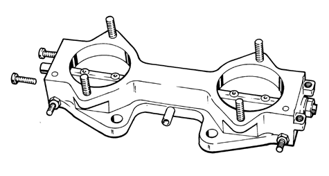

I´m looking for that throttle bodie that TWM offered a few years ago, it´s out of production, Pantera Performance of Colorado offered a "low profile" intake where this unit was used. Does anyone have any left overs...?
Andy
