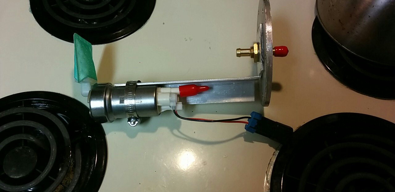

James:

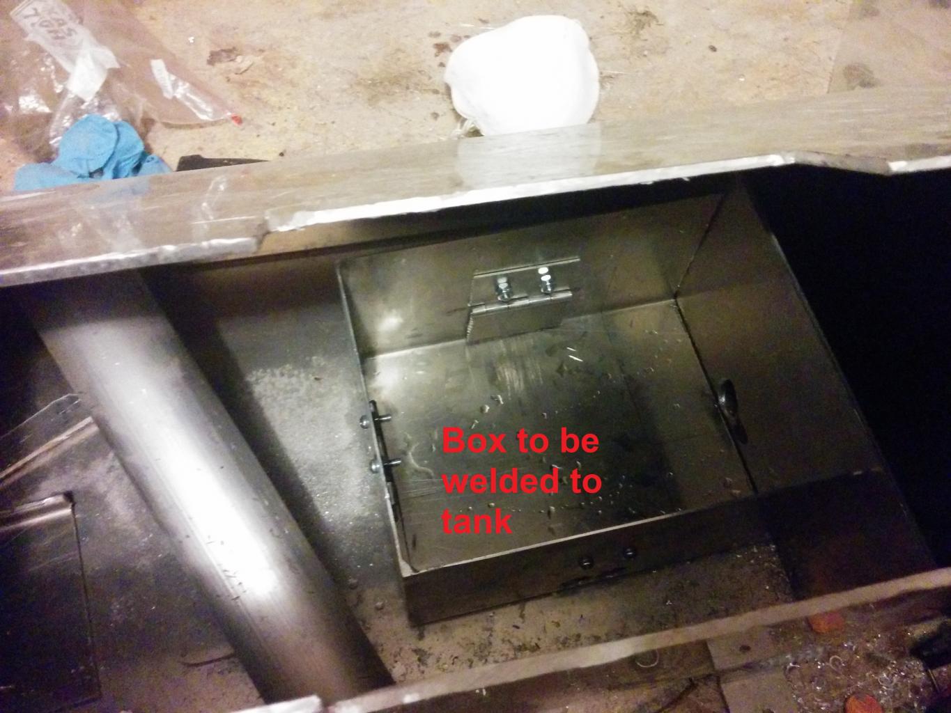

You could've used the pump how it was.

Don:
The photo above only shows the fuel pump placement ( representing how the fuel pump fits). I also added a dividing wall inside the tank ( full height ) with fuel safe check balls.
