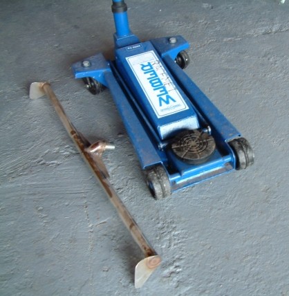

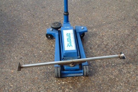

I have been struggling with jacking the front end once the front clip is mounted. Many thanks go to Dave Morton for his sending pictures of how he solved the problem. (Yes, I have permission to post!)
Thanks again Dave

This Weber jack in the pictures above is the lowest profile
jack that I can find in the UK. I will measure it today and post the height when I get back from work.
Dave

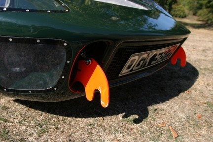

But none of them looks as cool as Dave's, and if ain't cool, it ain't for me. But then my wife says I'm a huge dork so what do I know.
David Morton
The wheels on the Weber jack are the limiting height at 3" and the centre 'spinner' sits below that with the rubber disc removed. With the Rubber disc it will measure 3.4".
I am not advertising but if anybody is interested send me an email and I can give you the companies details (in Essex, UK).
We also use an air bag jack on our F1 trailer which can lift a Mercedes Sprinter at 3.5 tonnes. I think about 1.5 inches is the minimum height to slide the bag underneath.
Dave

The hooks on the front chassis and the lifting bar with the jack are capable of lifting the car with rims only. The
trick is to be able to carry a trolley jack on board as well !!! no - taking the p-ss.. I will work on another way
of lifting the hooks with a light weight jack and get back again. It would be no big deal to carry the lifting bar somewhere down the back end. I'll try and think something out in the next week or so then come back.
Dave M
