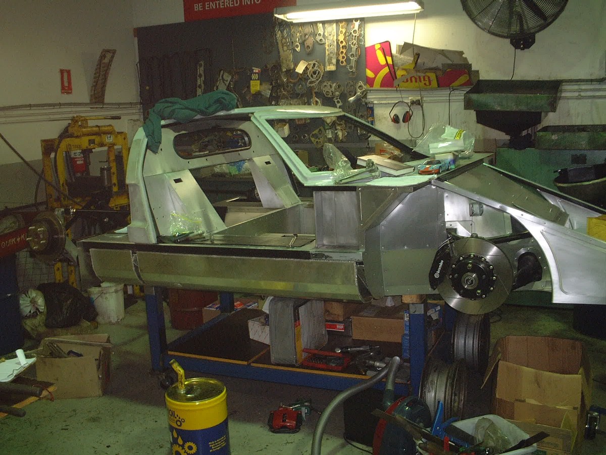

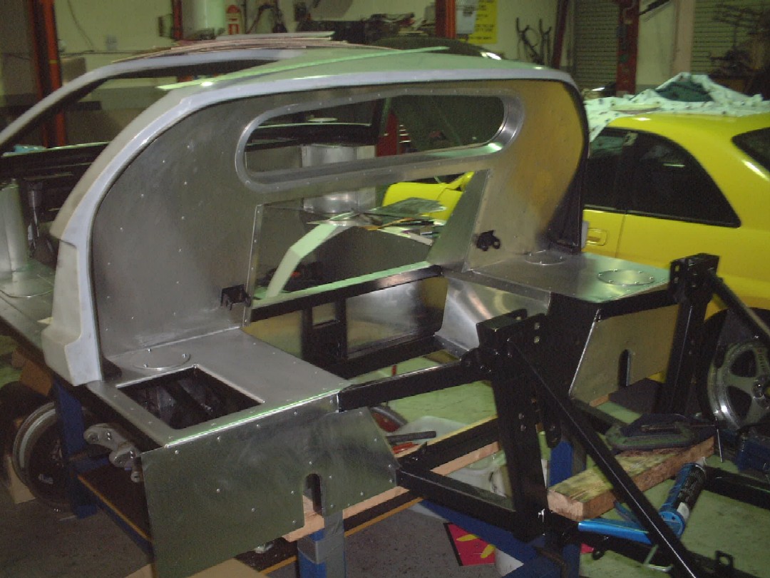

Made the firewall in one piece.
Formed a window surround out of 2mm sheet.
When I finished this part I was so pleased with my self I had three beers & three cigerettes while staring at it.
Re: RF105
Not going with the butterfly panels.
Nothing wrong with them, just thought I would try something different.

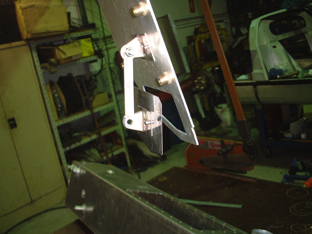

the first day I finished of the L/H fuel tank.
That was were I got to in OCT.
I put 2 sets of trap doors in the tanks that close of under brakes & hold the fuel up in the rear of tank.
If need be I will put foam in but I am trying to avoid it. Less servicing.

Tank baffles & trap doors

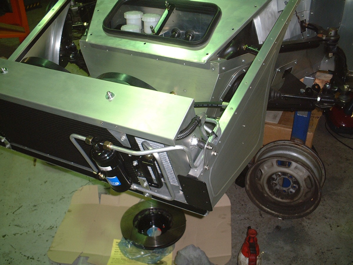

Re: RF105

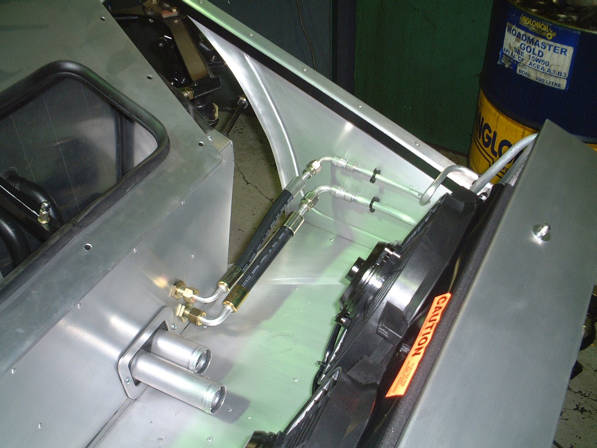

I made the radiator (alloy core)2 row.
Fitted the condenser ,Made all pipes ect mounted fans bla bla.
I spent a lot of time looking hoping the front clip will close.
She ill be f*****g right was the end result of all the looking.
Mounted resivoires for brakes under front cover , I am trying to keep it clean around the front.

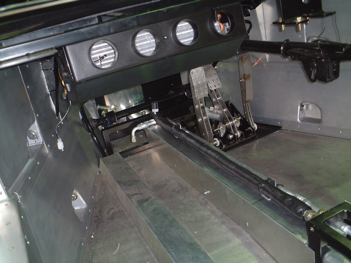

Re: RF105
I made the console with a 2 layer system water pipes in lower & a/cond & wiring in the top.
I didnt want to see the pipes.
Under dash unit went in

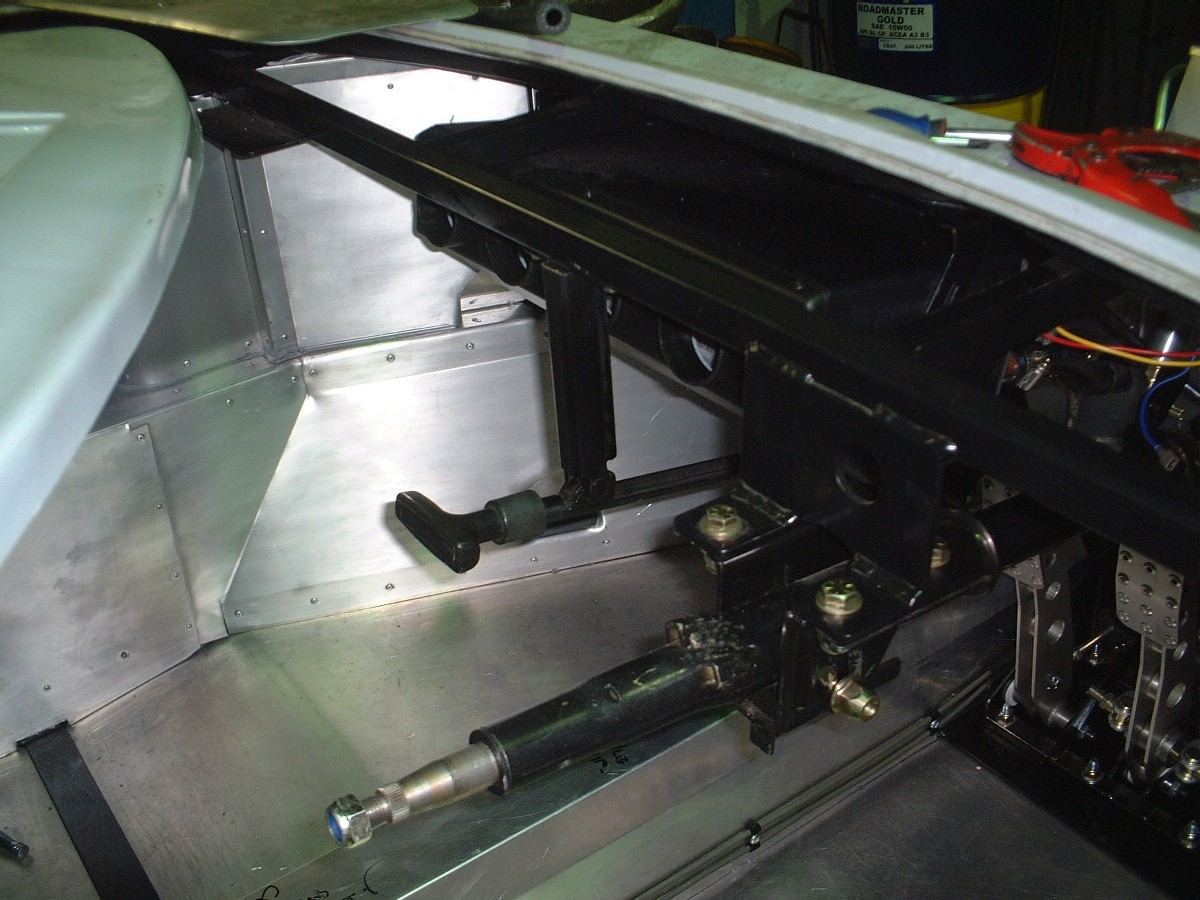

Re: RF105
Had to give the handbrake the sack due to the A/Cond plumbing taking more room than I thought.
Sorry Dan.
I think the original cars had them their anyway, and it feels good.
Re: RF105
Lot of farting around with this but I got it sused in the end.
I used the h/brake shoe off the monaro ( lumina over in USA I think).
I will get the cable made to suit but it works a treat.

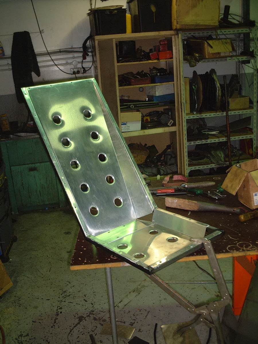

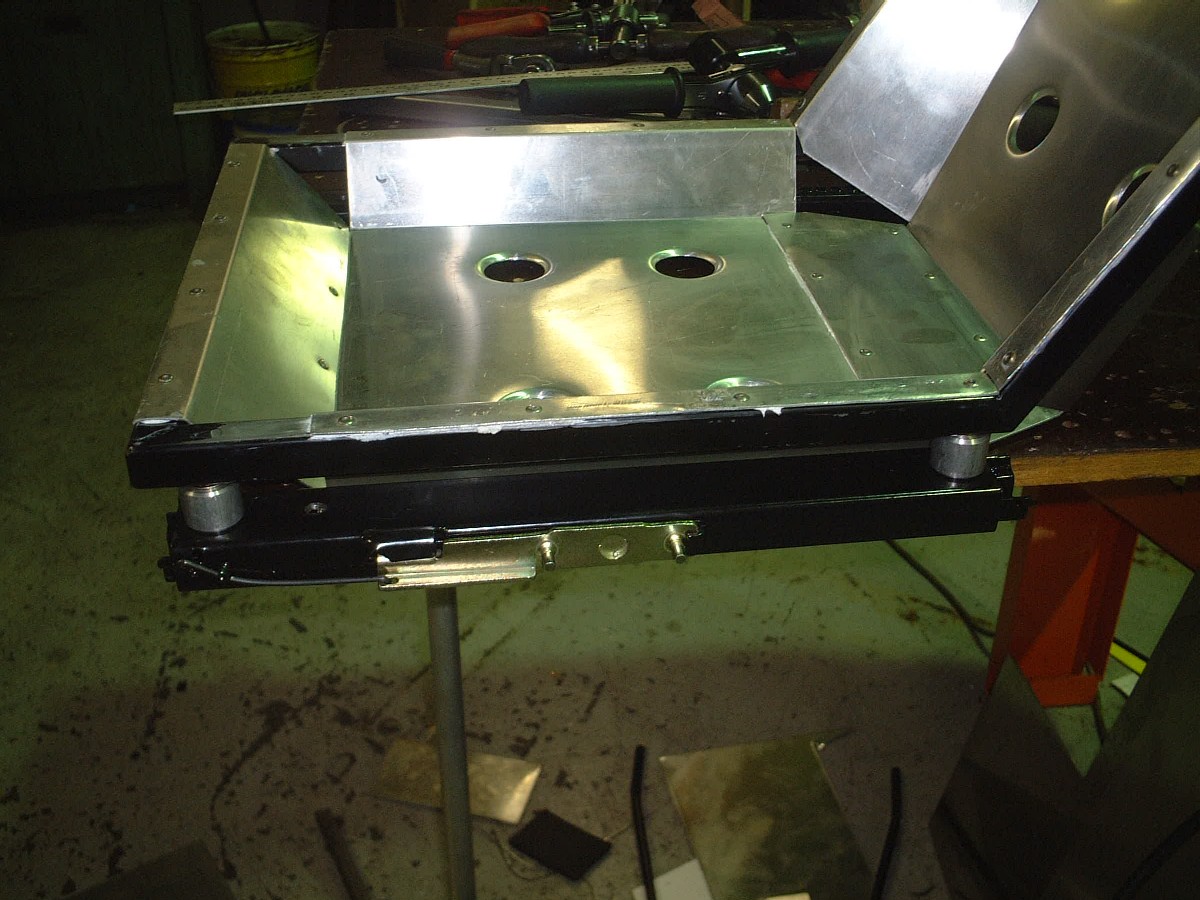

Re: RF105
started on the seats , got a fair way through the drivers.
Put a track on this on ,the passenger will be fixed.
Could have done better sheet work on it but by this time I was over it.
I am going to try to simulate the 1075 style of race seat ( we will see).
Re: RF105
Track mechinisim.
Dropped the seat down between the track for head hight.
Ive had it in the car it fits good.
Passenger side will have longer spacers & no track.
Thats it for the moment.
Hope you enjoy as much as I have the last 10 days.
Jim

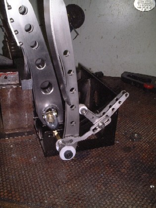

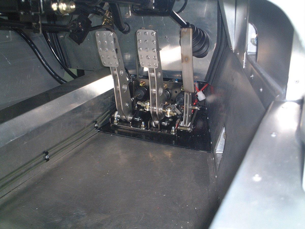

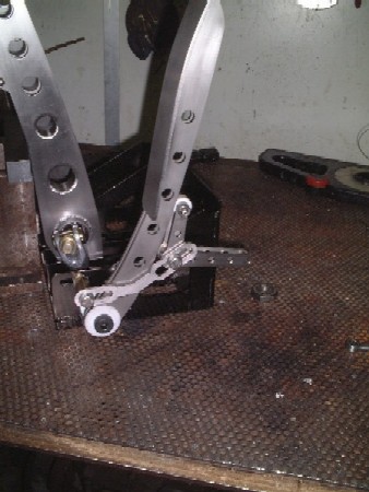

Firstly I took out my pedal box & threw it away.
I remade the frame because I found it to be a pain in the arse to hook a throttle cable to.
I found because the inner side panel next to the throttle runs at an angle it is not an easy job to bring the cable in & hook onto the pedal.
I didn’t think it would be that bigger deal but it was.
The new assembly has a bell crank with a Teflon wheel that runs of the back of the pedal.
The cable mounts above the box & is attached to the end of the bell crank.
pic 1 is closed throttle pic 2 open
Also incorporated closed & full throttle stops.

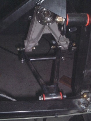

RF105 upgrade parts

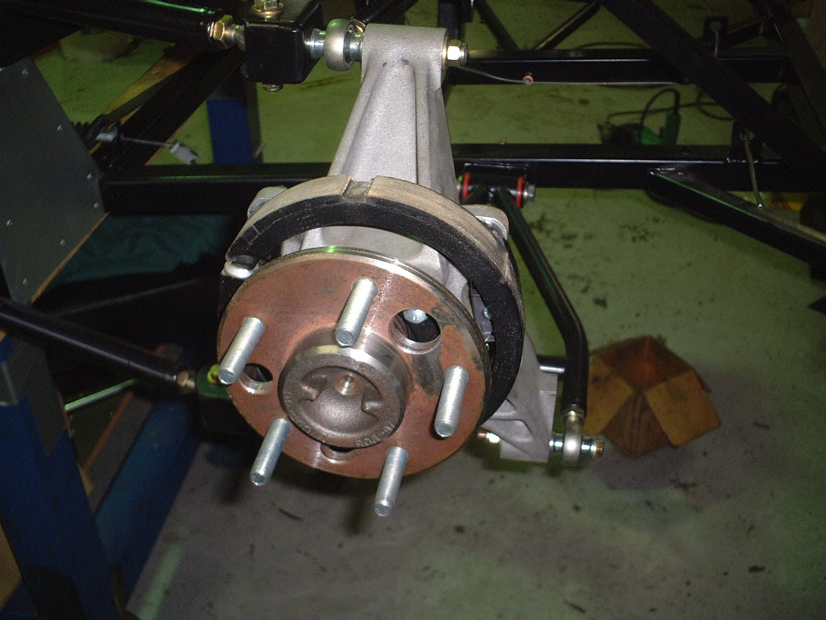

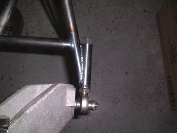

The suspension adjustment for wheel alignment purposes I found was not easy as it requires you to remove the through bolts on the rose joints to make any adjustments.
This meant while on the wheel aligner removing the aligner jacking the car to take the bolts out & make an adjustment, put it all back & if its not right do it all again.
This was made worse by me sheeting the front completely.
I remade the lower rear arms ,rear links & upper front arms all with adjustment.
The arms have 4140 tube nuts going into the rear of the rose joints.
You don’t even have to jack the car.
The arms are raw in pics im going to silver zink & debritalize.

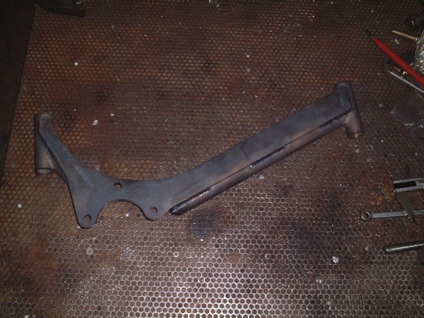

RF105 upgrade parts
Rear lower arm.
4140 bolts go through the back.
RF105 upgrade parts
upper arm in raw form,ready for plating.
Ends have been made to allow for tube nuts.
