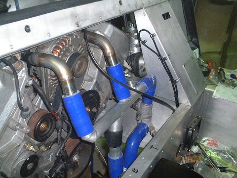

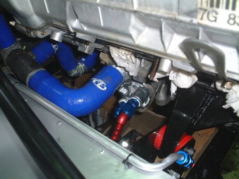

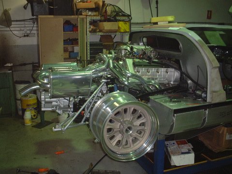

Cooling system is done just waiting for some hose.
Modified the a few STD items on the engine to do the job (outlets mainly).

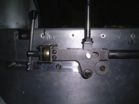

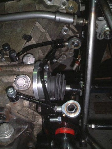

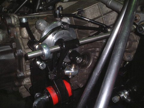

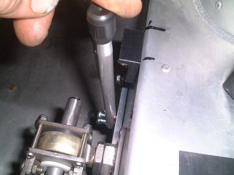

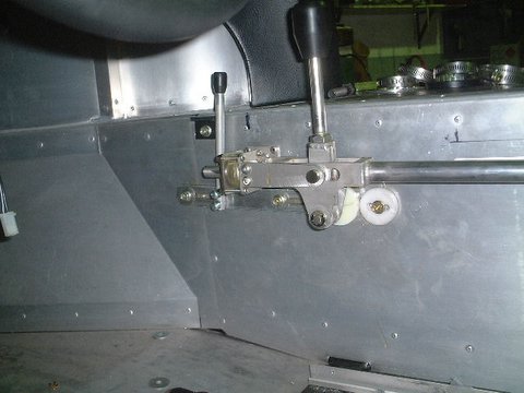

Made the gear lever and linkages.
Firstly made the housing and shaft to get it to exit on the driver’s side.
Brackets to mount rose joints then I filled in the gaps.

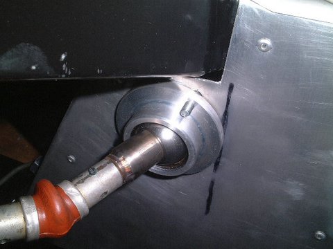

Made a housing on the back with a sperical bearing to allow for the shaft motion.
I made a rev lock out it is in the form of a bolt action and it worked out well.
The small lever is sprung loaded and allows you to move it either side of the block.

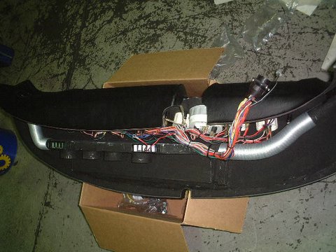

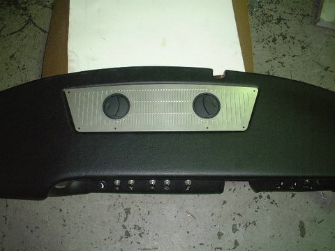

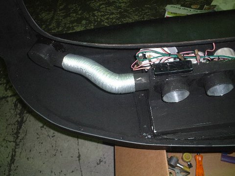

Made a plenum for the heating to go into the back it was a little tricky as it has to clear all the instruments and the chassis.
The plenum allows me to pump straight into from the heater a /cond and it goes to the vents from their.
This has allowed me to turn side and floor vents off and pump everything to the screen.
The top grill I had laser cut to suit 2 Toyota vents.
These allow me to direct onto the screen and shut off if required.

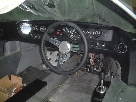

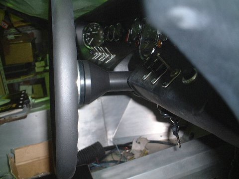

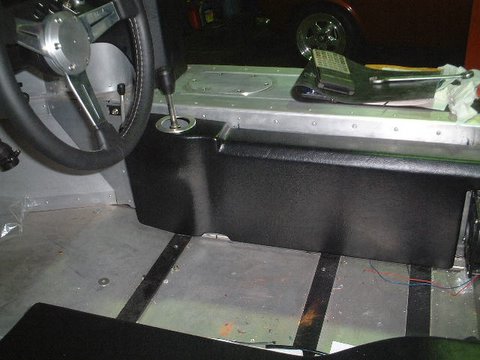

Had the dash covered.
The instruments are VDO and I had them refaced to Lucas.
Chrome bezels replace the black, you cant tell.
A good friend made the steering shroud out of Delrin , he told me I was not smart enough to make it so he would do it for me.
He made it an extremely tight fit around the column ,he had me put it in boiling water then fit it over the tube, it is on so tight it will not budge and it looks perfect (thanks Jake)
Another friend (thanks Stuart) offered to do the wiring and has done a fantastic job.
Milspec style plugs and the part that got me is other than ground wires he has not repeated any colours.
The centre console and gear selector panel I had covered (vacuum formed).

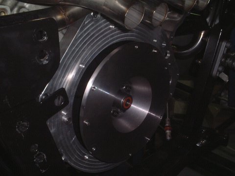

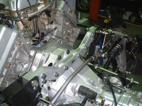

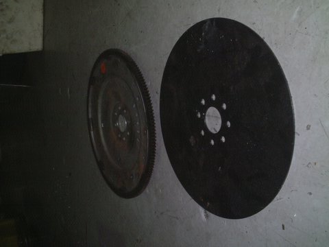

I drew up the conversion plate and flywheel and had Flatchat(Cris) make it and he did a fine job.
I made the drive plate as it was flatter than the ford item.
The bearing I messed around looking for something that would suit my clutch but it was not going to happen.
The Audi bearing is flat and my clutch p/plate requires a radius bearing face so I made a snap on extension to fit the original bearing then used Loctite to bond it on.
Sometimes the simplest solution gets over looked but i worked out fine.

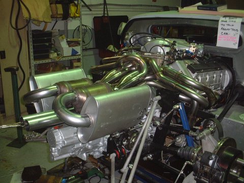

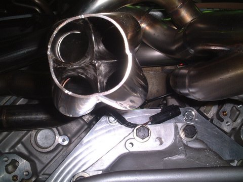

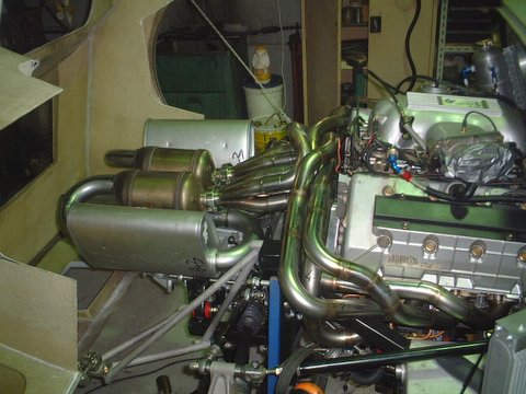

Built the exhaust.
I did a piece in the how to section on making these collectors.
I didnt take enough shots of the system being built, you get busy and you just dont.
These are before coating.
2 cats
tripple pass mufflers to get its db for RTA requirements.
I passed the pipes under the cats to try to give it some reasonable look.

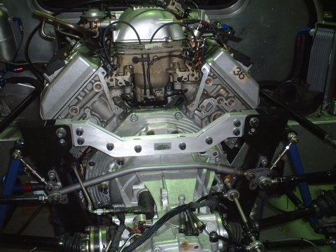

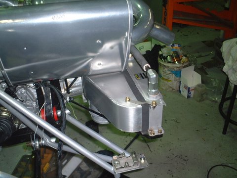

After finishing the exhaust I realized that to pull the gearbox you have to pull all the pipes because the c/member between the shocks drops into the chassis from the top.
This seems an ok method until you start to fill the spaces in.
My solution was 2 alloy blocks,2 alloy plates with spacers.
This can be dismantled in the car with the exhaust on.
Take the rear mufflers off remove the member and the box can come out.

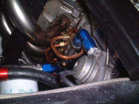

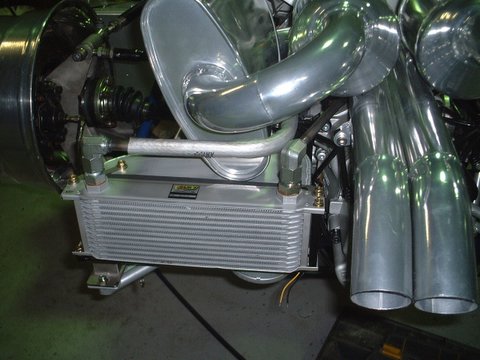

The EGR will be controlled by the ecu.
This info was passed onto me so I am going to give it a go as I have nothing to loose.
The theory is cool the exhaust gas pre sending it into the intake manifold.
It will help drop the NOX,this is one of the gasses that the threshold has been lowered in the IM240 test so I will try anything if it will help.
I will be running the EGR gas through an oil cooler to drop its temp
The cooler has an independent fan as on the dyno it will get little air flow.
I am going to cover the cooler on the dyno to see what the reaction is just for interest sake.

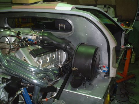

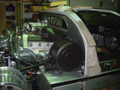

The air filter I looked at for a while and made the decision that it wasn't worth making.
I got my hands on a 2nd hand air box out of a Toyota L/Cruiser 80 ser.
I cut and modified the outlet ,filled holes , cut off brackets ,made new brackets , repainted and it only took about 12 hrs.
Its a good size filter and to be honest I don't mind the way it looks , it has an old school look about it.

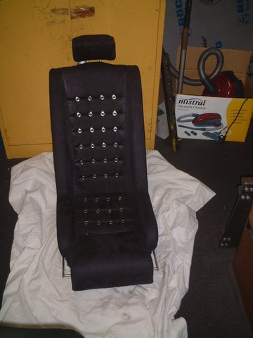

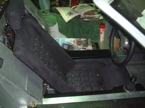

After 2 years the seat are finally finished.
The 2nd upholsterer after several pep talks and some of my best motivational speeches to date.
I selected a foe swade ,black and I have to say he did a great job.
Thanks Mike they look very classy.
