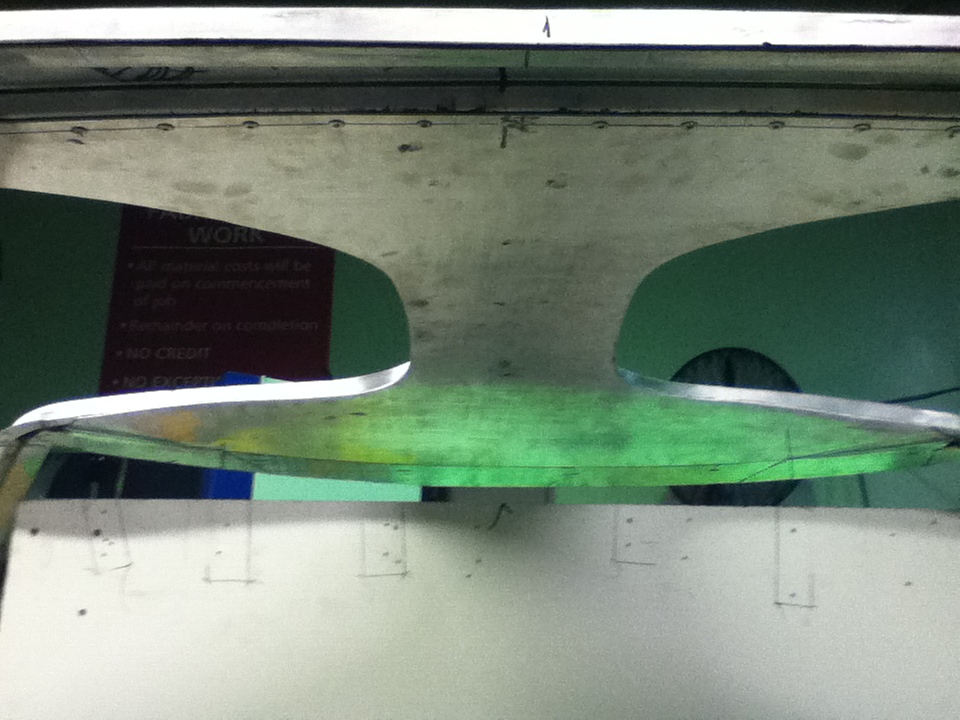

Fitted the liner and bonded/rivited it in.

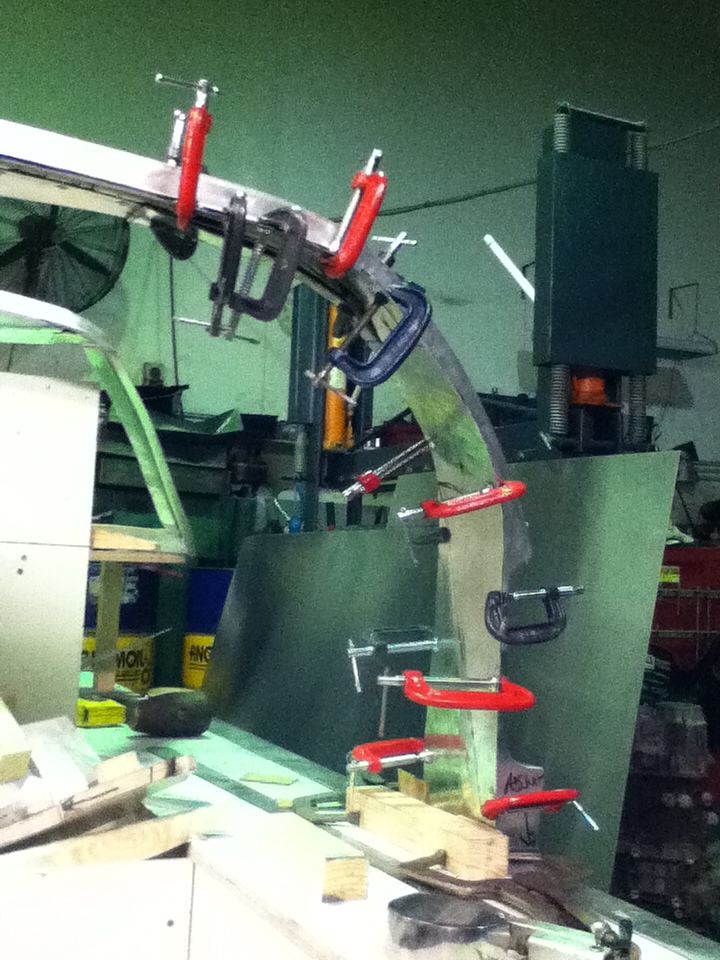

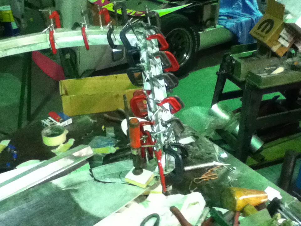

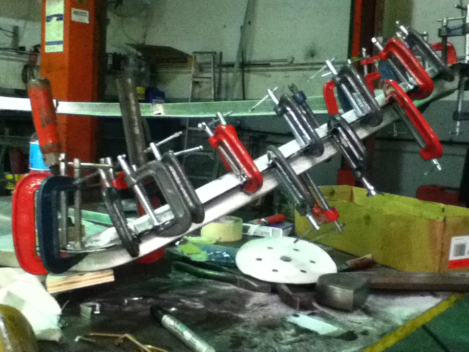

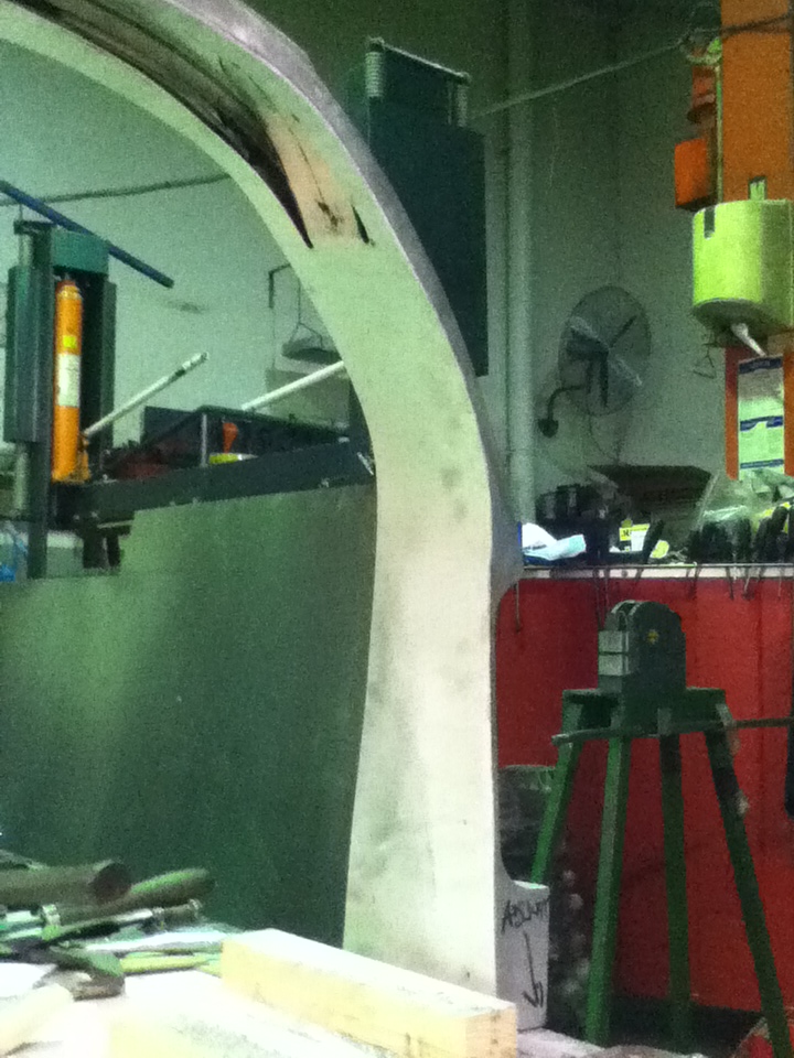

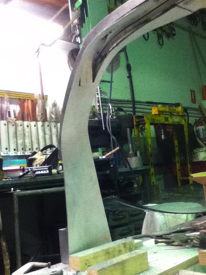

Made the inner B pillar sections and also bonded them in.
This has made a huge difference to the rigidity of the turret.
When I glued the inner B pillars I had to make sure I set the distance between them pretty close as it has taken the flex out of doing adjustments after the fact.
I cut the sheet at the top so it has a tongue and it bonds to the rear chassis channel just to try to tie things in as much as possible.

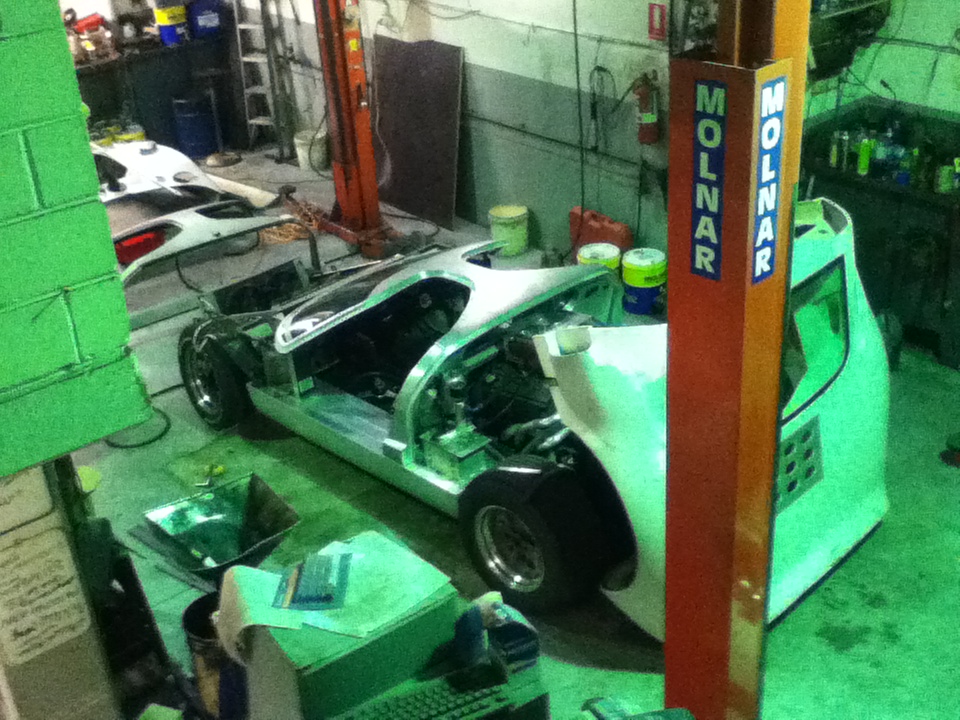

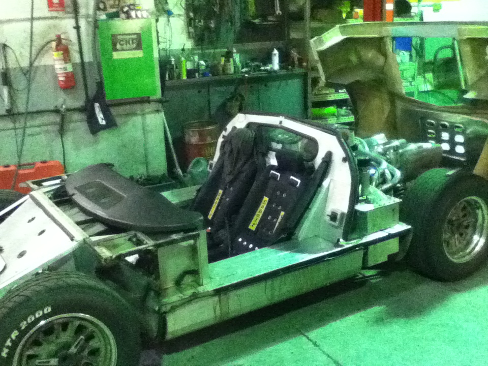

Body work was removed this morning for the big fit up for the turret

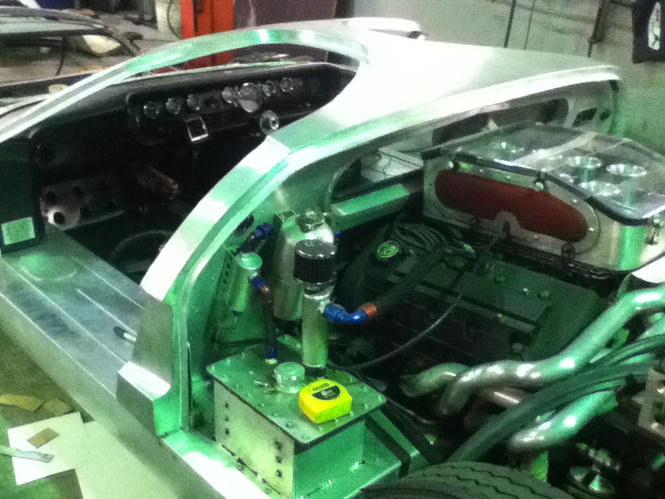

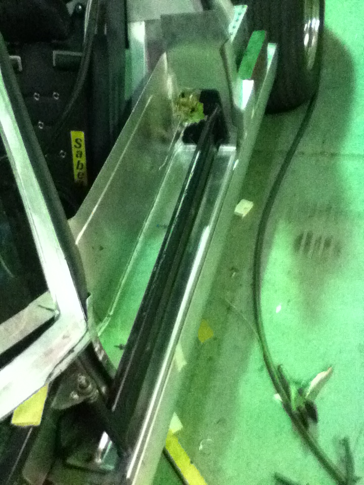

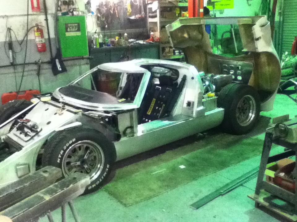

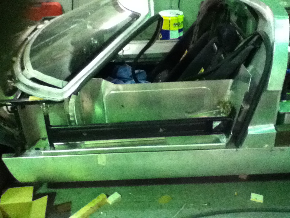

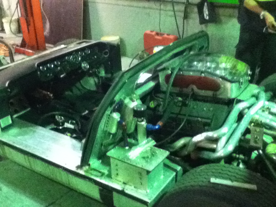

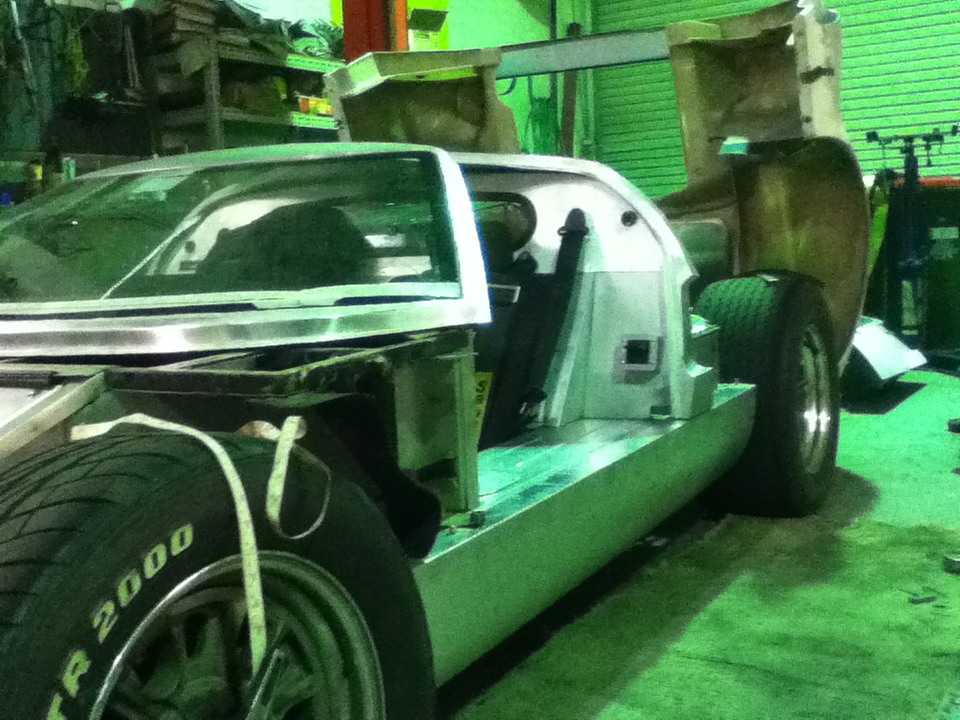

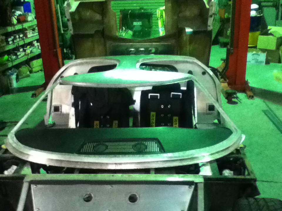

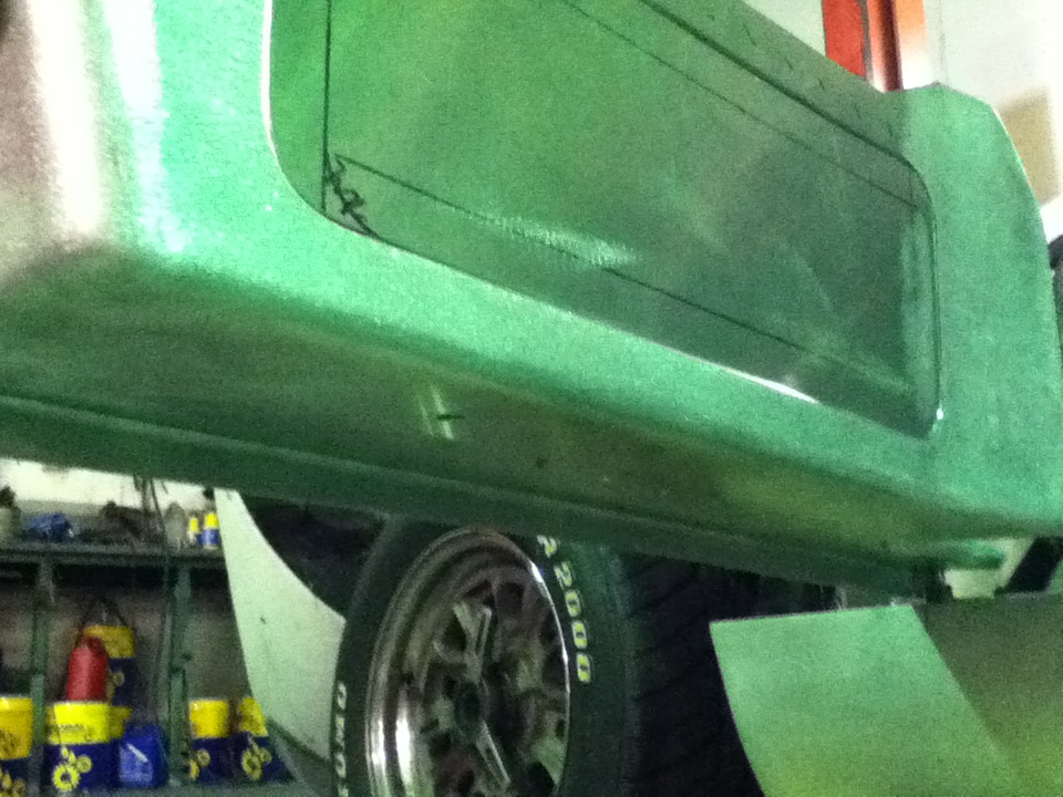

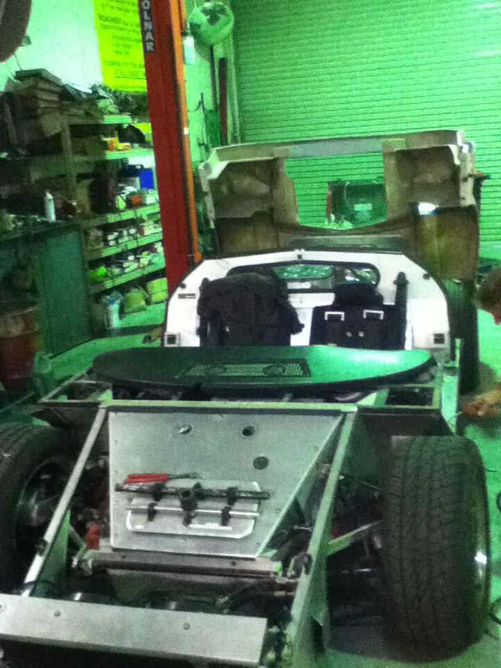

The body came off the buck and went on the chassis.
This part I have been a little anxious about, you can do all your measuring you like but you can still get caught out by small details.
Sills fitted up magic.
The roof fitted perfect , a little bit of height adjustment will need to be done around the L/H side of the screen to dash clearance.
The dash height must be slightly higher on that side as the metal work on the screen apron it all good.
Sorry about the quality of pics ,it is of my ipod, camera died.

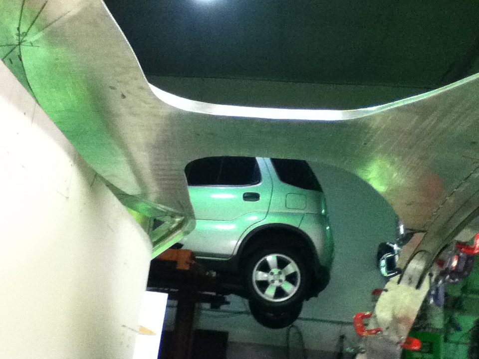

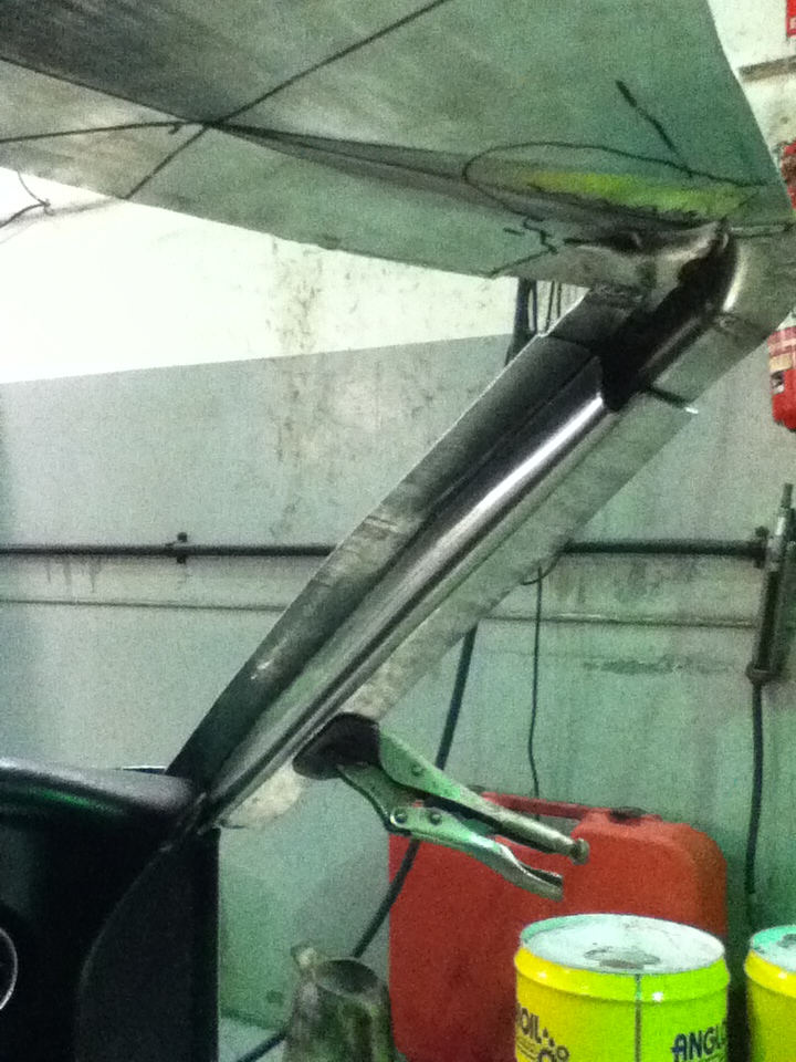

The reason I did the fit up is to work out the amount of space available for the inner A pillar shells.
I folded a sample to check the room as it travels down next to the dash.
I had to finalize the location of the wiper shaft on the front apron.
Also I need to work out the space between the back of the dash and the lower screen support as it will be double skinned as well.
That’s all I have at the moment.
Jim

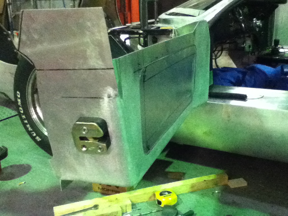

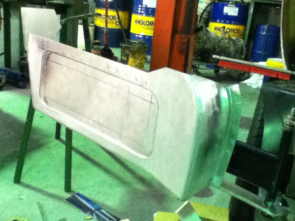

I had to think about how to make the doors.
I started makeing a jig them realized it was a waist of time other than welding the floor and the inner panel.
So I am pretty much free handing it with out any jigs.
I wanted fairly decent radius's on the corners as it would give it a more authentic look.
Put the step in for the door pockets, I will cut them out when the welding is finished.
Jim
