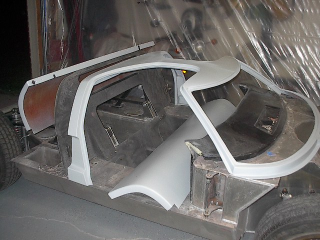

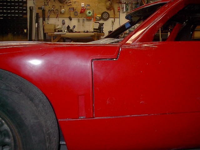

I have finally gotten back to work on my car. Fran got the hinges to me a couple of weeks ago and I have finished mounting and fitting one door. The other door is mounted but not fitted yet. The gaps are pretty good. It took quite a bit of patience to get the doors properly trimmed but I am happy with the results. Here are a couple of shots:

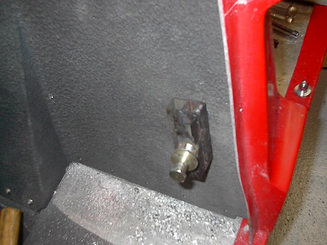

Stiker Plate

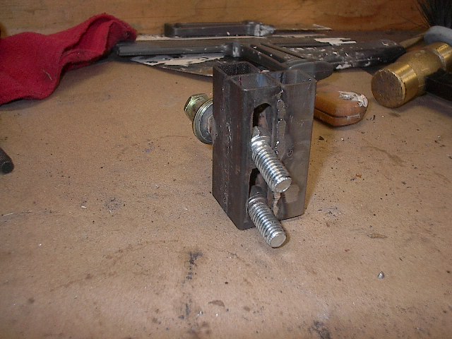

I had to shim the door striker out 2 inches so I built the shim to allow adjustment. The shim has a vertical slot and the firewall has a horizontal slot for full adjustment. Here are some shots of the striker:

Nice work on those and it looks like some progress is being made. I'm waiting for the 1/2 shafts too, but I know those have been delayed and will be along shortly. They don't hold anything up though. Is your 016 stock?
Dutton
Nice touch on the striker alignment, Jonathan.
If you don't mind, set aside those notes you pass along to Bill... your coaching will be darn valuable in my garage, too!

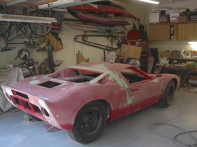

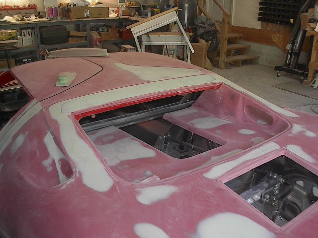

I have not posted for a while but I have been hard at work. I have most of the bodywork done. I should have the car in primer within a week. Here are some photos of my progress on the bodywork.

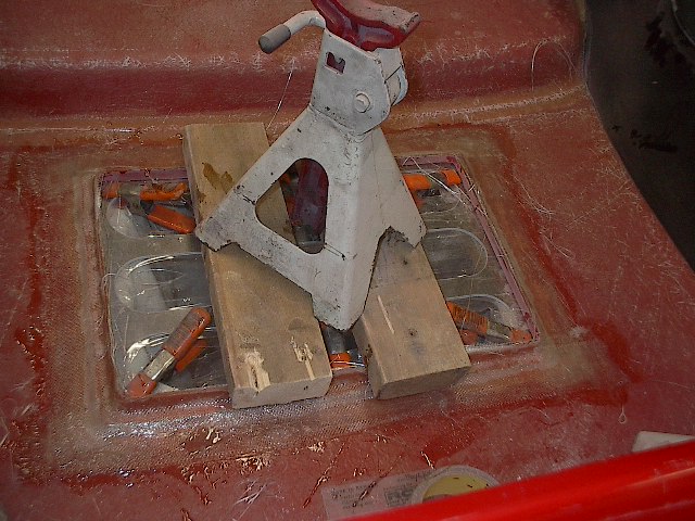

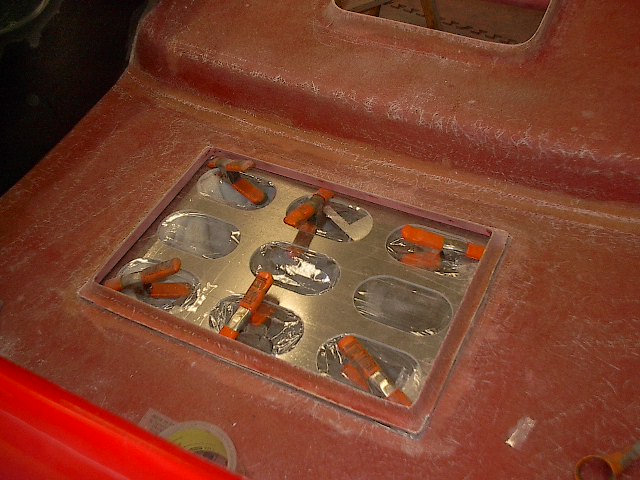

I decided to modify the rear deck so that the plate would sit flush. Fran supplies a cover cut from plate but the deck is taken from an original car so it is set up for sheet metal. I cut out the lip and reglassed it to get a deeper recess. Here is a shot of the progress:

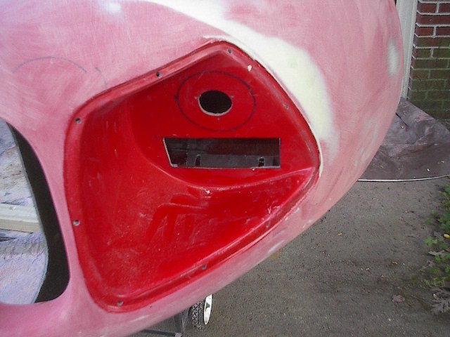

I also did the cutouts and fabricated a mount for the fog lights. Here are some pictures (the front clip is upside down in these):

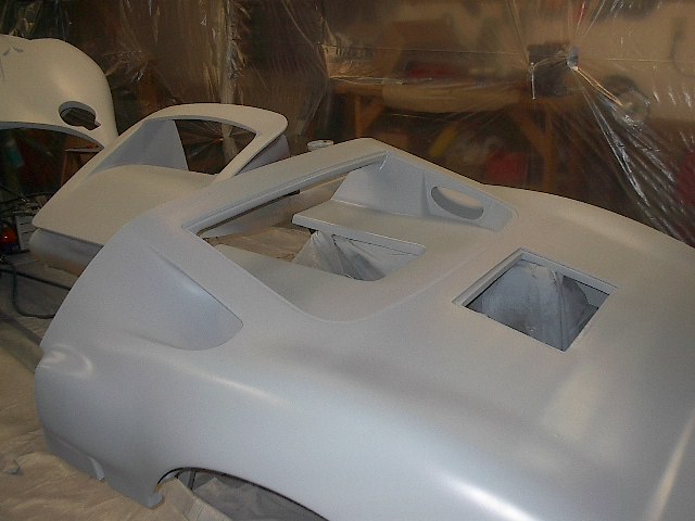

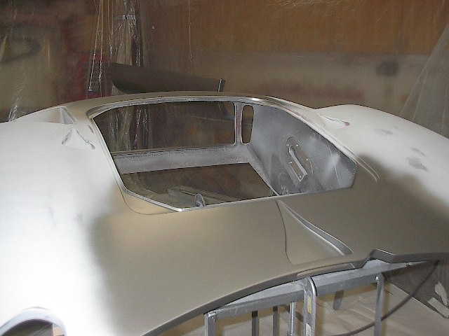

I finished priming the car. Here are some shots:

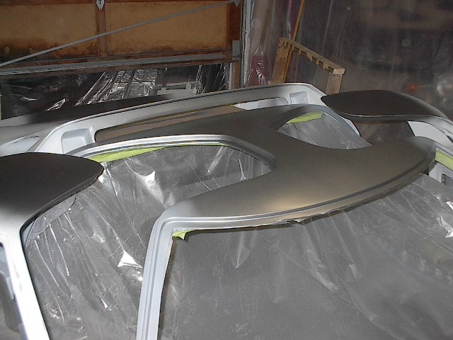

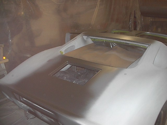

I started painting today. I put down the silver for the stripes. Here are a couple of photos:

As far as body prep the panel alignment on this car was incredible. Misalignments were so small that almost no filler was needed for panel alignment. There are a few places where the body gets a little wavy. If you go to my web pages you can see shots of the car with body filler on it. That is a good guide to where my body had waves. The toughest part was getting the back of the spider to match the door and rear clip. This part seems to have gotten a twist to it after it is pulled from the mold.
As far as special tools nothing fancy is required, its just lots of sanding. I only use DA sanders and air files early on. Once I have the gel coat scuffed I go to long boards. I only use the power tools on the primer if I have a lot of orange peel to knock down. The AFS boards are really nice when you are blocking out the car.
