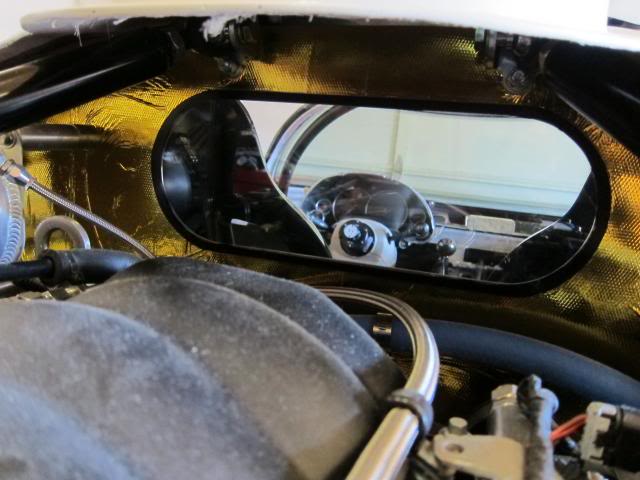

Ken, where did you get the rear, circular bulkhead window? A quick google search did not turn up anything, and it seems like a very practical addition.

I had it cut from safety glass purchased from a local auto glass franchise. The glass overlaps the hole cut in the bulkhead by about 1/2 inch all the way around. It is held in place with urethane like a windshield. There is no rubber moulding.
Be prepared to mount the rear-view mirror on the dash as that is the required angle needed to see over the lip spoiler on the street tail.
Here is a close up picture of it for you...
Very cool! Thanks for the info and the pic. You said that you didn't use rubber moulding. What did you use to outline the window in black on the engine side of the bulkhead?
Did you blacken the extra 1/2 inch you left on the glass? It's a super clean install and I thought for sure it was rubber moulding.

The car isn't licensed for the road yet. The rear window is functional though. The rear view mirror must be placed on the dash to get an upwards view over the rear spoiler. You most definitely can see cars behind you. At least their front bumper :thumbsup:
It's also kinda cool seeing all that horsepower right behind you. It gives the cabin a little less claustrophobic feel too.
I'm in the process of finding a mirror that is appropriate. It must be about 6 inches wide at the most. I tried using my fancy C6 Corvette auto dimming and compass mirror but it's just too big and bulky for sitting on the dash.

What did you use to hold the rear window in place while the adhesive was setting up?
Will the window adhesive tolerate the heat generated from the engine side?
