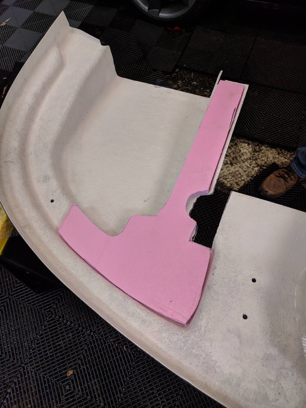

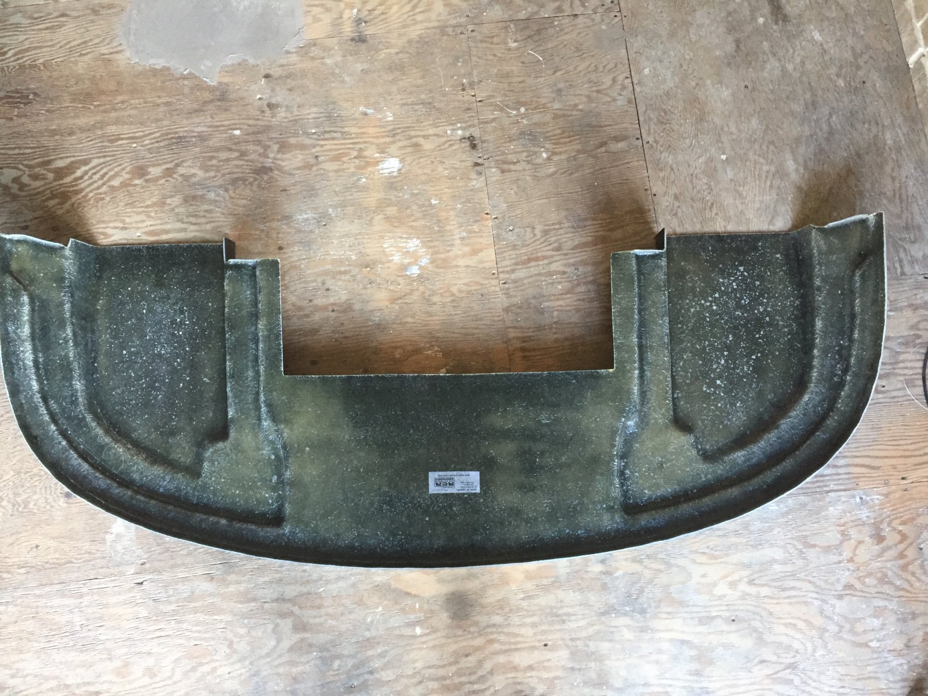

Can anyone show me a picture of the bottom side of your track splitter? I'm wondering how to shape the bonded in wood needed to strengthen it.
Here's how I did mine. Foam carved to shape, later followed by a couple of layers of Kevlar/CF fabric.
If you use wood to cover the entire lower part it destroys the aero designed into the splitter.

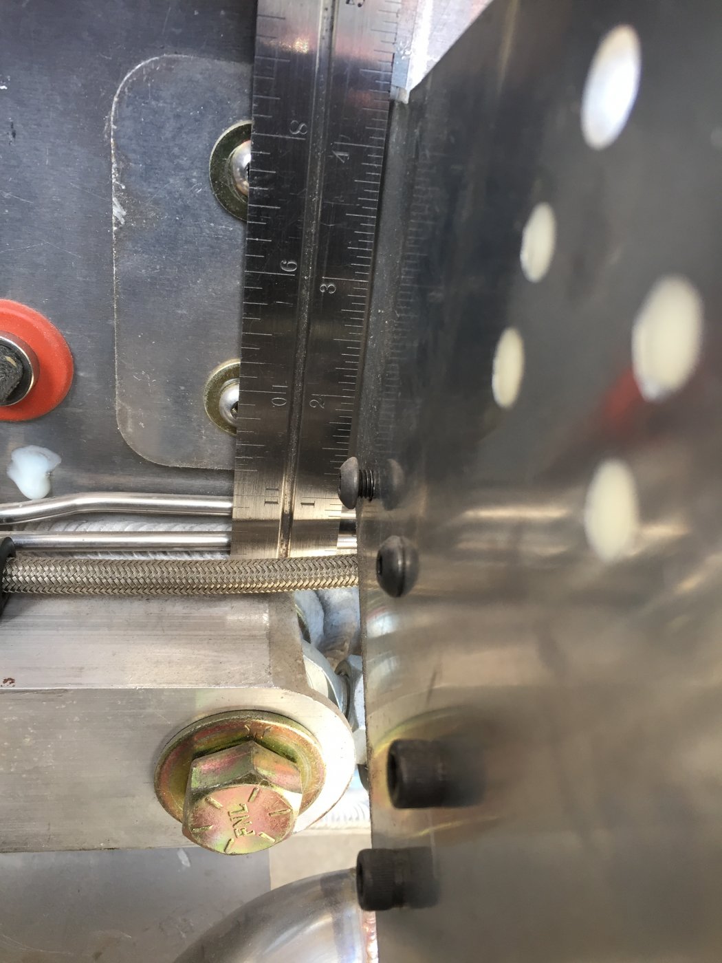

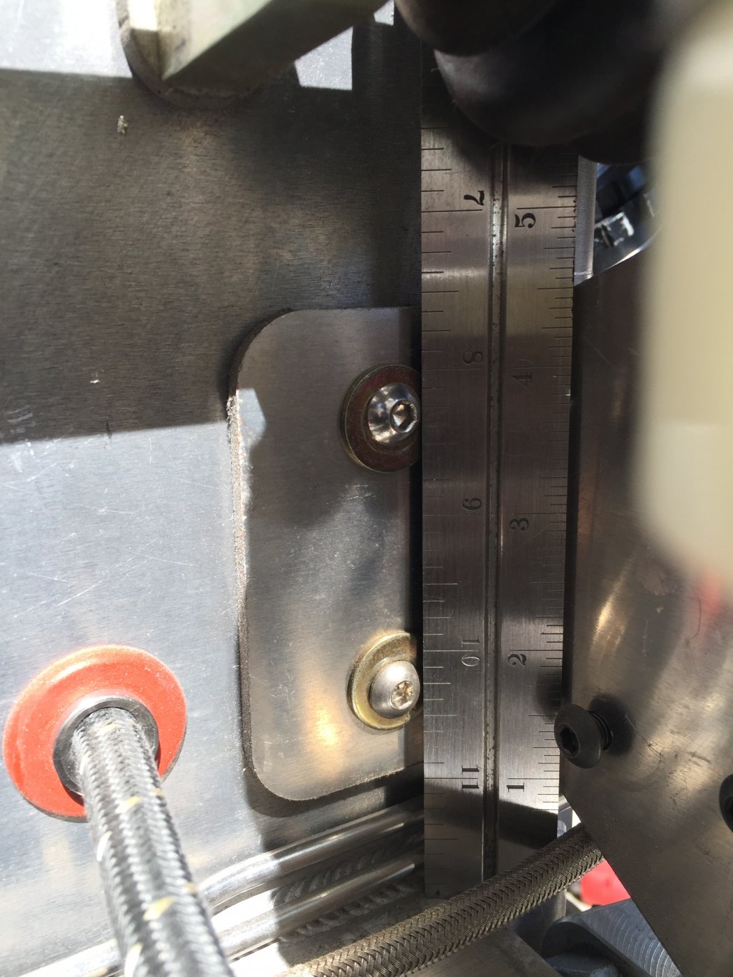

The nose of the car always seemed to be on a slant down (side to side) towards the drivers side as shown in this picture. I verified it by taking a measurement with a steel ruler resting on the square aluminum tubing and measuring up to the bolts that mount the vertical supports at each side of the foot box. The passenger side holes in the front wall of the foot box were spaced at 2"and 4" above the square tubing. The second picture shows the spacing on the drivers side. The holes are spaced at 1 11/16" and 3 11/16". Taking measurements of the difference in heights of the vertical nose plates from one side to the other also confirms the same thing. Pretty upsetting that I have to disassemble everything to repair this. Not happy at all having to do this. I read recently that someone with a GT-R had the same problem. The factory should be using a jig to locate these holes as it's important for the fit up of the the body parts (splitter and nose bodywork).
Can anyone else confirm what their measurements are?
Look closely at the top of the vertical plates and at the front upper suspension arm steel U brackets. You can see that the drivers side is lower by almost 3/8". I took measurements three different ways and they all confirmed the same thing. Check yours!

Ken, I got the same freaking problem as bad as yours. Not happy at all about it, such a simple quality control issue that should have been done.
I am hoping that I can fix it without taking everything apart. We will see.

I redrilled my holes for larger fasteners Hector. That way I was able to correct the mistake without welding the holes closed first. Glad to hear you caught the mismatch at this stage.

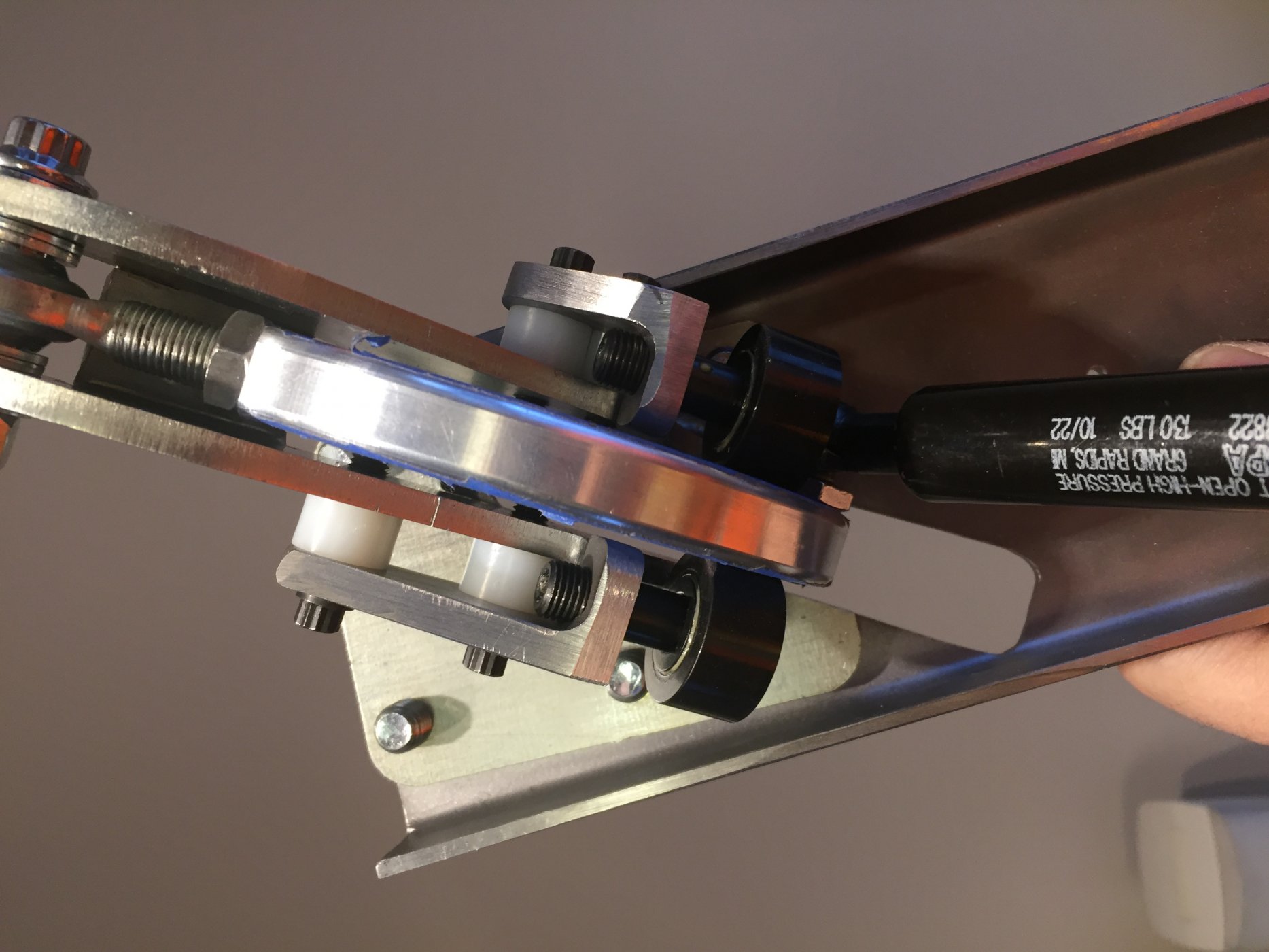

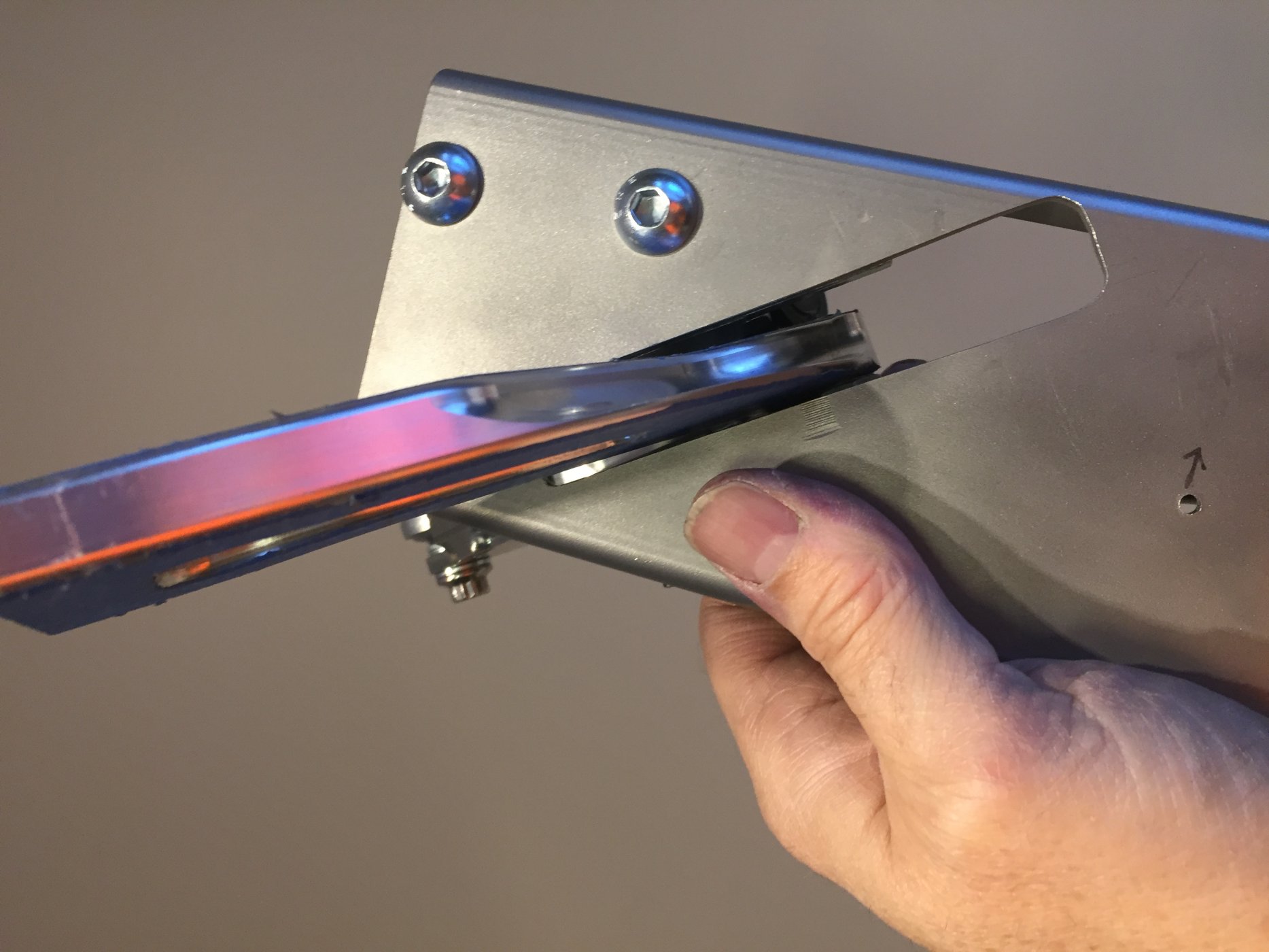

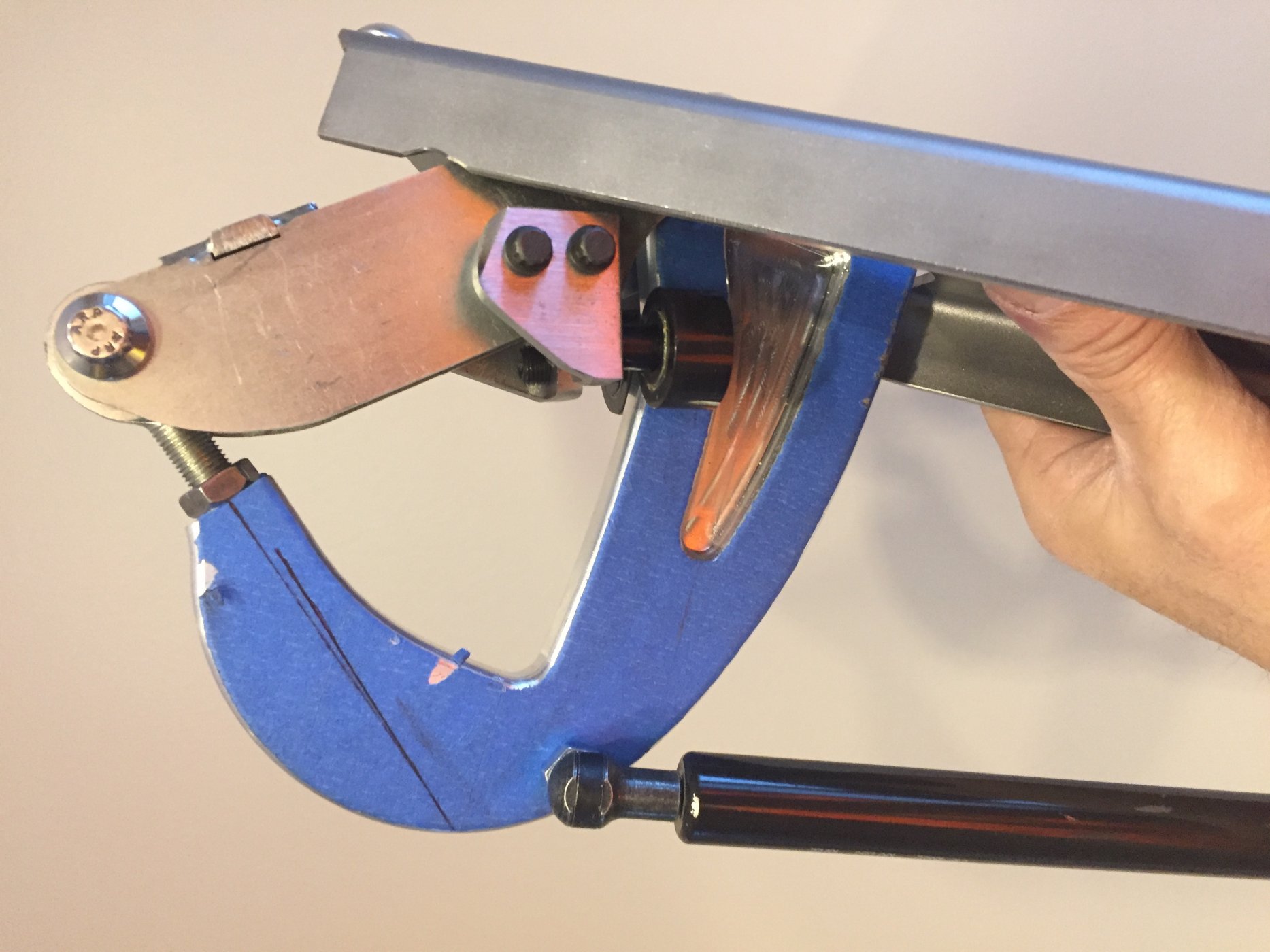

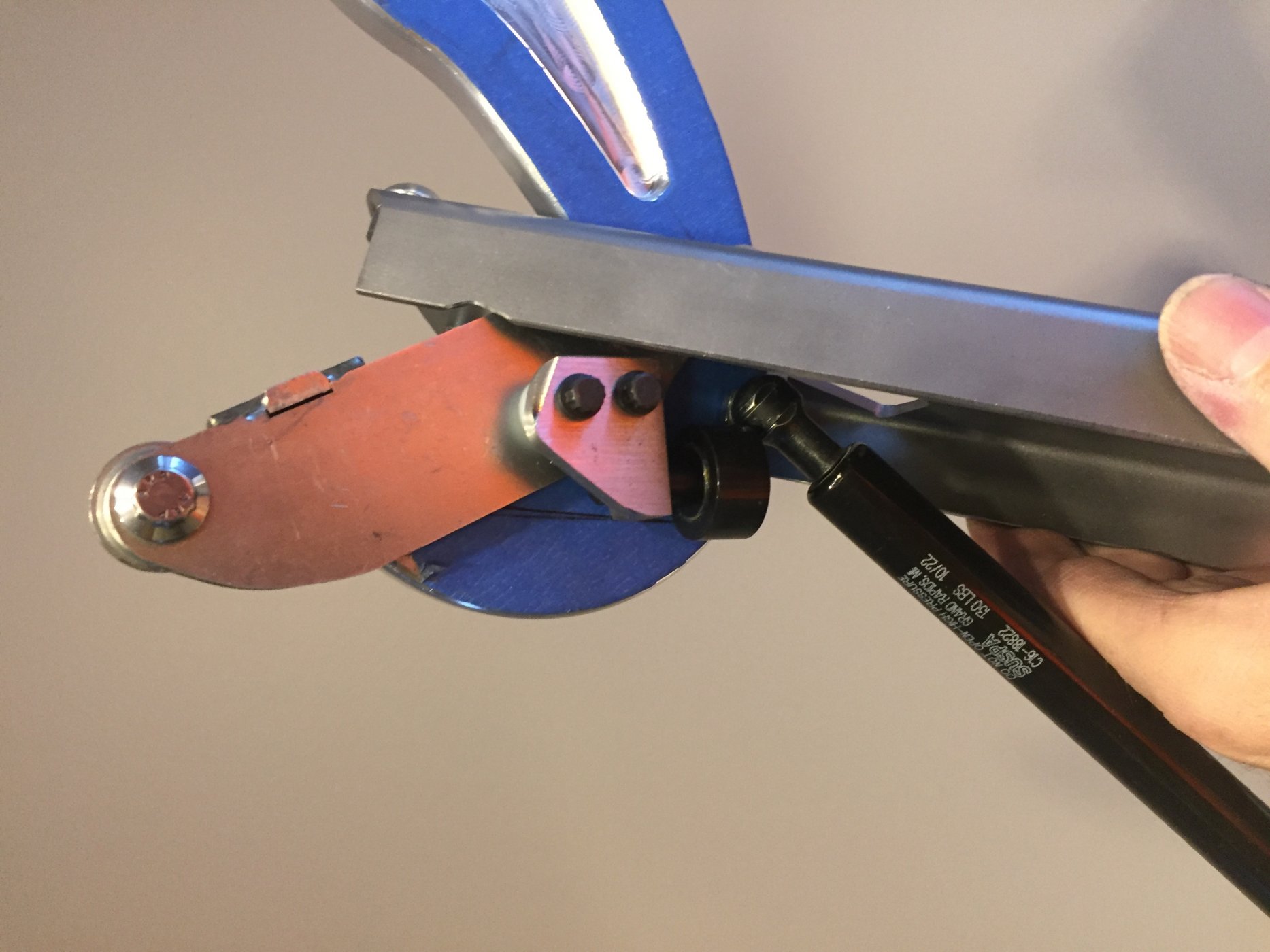

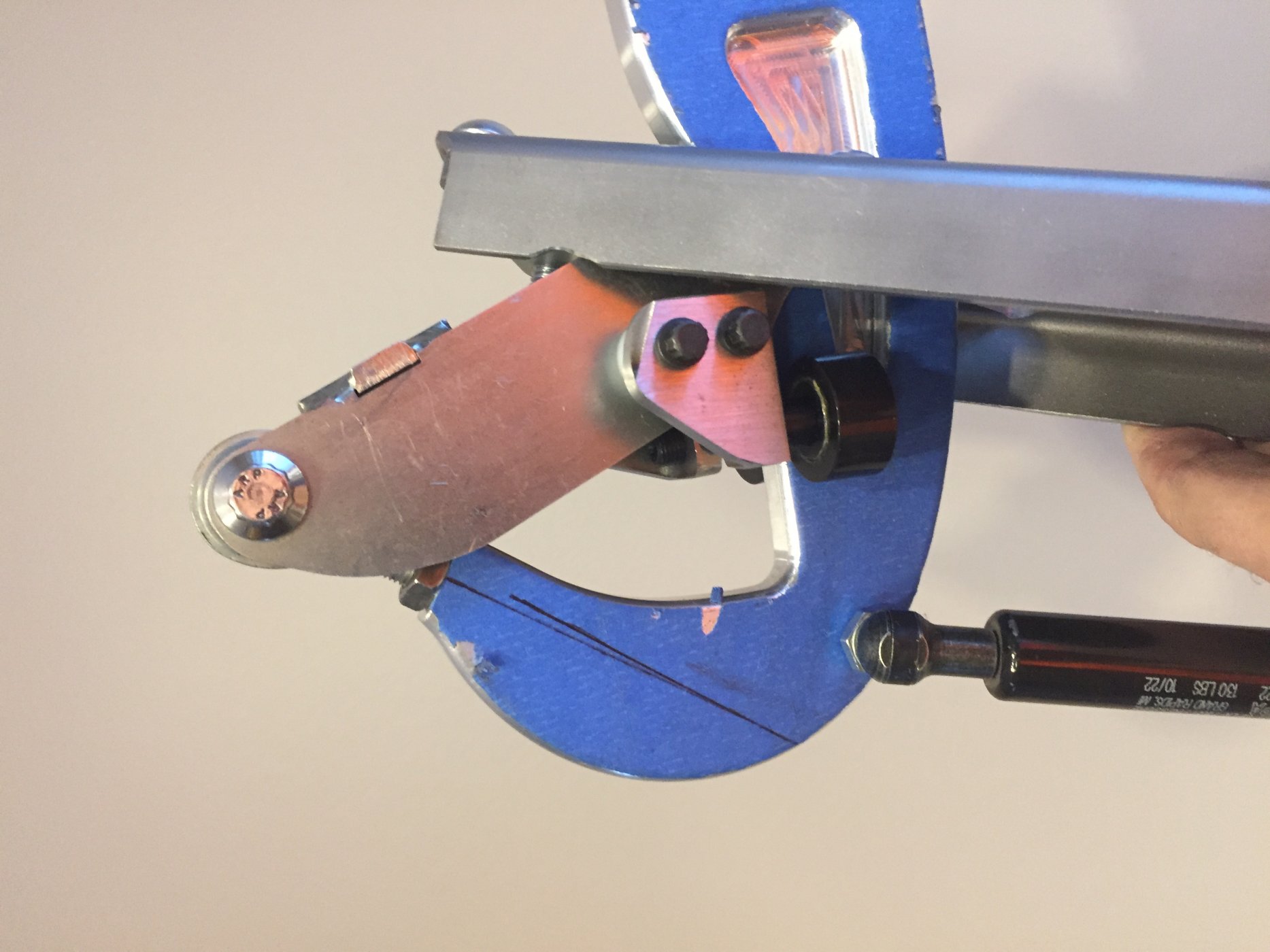

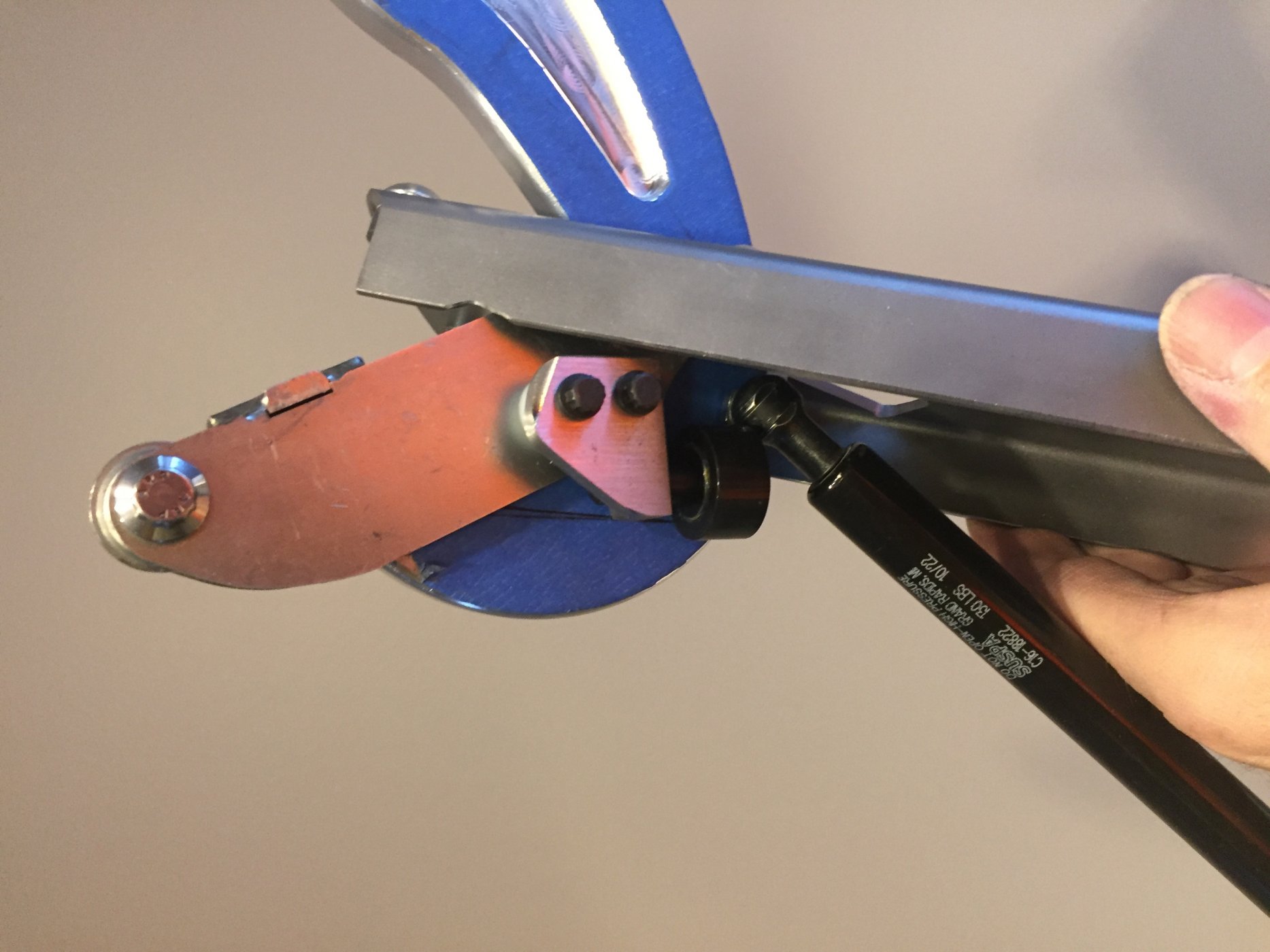

I modified my door hinges to eliminate the grinding sound. The hinge arm is now perfectly centred in the bracket as it swings through it’s arc. Two bearings with rubber treads were used. I was careful to make sure the strut end cleared the outboard bearing. The outboard bearing bracket had to be smaller to clear the fender obstruction. The nylon standoffs will be replaced with steel versions upon final assembly /install.

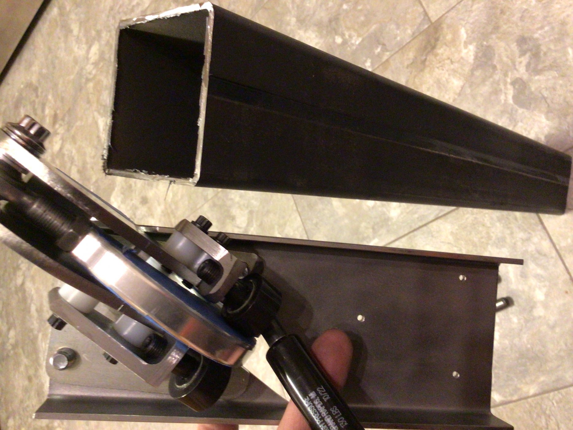

The stock hinge bracket mounts to a large steel plate now to help spread the load out over a larger surface. The two plates were cut from a one foot length of 3 1/2” square tube. The C channel shape gives it additional strength. The extra large slot cutout by the factory really weakened that area.

I modified my door hinges to eliminate the grinding sound. The hinge arm is now perfectly centred in the bracket as it swings through it’s ark. Two bearings with rubber treads were used. I was careful to make sure the strut end cleared the outboard bearing. The outboard bearing bracket had to be smaller to clear the fender obstruction. The nylon standoffs will be replaced with steel versions upon final assembly /install.

Great design Ken, another project to my bucket list, the list is getting awfully long , LOL.

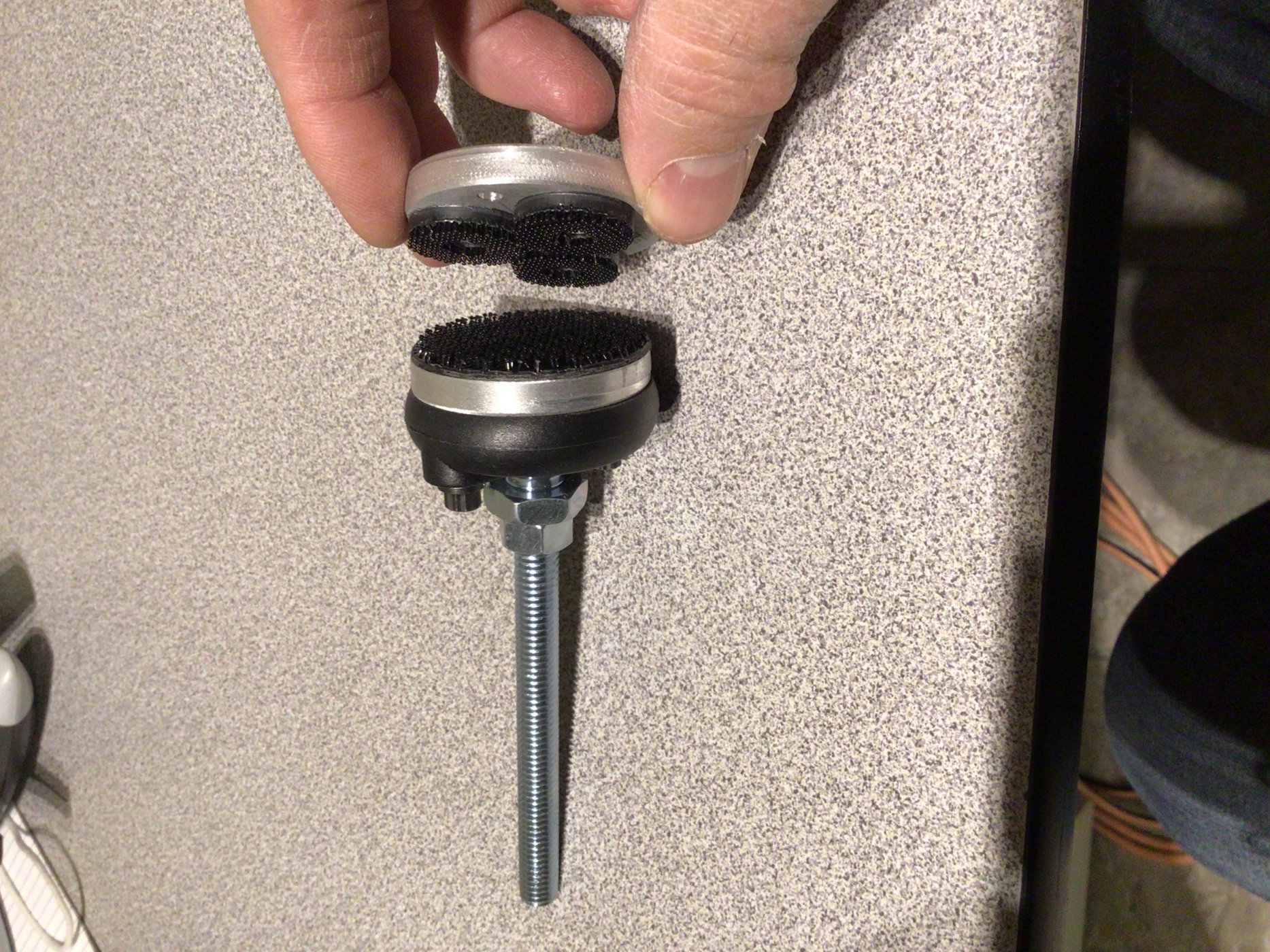

I’m taking a slightly different approach to mounting my dash. Six threaded posts will be located/bolted on the top of the foot box (their height will be adjustable). They pivot and have aluminum discs fastened to the top with a industrial type of hook and loop material bonded to the top. Each post will mate up to a aluminum disc with the same hook and loop material on them. These will be bonded to the bottom side of the dash. I’ll be able to adjust the dash for warpage and set the height of the dash accurately this way and in the future if needed. This type of industrial fastener by 3M is used on the plastic interior panels of GE locomotive cabs. I might even use this type of industrial hidden fastener on the interior door panels in one spot.

My hvac anchor is mounted on threaded rods. I had to bond a aluminum base to the anchor so it can function on it’s own. Once the dash height is located correctly then the anchor can be adjusted up till it just touches the defogger slotted holes on the bottom of the dash.
Super cool idea. Never knew about it . Lerners something new everyday in this forum . I can think of a few places where this is helpful . The versatility is very very helpful .
