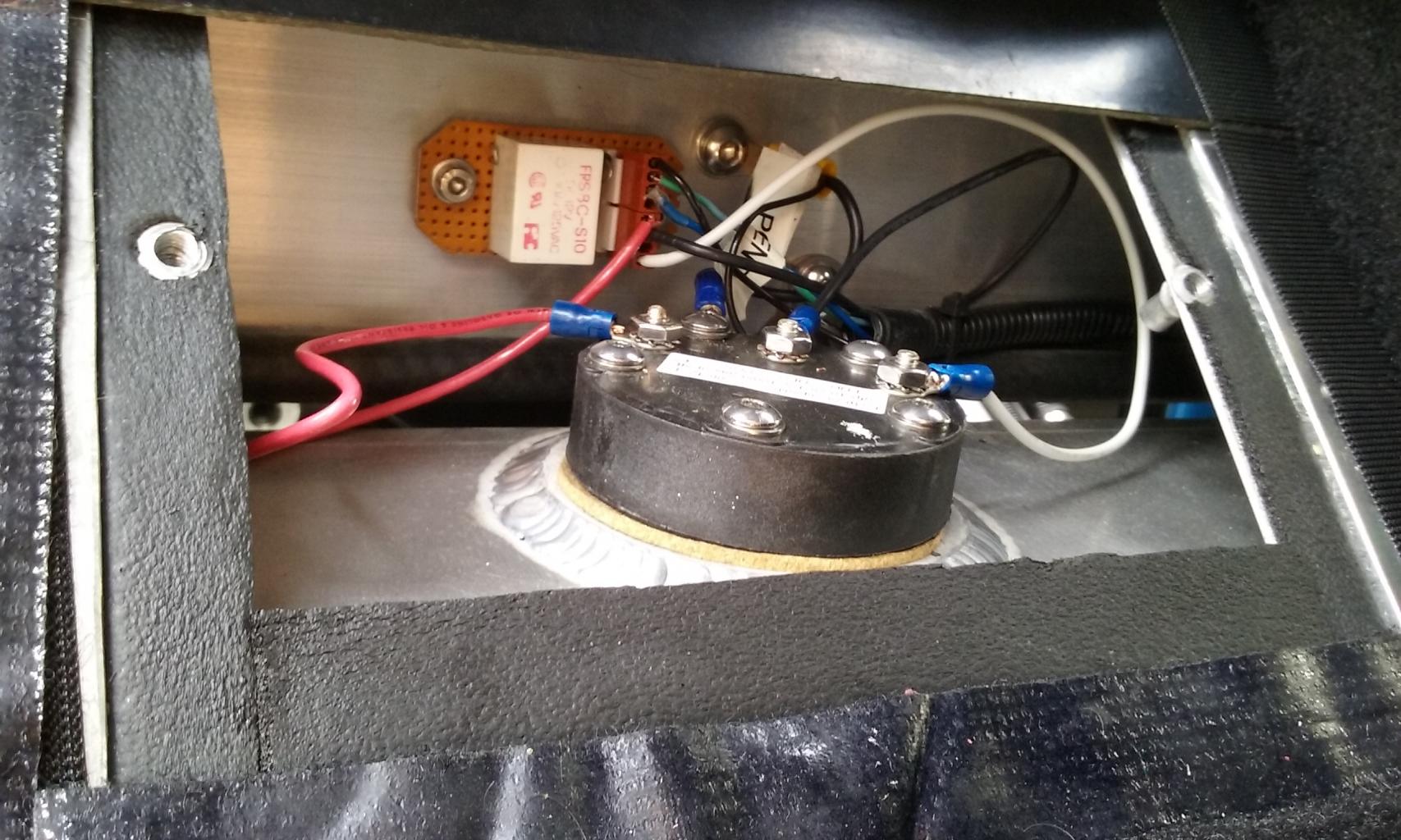

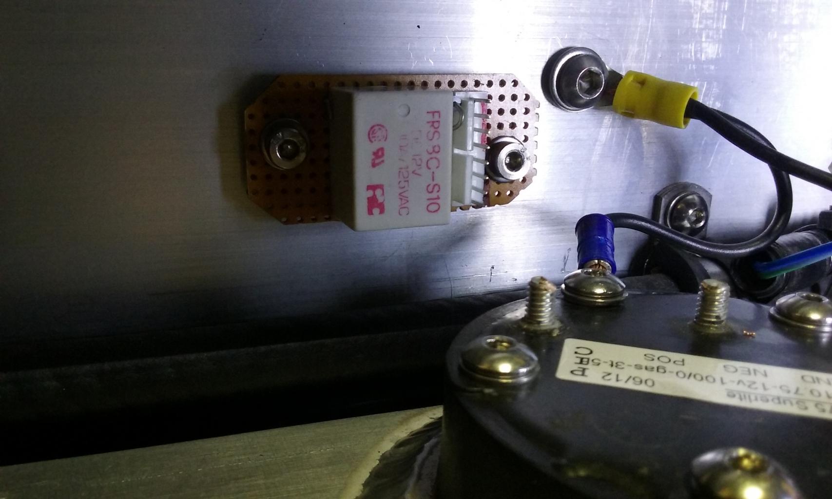

I had my sender wired to operate only with Ignition ON. I isolate the battery when the car is not in use. The SEND signal is connected to the KOSO. I learned from Joel that the KOSO SEND port has a 5Volt pull-up and so when the KOSO is booted that signal appears at the sender. The sender is calibrated by jumping the NEGATIVE and SEND contacts and will set the fuel level it sees at that time. It seems that this is what happened at KOSO boot up, but not all the time (it's microelectronics so can be a timing or a set of cirumstances thing, believe me). I now feed the SEND signal through a relay that it powered by the POSITIVE signal to the sender so isolating the SEND at KOSO boot up. The following are the notes from my problem fixing file.

Relay with diode isolated coil for SEND line to isolate during KOSO boot and avoid possible calibrate.

PeteB, your sender is probably set at FULL when the tank is part full. If you can easily get to the SEND line from the sender, at the KOSO or elsewhere, why not fill the tank then do a calibrate as I described using a local Ground. Then put the SEND through a relay, which does not have to be right next to the sender like mine. Your EMPTY setting should still be valid. It should work for you.
