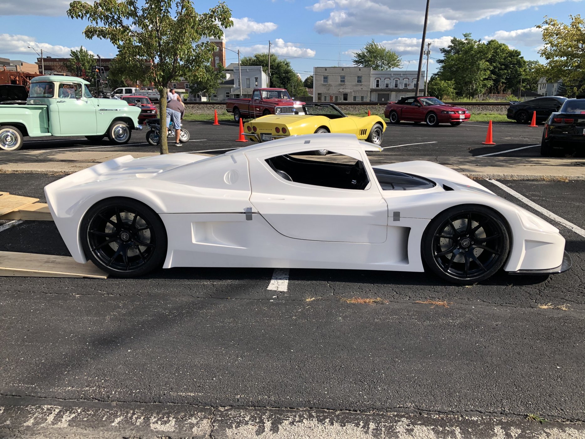

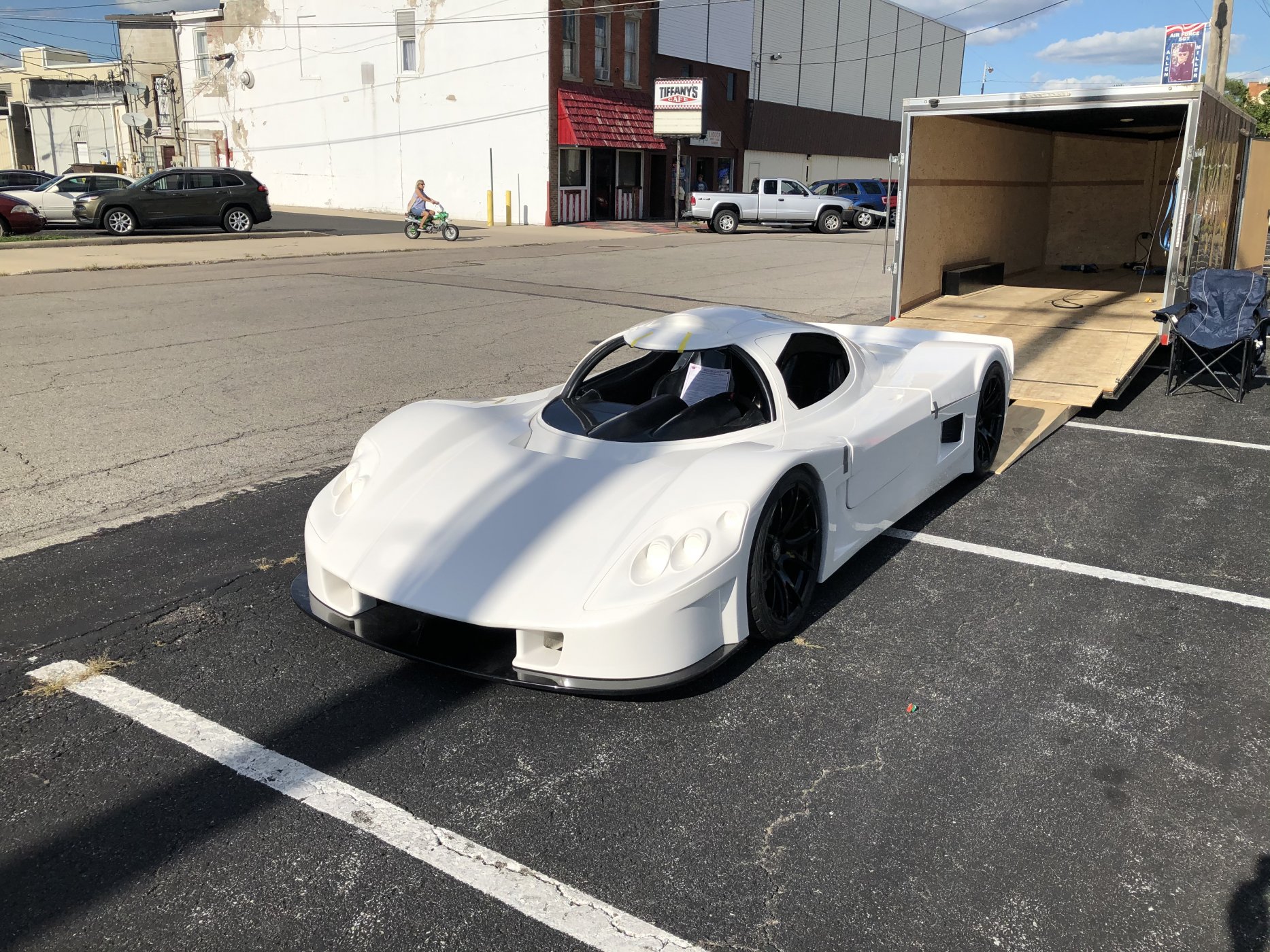

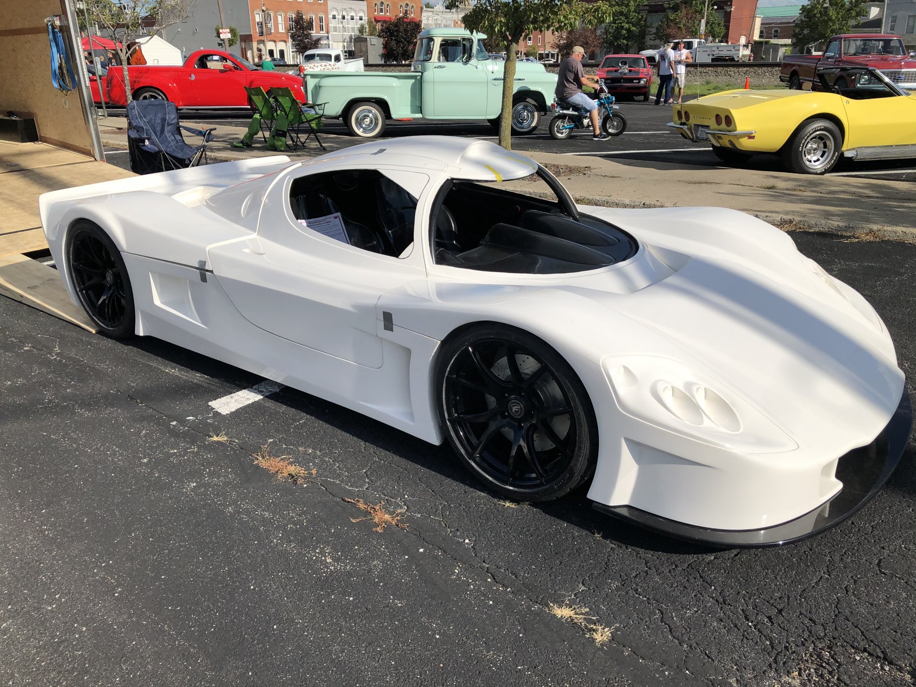

Couple of pics of the cars first time in the sun since bringing her home from RCR (these are from as soon as I rolled it out of the trailer, the crowds gathered soon thereafter):

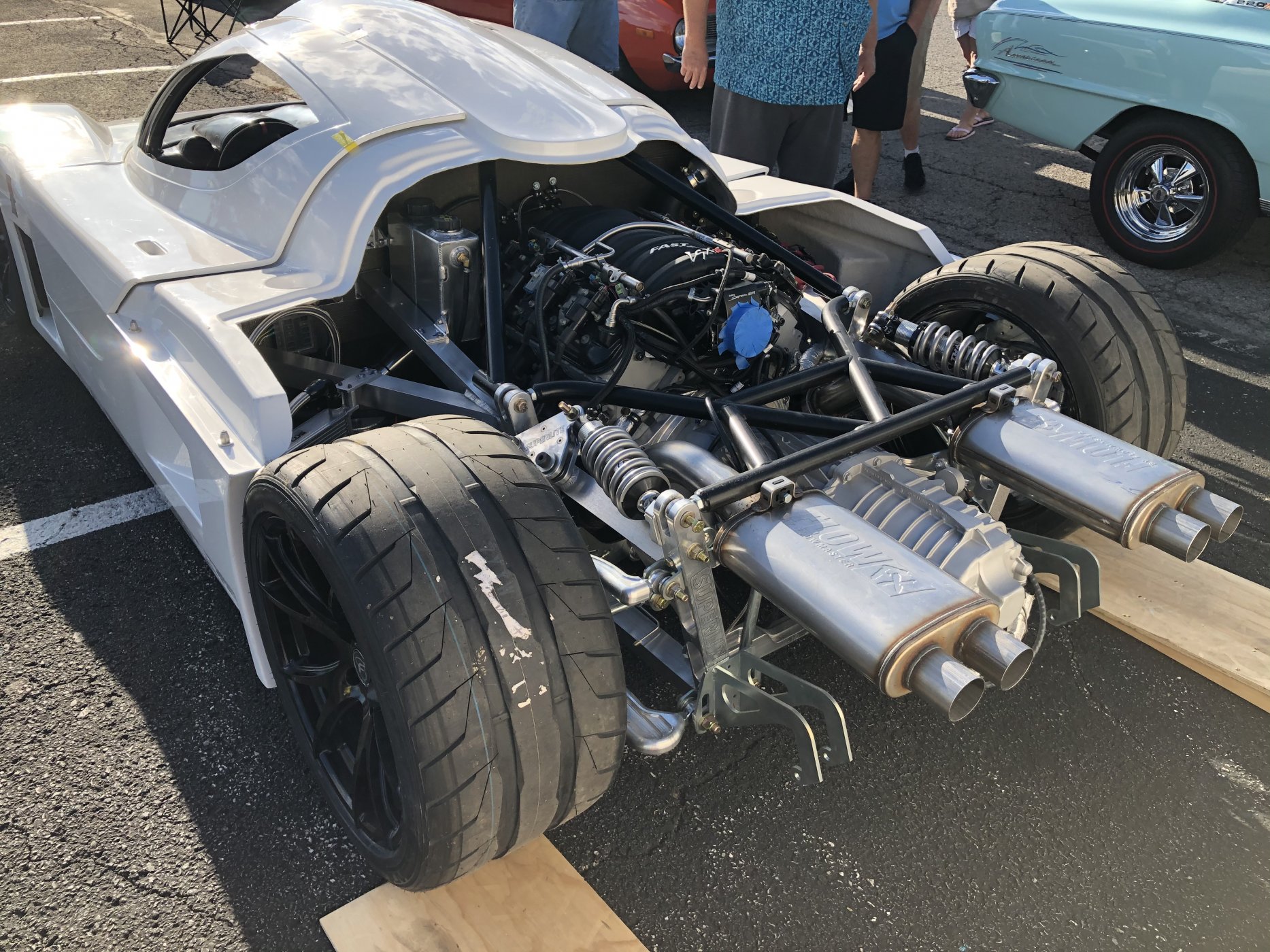

Everyone wanted to see the motor right away so after all the work I did to temporarily fit the rear clam, it came off after only a few minutes (wish I had the time to mount it to the hinges).

Having the body on for the first time with more of the items assembled on the car has shown me a few things:
1) I have a lot of work to do to align the suspension
2) I am going to need to cut a lot of the wheel well inner lip away to clear my tires, body is rubbing in multiple locations (mostly due to suspension not being aligned yet)
3) alignment of the center spider section is CRITICAL to aligning everything else on the car, I am currently off about 1/4" at the rear and that is pushing the back of the rear clam over about 1" at the very back of the car
4) Have I mentioned before THIS THING IS LOW TO THE GROUND.
5) I have the ride height roughly set at 4" front-4.5" rear right now and I may increase both those by 1/2" before I am done. We will see how things turn out with the suspension set and the body fit
6) I have seen where many builders have needed "droop helper springs" to keep the shocks at springs aligned at full droop (car on a lift). To set my ride height I have enough preload on both the front and rear springs that they are still engaged at full droop. Am I missing something or maybe setting something up wrong?
7) Another thing I learned strapping the car down in the trailer is that you cannot reach under this thing. I had to remove the front clam to access the control arms to tie the car down. I am definitely going to be hinging the nose to make that job easier if nothing else. The race tail would make rear access easier but too late for that, plus I prefer the street tail.
Dan Carter
Kurt. I had a similar problem with both my corvette and SLC when I loaded them into my trailer. I built drive up ramps front to back in the trailer about 5 inches tall so I could reach under either car and strap them down. Works out perfect. Just an idea.
Joel K
Kurt, must have been a lot of fun today. Not sure if this is just the angle of the pics, your front roll hoop looks like it hugs the body A pillars quite well with a relatively small gap. Wondering if that was a modification that RCR did, you did, or just an optical illusion.
Dan,
Good idea, thank you. I’ll definitely consider that.
Joel,
I modified my front roll hop by cutting it at the top and machining up some 1 1/4” long spacers that fit inside the tube to spread the ends out. Seems to have worked well if you noticed it. Thanks!
Joel K
Joel,
Looks great, that’s a really nice mod.

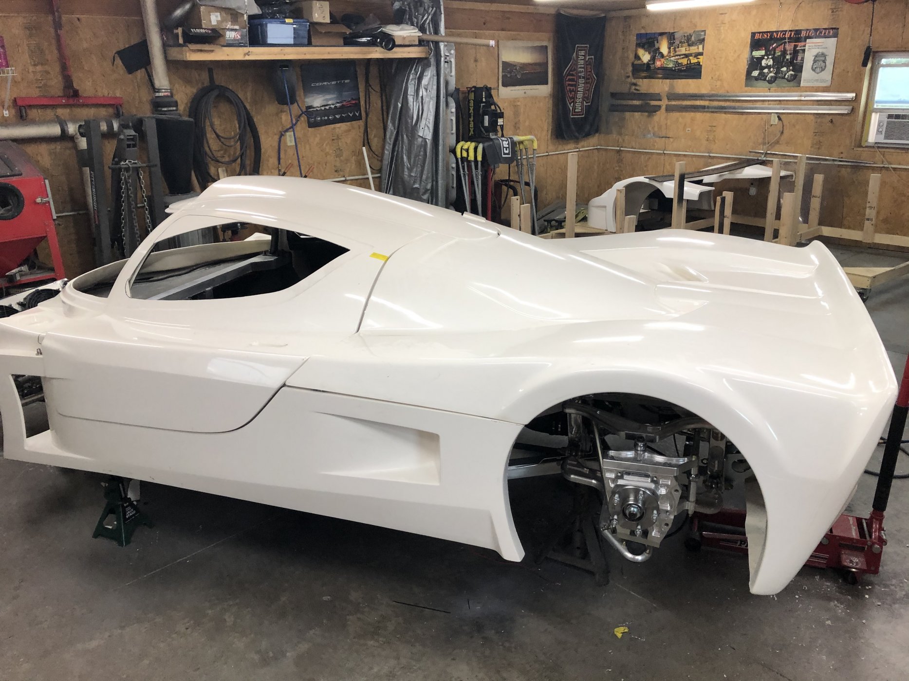

Over this weekend I have managed to spend some in my shop on the SL-C (it has been raining all weekend, not complaining, we need it).
1) Trial fit the spider
2) Trial fit the rear clam

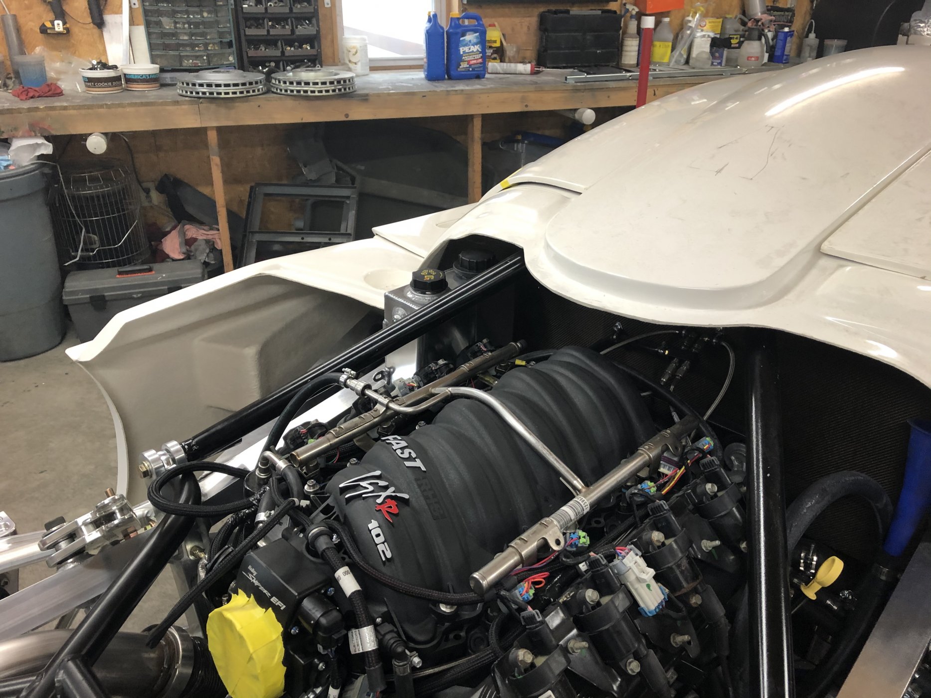

3) Finished more of the coolant system plumbing routing for the expansion tank (more fittings on order, due to be here Tuesday)

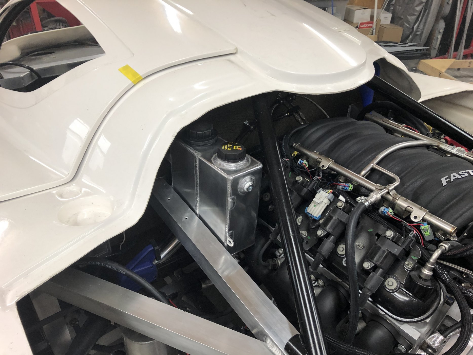

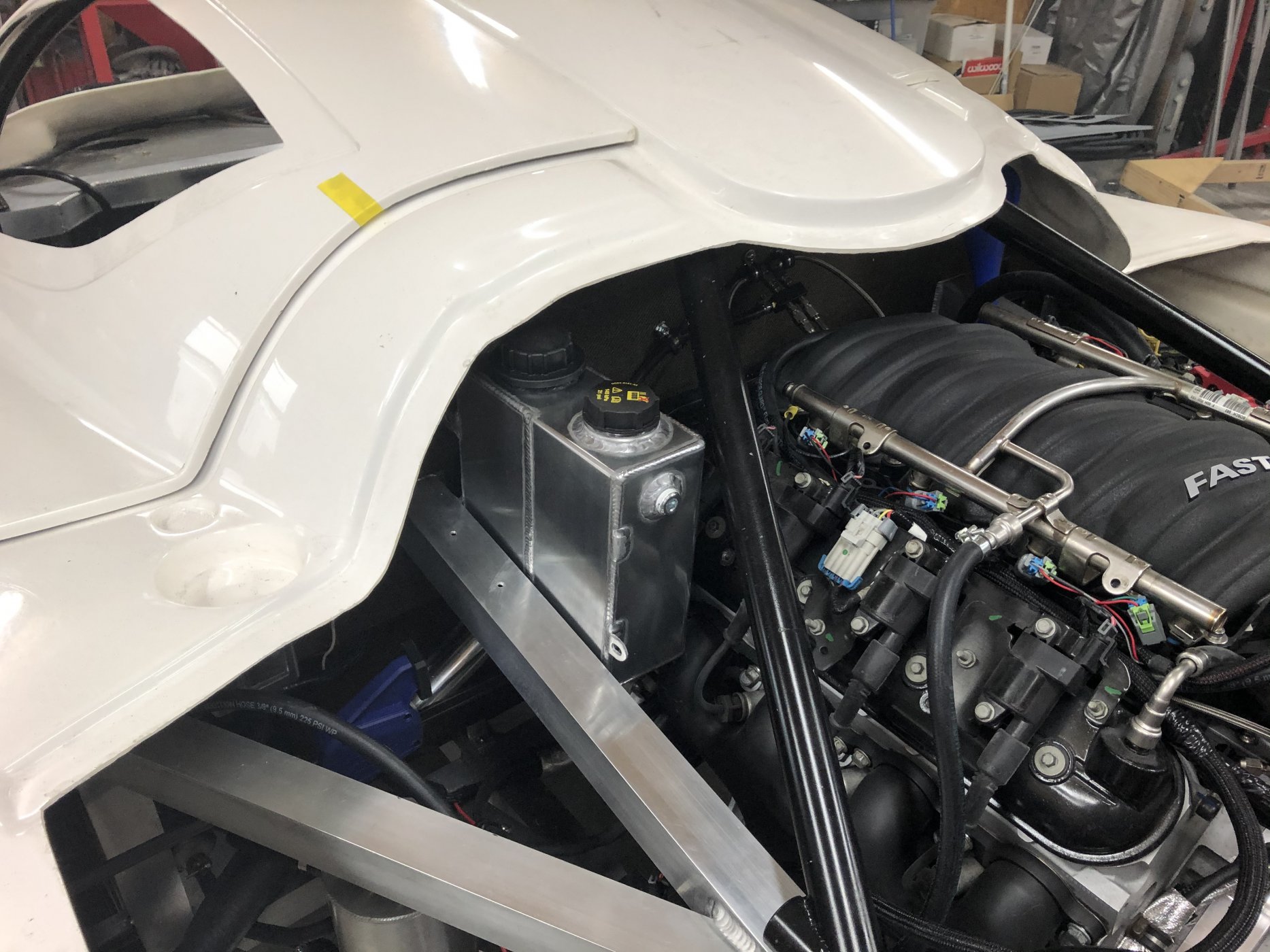

4) Trial fit, polished, applied Sharkhyde, and partially mounted a Canton Racing two in one expansion and overflow tank (need some 1 1/2" angle to make some brackets, all I have around the shop is 1", more shopping to do). I like that this unit is both the expansion and overflow tanks in one. It is fairly compact and fits well beside the engine with about 1" of clearance on the top to the rear clam. It is about 1/2" away from the header but that will have to do.
5) Temporarily plumbed the oil cooler

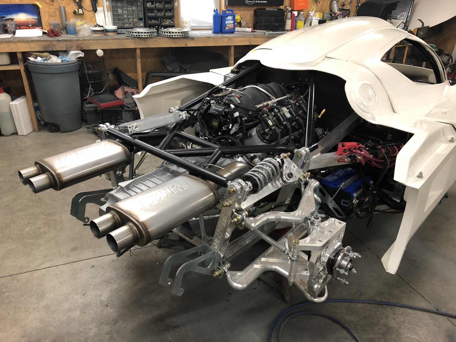

6) Test fit the exhaust

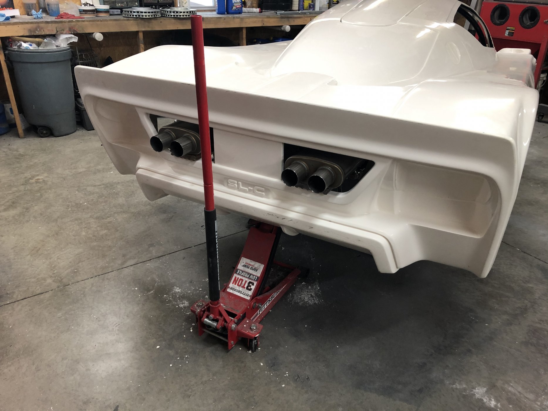

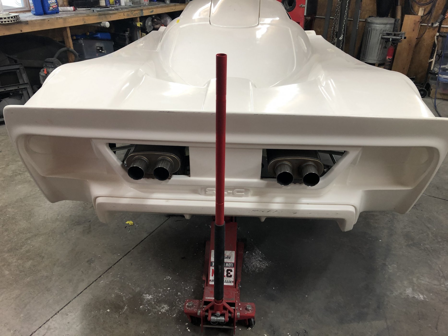

7) Fabricated and mounted the exhaust. I angled the horizontal tail pipe and mufflers downward towards the exit to help prevent condensation from running back towards the engine. I stuck the muffler out the back of the rear clam so that they would not drip condensation on the rear clam. This has a portion of the muffler body sticking out of the rear clam but I like the look. I will mount mesh around the mufflers to give the hole in the clam a finished look. Once I know there are no leaks I will Cerakote the pipes and mufflers and wrap the rest of the pipes in header wrap.
8) Primed the oil pump on the engine in preparation for first start
View attachment 108646View attachment 108647View attachment 108648View attachment 108649View attachment 108650View attachment 108651
I turned the motor over with the exhaust installed and I do believe this thing is going to be throaty and loud, just like I want it!!
The mufflers are Flowmaster Flow FX and are a straight thru glasspack design. I hope no little kids see those big opening as an invitation to stick a ball or something else down in there...........
Once the fittings come for the coolant tank I will finish the plumbing, run some temporary switches for starting the engine, double check everything, fill the tank with some fuel (just to get it above the lift pump sunction) and cross my fingers!!

Kurt:
you did not have to modify any mounts to get the mufflers to fit? They look awesome, I a hoping for a smiler set up but with catalytic converters and quiet but nice sounding mufflers, hope to find the right balance, Great work!!!
do the muffler tips fit well into the rear clam outlet gaps? I did not see any views from the rear with rear clam on. Keep up the good work, you sure make up a lot of ground quickly!!! I just placed the spider onto the tub and it fits perfectly on the passenger side, but it "floats" a bit on the driver side. I am hoping bending down the aluminum floor overhangs where the spider sits will allow it to sit solidly onto the tub. Body alignment will definitely be a challenge, hoping you can show me the way .
Never mind Kurt, I saw your post # 150 and the fit of the muffler tips on the rear clam, sorry I did not go back far enough. Looks good.
Hector,
I am leaving my muffler bodies hanging out the opening about 1 1/2”. This allowed me to install them with no modifications to the chassis supports and brackets. It will also place the outlet of my tips past the rear bumper protrusion so no condensation will drip from the exhaust onto the rear clam. The mufflers will be cerakoted black along with all the rest of the exhaust. My plan is for no shiny bits on the exterior of the car.

Hector,
Kurt:
Glad you mentioned that the muffler bodies are hanging out, I did not appreciate that from the pictures, I do like that option without extensive mods.
I still have not decided on the exact mufflers or finish, but is good to know you can let them hang out!!! Thanks
