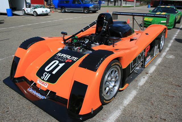

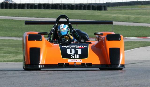

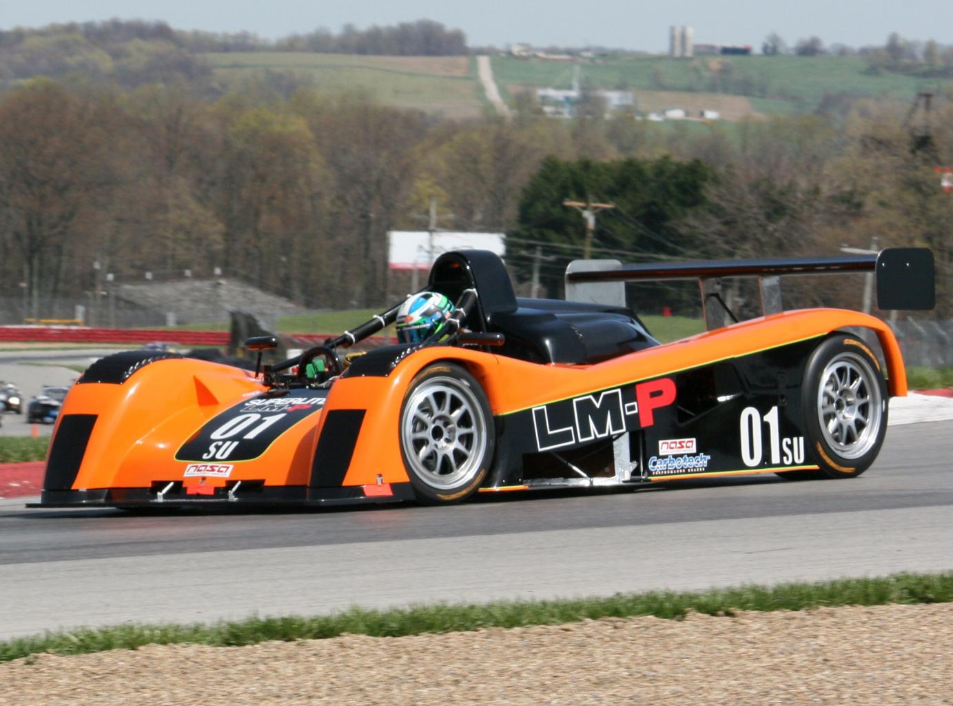

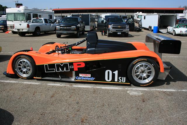

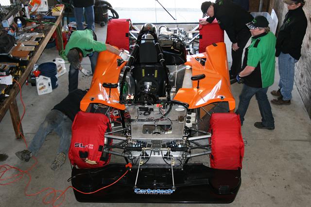

More pics

Impressive car :). I look forward to seeing more from the next race.

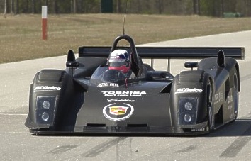

I see some common DNA :thumbsup:
