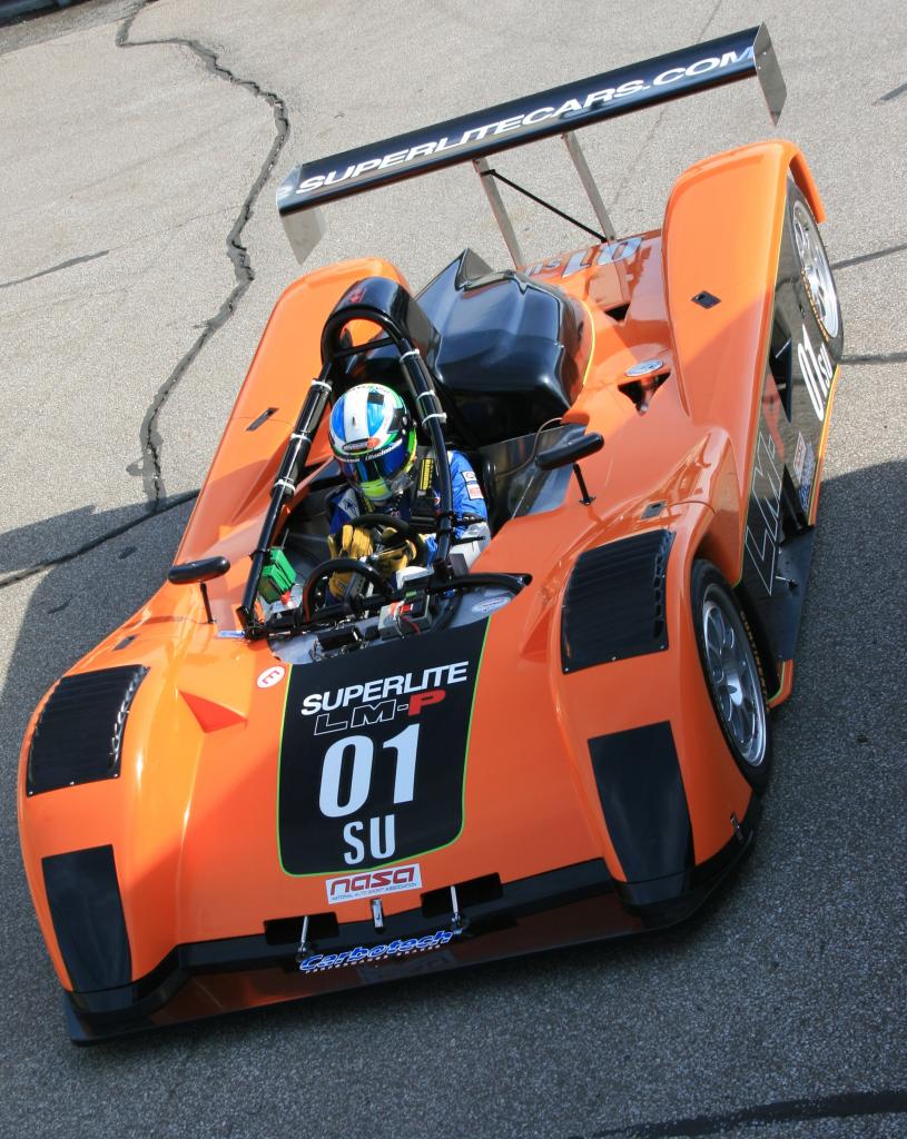

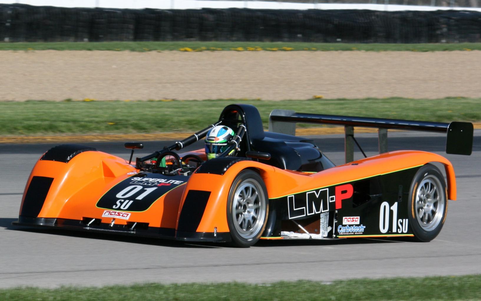

LMP Test Day
This weekend Superlite Cars took the first LMP car to Mid Ohio Sports Car Course for its maiden voyage. The intent of the weekend was to get the car through tech, and to get some shakedown laps to validate the basic design, gather setup data, test our new tire setup, and prove the basic drivetrain model.
And have fun.
We were able to do all of that, and more!
The team arrived on Friday for a test day and enduro, but last-minute adjustments, and getting through tech took most of the day, and so we only had a few laps in the enduro to get some initial feedback. The first laps on track went without major incident, as Ryan worked up to speed.
Those laps were useful in pointing out a few new-car bugs. For example, we had what we thought might be the right gearing, but it turned out that we were going down the front straight in second gear, and only got into 3rd on a few places on track. Ryan adapted by using first gear coming out of a lot of corners to get speed, but that was a crutch. What was worse was the fact that the engine in the car really woke up in the higher ranges, but didn’t have much torque down low where we were forced to run it. So we were creeping off the turns, instead of leaping off them.
We really should have left our LeMans gearing at the shop. Next weekend at the track we will be sporting much shorter gears!
We also had chosen a brake pad that wasn’t suited to Ryan’s driving style. He wanted to see much more initial bite than the pads we had in the car, and so was pretty tentative on the brakes .
Unfortunately, we also didn’t have a tach in the car, as the new AIM dash we had wasn’t communicating with the regular GM ECU. So Ryan had to shift by ear, which was difficult since he couldn’t hear much with all the wind noise in an open car, coupled by the fact that the car was very quiet (as we were testing a new muffling system for a certain race where we were warned last year that we were too loud). He never hit the rev limiter, so there is no doubt he was short-shifting the car.
And finally, we learned just how much downforce the LMP cars really made. In technical terms, it was a whole lotta downforce. So much so that we deformed the splitter at speed and got a bit of aero porpoising at speed which really slowed us down. After qualifying, we went to work on that with added bracing to stiffen things up there.
But even with all that, and with only getting a few laps in during qualifying, we managed to qualify just two seconds behind an ex-GrandAM Riley Daytona Prototype, which was sort of a benchmark for us, as that car had run very competitively at the National Championships last year.
The team believes that with the gearing sorted, a more suitable pad compound, and some small revisions to the rear suspension (we have already run FEA analysis on the proposed changes there) we will have a track killer on our hands.
So how did the races go? Well, just an hour or so before the race on Saturday, we noticed that we had a cracked mount on the differential. We didn’t have a spare so that put an end to the weekend. Reluctantly, we packed up the new transporter, and headed home, disappointed that we didn’t get to actually race the car yet, but very happy with the raw speed right out of the box, and the relatively short list of the expected teething issues we need to address.
The gearing and brake issues are simple to fix, and we will have those addressed early next week. We’ll work on the differential mounting to reduce stress on the case, and already have an FEA-validated solution that lets it float free in the car, instead of treating it as a stressed member. And we think we’ve already addressed the small aero issue that was causing porpoising.
All weekend we had a constant stream of people looking at the car, all with very positive feedback on every aspect of the car. Ryan thought it was very composed, and easy to drive, and can only get much faster with the coming updates.
We are pretty happy with the first test. Being just 2 seconds off a well-developed Daytona Prototype car on the first day with less than 15 total laps on the car is pretty good. We think we have massive amounts of untapped speed, including adding a bit more power from our currently detuned engine now in the car (we wanted a relatively safe tune on this one so we didn’t have to worry about the engine on the first day). Ryan thinks we left more than 5 seconds a lap on the table just on gearing, and almost as much in braking.
In the end, we were all very pleased with the speed and reliability that the car showed on track. The LMP was exceptionally quick considering the typical new-car issues, and everyone on the team felt that we had only scratched the surface in terms of development. The new Continental tires worked well, the adaptation of the Corvette transmission worked perfectly, we got great input on the overall package, proved the basic design of the chassis and body, had no leaks, and nothing fell off the car. For a first test outing of a car we’d never built before, and never raced before, it was a great success, and the speed it showed in spite of the issues we faced was really quite remarkable.
And we had a lot of fun!
(Special thanks need to go out to the entire crew at the shop who worked incredible hours to get the car finished in time to run at the track, all while still building customer cars as well!)
