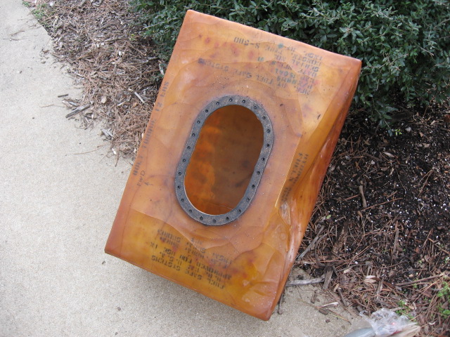

We've got a leaking fuel cell on our old Z SCCA car that is coming out in a couple of weeks. It carries a standard 15 gallon road race cell with "special" dual pickups. Just the bladder, not the entire cell, is quoted at about $750 to replace retail, maybe $550 street price. Sort of high.

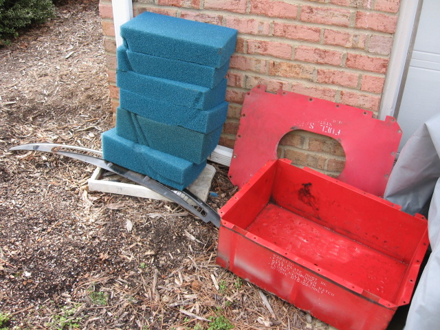

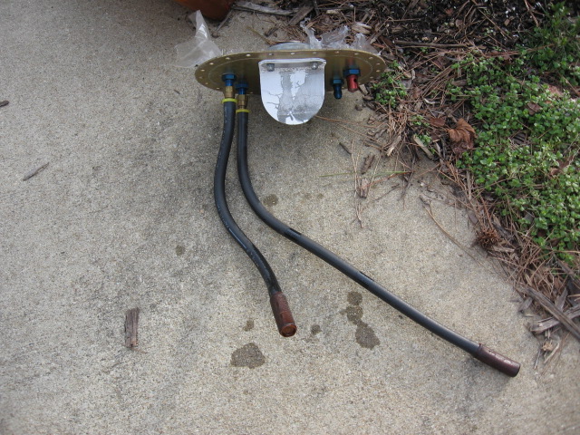

Seeing as how it is leaking, small pin hole I can't find on the bottom, I figured I've have a look at it and take it apart. Not much to it. Standard top plate with roll over vent valves with check balls, two pickups that are nothing more than rubber hose with screens you cram in the corners, and a lot of foam cut to fit in there just right.
So, now that it is all apart I think I'll try a good old product I've fixed a few motorcycle tanks with - Kreem. Anyone tried this on a fuel cell bladder? The bladder is quite thick, so if it has a hole I think it will be repairable with Kreem. I plan to put the bladder into the can to help it hold shape (it holds shape without the can actually) and then Kreem it up. After that has cured then re-install the lid and foam so we can be on our way. Anyone else have experience with this? If not we'll give it a go and let you know how it turns out!

Hey Sandy, thanks!! I just finished putting the Kreem in here at work and I think it is doing a wonderful job. Coats well, and drys with a sort of semi flexible feel to it. I'll get some pictures tomorrow or Friday when 100% cured and then test it out. So far I think it is working well.
Those fuel cell companies do something similar as they will tell you that much on the phone "we clean it, pressure test it, check for leaks, and seal it against leaking". So they are using some sort of liquid/spray seal to do the job.
Anyhow, we'll learn something either way here with this experiment.

That is my only worry too. I think it might work here though because the bladder is fairly firm and once it gets packed with foam and in the can it is more rigid. Not like a steel tank, certainly not, but not flimsy floppy either. We'll see how she goes.
R
Hey Pete,
I think our fears of cracking were unfounded. I got the bladder coated and the Kreem is dry now. I think because the bladder construction, some sort of "fabric/cloth" and the thinness of the Kreem layer that the coating still flexes with the material. And it is coated completely white on the inside fairly uniformly. I'll give it another 24 hours to cure then put gas in it before I call it a success, but it is coming out better than I expected at this point.
Ron
Hey Pete,
Looks like our worries over Kreem are not a problem. Got the bladder coated and the coating is flexible with the "fabric" that makes the bladder. I think it has penetrated the fabric and being in the material is somewhat pliable. It seems sound and good to go. I'll give it another day to cure then test with gas before I pronounce it a success, but so far so good.
Ron
I forgot to post the outcome of this repair but wish to do so for completeness sake.
The Kreem material did a fantastic job. It penetrated the material of the cell and it still remained flexible a week after curing. We filled it up with gas and it has been holding fine for over a month now, no problems at all. Car might be racing in a week so I'll report back if we have issues, but I don't think that is going to happen.
