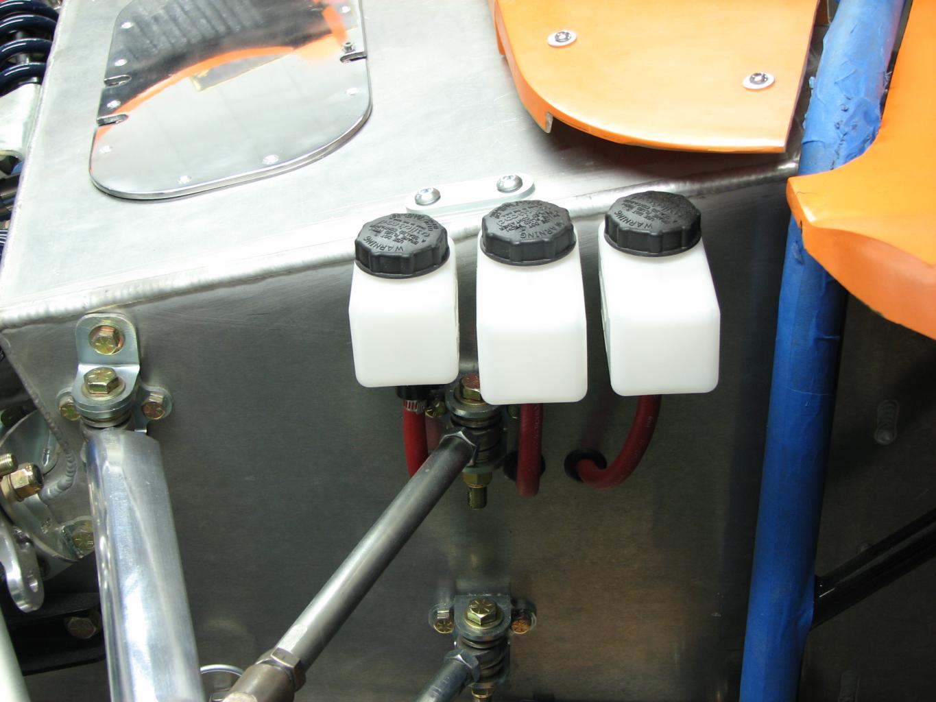

I happened to see the Tilton triple reservoir in a catalog just AFTER I had mounted the three Wilwoods and noted how I wish I had seen it sooner. Now that there are reported problems with the Wilwoods, it doesn't seem like an option to switch.
I guess that's what hole plugs are for! Just glue them in with epoxy.

Is it me or are your remote reservoirs located across from your tire - seems like they would take quite a pounding??

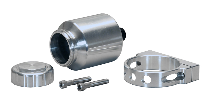

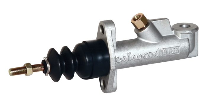

The reservoirs are not the only issue. The cap/fitting on the other end of hose at the masters is using the same design. I have noticed several other types of masters that have a AN fitting/ solid alum cap in place of the plastic cap and o ring system used on the Wilwoods.
I am going to wait until I get to filling the brakes with fluid before I tackle this issue if I have one. Should I have leaks I going to use different masters and reservoirs.
Here's the Tilton masters;
http://proshop.summitracing.com/parts/til-76-750/overview/
CNC Brakes makes some interesting pieces;
CNC, Inc. - Manufacturers of Quality Pedals and Brake Components
As well as the Wilwood parts below
That is the only place the reservoirs will fit, Alex.
That's where we recommend mounting them too...we have run ours with no ill effects..but Alex's driveway is riddled with Mousse so he may have a point in the frozen tundra...
