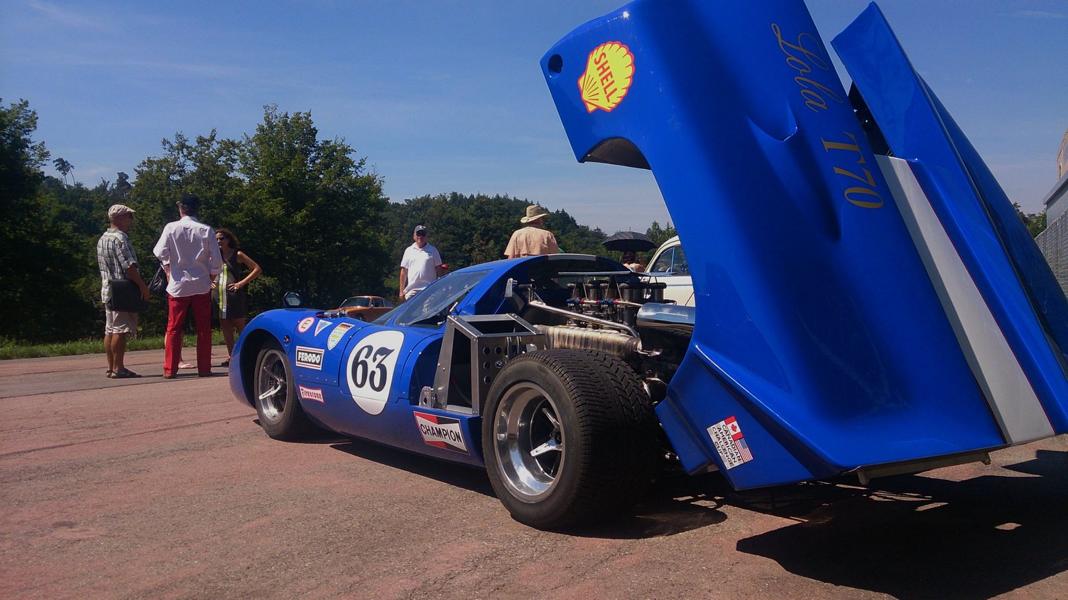

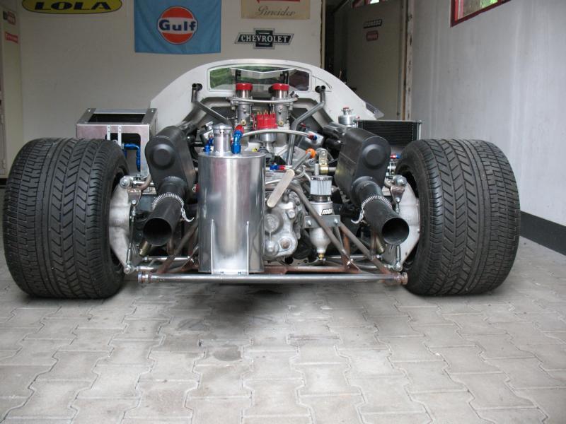

hi giles,I can not tell where the problem is I'm driving pirelli tires on the road legal no problems.you do not drive like 250 kmh with the lola anymore
gruß meinolf

Hello meinolf dwuzet,
The Pirelli tyres are a totally practical solution. I would be interested to know your feelings about the balance of the car on the Pirellis. It is just the aesthetics, the original car would have had higher profile (and wider) tyres on 15" rims. Some people prefer the look of the lower profile tyres and certainly you can accommodate bigger brakes in a 17" rim (who made your wheels please?)
If it is possible, I would like to replicate the look and feel of the very wide, high side wall tyre that is road legal. If this proves impossible, I will likely use 17" rims with either Pirelli P Zero or Michelin PS2 tyres (depending on which is the better compound and likely future availability). Thank you for your thoughts - yours is a good looking car. Best. Giles
hi giles . i have many thoughts for tires. the feeling on the road or racetrack is verry good with pirelli`s . the spring set is soft. for my feeling is 17`rims is not orginal and to big. only altanativ is for my firstone gold strike. is not for 14`width.ihe pirelli is nice square.there is no possibility .
gruß from black forest germany meinolf
