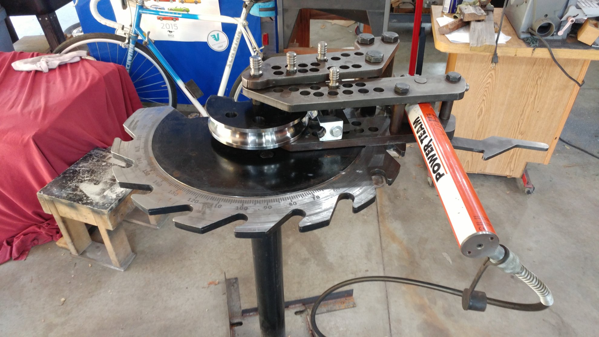

If you want a tubing bender this is the best one out there ! Bar none the JD squared model 50 . This will bend 2 1/2" .250 wall tubing ! And don't go manual go hydraulic, it's mobile, if it's used manually you have to bolt it to the floor and bust your ass to bend anything ! I've used this to bend 1" to 2 1/2" tubing up to the 1/4" wall .

Yea, mine is manual, and it will work your ass. I only have 1.25 and 1.5 dies. I bet a 2.5" would really take some effort.
Also, the 32 I have, biggest dies are 1.875" or 50mm.

JD2 is best for tubing. If you also want to do flat stock, then get a Hossfeld. If you also want to do stuff like eyebolts and u-bolts then get a Diacro.
