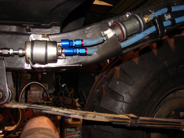

I found this photo showing the filter / regulator hookup. This doesn't look correct to me. Anyone chime in that know..... Shouldn't the pump feed the center port of the filter/ regulator???

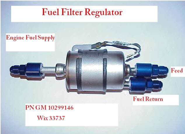

I believe that this is incorrect... Either way the larger port of the two is the feed line.
Ken Roberts
I'm with Pete. The first picture is correct. The second is wrong. The center pipe has a smaller diameter. The outer pipe is larger.
