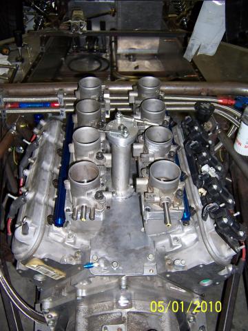

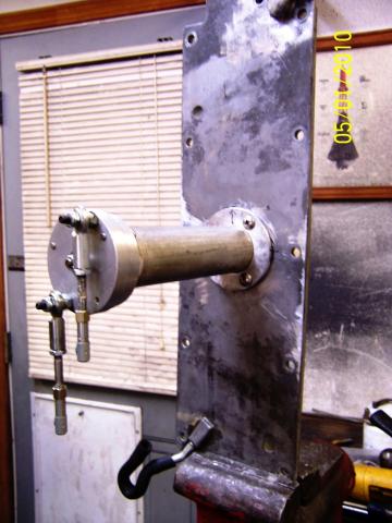

More updates today. I had previously fabricated a throttle actuator for my Weber set-up, so I took the "wheel" and mounted it onto a newly fabricated "tower" that will raise the wheel up to a level that can operate the ITB throttle shafts. The hollow tower can also be used as a vacuum chamber for metering purposes by tying all the individual vacuum ports into the tube (chamber).
The thumbnail below shows the tower being mounted onto the LS1 cam/lifter valley cover, and then the second shows the assembly placed back onto the motor between the ITB banks.
