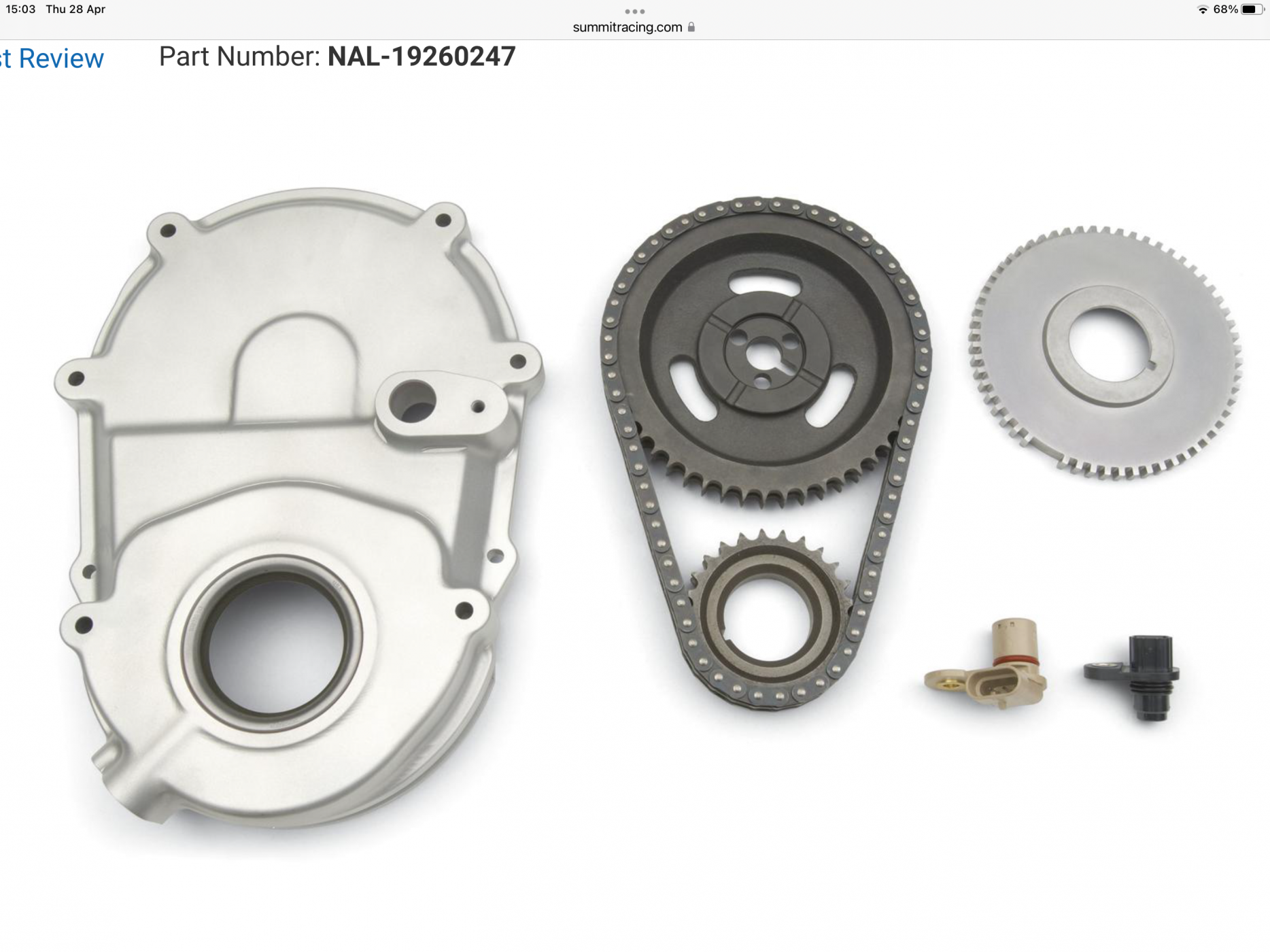

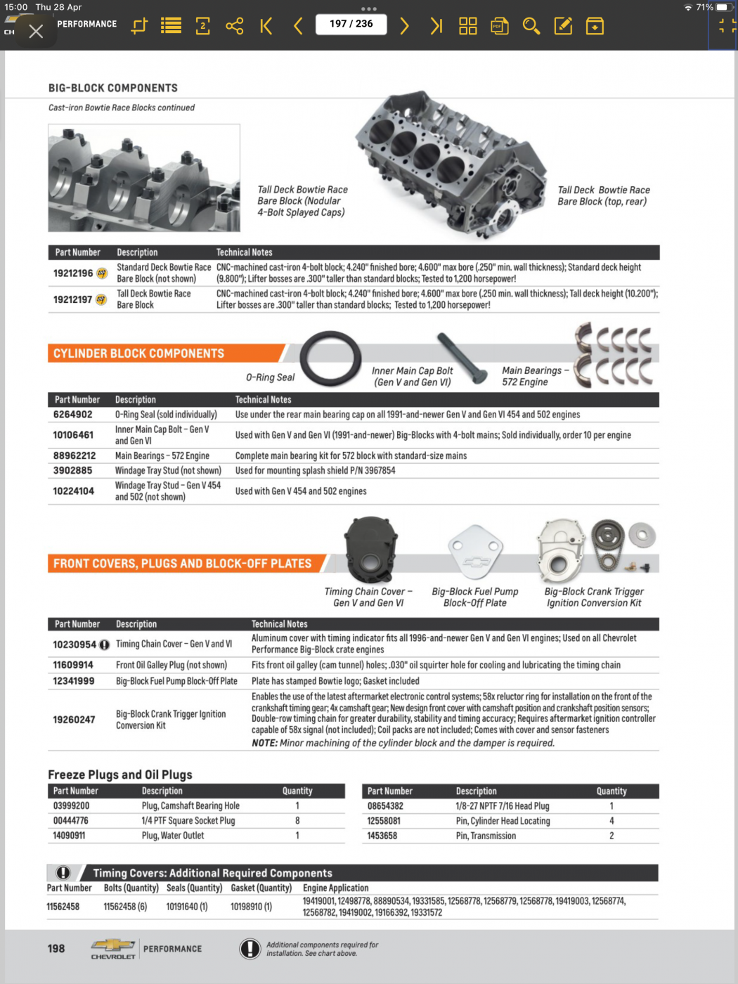

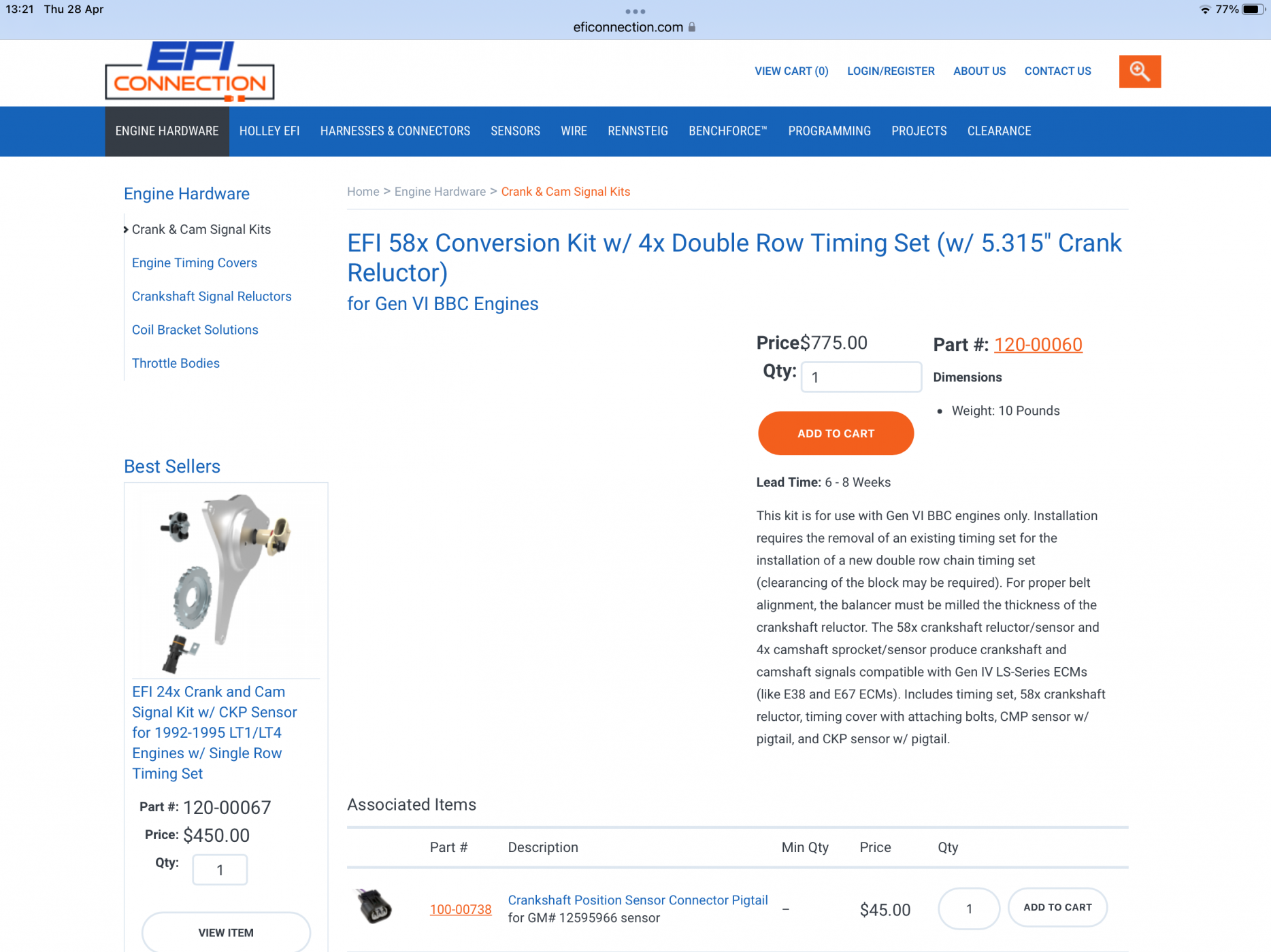

I’ll jump in for Udo, we used the EFI connection kit that is also marketed under the Chevy Performance banner.
It uses the LS crank and cam sensors in a custom front cover to suit the 572.
The injection is already setup for sequential fire and will now use batch fire on the coils (only 4 outputs from the Haltech 950)
Have a look at post # 135-137 for pictures of it fitted.

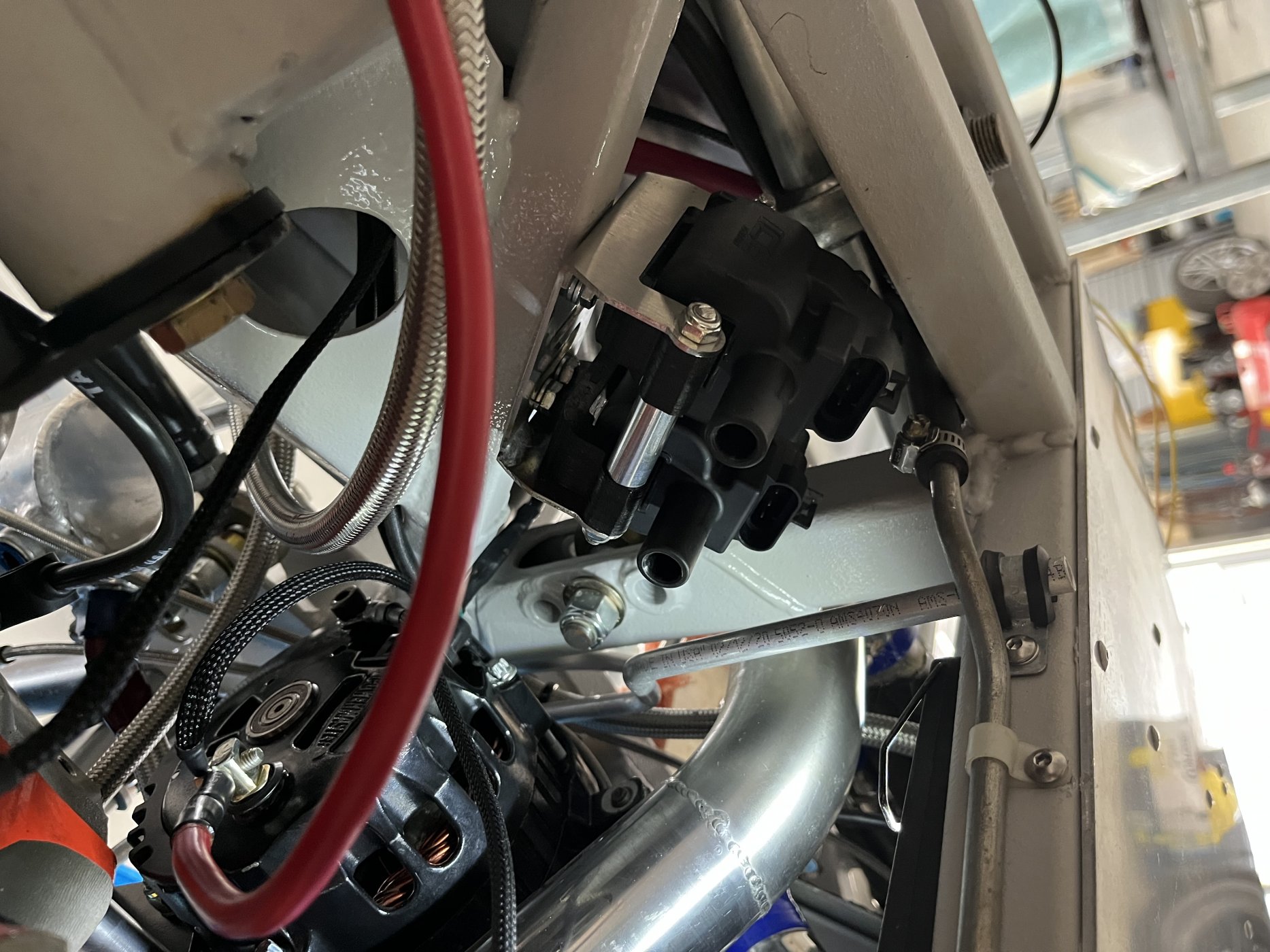

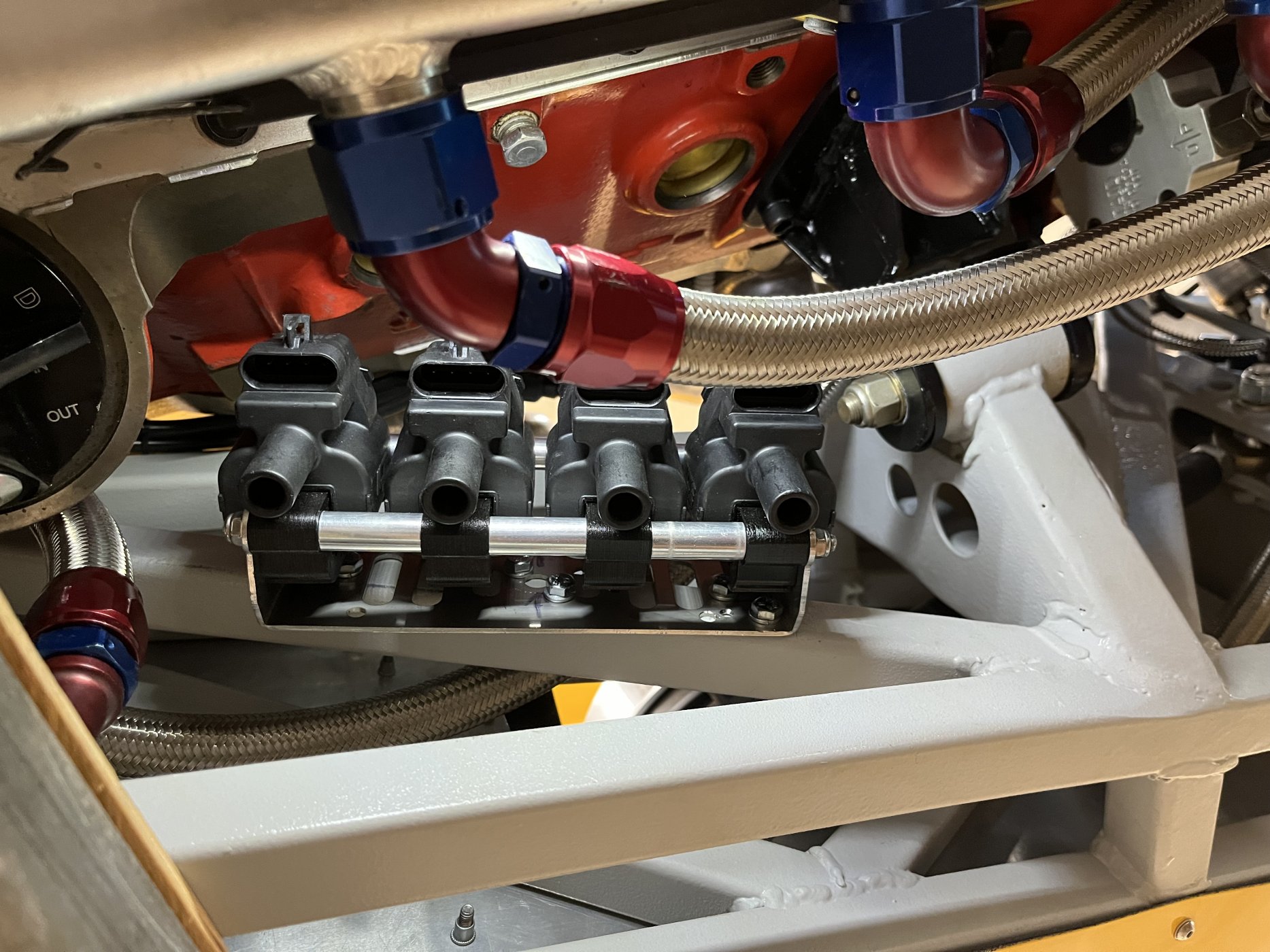

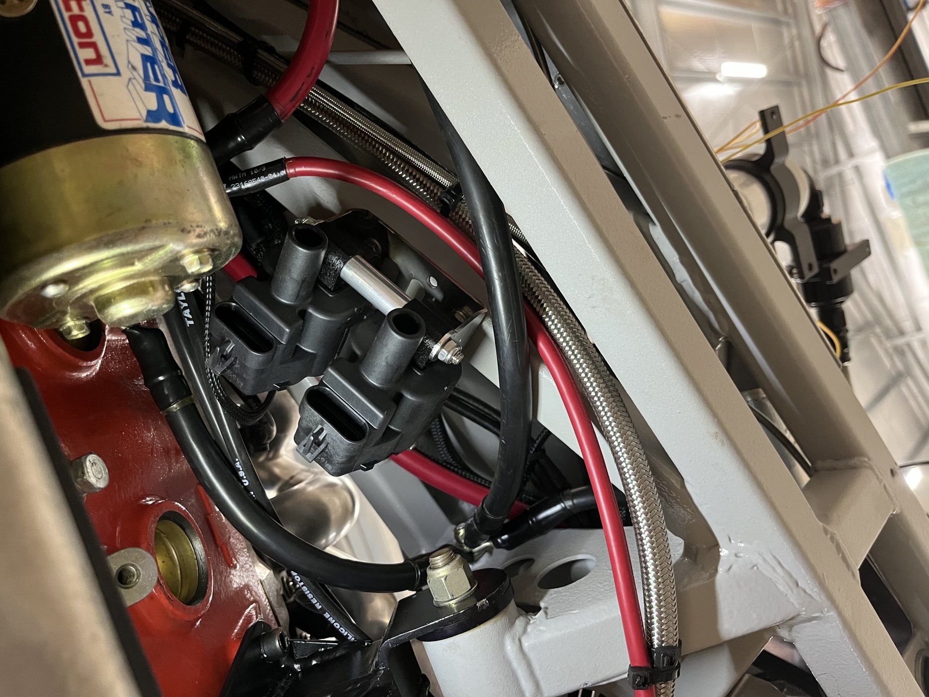

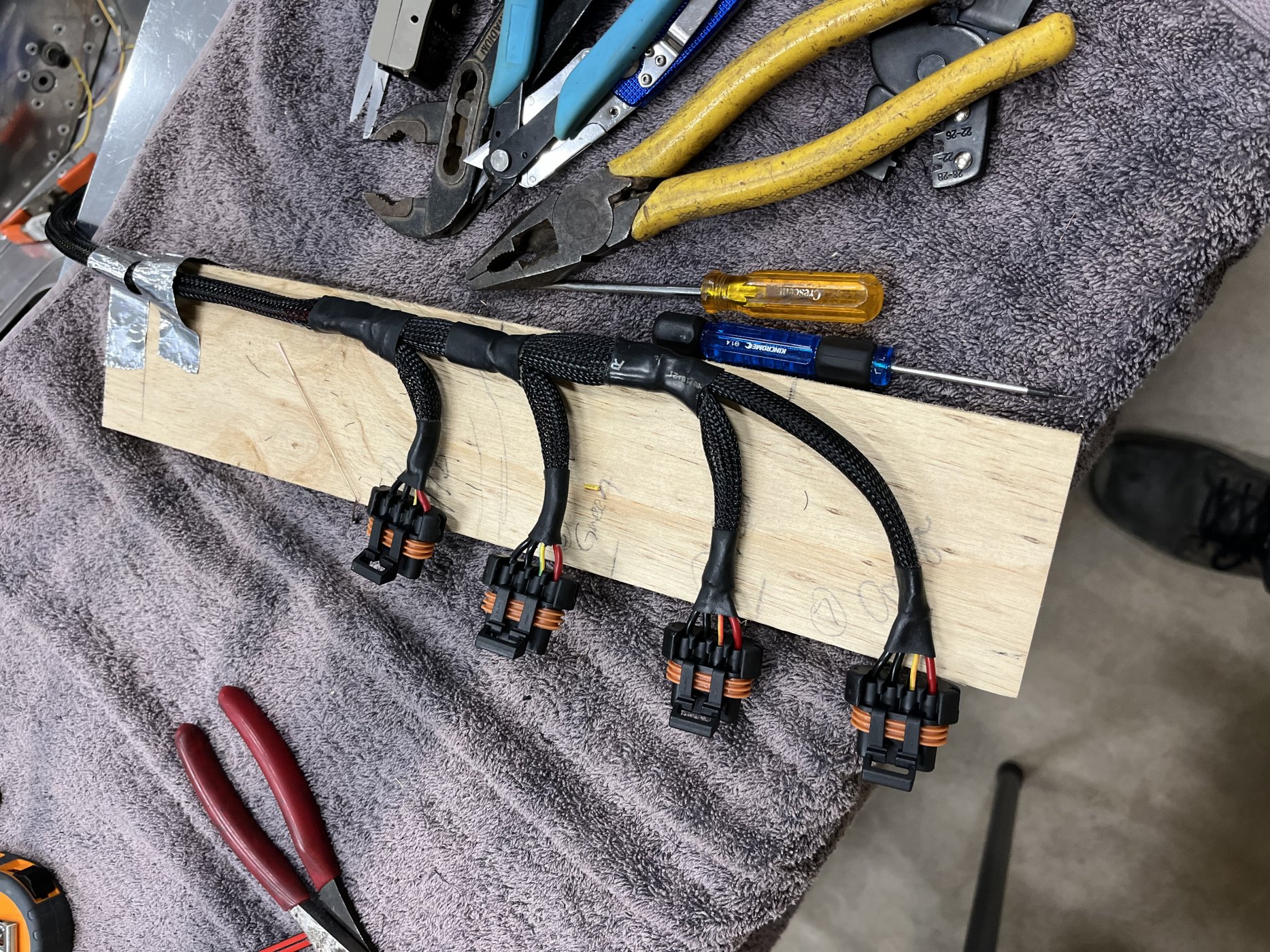

Okay Leon, here is how we over came this next hurdle. I purchased a set of ICE LS 4300 coil packs and they pack a wallop! Managed to mount them out of site down low on the chassis. Then we pulled things apart and Clayton de-pinned and re wired the computer end while I wired up the coil pack end. You can see by the pictures.
You're not going to believe this, but after checking the timing I hit the ignition button and it burst into life and sat there idling at around 1,000 RPM.
Not a splutter or a pop, just a crisp clear idle. Both Clayton and myself just stood there open mouthed in amazement.
Even when giving the throttle a blip, it was without hesitation.

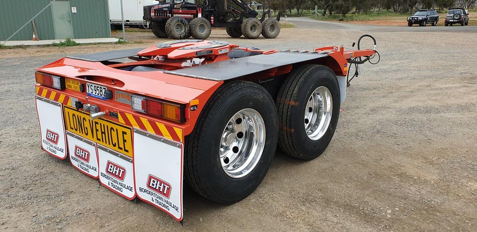

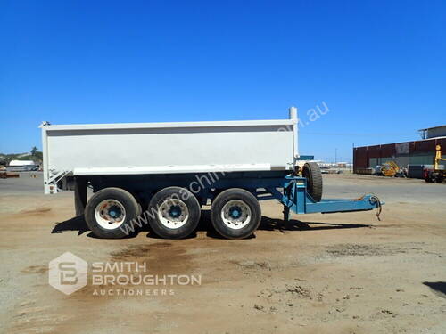

Hi Ryan, Here is my understanding of Trailers and I'm happy to be corrected.
My first pic is a Dog trailer which hook on the back of the previous trailer ( or truck ) and then put you trailer on that.
The next picture is a Pig trailer, which is a stand alone trailer.

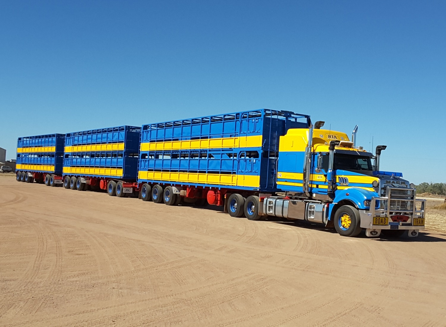

Here in the Northern Territory the norm is either a three trailer Road train ( Multi Combo ) or Three trailers with a B-Double which makes it look like it has four trailers, but one is only about three quarters the length. Have a look at the two cattle truck pictures.
Hope that helps. Regards, Udo.
