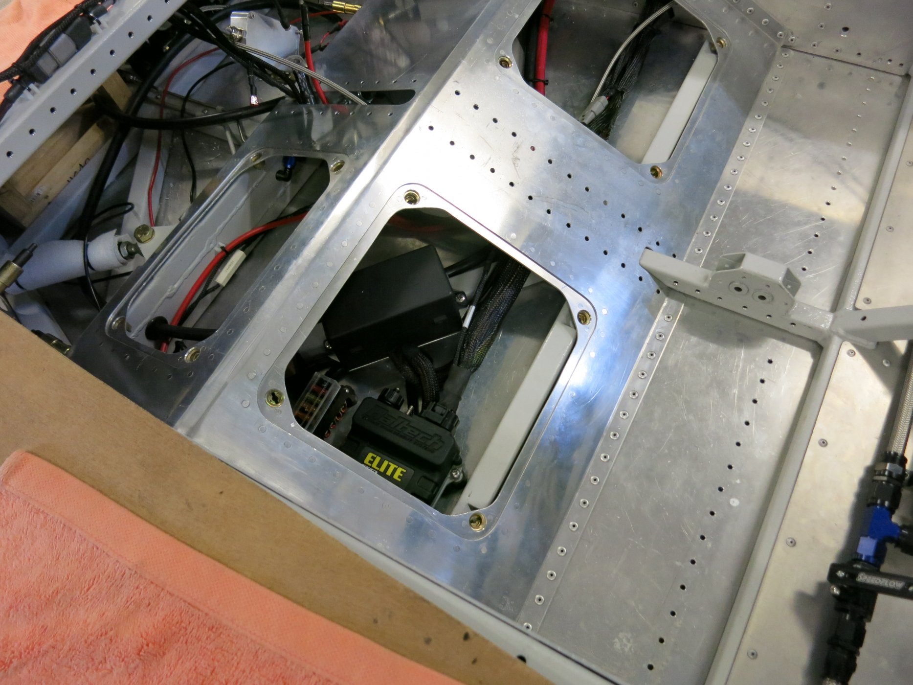

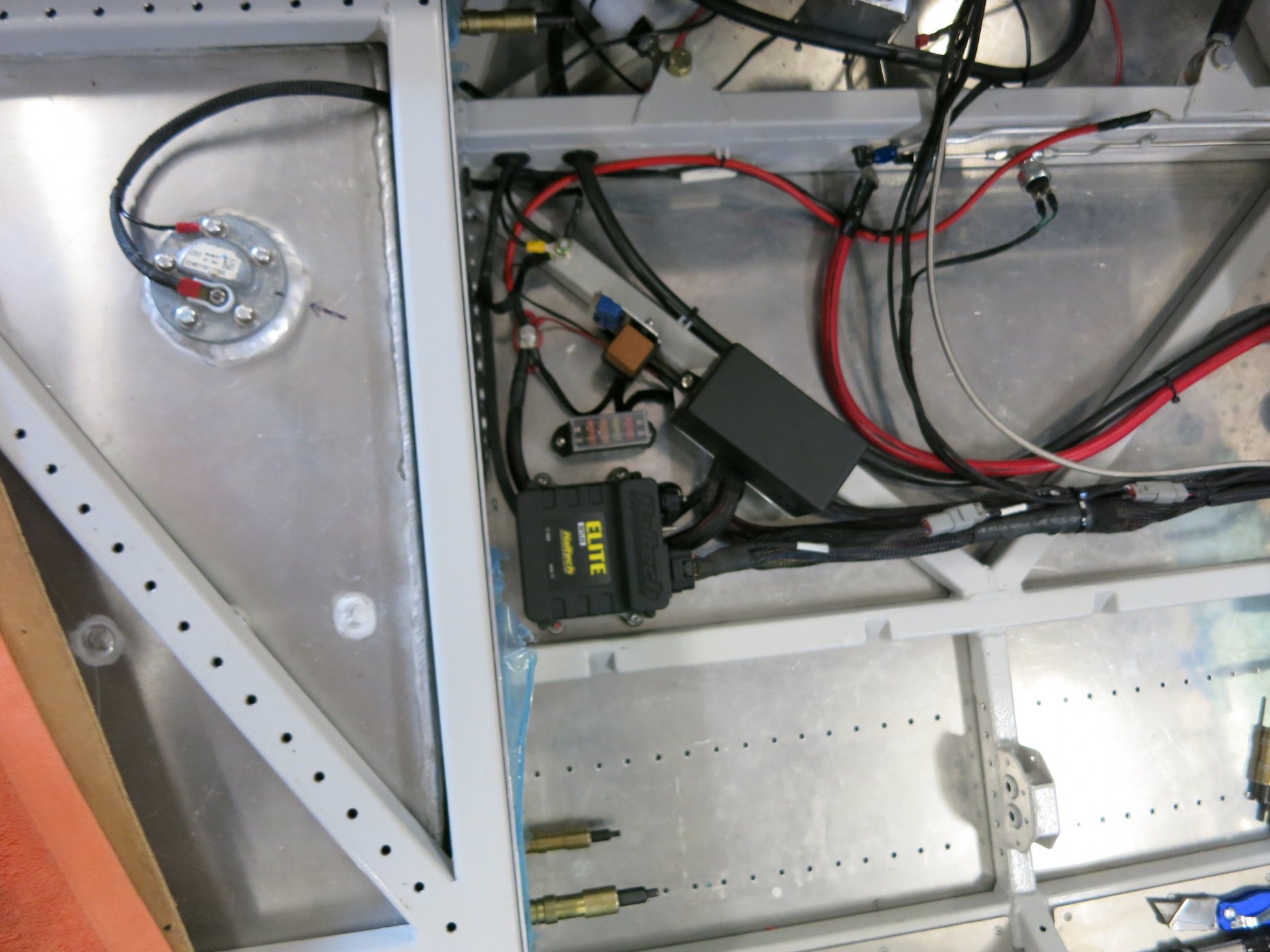

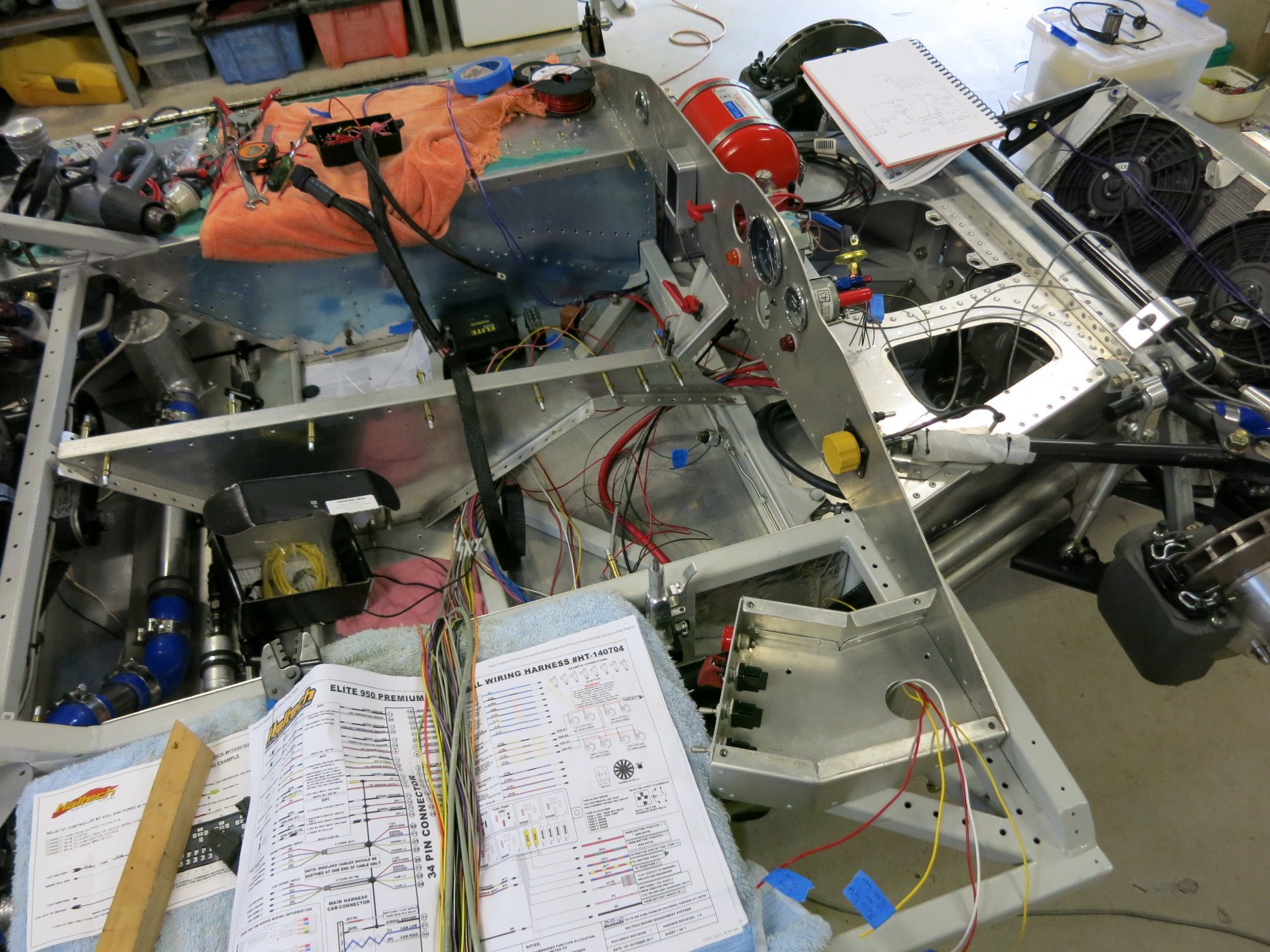

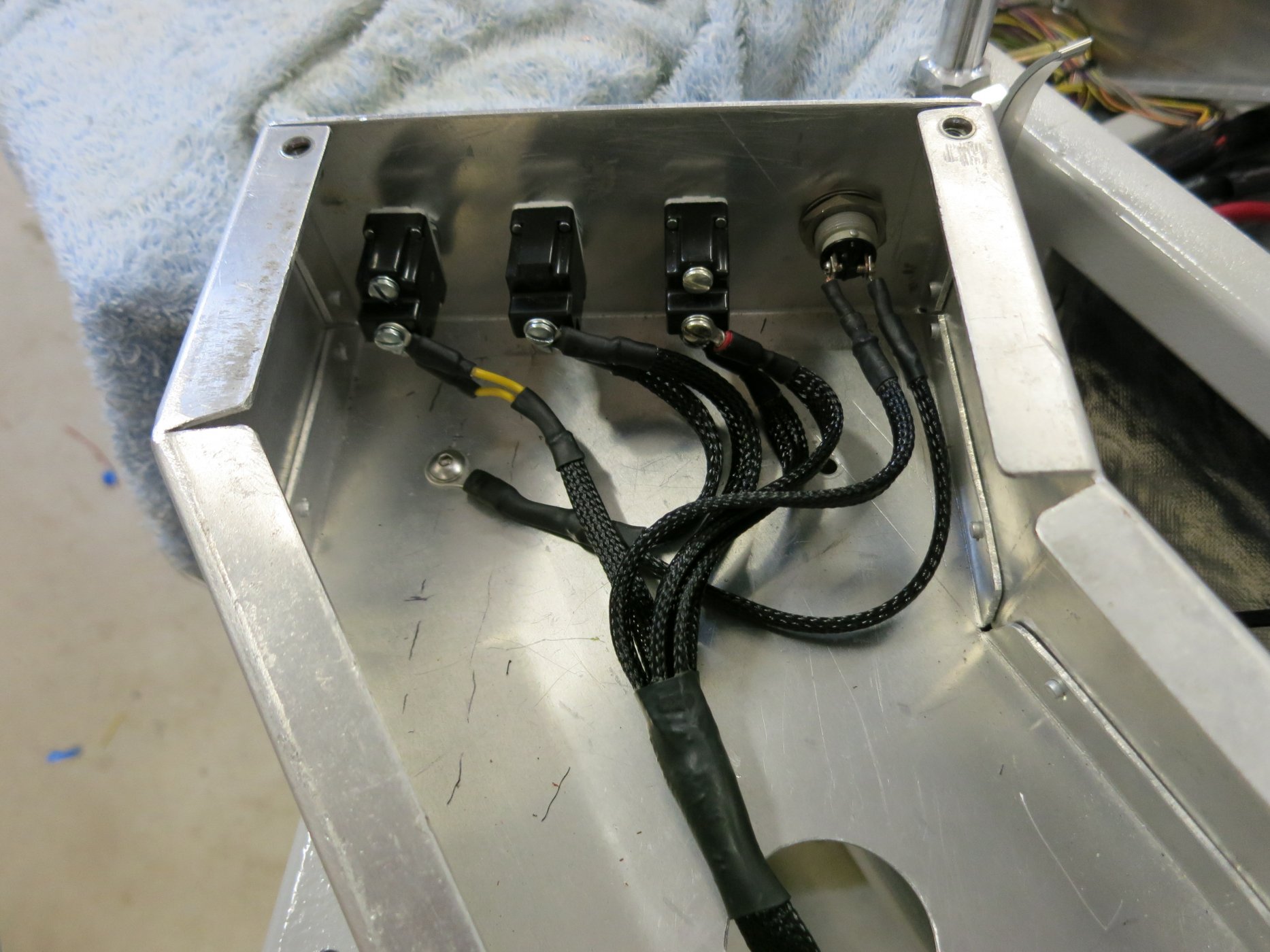

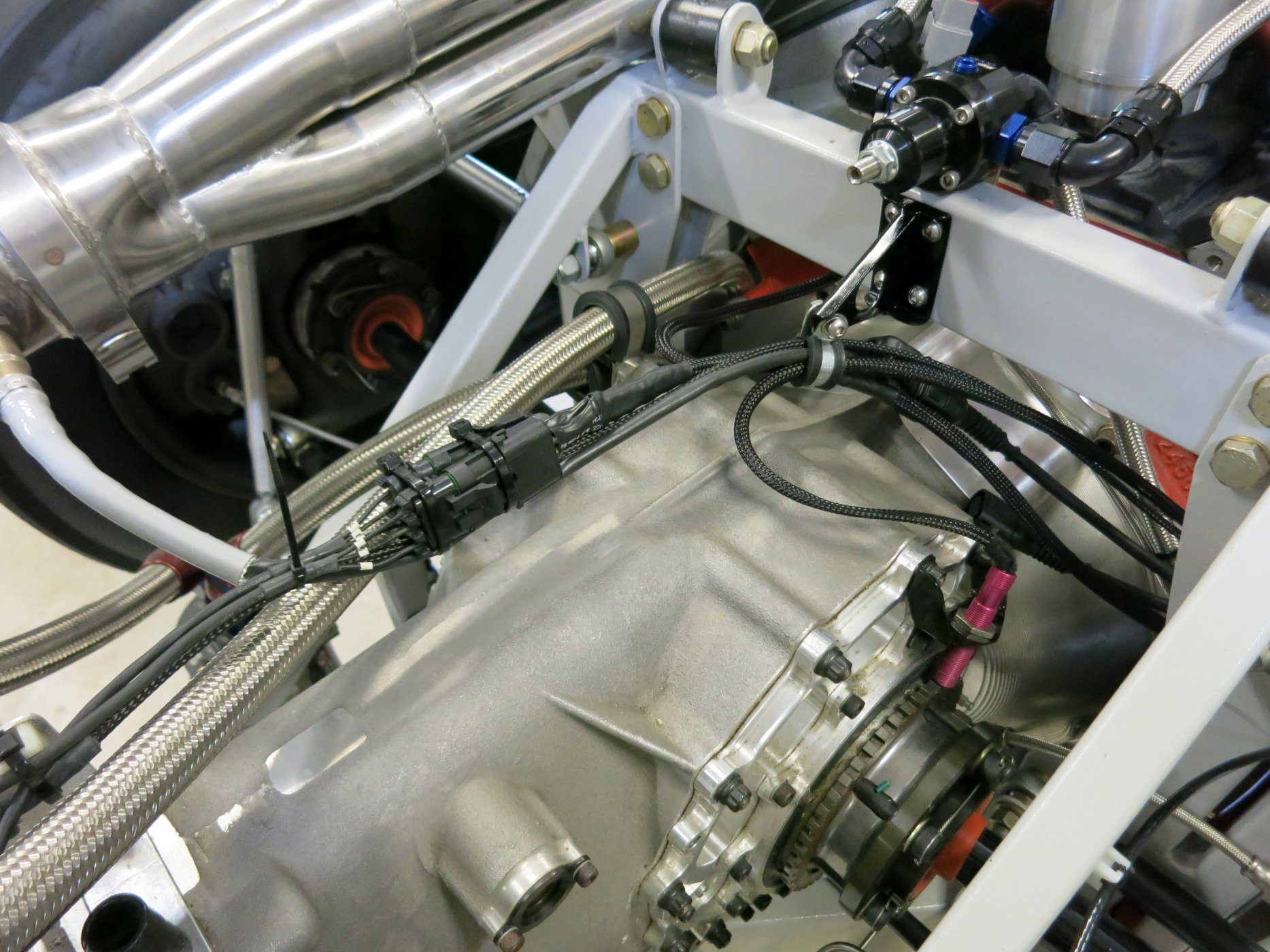

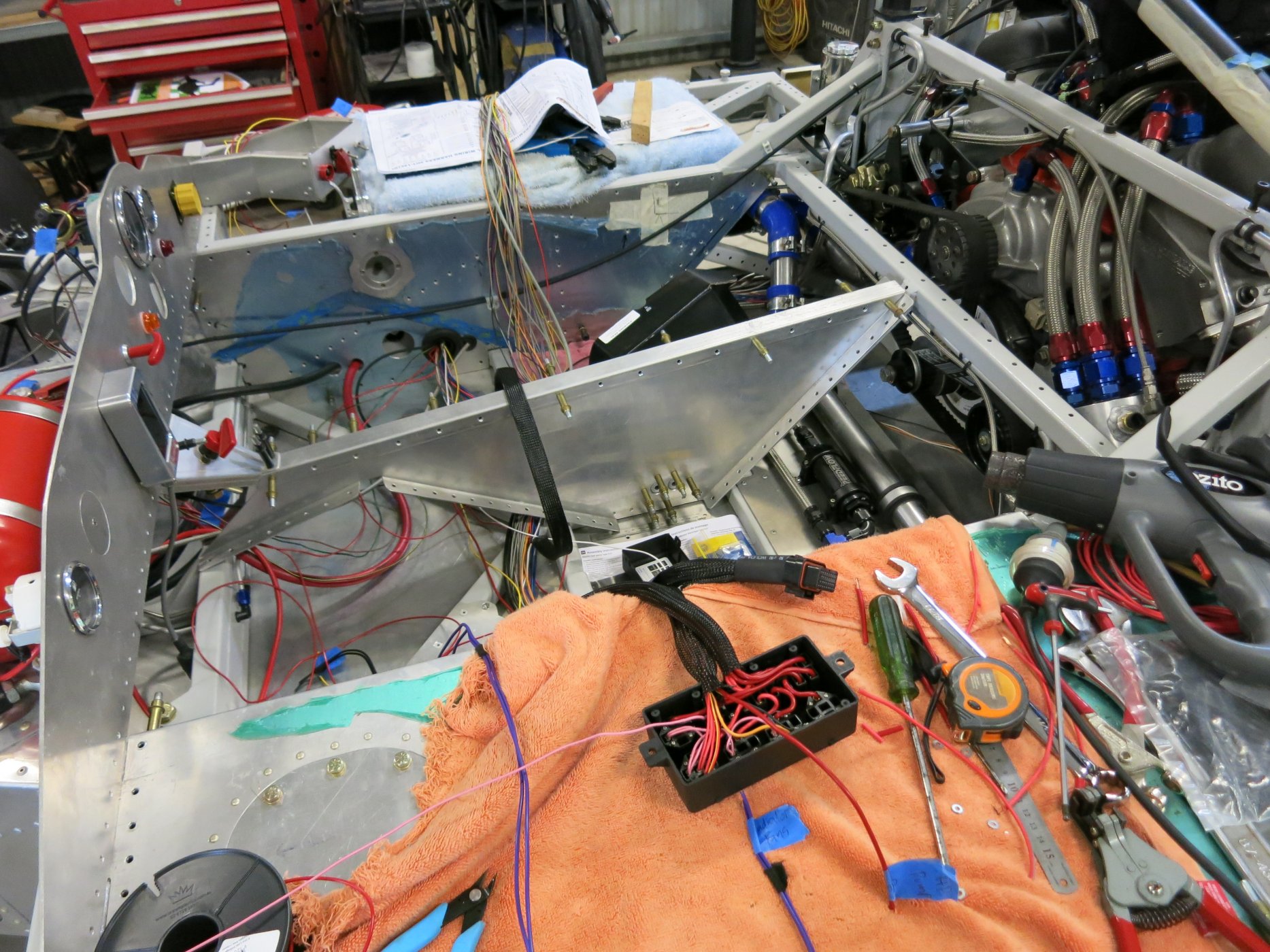

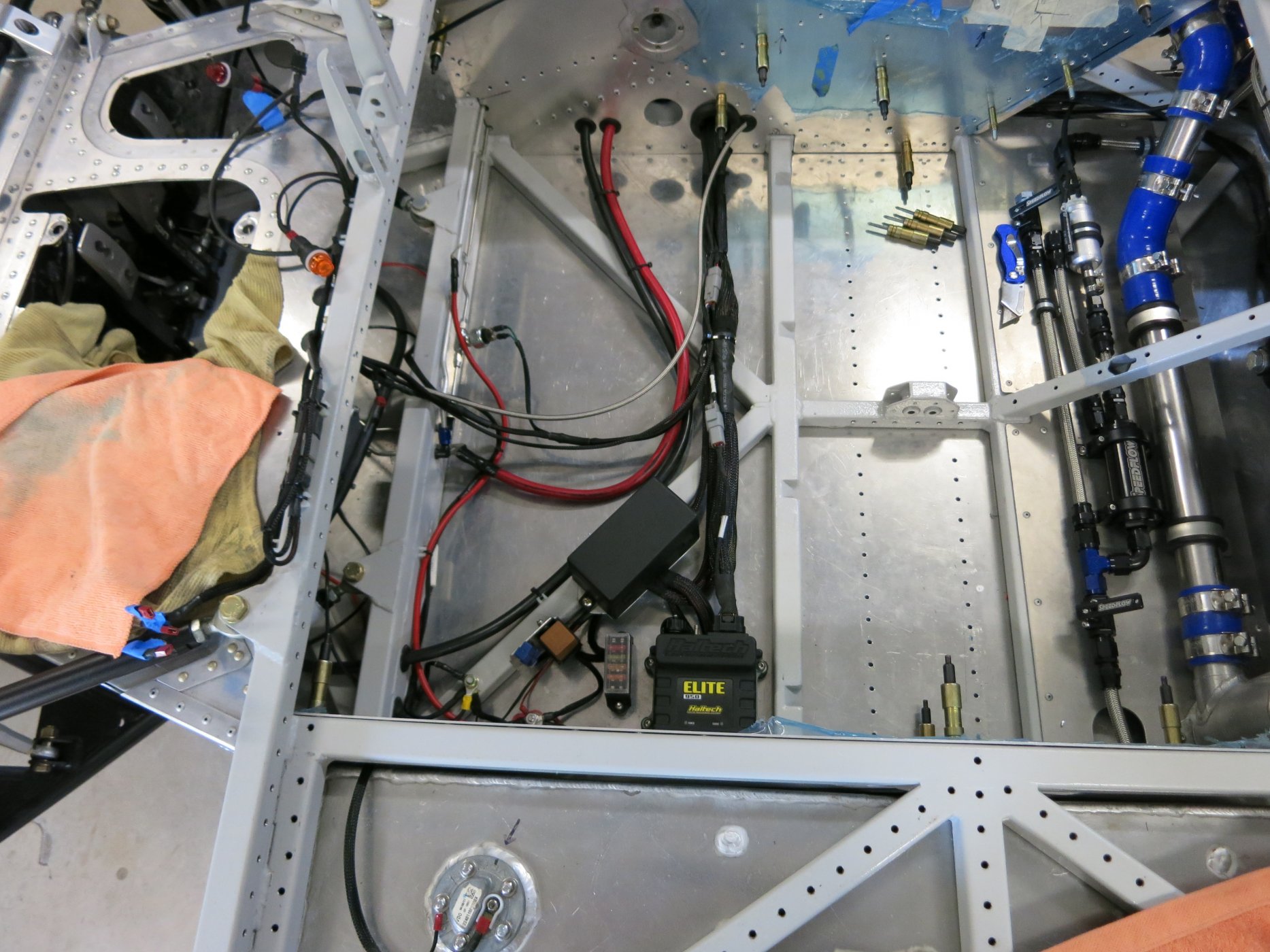

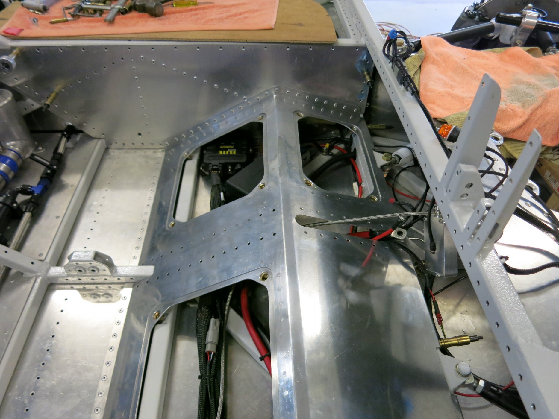

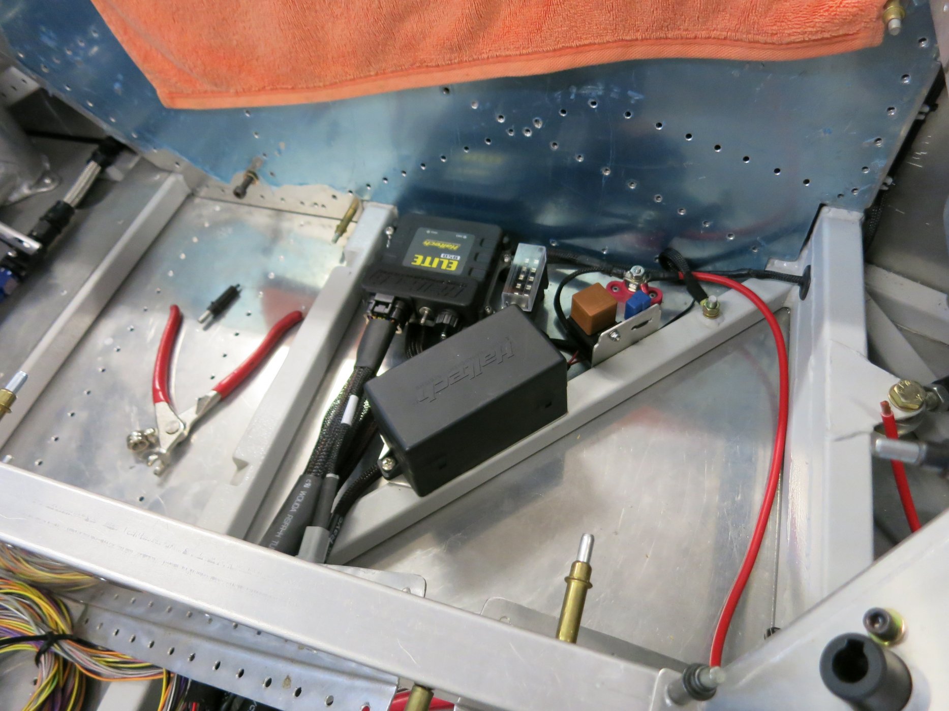

You're way ahead of me though. I just finished sorting electricals. I hate the stuff because I don't understand it. My good friend Clayton came to the rescue again and showed me the way. I now know what a lot of stuff does, how to crimp, splice, terminate, sheath, heat shrink, you name it.
I've been taught by the best. Even finished it off by myself in the end. All the depinning, and sorting out of the computer stuff was Clayton's Department. I have become dangerous enough as it is.

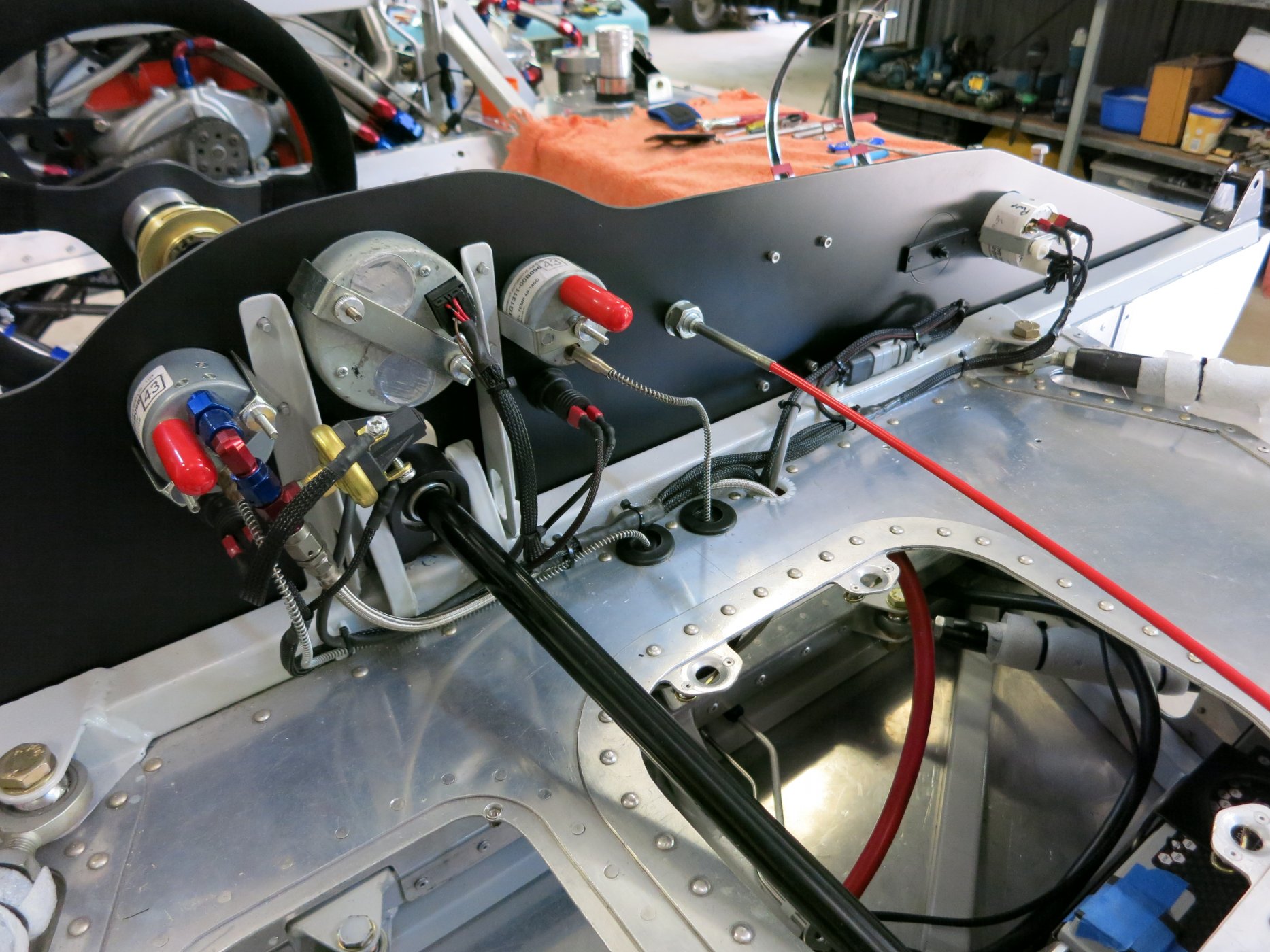

Now I can start fitting all the panelling, making sure it all fits over the electrical components and hides them away. Also making a start on completing the dash. a step closer every time. Next step is to tackle the battery box and trolley.

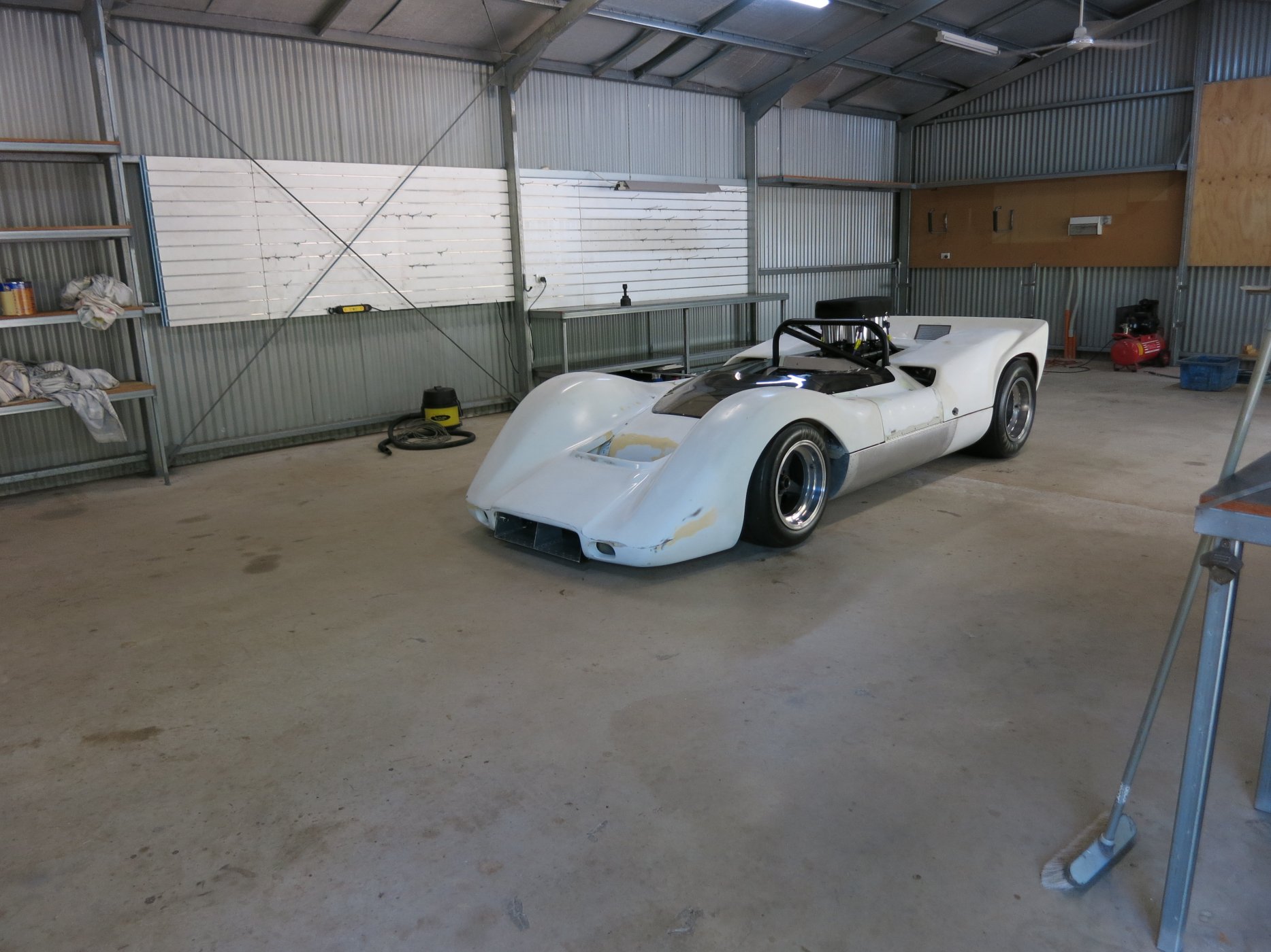

Hi Guys, I haven't been doing much on the car lately.
We decided to sell our property and move in a bit closer to civilization. Plus a much smaller and easier to clean and maintain house. We finally found something and snapped it up quick, but it only had a 4.0m X 4.0m shed on it. Good enough to park the mower.
Put our house on the Market and it sold that day, so we scrambled to move. Which meant pack up the McLaren and put it in storage at our workshop.

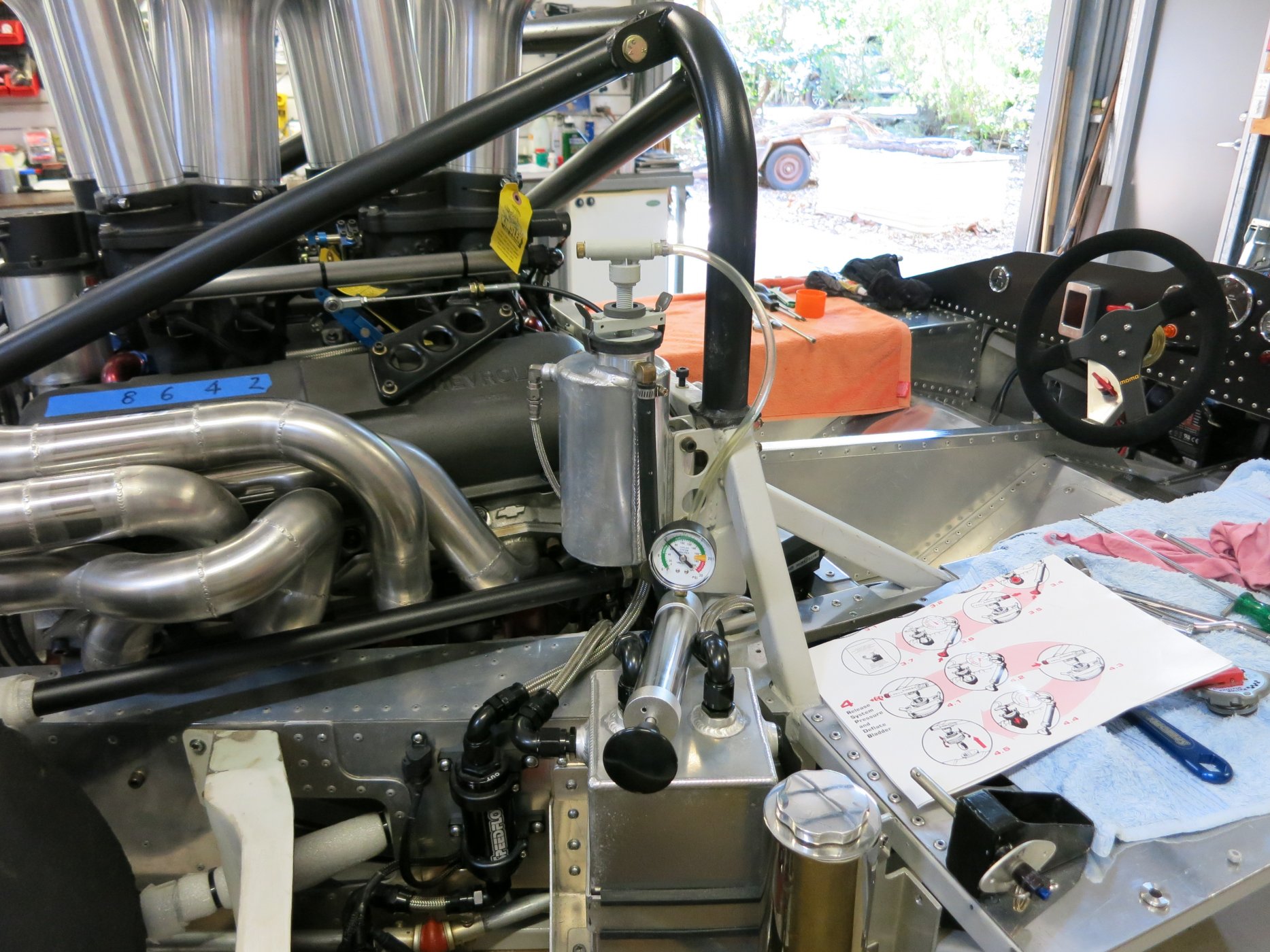

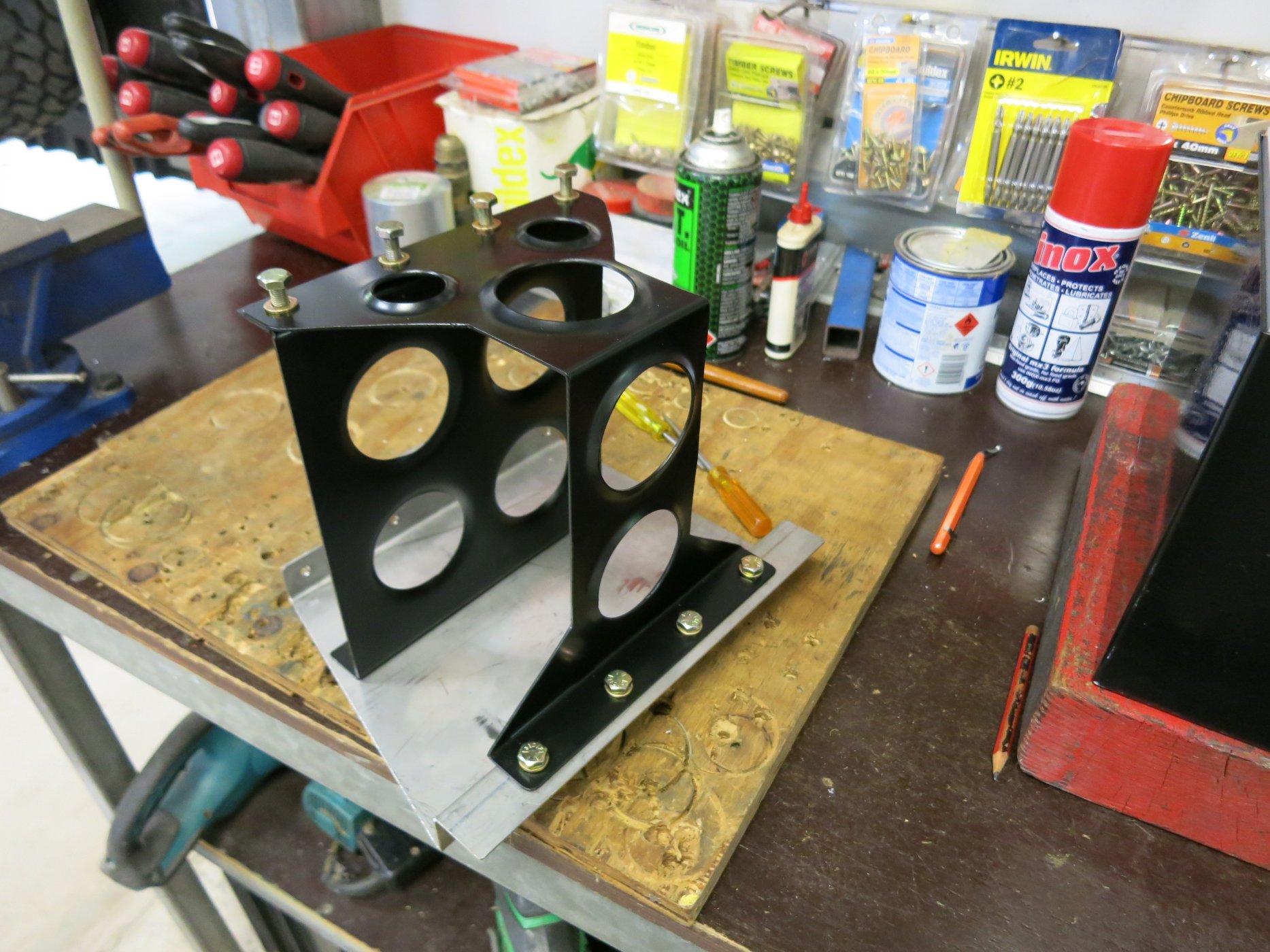

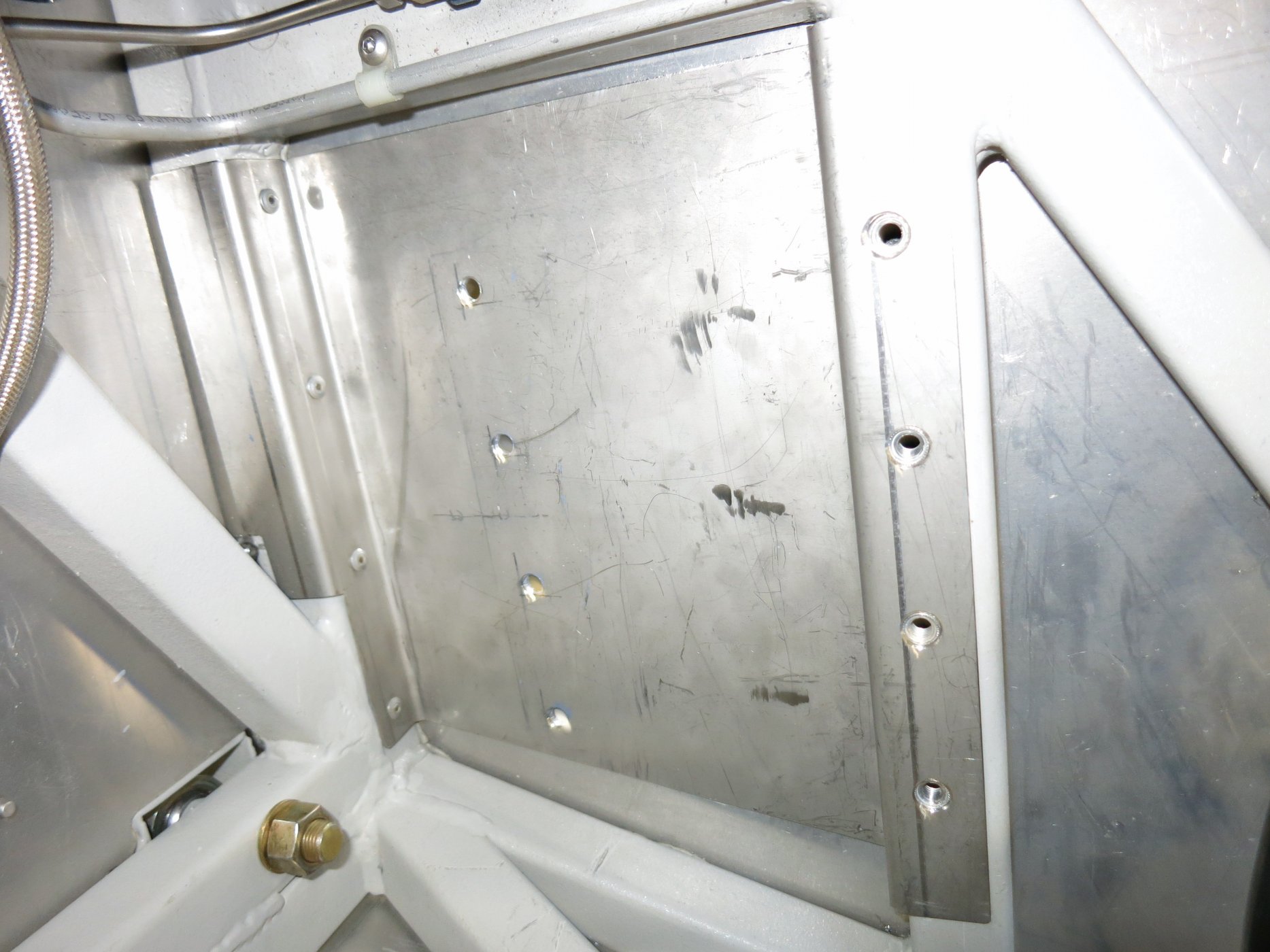

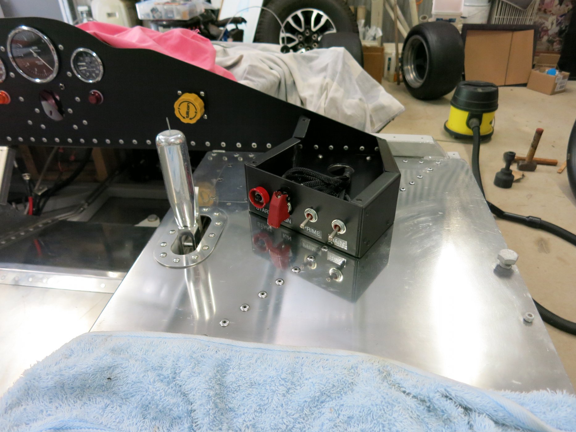

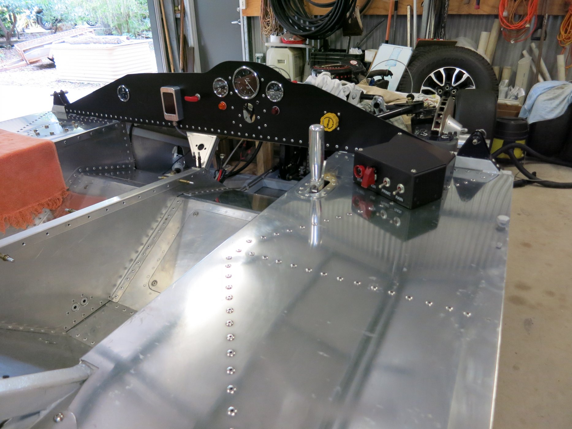

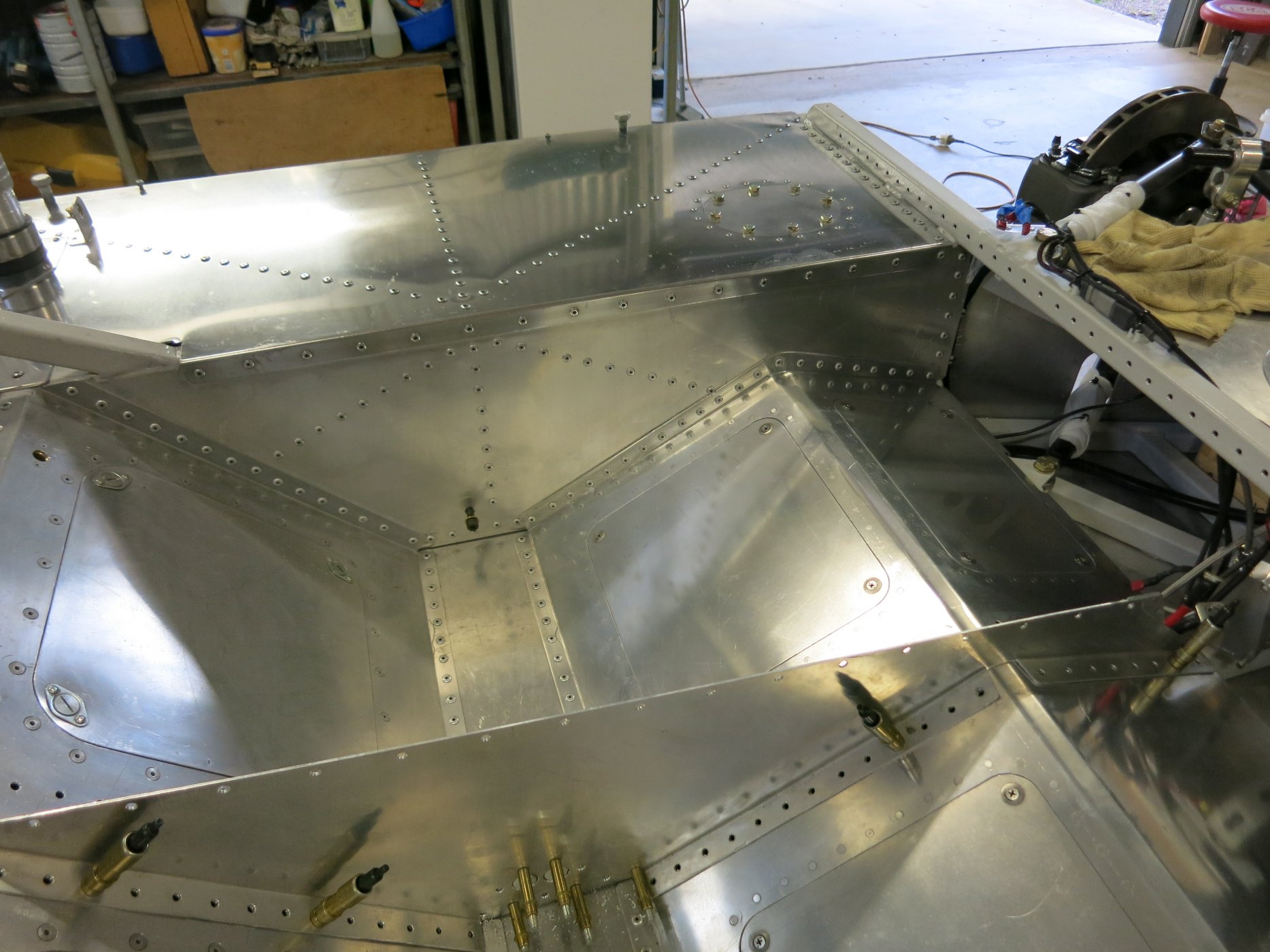

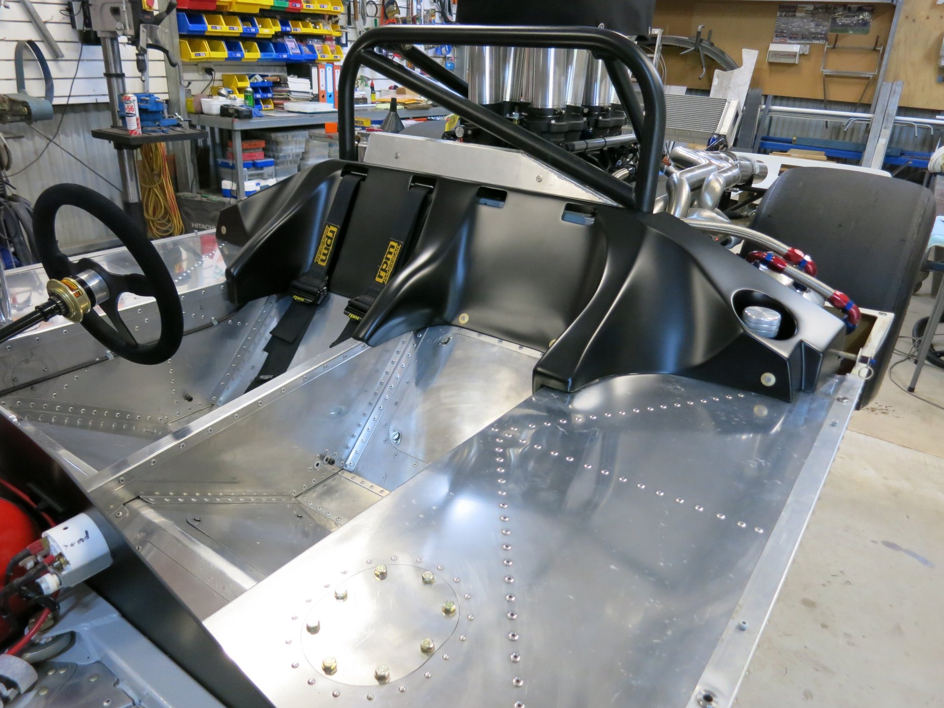

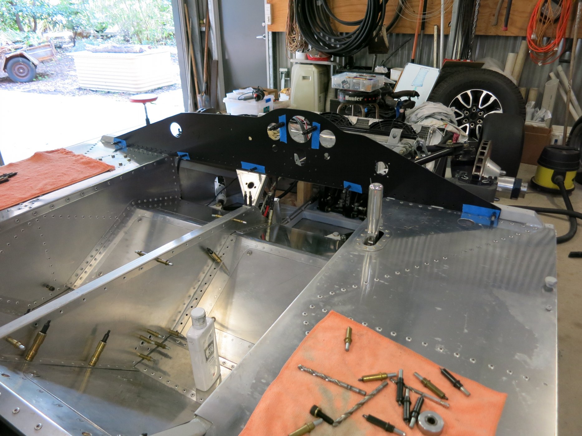

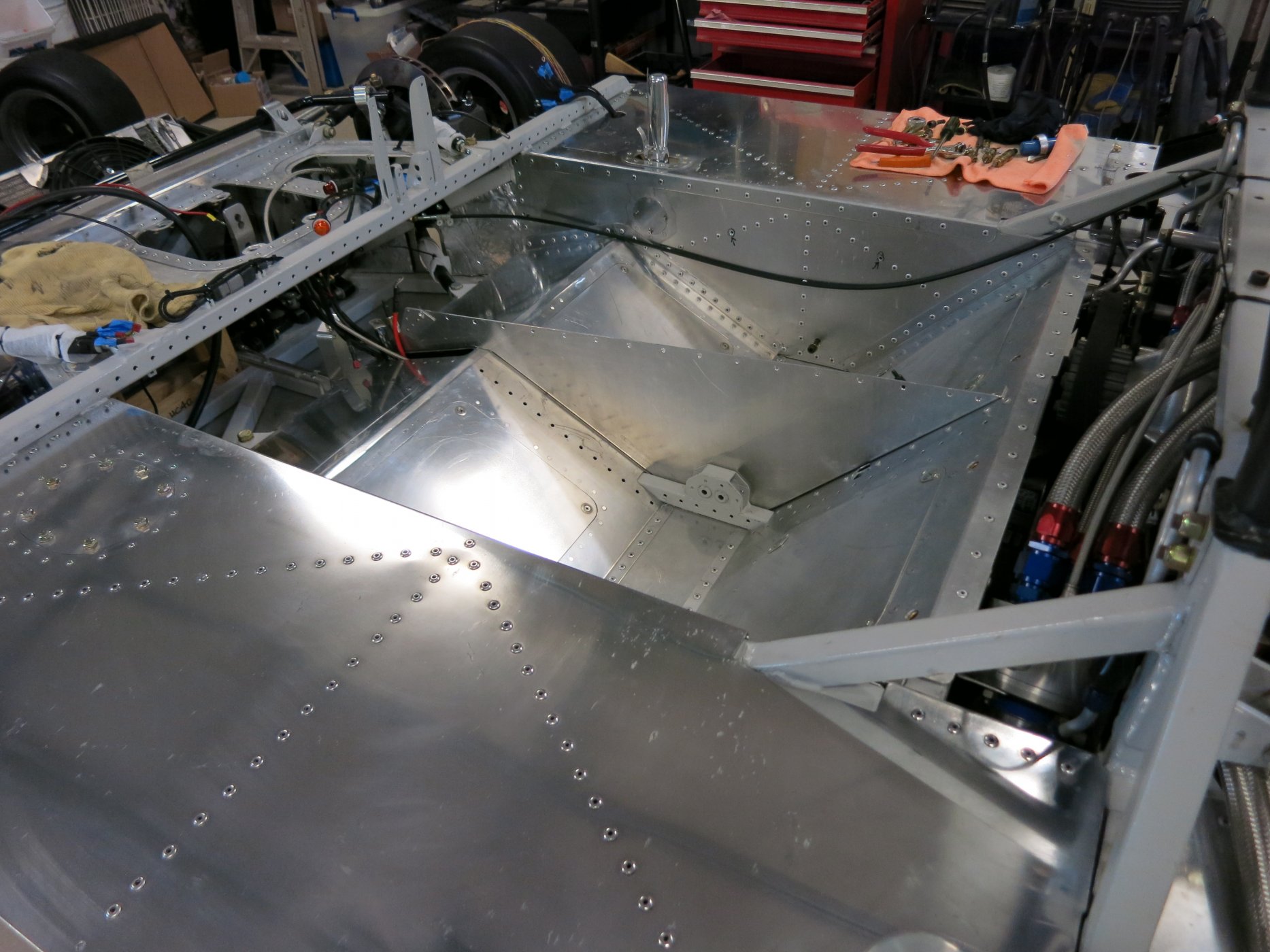

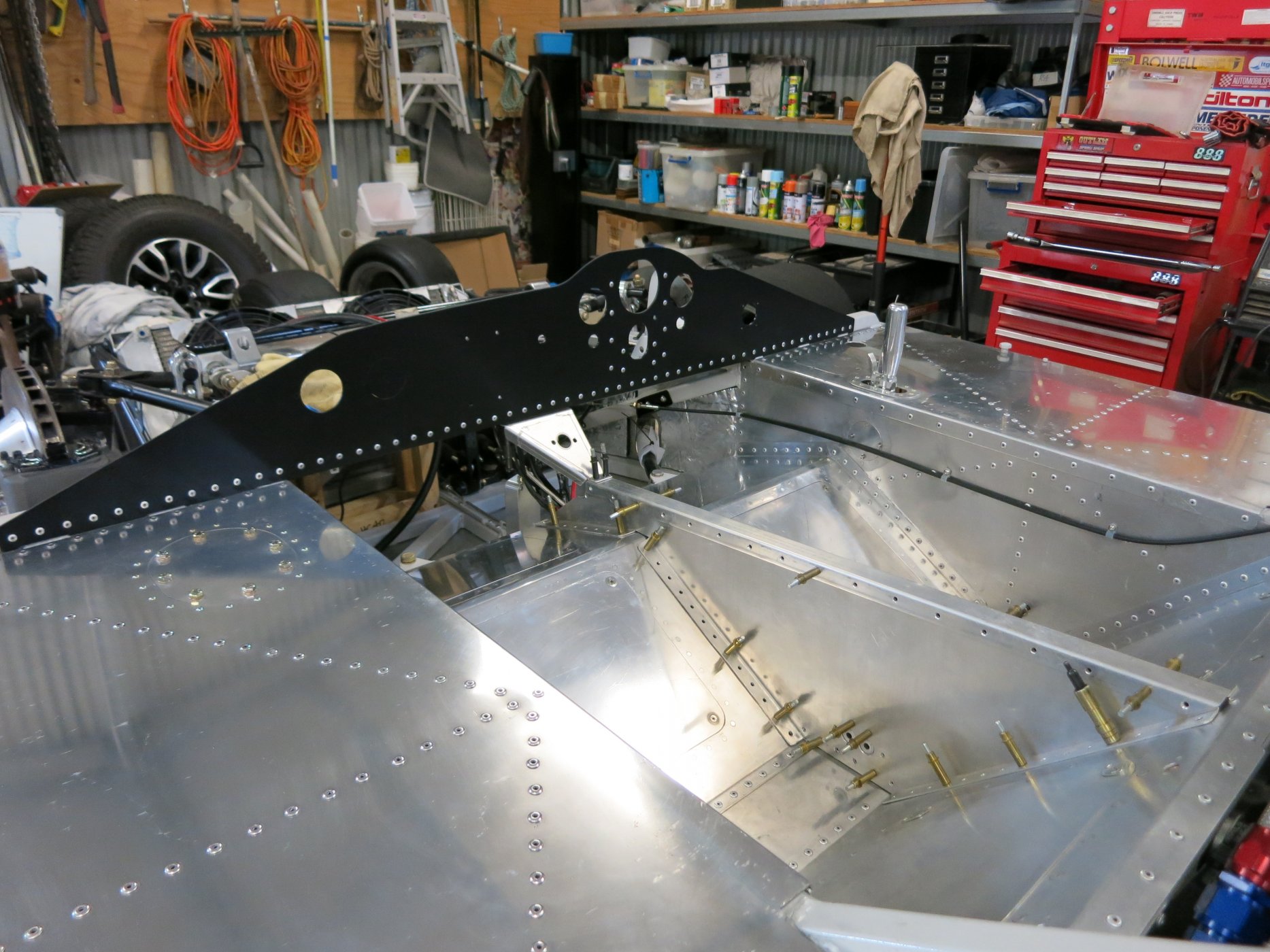

As you can see in the pictures, I made a battery box and reinforced the floor with some 2mm Stainless steel, tidied up the back of the dash, pressure tested the cooling system, painted the seat and put a series of solid rivets in the side panels to make them look monocoque.

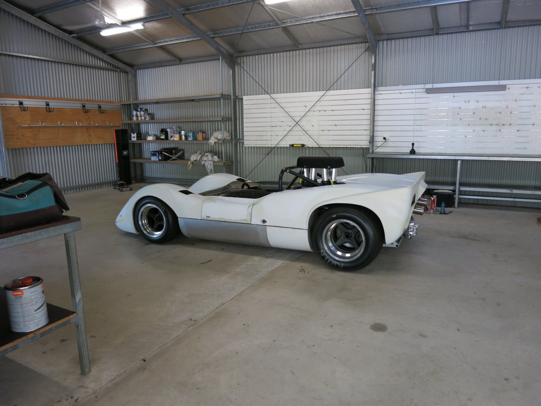

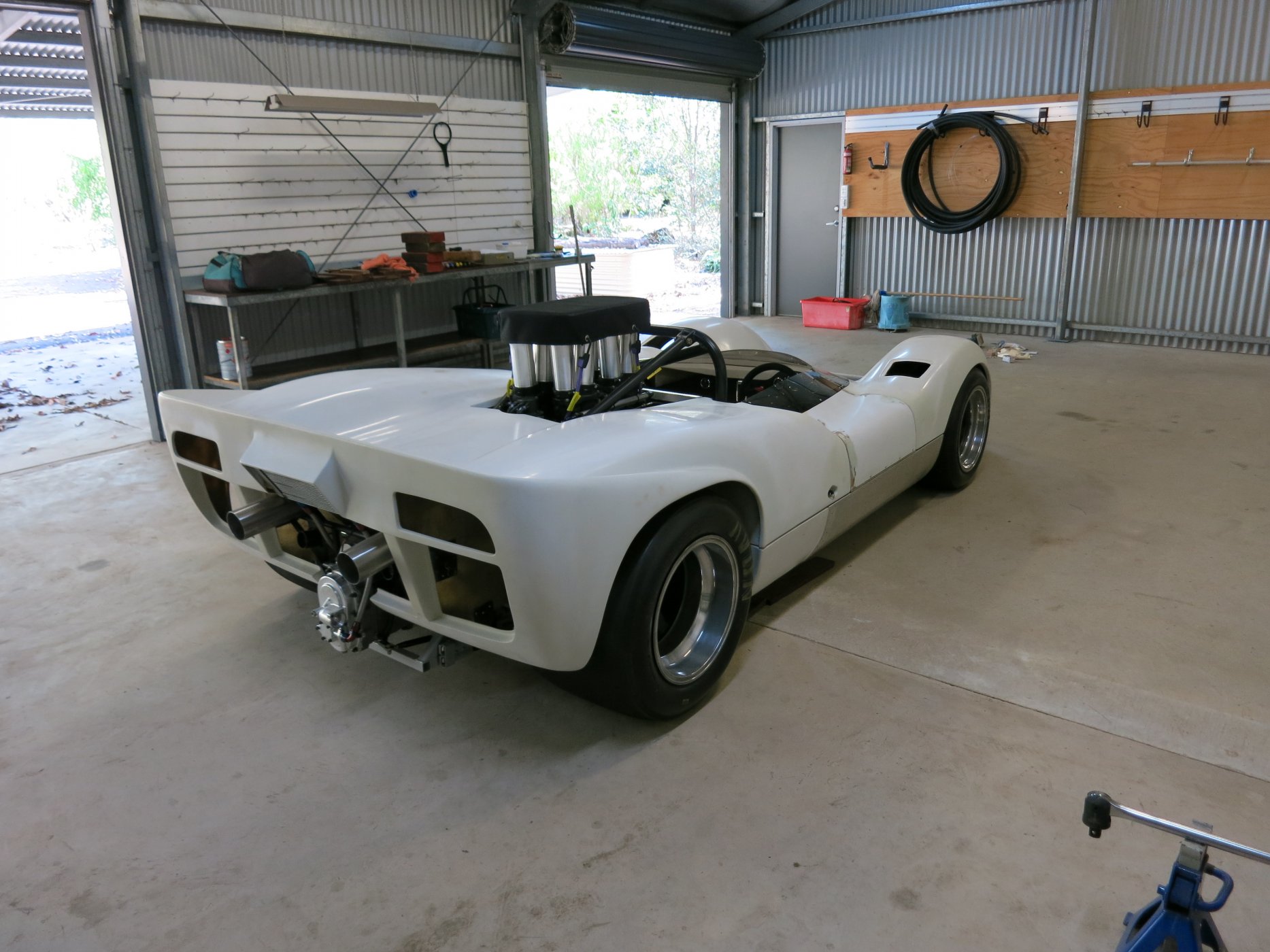

Then throw bodywork on and trailer to work.
