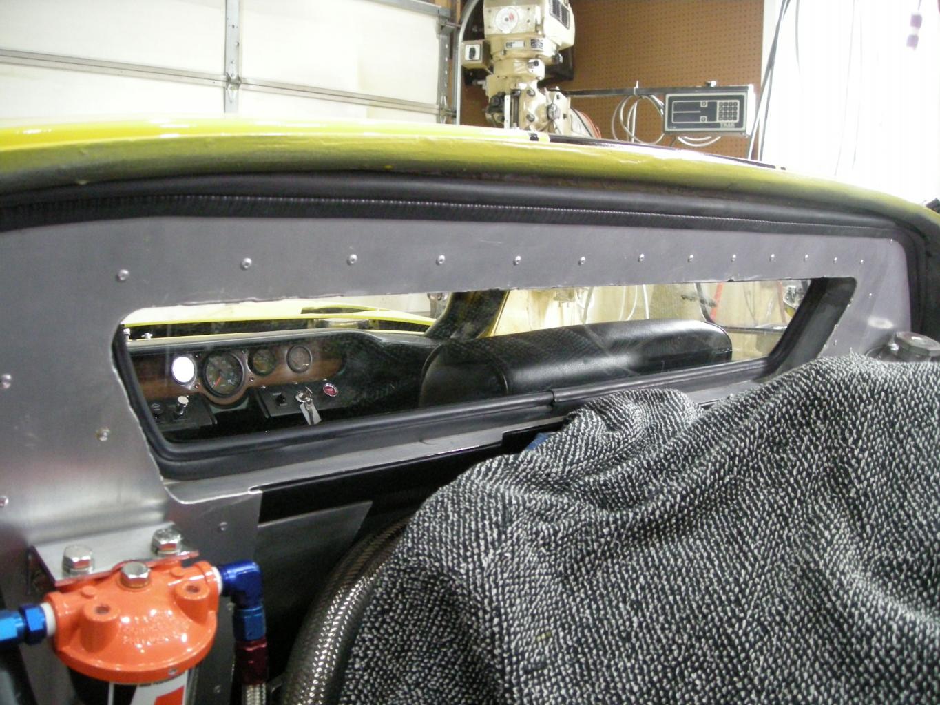

Fran is right glass is a better chose but use windshield urethane to bond it in it will be a lot stronger. I used the safety glass on mine but then used a rubber profile around it, check out the attached pic
Bob
