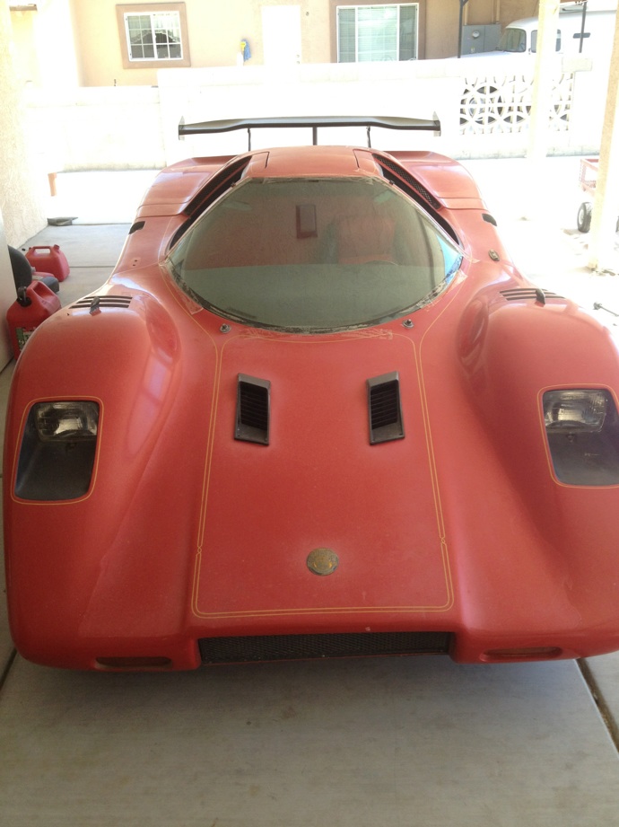

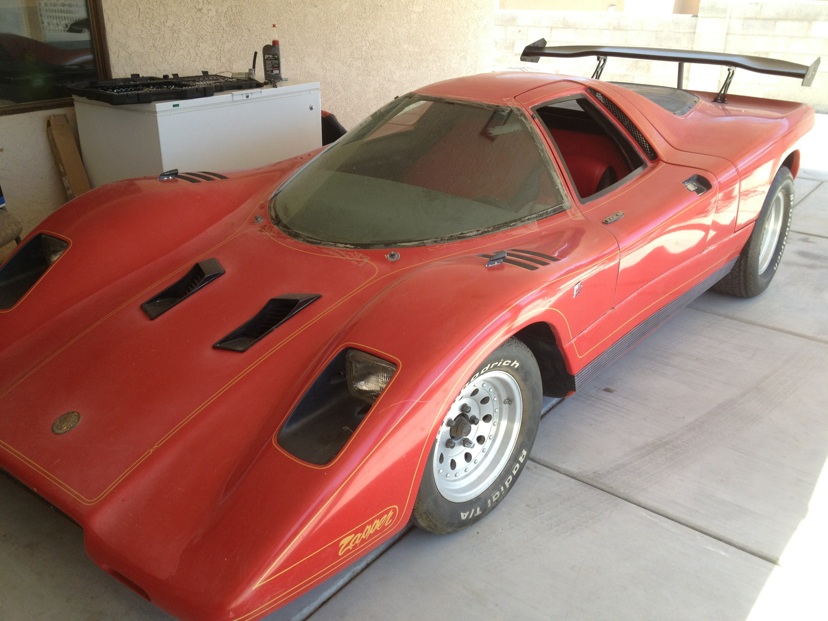

I picked up a Montage T about 4 months ago solely to flip for a quick buck. I brought it home and my wife absolutely despised it. I didn't plan on it being around long so she didn't hassle me much about it. That was until I turned down a reasonably fair offer from a local discovery channel show host here in Vegas. I feel I had good reason to turn it down but that's another story. Nevertheless my wife was pretty quick to point out my "mistake". Fortunately for me she has more faith in me than I do, so when I told her I was going to restore the car she semi-reluctantly agreed to let me do my thing.

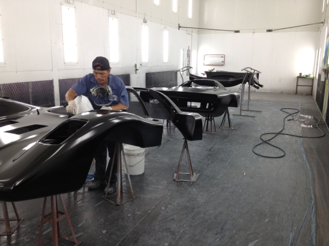

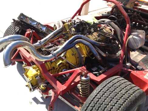

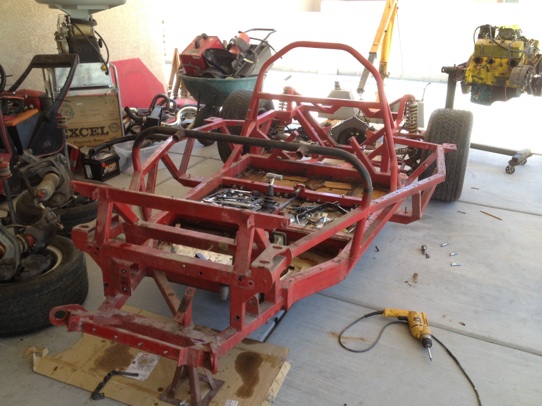

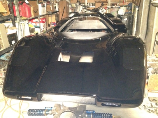

I will get some pics up. The car is completely disassembled, body work was completed and the paint is fresh. The tubed chassis still needs to be modified to accept the new zf transaxle along with the 383 stroker. Originally the car had a 914 5 speed mated to a 229 chevy v6. I have not yet purchased the 383 but I do have the zf. I can only complete the work as I have the spare funds to do so. Right now I have a 68 convertible vette that I need to offload in order to get the funds needed to complete the build.
This should sum up my knowledge along with the build thus far. BTW, since the new paint and body work was completed, my wife completely adores the car and she herself said it is going to be difficult to let it go.
