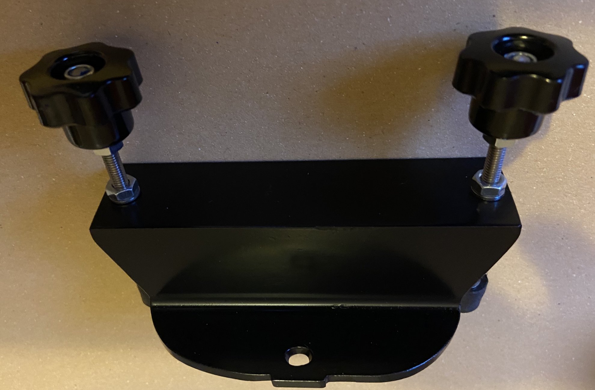

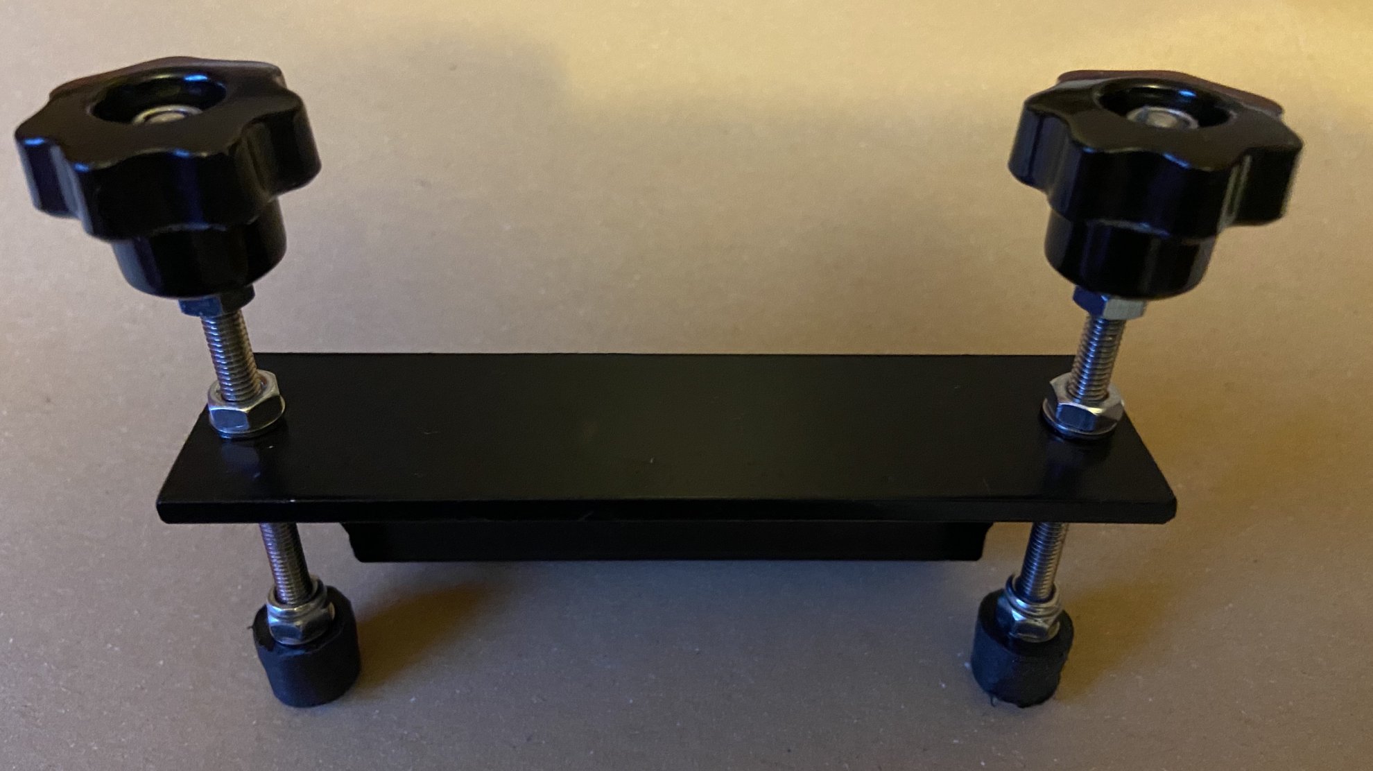

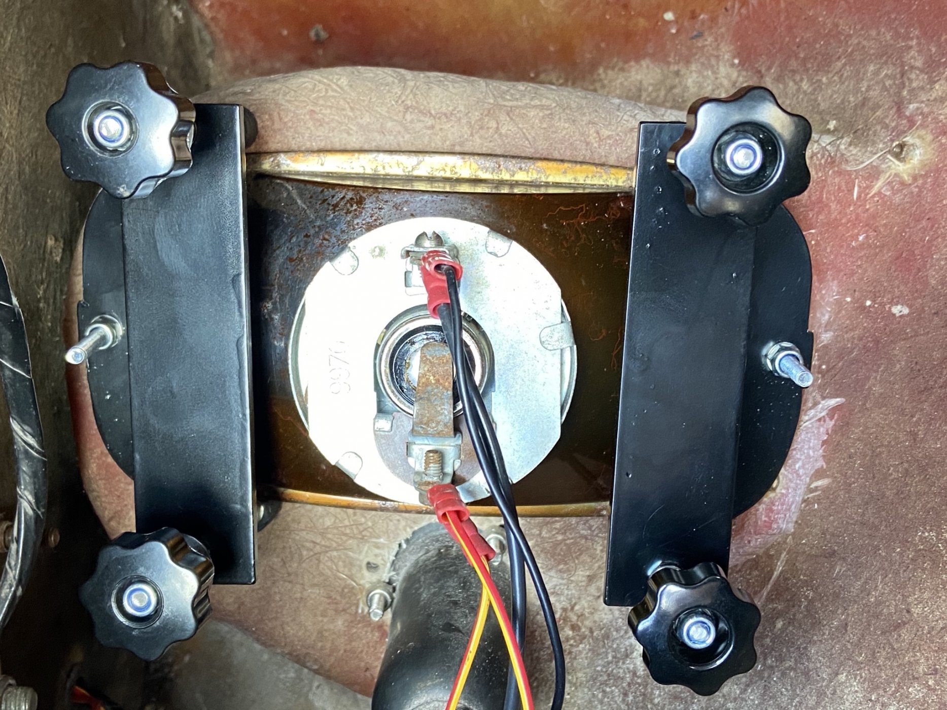

I have just tried a few things out and need to pack the bottom out by 8mm!
I would like to fit some form of adjustment, rather than a fixed plate (plus an 8mm plate is rather a lot).
I will have to give it some thought
