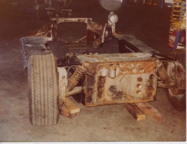

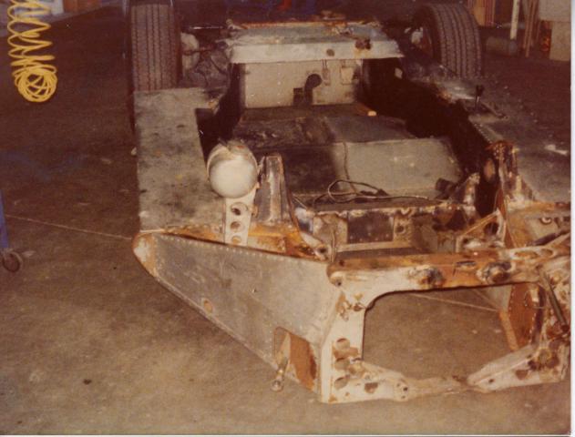

For info, I have attached two images taken in 1975 of the chassis no. 37. As you can see she is a Mark II with R & D mods.
You will notice that the fuel pods, centre bulkhead section (which has been heavily strengthened in steel) etc etc had been modified well before this time.
I have other photos which show that the roll bar towers have been modified to allow more room within the engine bay.

Seems a simple matter if you can prove (within reason) that the chassis in the pictures is 37 and also the basis for your current chassis. If it were my car I would not go with a semi automatic even if it turns out to be 37, which I hope it does!
Yes, without doubt my car has the chassis 37, John Mason did an incredible job in restoring her and patching up her wounds which are still clearly evident today.
