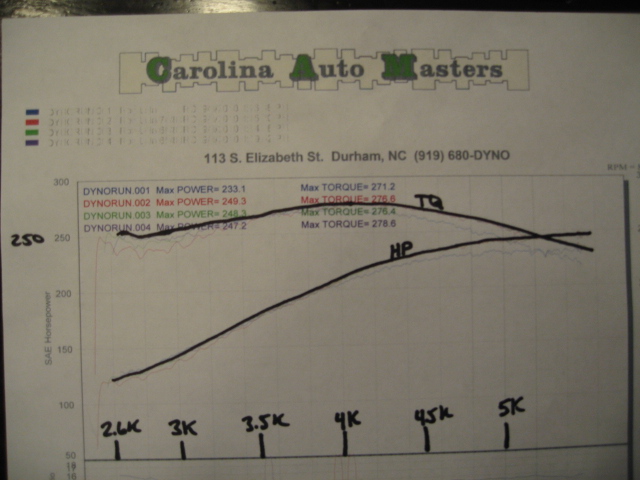

Here is the hp/tq plots. Not bad. from 2600 to 5000 RPM we have over 250 ft lbs of wheel torque available. And, that torque converts to 200+ hp from 3800 to 5800 RPM. All in all I'd say a very tractable and drivable curve.
Previously, we only tested with about 200-210 rwhp available so I hope the added hp pays off with decreased lap times. We're into the upper end of how much hp we'd like to have going into the preps for the 13 hr. Too much hp drinks too much gas.

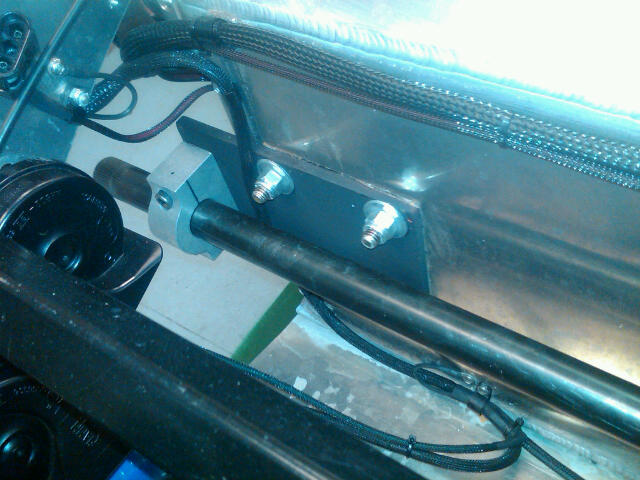

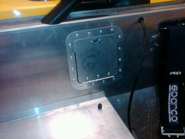

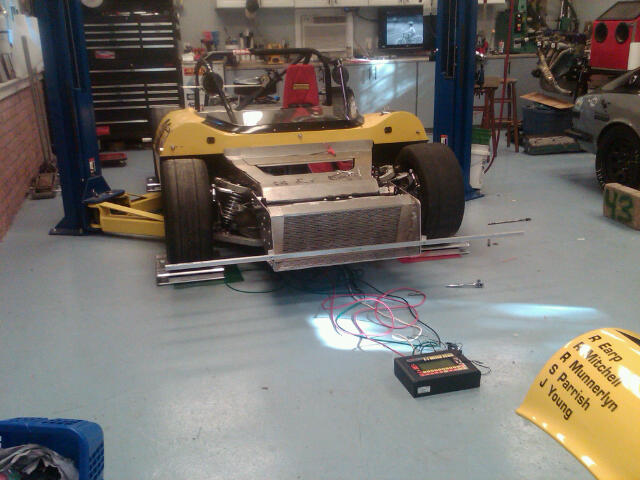

We have made great progress since Friday - two days with 28 man hours of time in will do that!
We now have the car re-aligned to specs that we think will improve performance of the car. As most of you guys know, aligning these sorts of cars at home with all the possible adjustments you can make takes a lot of time. It is no wonder that race shops will routinely charge four figure sums for setup and alignment. Here is what we're rolling with for the next test session:
Ride Height:
4 5/8" Rear, 4 1/4" front
Camber:
-1/2 degree rear (down from -1.5), -3/4 degree front (down from -1.5)
Caster:
6.4 degrees rear, 5.5/5.2 degrees Lfront, Rfront (not quite equal, but up at least 1 degree per side)
Total Toe:
0.10" rear; 0.050" each side
0.0625" front

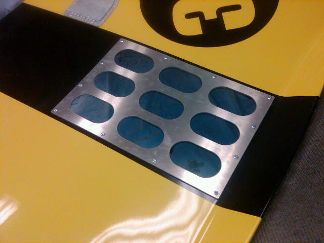

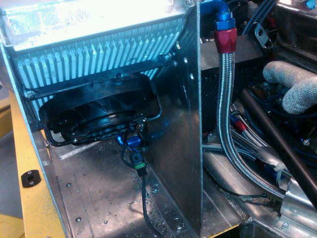

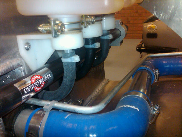

Besides the alignment we installed the oil cooler fan, a switch to turn off the transaxle pump, a rear louver for heat removal, relocated the pedal box for driver comfort, and a few other odds and ends. Very productive and quite efficient.
Here are a few pictures of the progress.
OH! And we found out that the throttle wasn't 100% open on the dyno runs from Friday, more like 80% open. So back to the dyno.

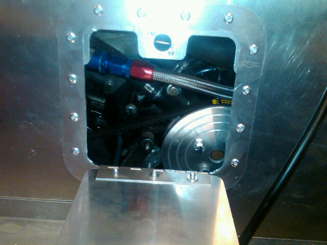

In between Sydney's soccer, lunch, gym, and some shooting I managed to install this access panel in the firewall. The timing was impossible to check due to access and simple checks with hoses and the belt were extremely difficult as well. This little access panel is sold under a variety of names and is well done for the price, around $25-28. I mounted it so the panel will fold down and the access to the front of the engine is fantastic. You could make one with scraps for nothing, but it was convenient to get the package.
Hey Alan,
I used this one on the external hatch on the rear clip:
SMALL ACCESS DOOR KIT - C73-490 at The Chassis Shop
It is very well done and extremely high quality.
The timing door you can get from Jegs, Summit and so on. I bought it a few years ago and had it sitting around. Here it is but it has gone up in price:
Moroso 85700 Moroso Access Door
It isn't as high a quality but is large and works well. Surface mount all the way on this one, while the Chassis Shop piece is meant to sandwich your firewall or body. Chassis shop piece looks a lot better if that means anything.
