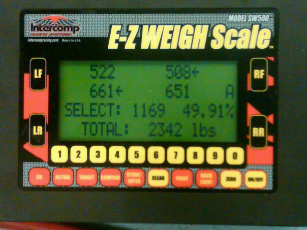

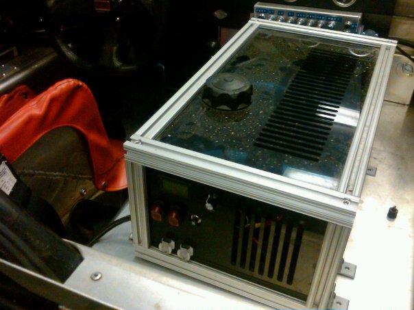

We've also added more weight to the car in the form of the DR COOL in the passenger side of the car. The DR COOL will be needed though as July at VIR is damn hot. Scale setup is shown with everything installed and we ballasted up for a 200 lbs driver this time around using cinder blocks and dumbbells. 9 gallons of gas, so about 5/12ths load of fuel.

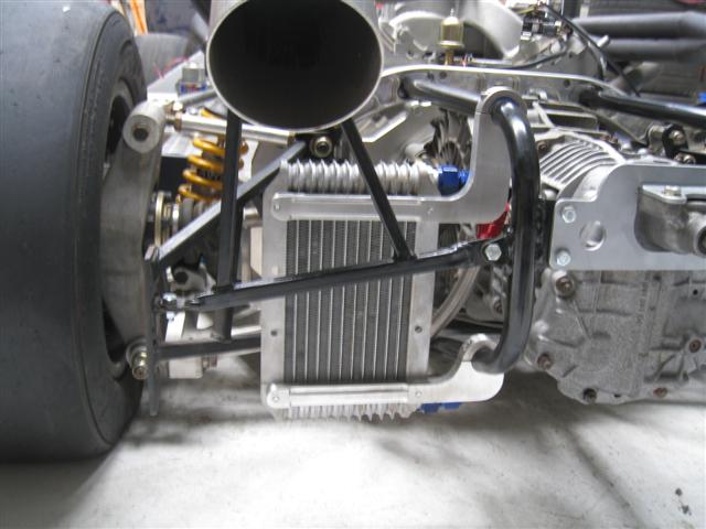

OH! And the dang ol half shaft angles are way down. When we set the rear up again at the lower height these were very much improved - down to 11 degrees from essentially 17-18 degrees. Much more tolerable. I think I've banished all thoughts of flipping the transaxle because if we did that we'd end up with basically the same thing, about 8-9 degrees, but more problems if we wanted to RAISE the car.

Chris, you guys dry sumped your Chebby motor didn't you? I suppose you never had any problems with half shaft angles out of the 930?
R
flatchat(Chris)
Nope and no -- Poor mans dry sump, ("accusump") remote cooler and filter.
Don't worry about the drive shaft angles ! We run approx 3° for / aft and 8°-12° @ ride to droop --just make sure you have QUALITY CVs and boots

We've got the best axles, CVs, boots, grease, cages etc as we could find (detailed on other threads) so I think we're going to be fine with these half shaft angles. Probably would have been fine with the 17-18 degree angles too.
