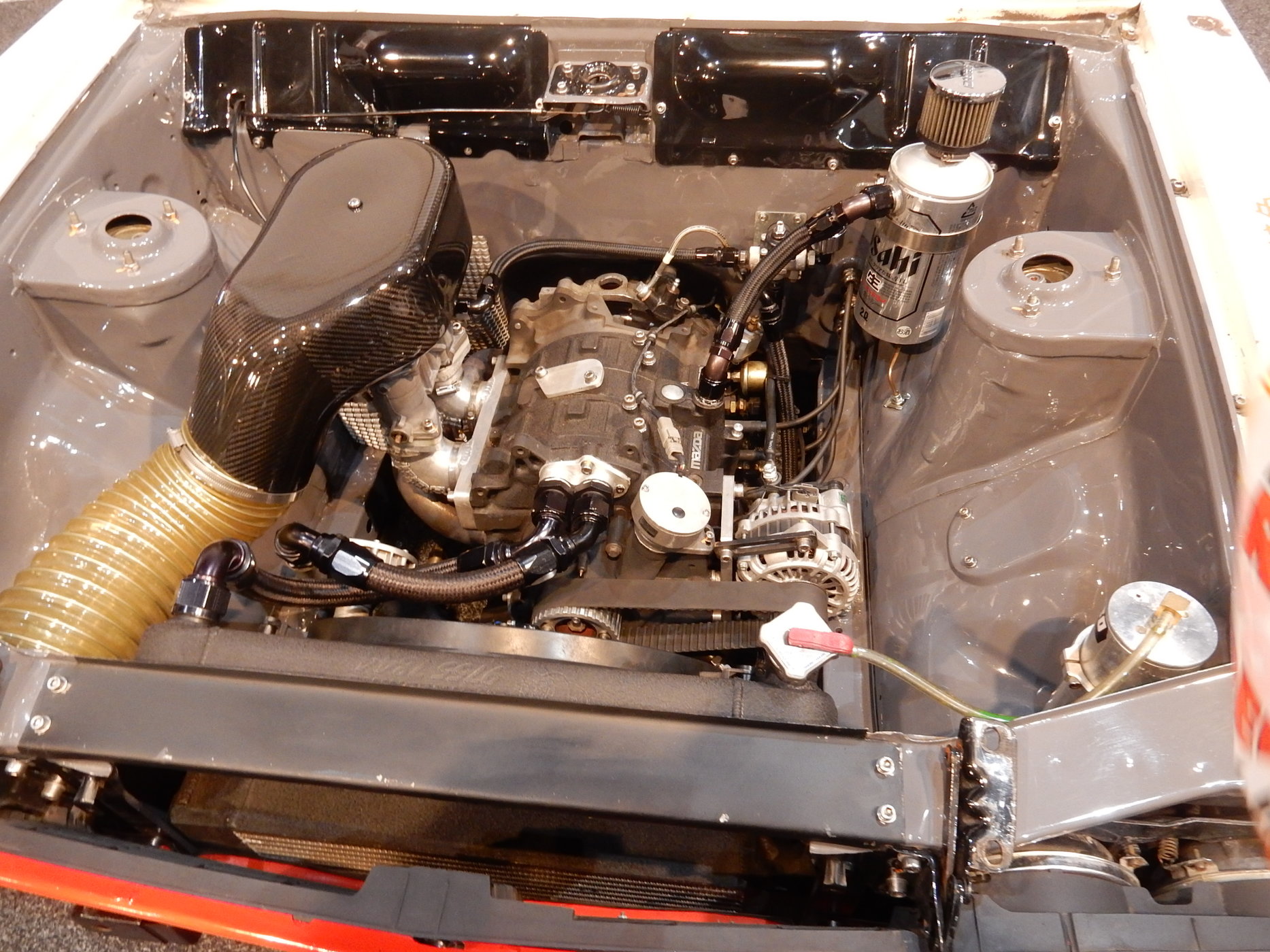

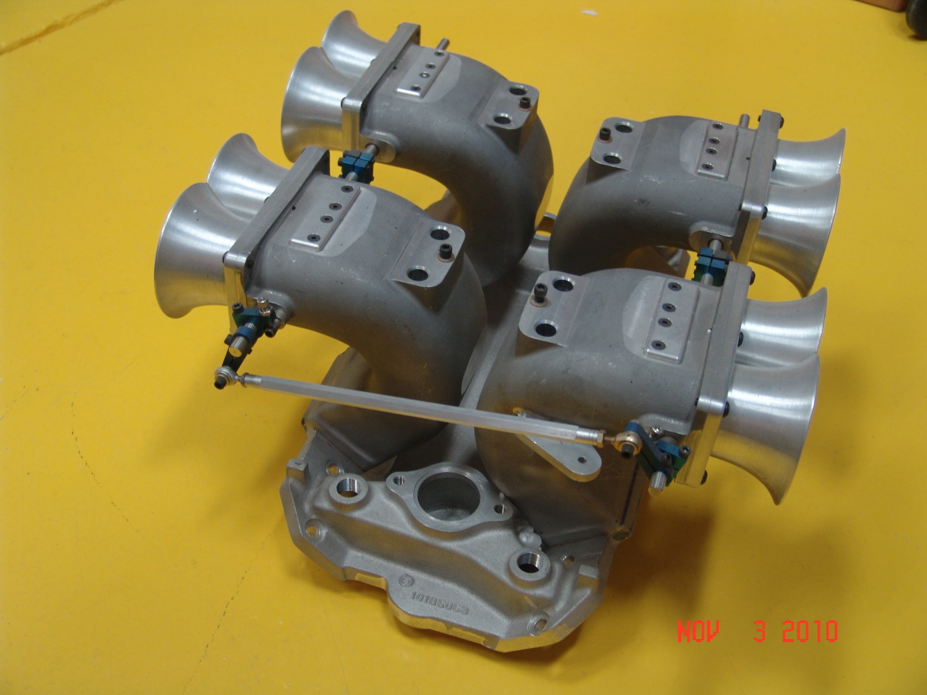

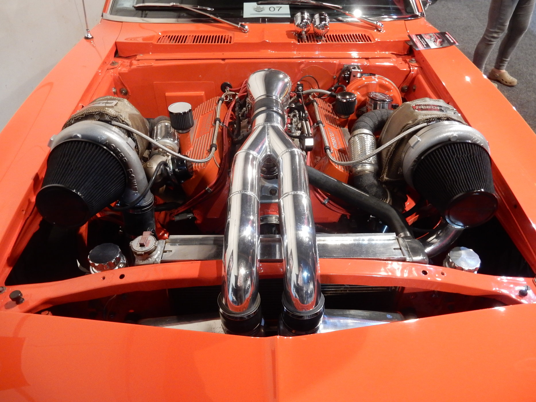

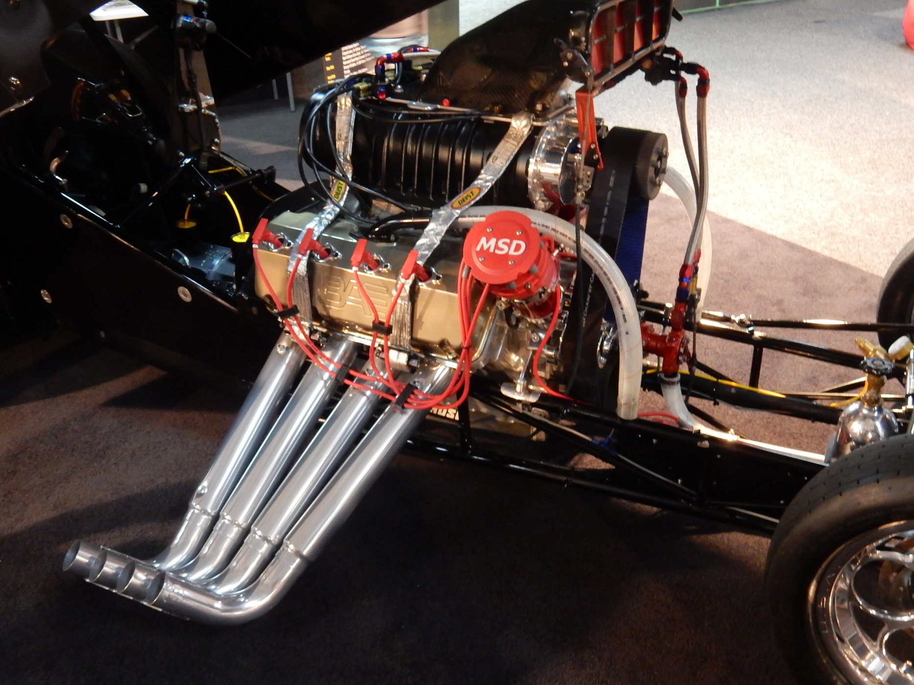

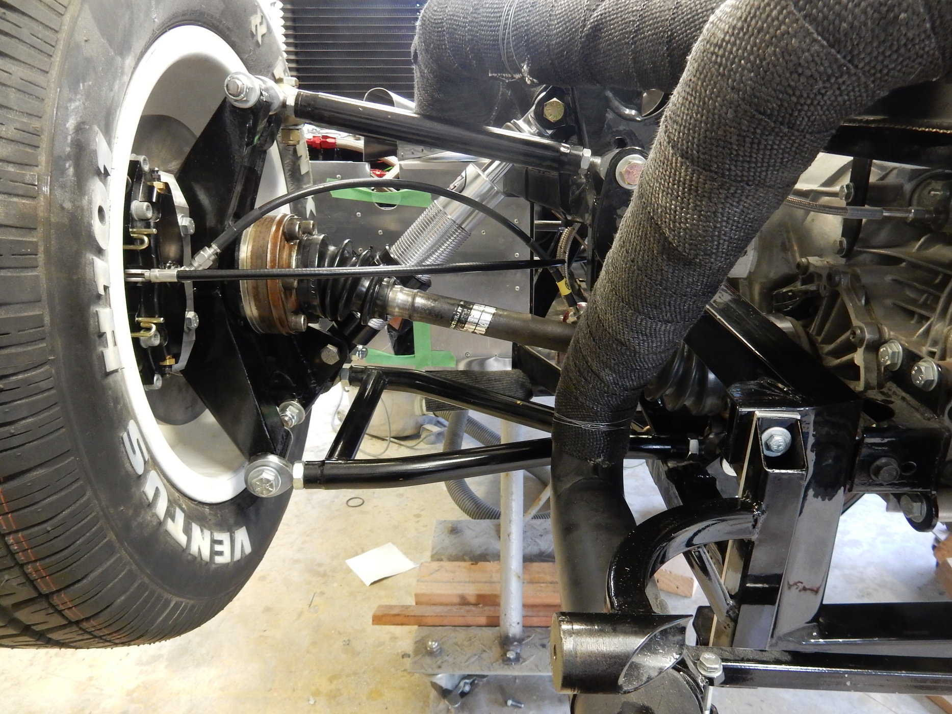

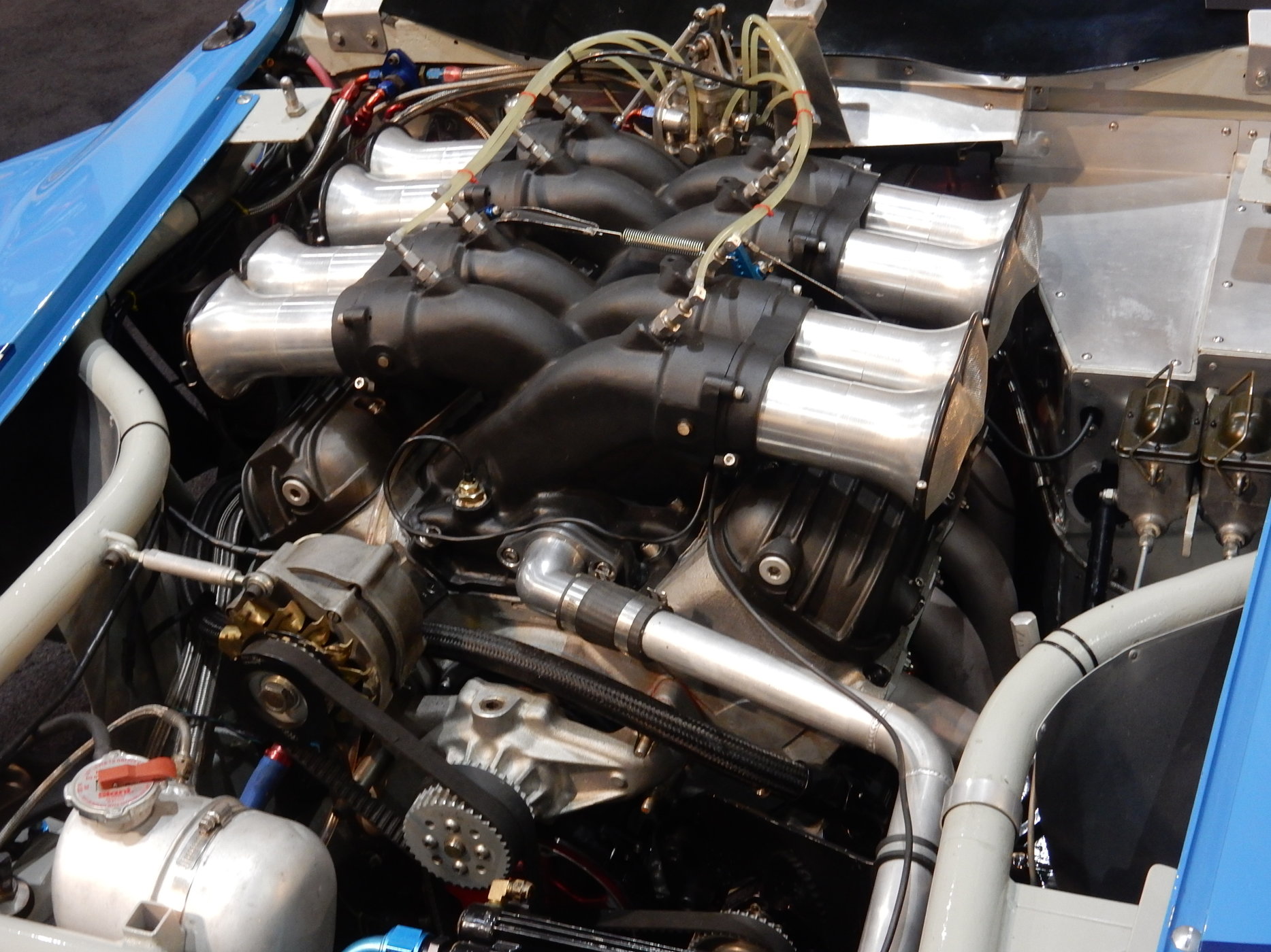

Just been to the Speedshow here in Auckland and maybe its time for a motor change, which one do you think would be the most suitable. Cost appears to be no problem.. DSCN4492.JPGDSCN4486.JPGDSCN4498.JPGDSCN4488.JPGMy axel`s might say otherwise.
Neil
Russell;
That intake manifold you show in your second photo is a little like one I bought from Erick Falconer a number of years ago.
Regards, Neil Tucson, AZ

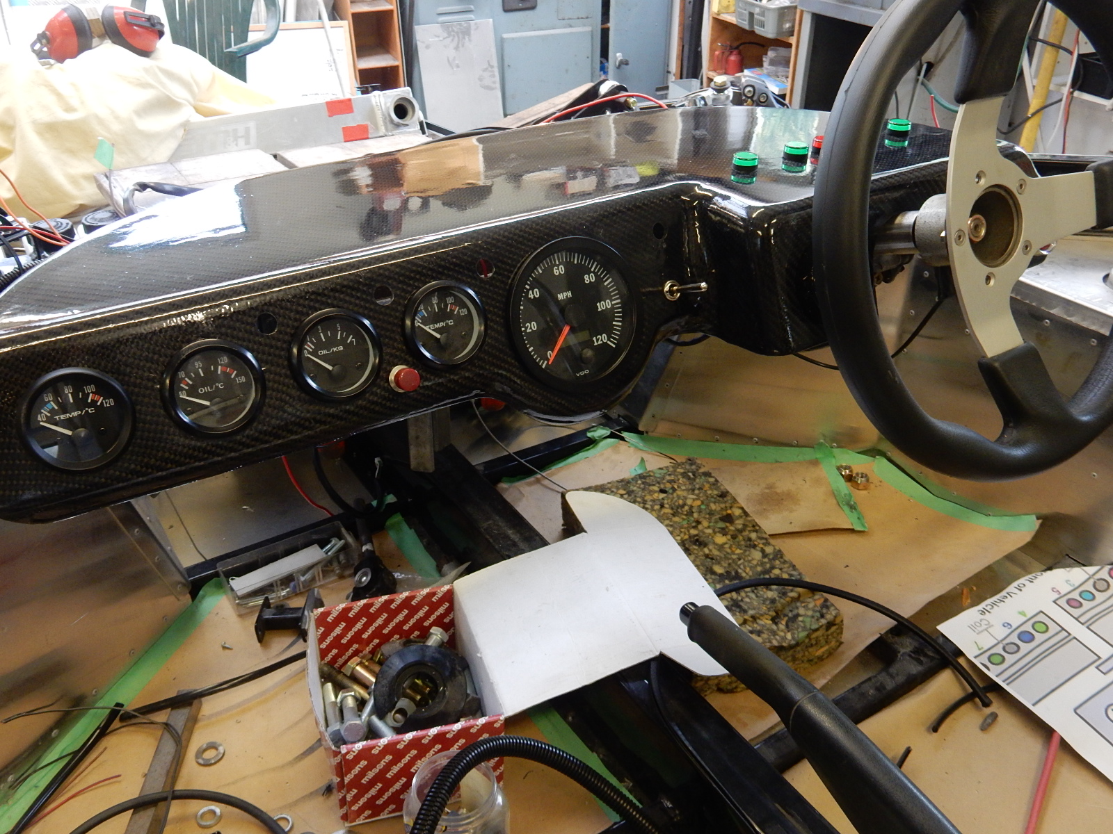

Just in case you thought I had gone to sleep... Finally my dash is completed, I went the male mold direction and struggled with my surface hence about 8 recoats. Meanwhile most other parts are on hand or due in the next few days from being machined.(Radial brake mounts and steering rack adaptors, rear axel adaptors) Made a good job of fitting off the rear brake hose mounts.....stood back and then thought...ok where are the axels going to fit now? just a small remount required.

As I had previously half wired the car, now I can complete the wiring thru the dash etc.

Sorry to disappoint you but those `happy` dash lights (pc correct answer) are green left and right turn indicators, red ignition light, green lights on and blue hi beam. I got them on line and they turned out a little larger than I would have liked.

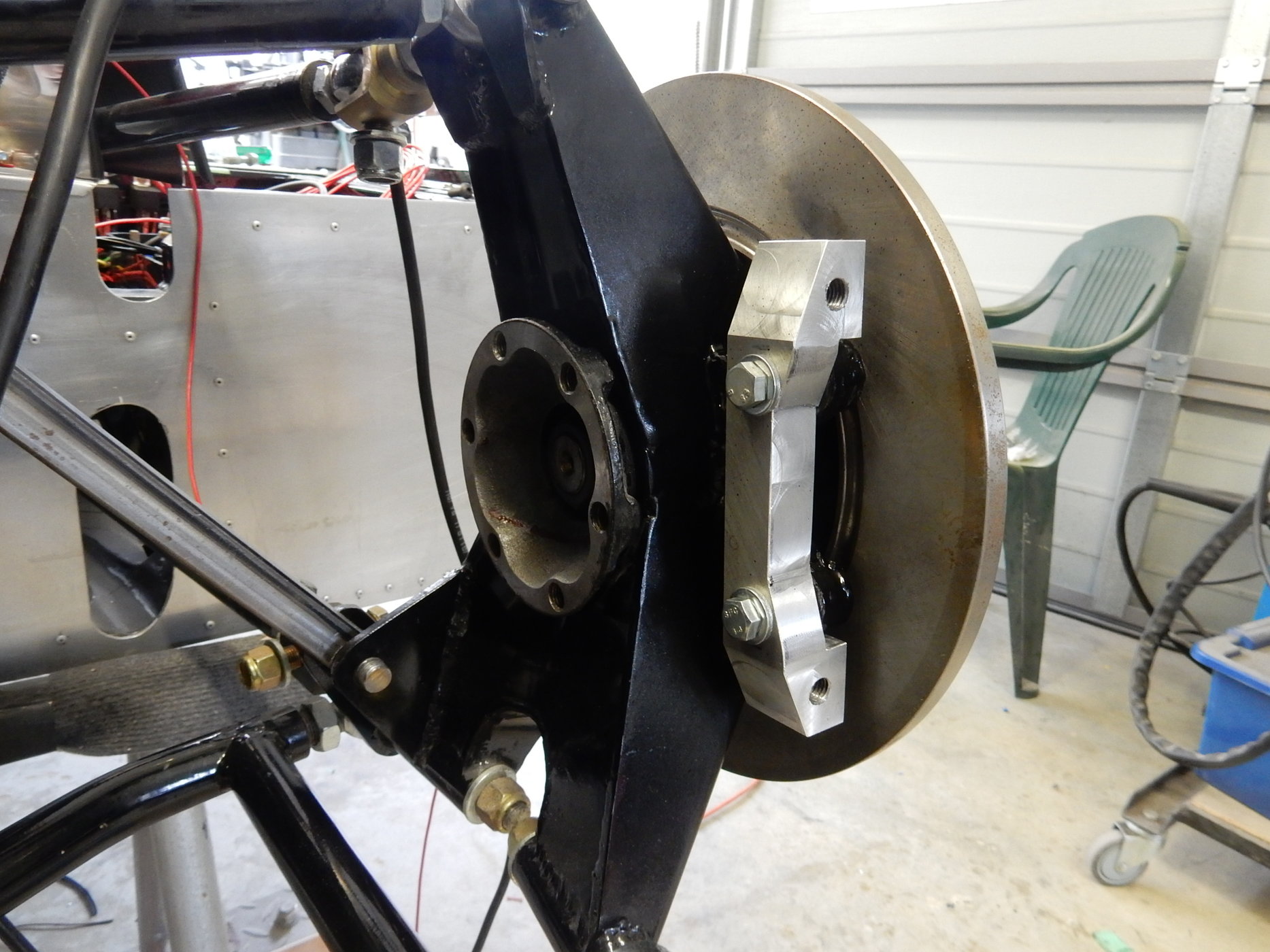

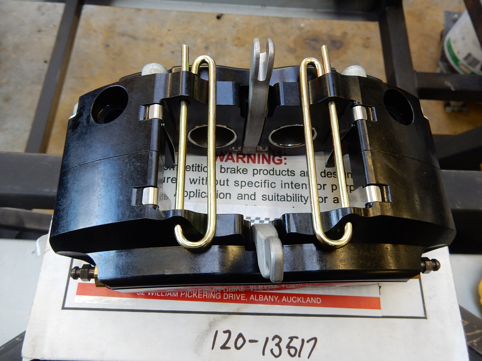

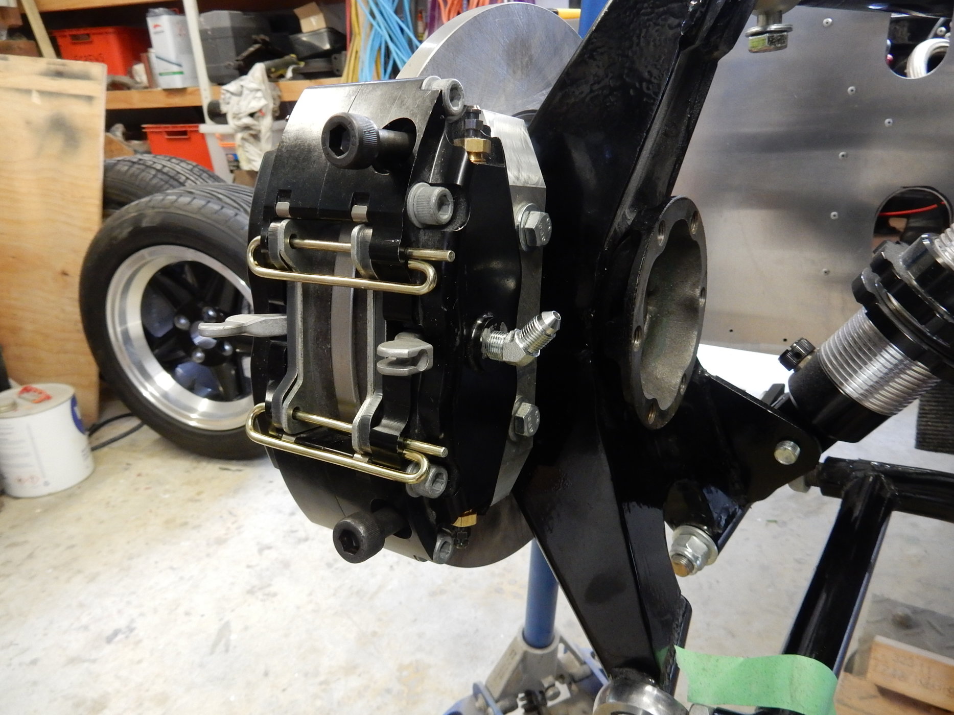

Finally got my Willwood Radial caliper mounts finished and mounted, took a bit of blind faith using my eyeometer for fit...all bolted up straight and true. These calipers do not seem to be listed at Willwood which is a shame as they are far superior than the seperate little round puck units.

Mate looking good i do like those calipers, have you got a part number for future reference.
cheers John
John, from memory they are a bit of a mystery being as not listed on the Willwood site, I understand that they are only available in NZ from Cardwells or in the UK. As you can see, the part number is written on the box. I had a great crowd in CHCH do the cables at a rate less than originals! They have a very effective purchase on the pads for the hand brake.
I could help with the NZ side if needed.
IIRC they were available thru some of the Rally car outfits mainly due to the provision of handbrake mechanism, Not a big seller in speedway & circuit sector of market.
Are you not confusing them with the small round puck caliper? as these appear to be much better with greater leverage and pad area.
