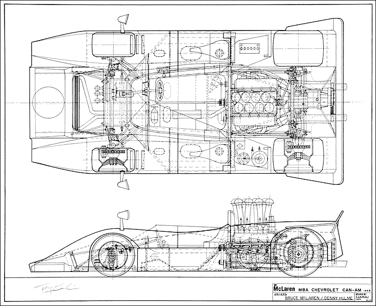

The bodywork is 80% scratch-built, (back in 2009-2015) like you did with your McCopy (or Leon is doing with his '20)...nothing new there. I used the drawing below, scaled it up (1mm = .8") to make the panels (and used plastic models of the "B" as well as hundreds of photos), and then added slightly enlarged "B" side scoops off of an "E" that I measured.

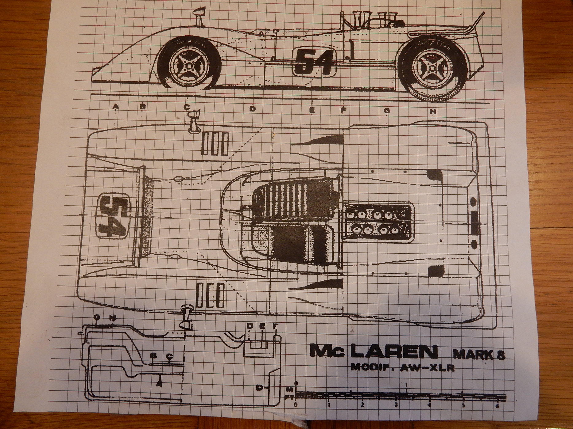

I will dig out my M8B picture which was down loaded from a slot car site in 2005, well before I started on this process as it had profiles and that is what I used. As you say, its quite a process doing the buck.
Terry
The only pic I can find at the moment is larger than A4 so have taken a picture....let me know if you want a more accurate file. As for attachment, there are some very nice cheese head cap screws that you could also use if you wanted it removable. I have towed the car on a trailer with the high wing fitted at over 100k`s without any hassles.
Russell

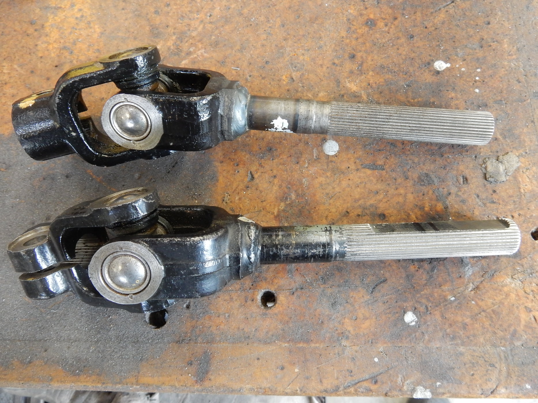

Different story...I was questioned on whether my steering parts were standard production and welding, it was suggested that I went to the wreckers, found a Corolla, took pictures of parts and car and that would suffice. Went one better at the local Toyota dealer. He went online, found the parts diagram and vehicle fitment list, copied to me and signed my picture of the parts. Very helpful. That should keep the cert system happy.

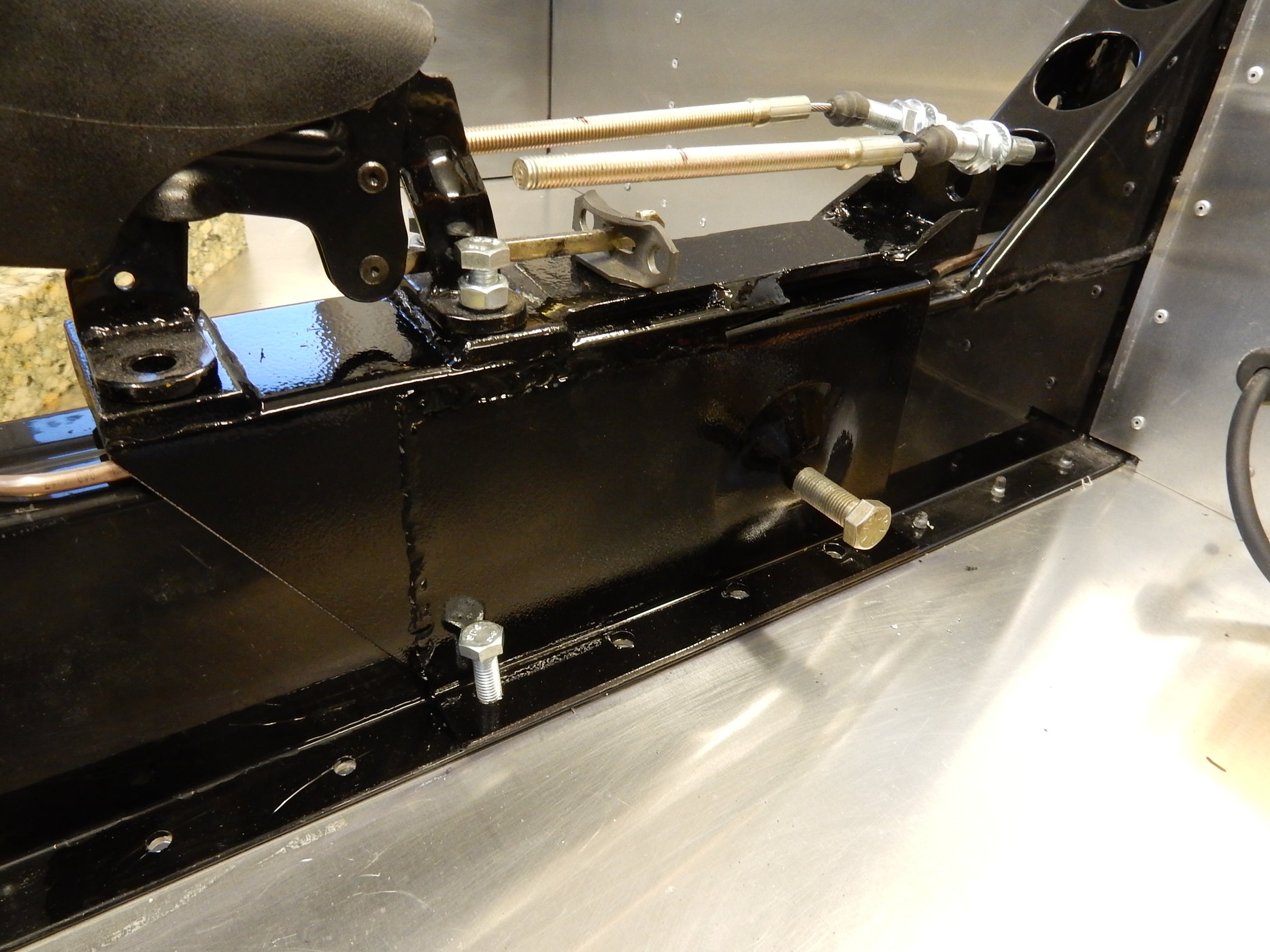

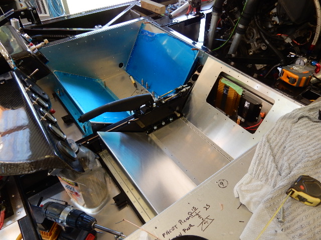

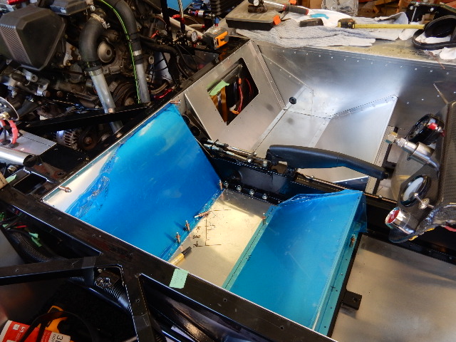

Well a little more progress, because the road regs required massive steel attachments for a fibre glass seat, we have made aluminium profiles permanently fitted into the car. Whilst they look like back breakers, once the upholstered fibre glass shell goes in they will be fine...more than one way to skin a cat. Its still going to be a shit of a car to entry exit going to the pub in fancy cloths.....or just going for milk at the local dairy. Who cares when they see my grin.

Terry, sometimes you just have to accept `rules` if they are an acceptable solution to the problem!
Had I used upholstered seats they would have required 3 mm doubler steel plates and extra brackets so I am very happy to use upholstered fiber glass seat liner inserts if that`s what they want. Their theory is that the `seat liner` is contained in the fabrication so I am happy.
Look like something is about to happen...hopefully it will look like pic 3.
Have completed the aluminium seat work and made a mold for the fibre glass seat insert...and it fitted really neat.

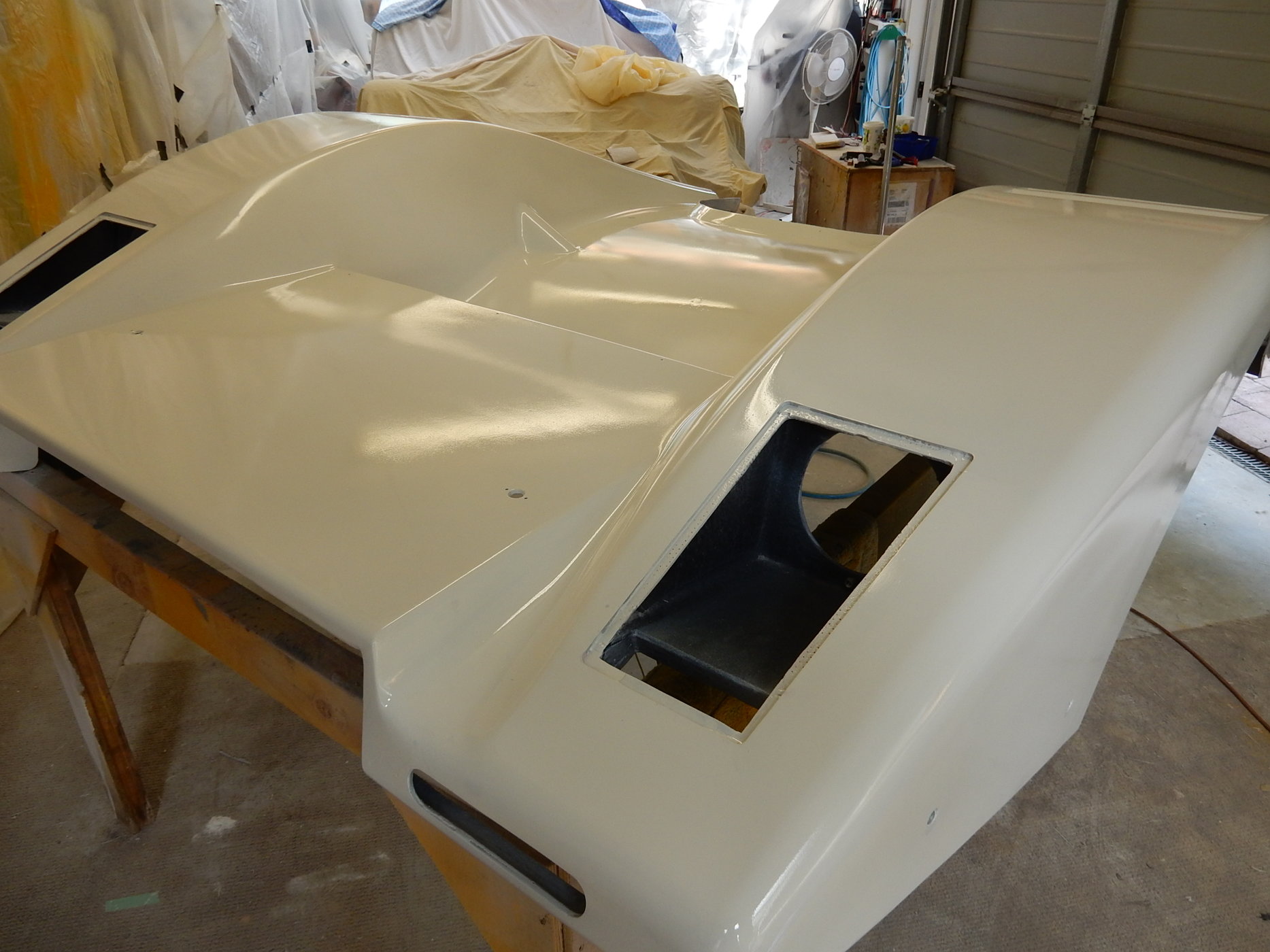

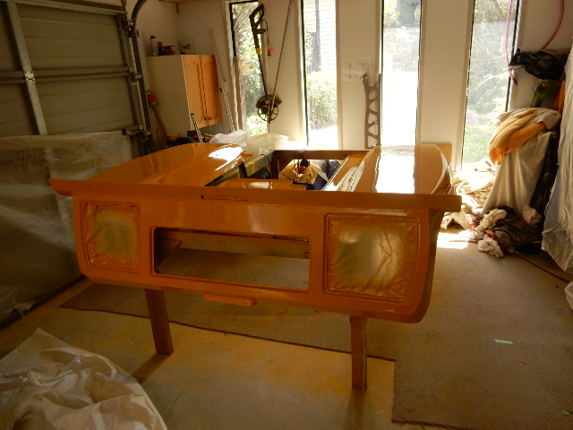

Terry, I would have to drive it to Wellington for that to happen. Got paint on the doors, side panels and rear clip. Will do the nose when I get back from holiday in 5 weeks. Did not have enough space to do them all. Couple of minor runs to cut out, with 5 to 6 coats, there should be plenty of paint to polish.

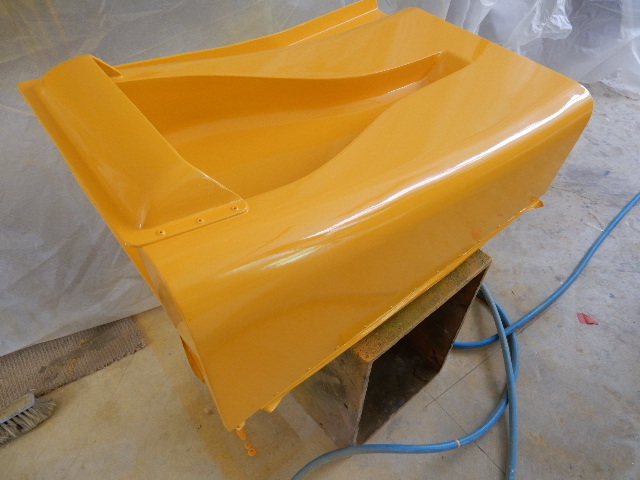

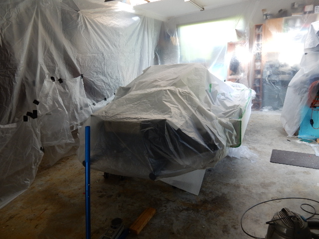

Well after 5 weeks cruizin around the Sth Island, it was time to come home and put some epoxy undercoat on the nose clip, sure does make all those little pin holes come out to play. Not to bad so some spot filler, plenty of fine sanding then some etch primer under coat and we should be ready to spray some colour. The headlight boxes look like they are meant to be so let the light shine on....
