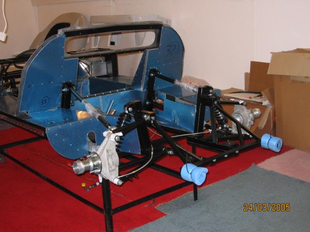

This is a photo of my MDA MK1 which I'm building, here in Wales, United Kingdom. The kit was delivered on the 17th December 2004 and so far I've put in just over 280 hours of build time on her. All of the aluminium panelling is complete, apart from the front bulkhead, which I'm leaving until I install the braking system, which is the next major job. I'll try and keep adding photos as the build progresses.

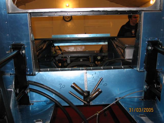

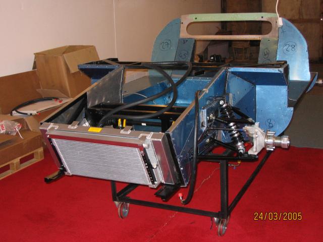

I thought that I would add some more photos which show the panels after bonding and sealing but prior to removing the protective film and polishing. They are in no particular order.
This one is of the nearside engine bay inner.

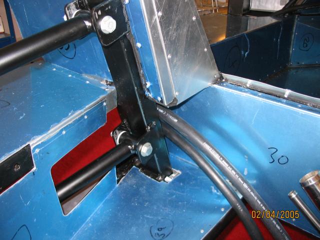

Another!

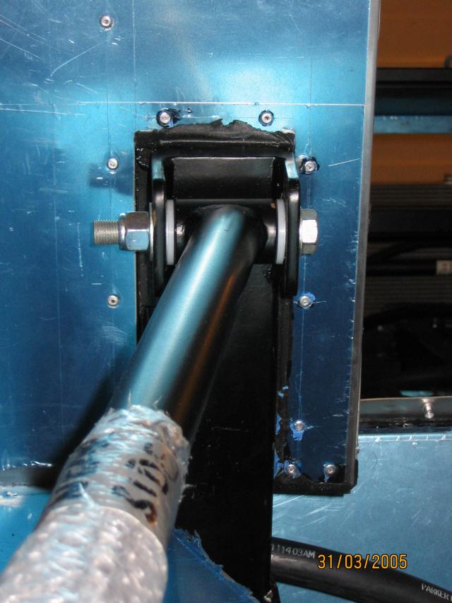

Nearside rear radius arm mounting. You can see the extra rivets around the mounting plate where I attached the infill pieces to fill in the gaps. Sealed with 'WURTH's Bond & Seal'.

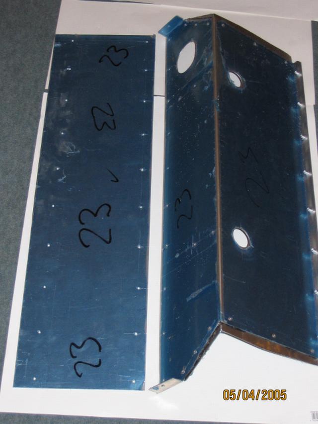

This shows the panel which goes round the steering rack area, after I have modified it.
Originally the panel was a three sided pressing with just the one hole in it for the steering column to come through. This was a very difficult panel to fit, especially after I added the extra infill pieces at both ends.
I decided to cut one side off (the top side infact) and this has made it much easier to install. You can also see the two extra holes which allow the heads of the steering rack fixing down bolts to protrude through the panel. I will seal this area at final assembly.
You can also see the 'Rivnuts' along the front edge which allow me to have a removable front lower bulkhead panel. I will also seal this joint on final assembly.

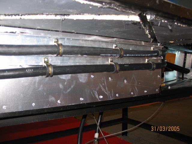

And another.
This photo shows the extra panel that I have added to the chassis on the side pontoon. You can also see the aluminium profiles I have fitted to allow the air-con hoses to be rivetted on. I shall also add these profiles on to the driver's side pontoon area for attachng the break hoses etc..

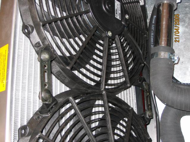

Fitted the SPAL cooling fans this week. Contacted SPAL in Italy who gave me their UK agents details; Malcolm Phillips Tel 01823 273060. He is a very helpfull chap. I odered two kits from him for fitting the fans to the radiator. Kit numbers 3013.0011(2 Off) and 3013.0014 (4 Off).
The first photo shows the cross support brackets at 2-10 and 4-8. These consisted of four brackets and one perforated strip from the 3013.0011 kits.

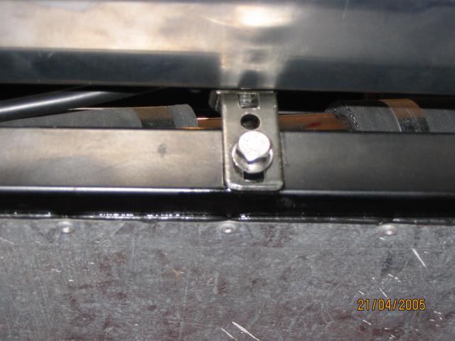

This photograph shows the bottom fixing from the fan onto the front chassis cross member.
This fixing consists of one 3013.0014 and a cut down perforated strip from 3013.3011.
I drilled and tapped a 6mm. hole into the chassis member and then used stainless steel hex bolt for the final fixing.
