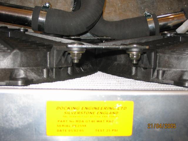

A another view of the top cross support.
Tim Kay
Good work /ubbthreads/images/graemlins/cool.gif
Spal fans, in my opinion, are one of the most efficient fans on the market
by moving the most CFM for each given size and depth of fan.
In addition I suggest adding a shroud to optimize the ability of the Spal
fan to move more air thru your radiator.
Just my .02 /ubbthreads/images/graemlins/wink.gif

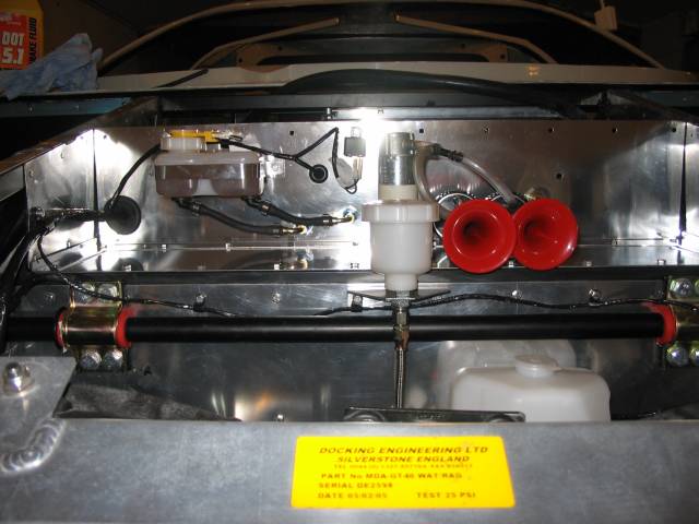

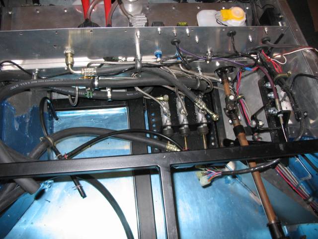

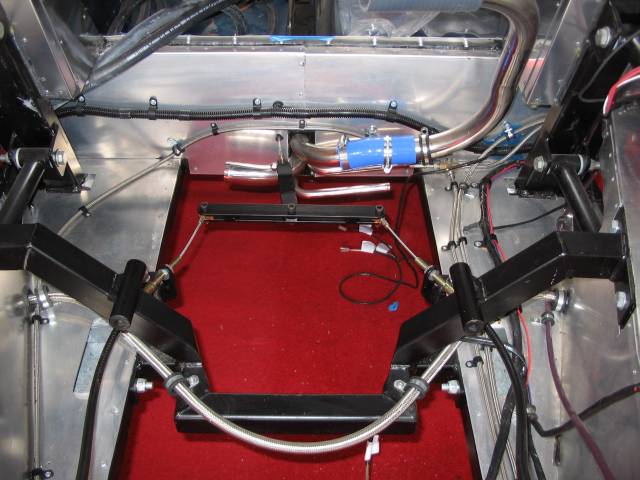

I've started to install the main wiring loom and the brake lines. Photo below shows installations, so far, in the engine bay.
I've done 356 hours of build time on her, up to now.

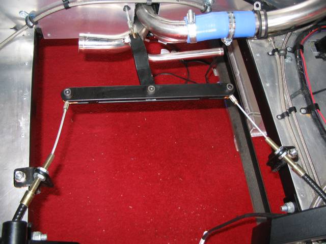

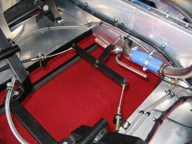

Hi Alastair!
I just wonder if you have started working on your handbrakes and especially your cables. I have some troubles with them. If you have some picture on this I would appreciate it a lot if you posted them.
Thanks and best regards
Daniel
Daniel,
I've trial fitted the handbrake lever itself and installed the primary activating cable and wiring through the rear bulkhead. You can just make them out in the above photo.
I'm waiting delivery of my actual rear brake setup, including the handbrake calipers. MDA are working on it just now.
As soon as I install them I will post some photos.
Regards
Alastair

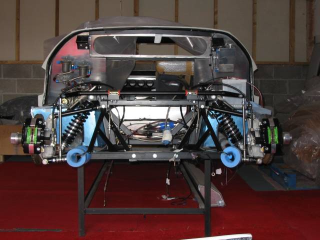

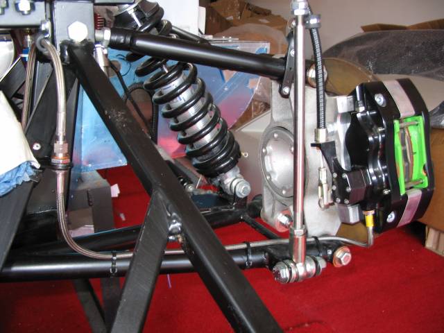

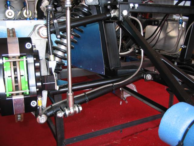

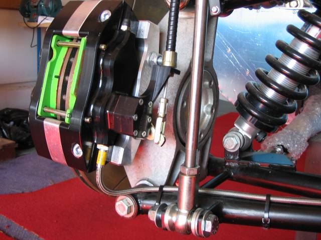

Finally got the HiSpec Engineering rear brake callipers fitted and fully commissioned.
Here are some photos showing my installation.

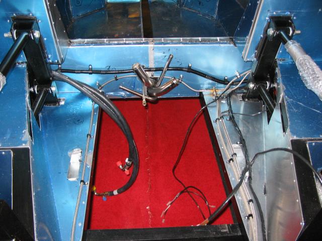

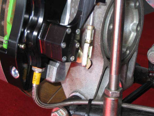

Here's another couple of photos of my rear braking system.

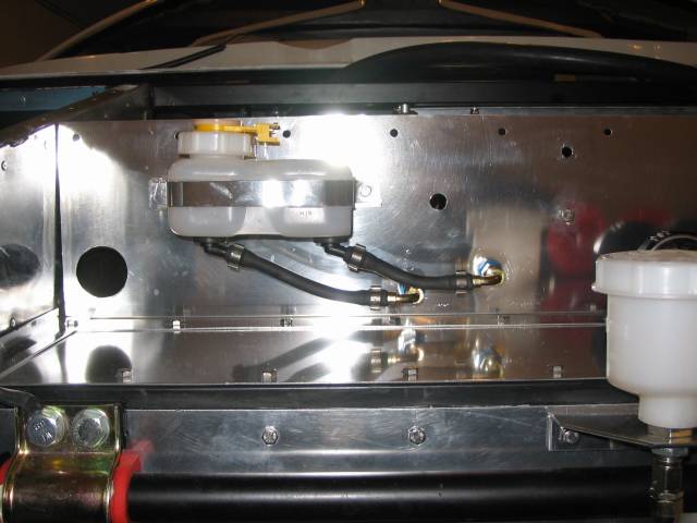

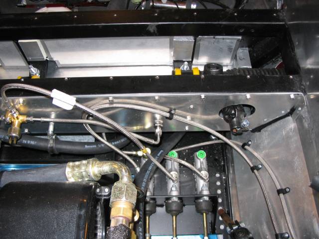

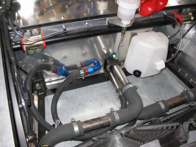

Some photos of my front bulkhead installation.

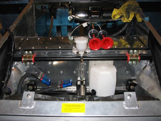

Front bulkhead build up
Another couple of photos of the front bulkhead.

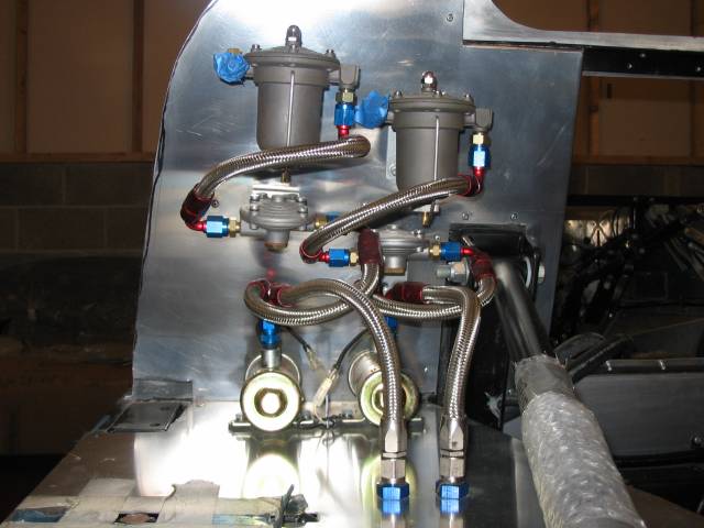

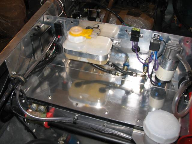

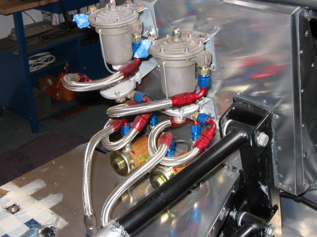

Fuel pumps etc.
Some photos of my fuel pump installation.

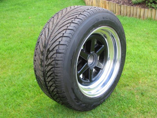

Wheels and tyres
A couple of photos of my wheels and tyres which are:-
Wheels: Jongbloed Aluminium Alloy 3 piece 16" Knock-On, Pin Drive, BRM Replica, 8" wide fronts and 10" wide rears.
Tyres: KUMO EXSTA SUPRA, 225/50 ZR16 and 255/50ZR16
