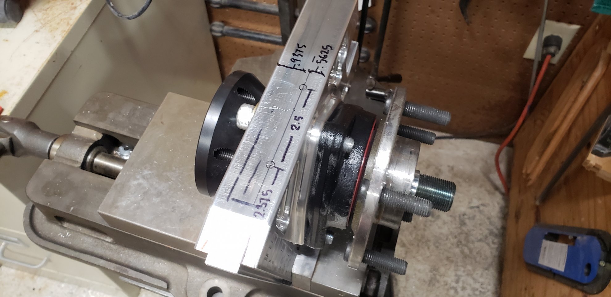

Sure, let me know when you are ready. I borrowed a set from H, but ended up sending them to some other folks who were ready for them before I was. But before I sent them, I traced them onto a piece of aluminum, just in case they got lost or something. When I was ready, I went ahead and cut my set out and used them instead of waiting or rushing the guys who were using them. So, now there are two sets floating around. I am happy to let you borrow mine. Anyone else can as well, I just ask that you don't beat them with a hammer and mushroom the tabs, and clean them up when you are done (can be a little time consuming!)

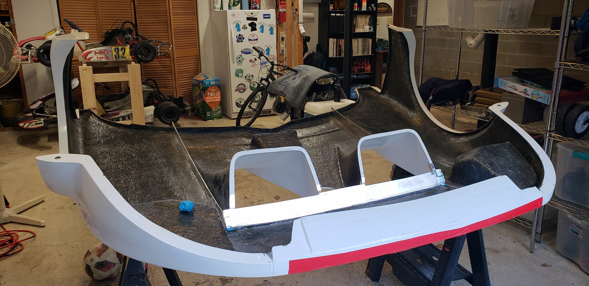

The lower valance work. With the splitter modifications, the fiberglass piece between the valence and the splitter no longer fit, so I flanged the valence to give it a place to fasten to the splitter.

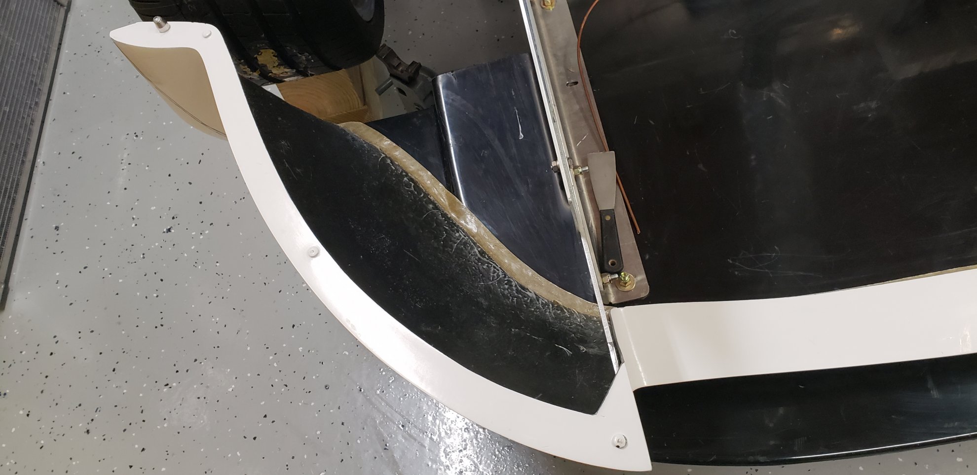

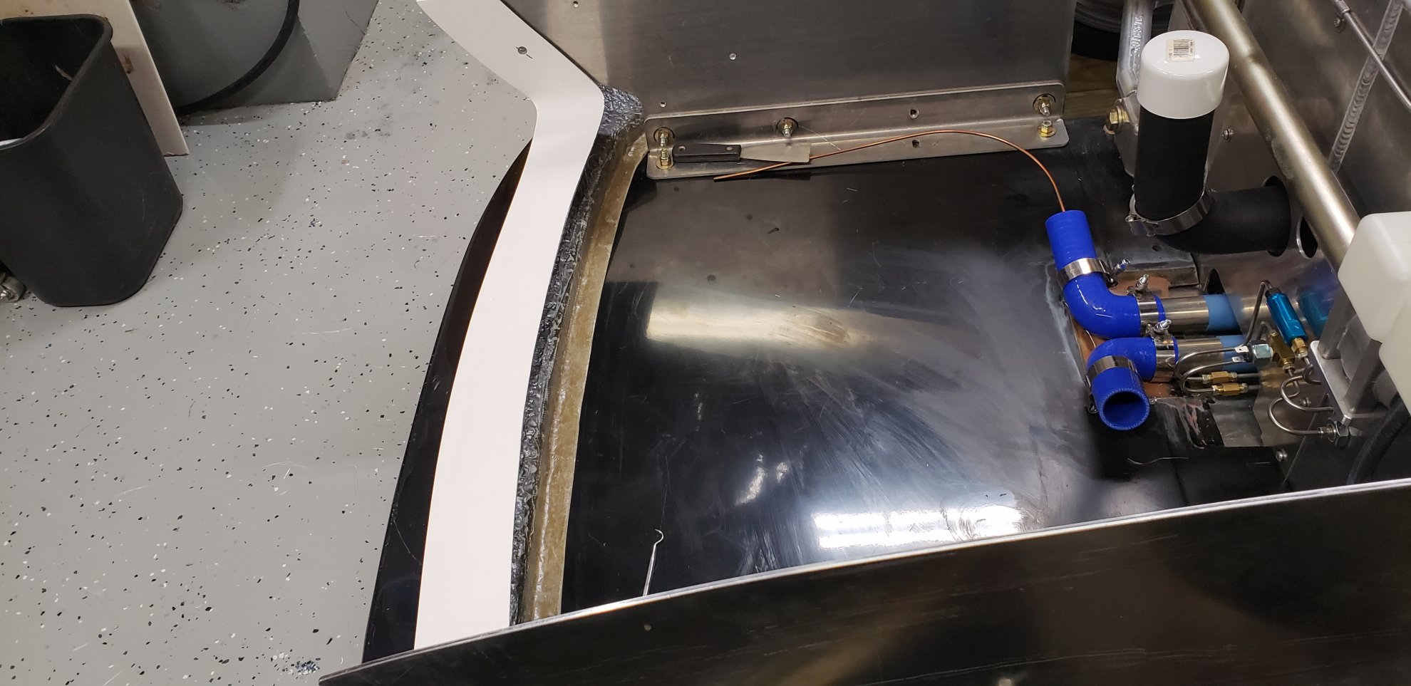

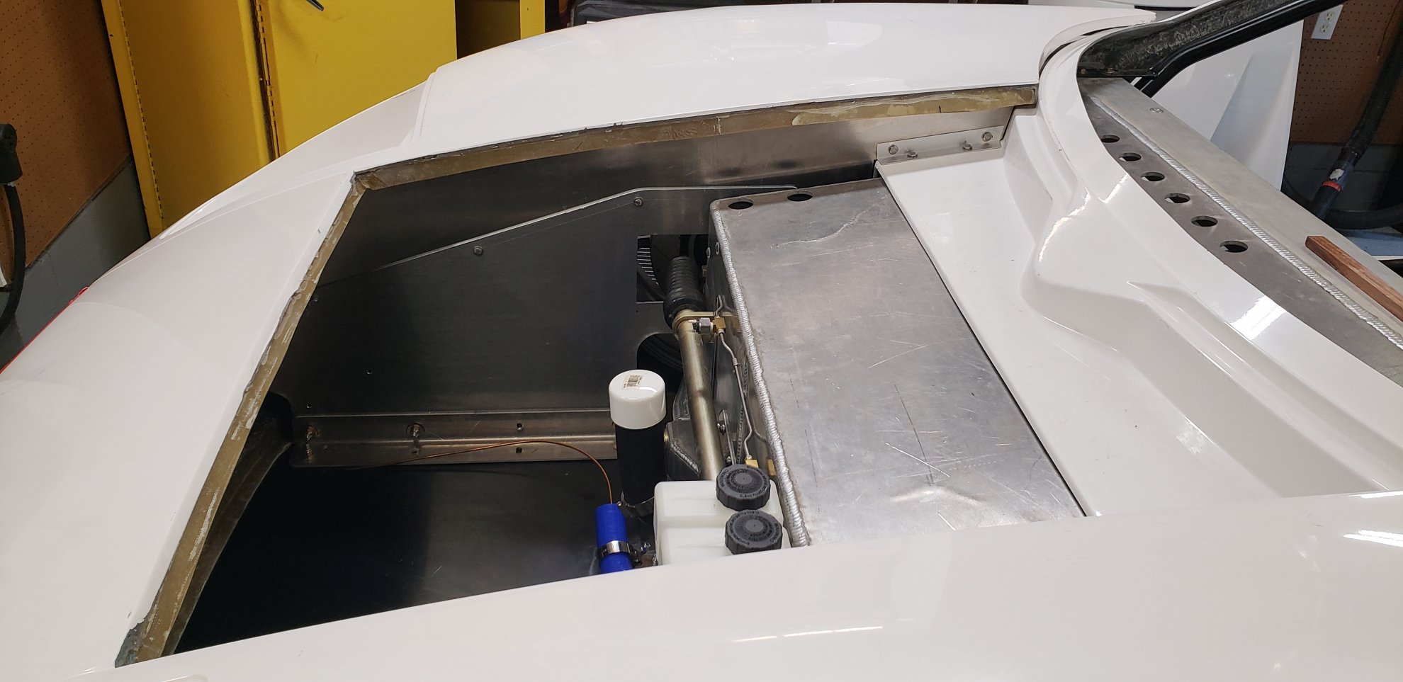

Also, added a support for the inner fender along the hood edge, since the hood has been cut out. 1/8" 6061 sheet. I made a template out of 1/4" foam board and traced it onto the sheet for cutting. Increase in support is perfect.

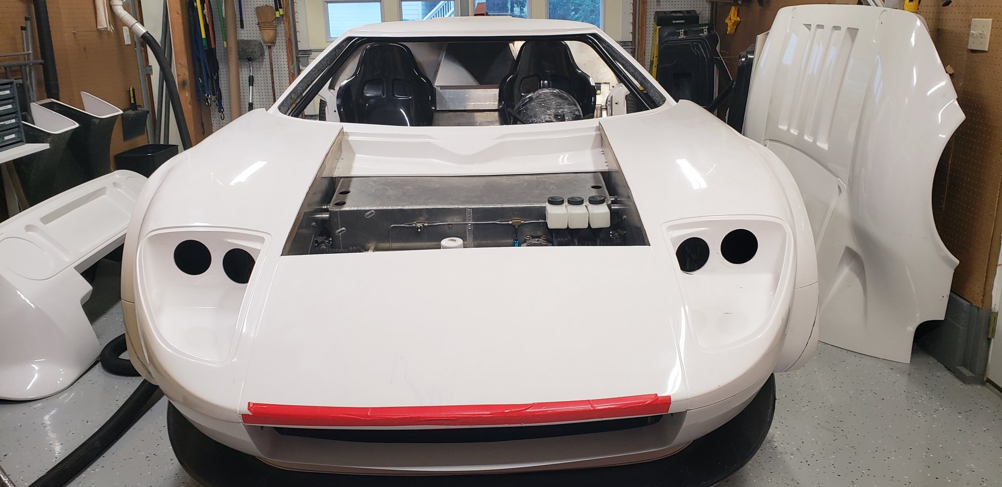

Made some eyeball sockets today. Unfortunately, these dang Li-Ion batteries stop so fast, when I finished the last hole and released the trigger, the hole saw spun off of the arbor and banged around the headlamp recess for a little while! Nothing a little filler won't fix I guess...

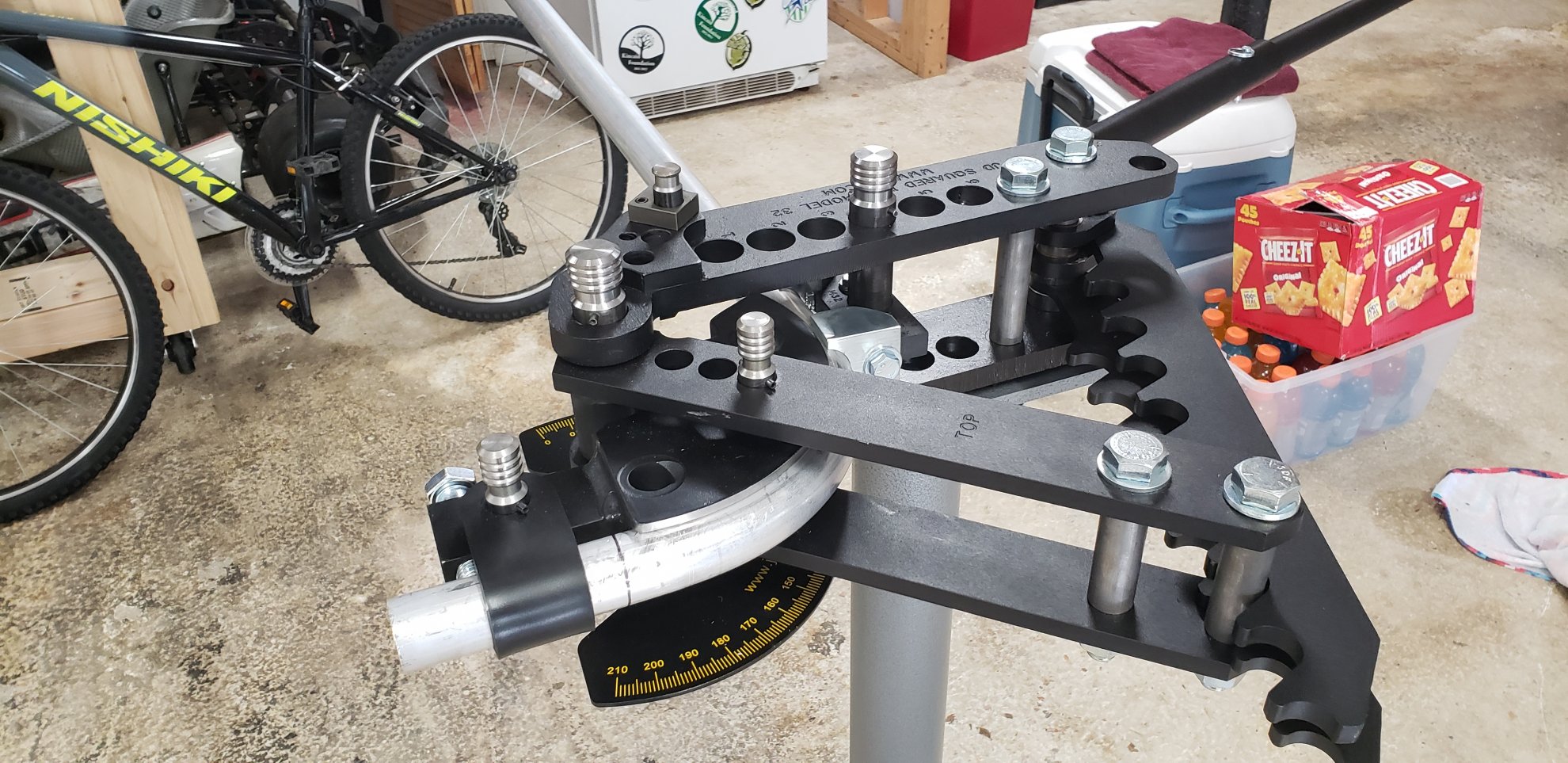

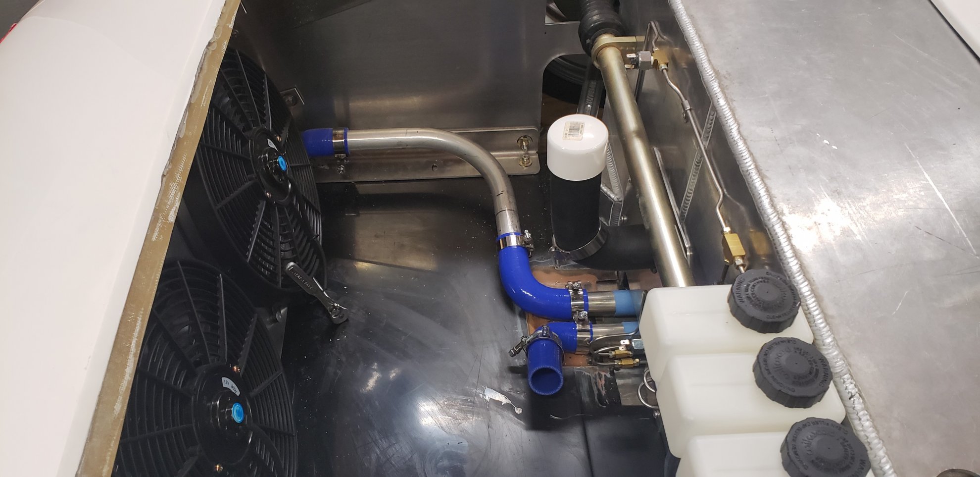

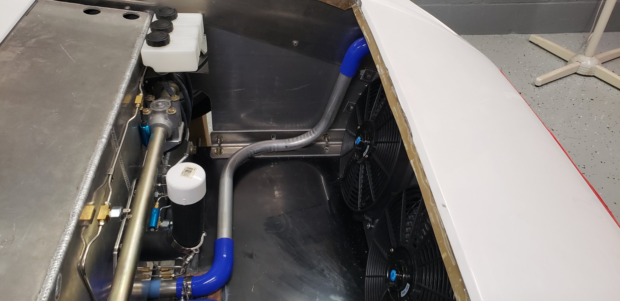

Then bent a couple of pipes with my new bender (won't be parking in the garage for a little while), and have some coolant lines now. I am learning a lot. Like don't lubricate the bender die. The second piece has wrinkles in the inner bend because of this. I will re-do that piece when I get more 1.5" pipe from McMaster-Carr. First attempt using a bender though, and I am proud I don't have nothing but a a bunch of scrap left over!
