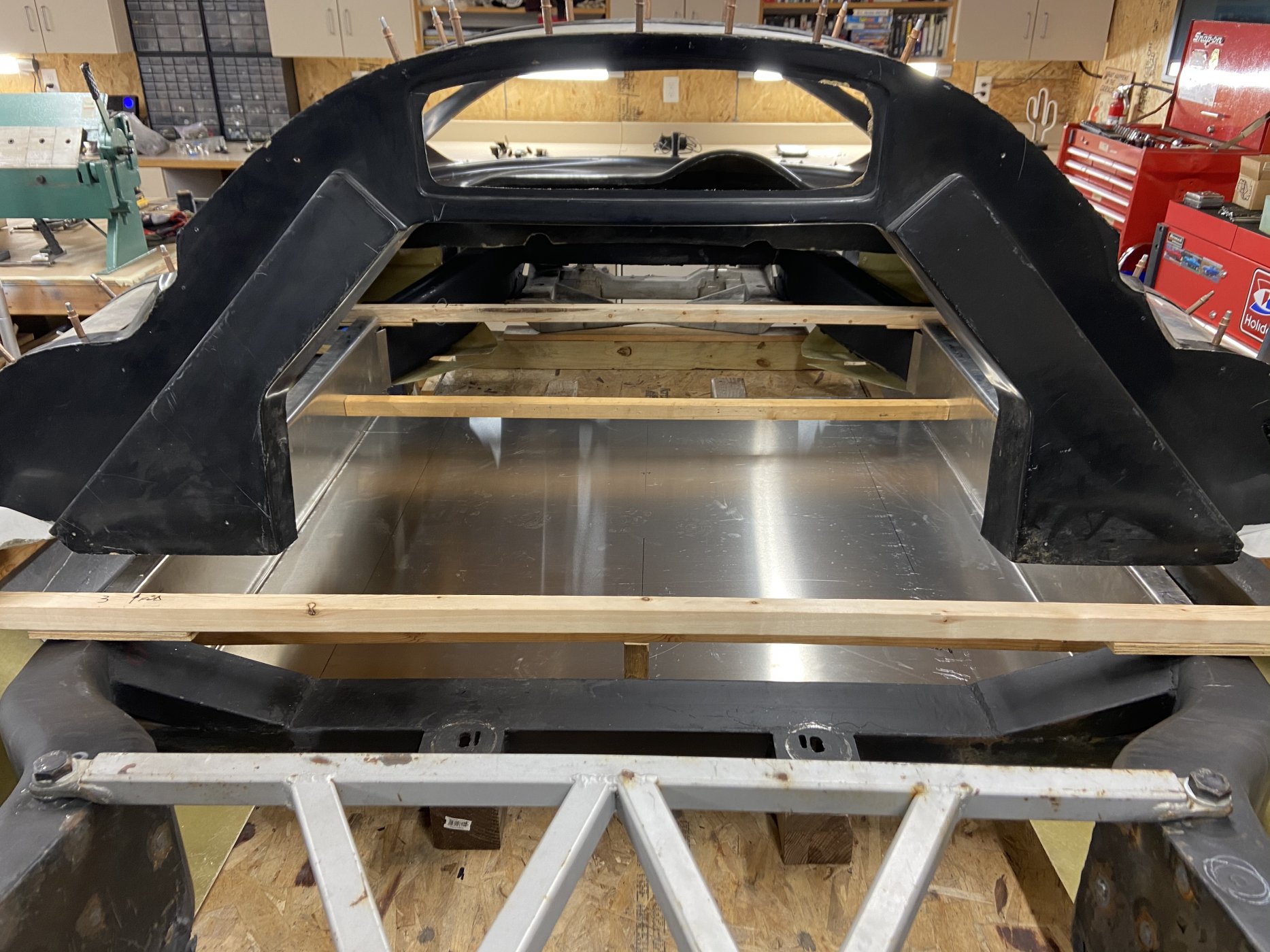

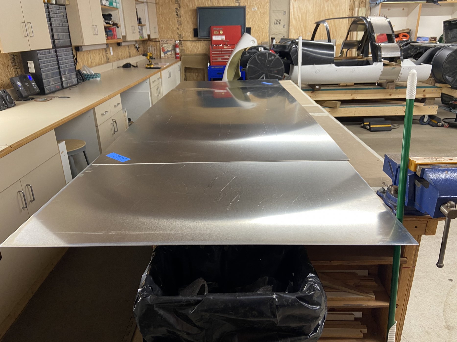

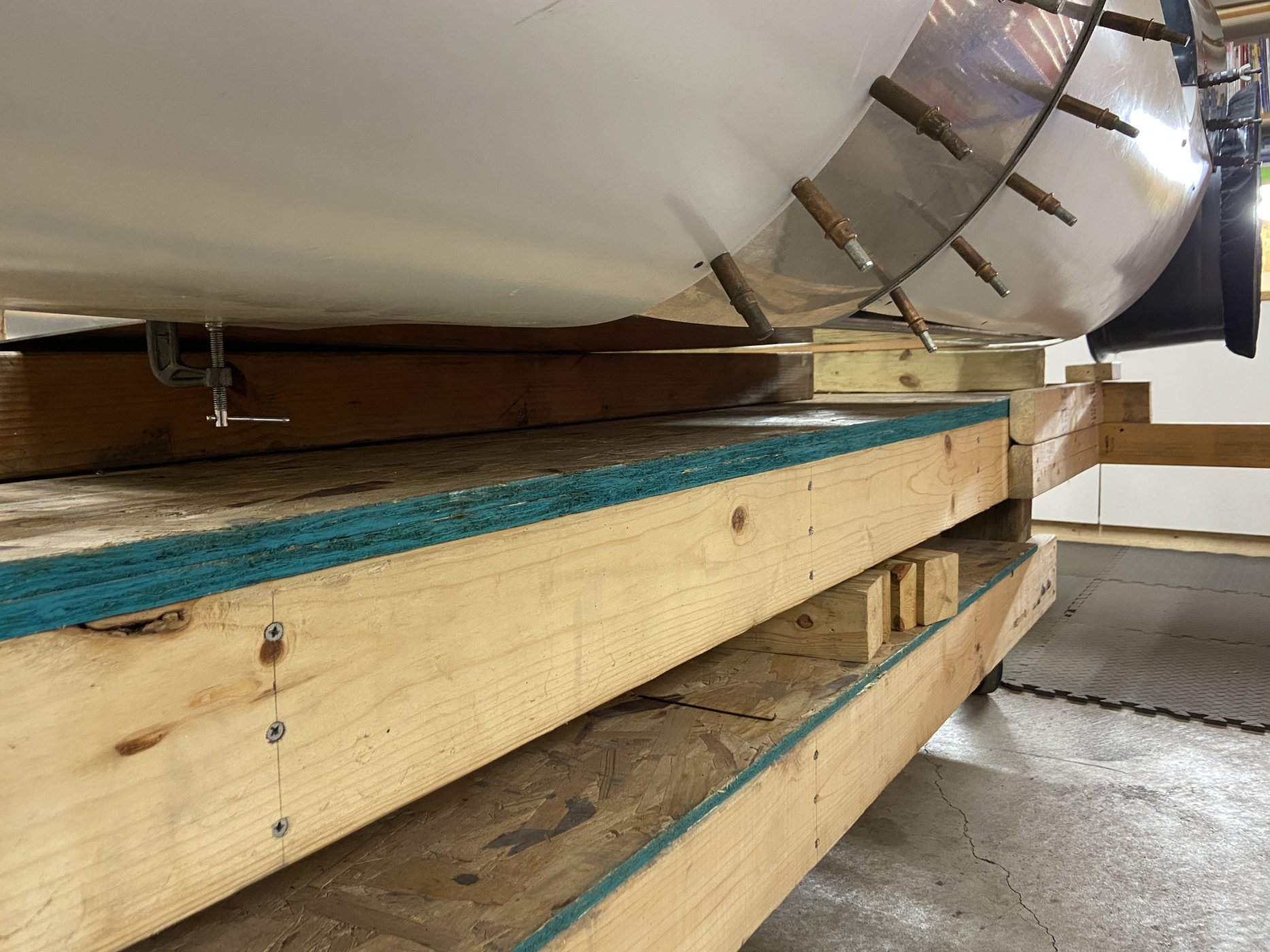

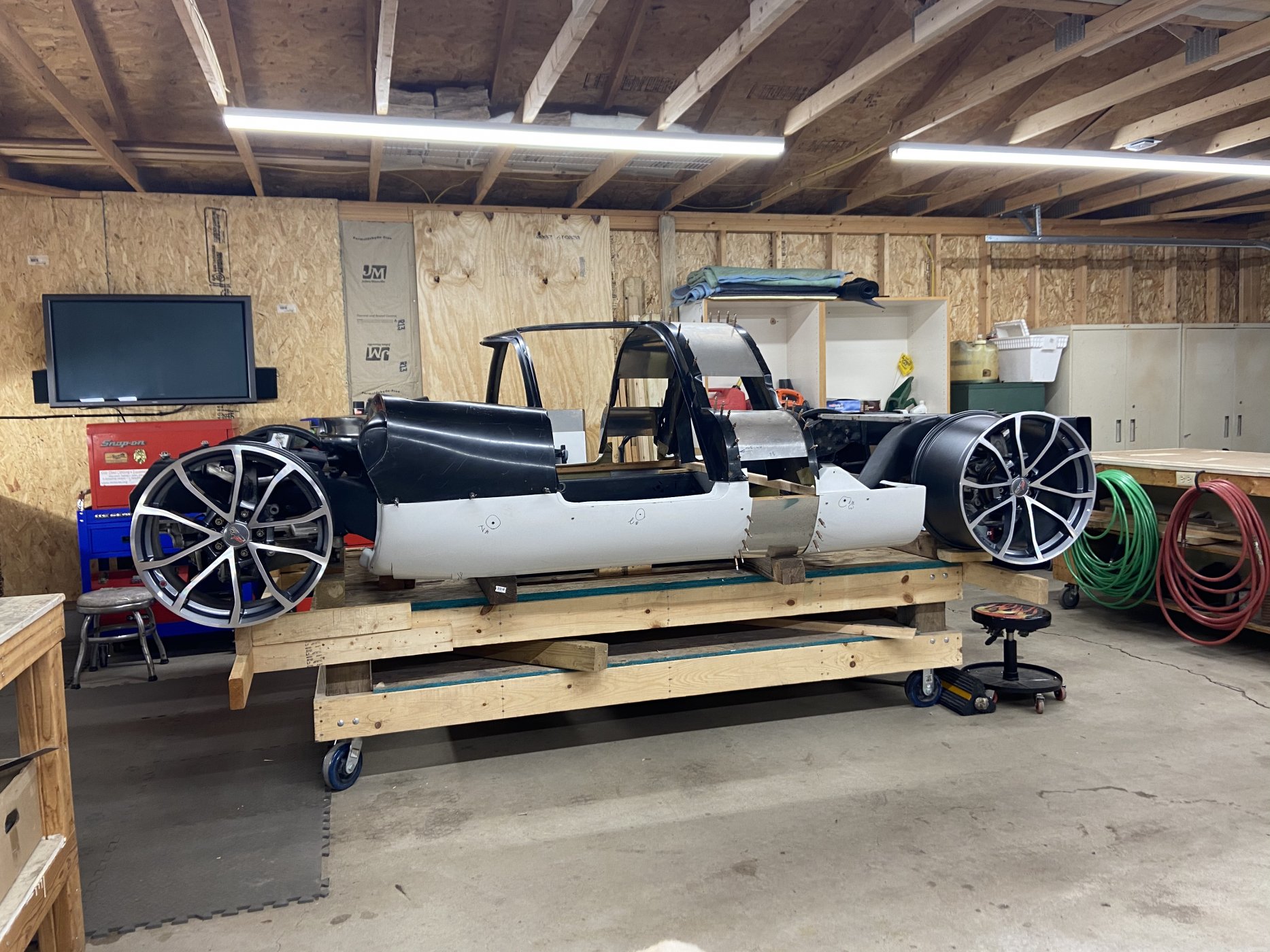

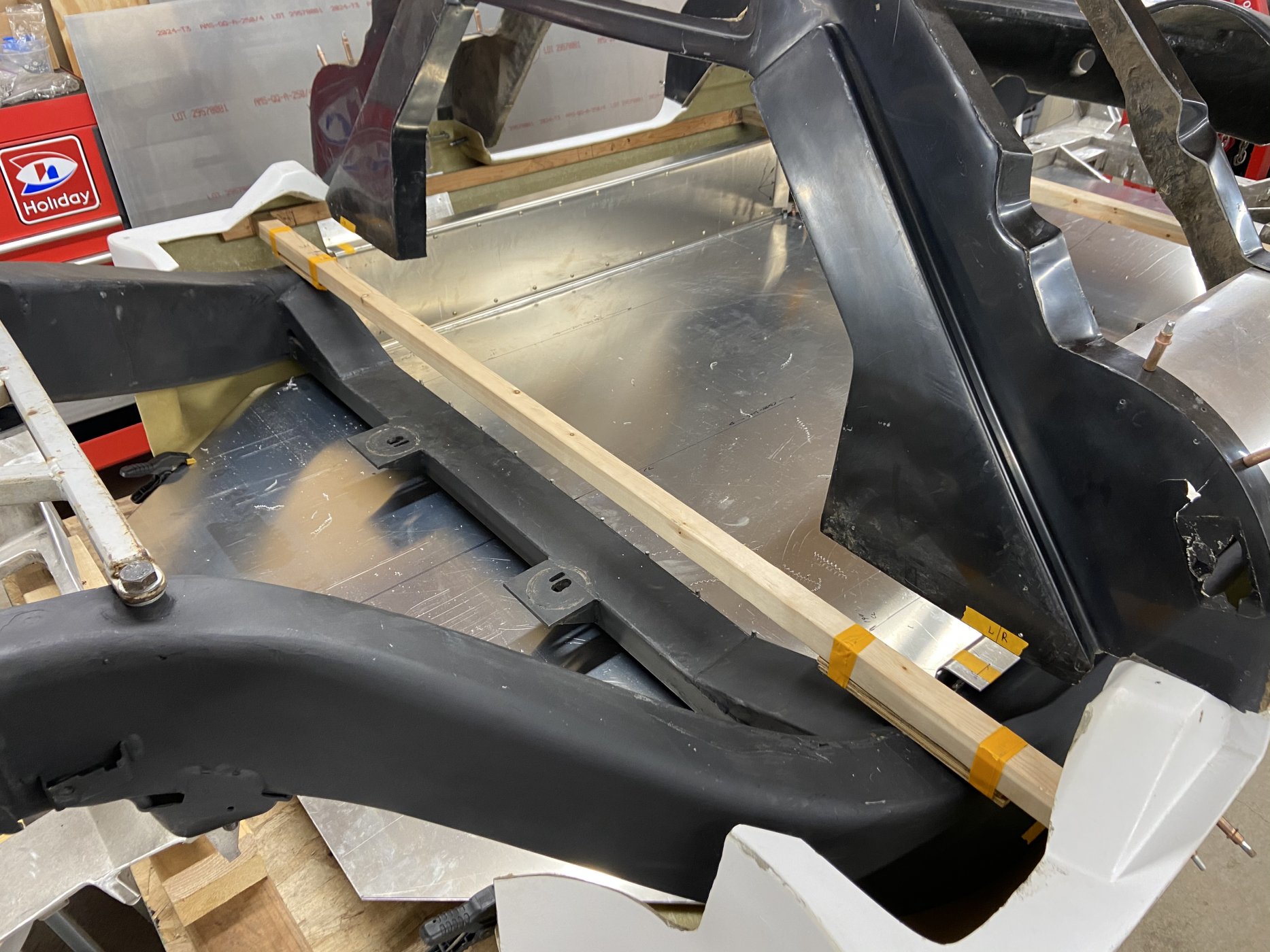

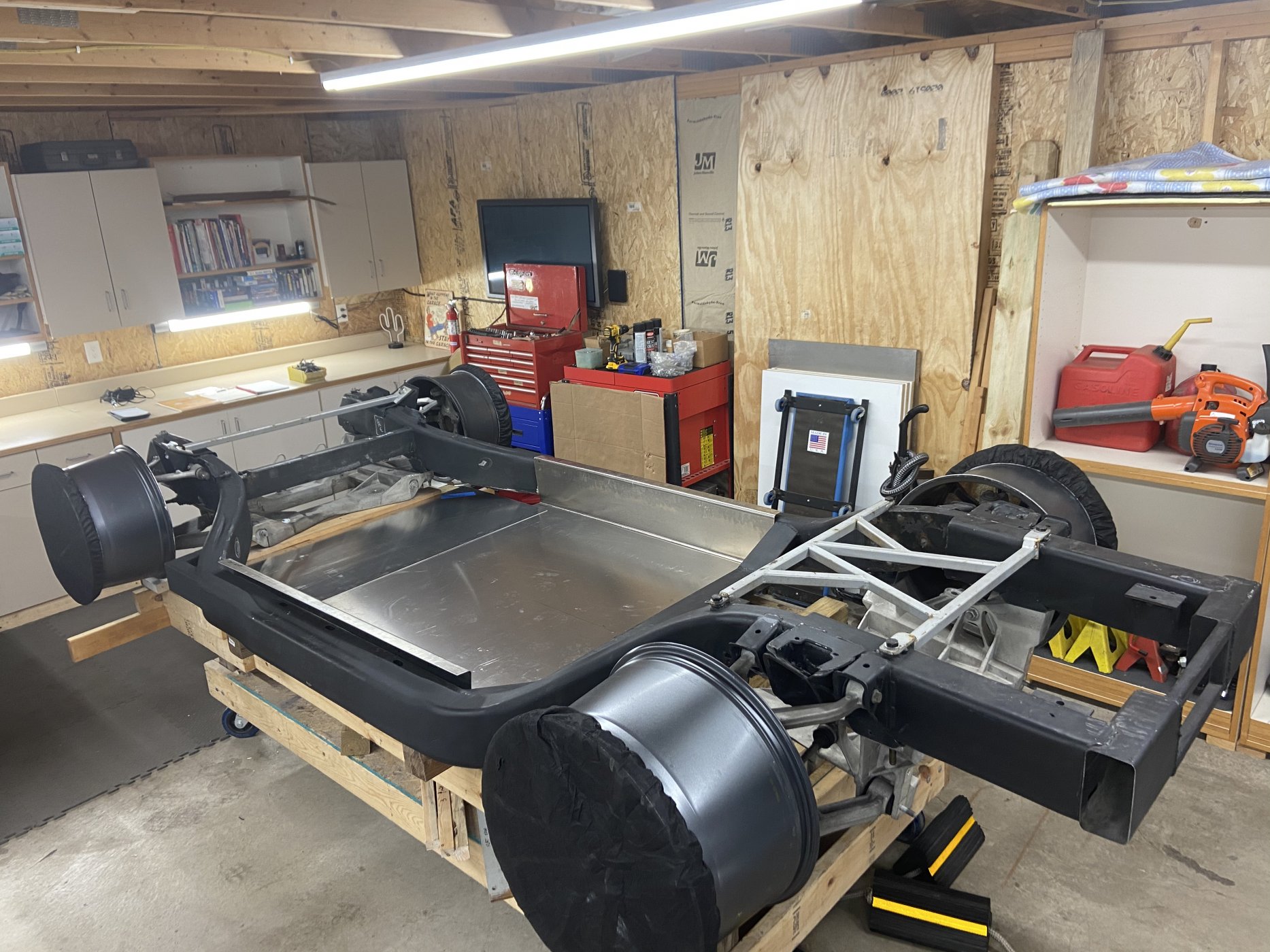

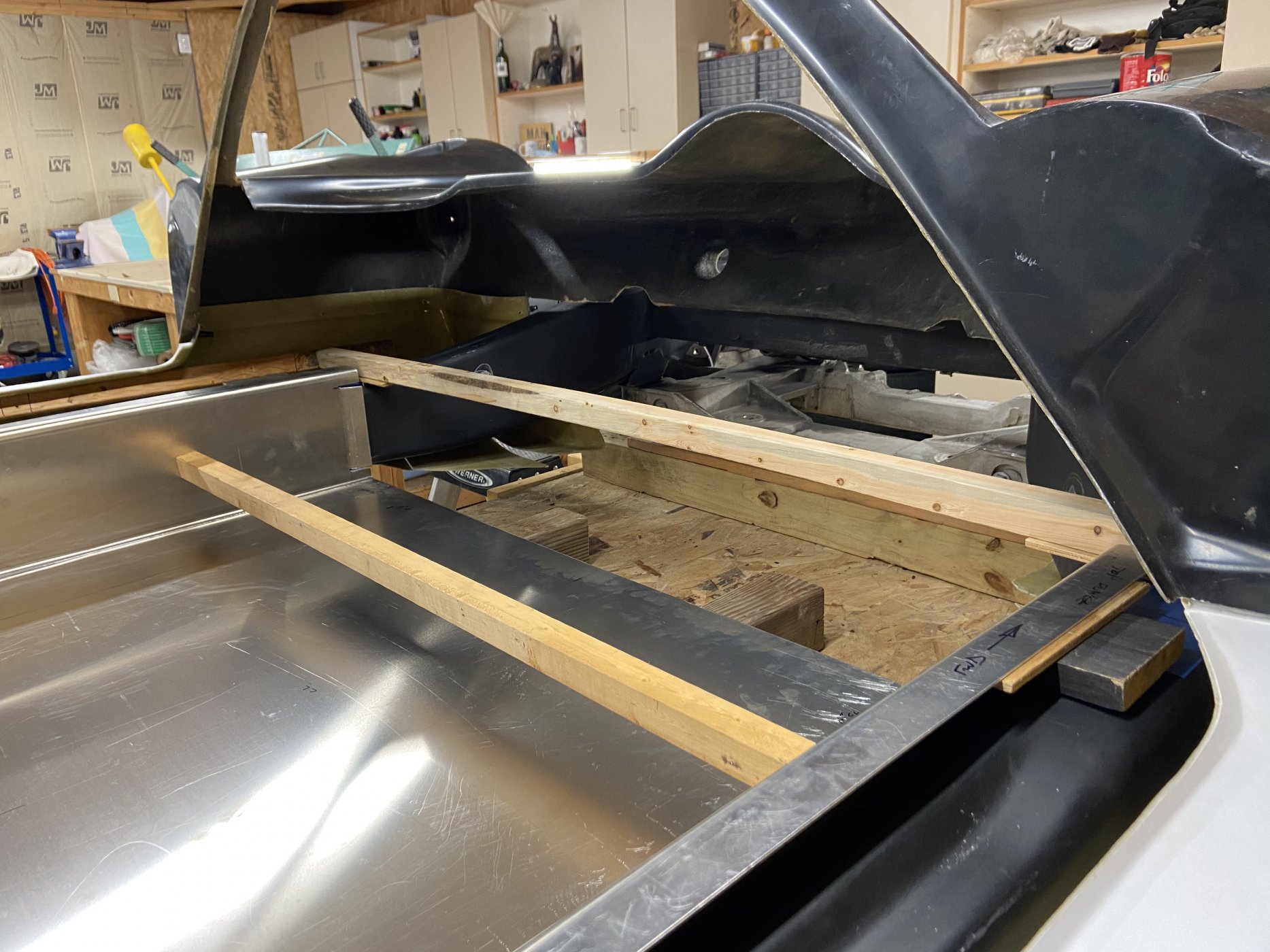

Chassis ride height & bodywork centersection set now. Looks like floor will be 3.75” ground clearance.
That’s the Max I can lift the bodywork without hitting the side-rails. Ordered aluminum today for floor & interior structure along with radiator support.
Sounds like it will be here early next week so I’ll bend up the floor & post for everyone next week.

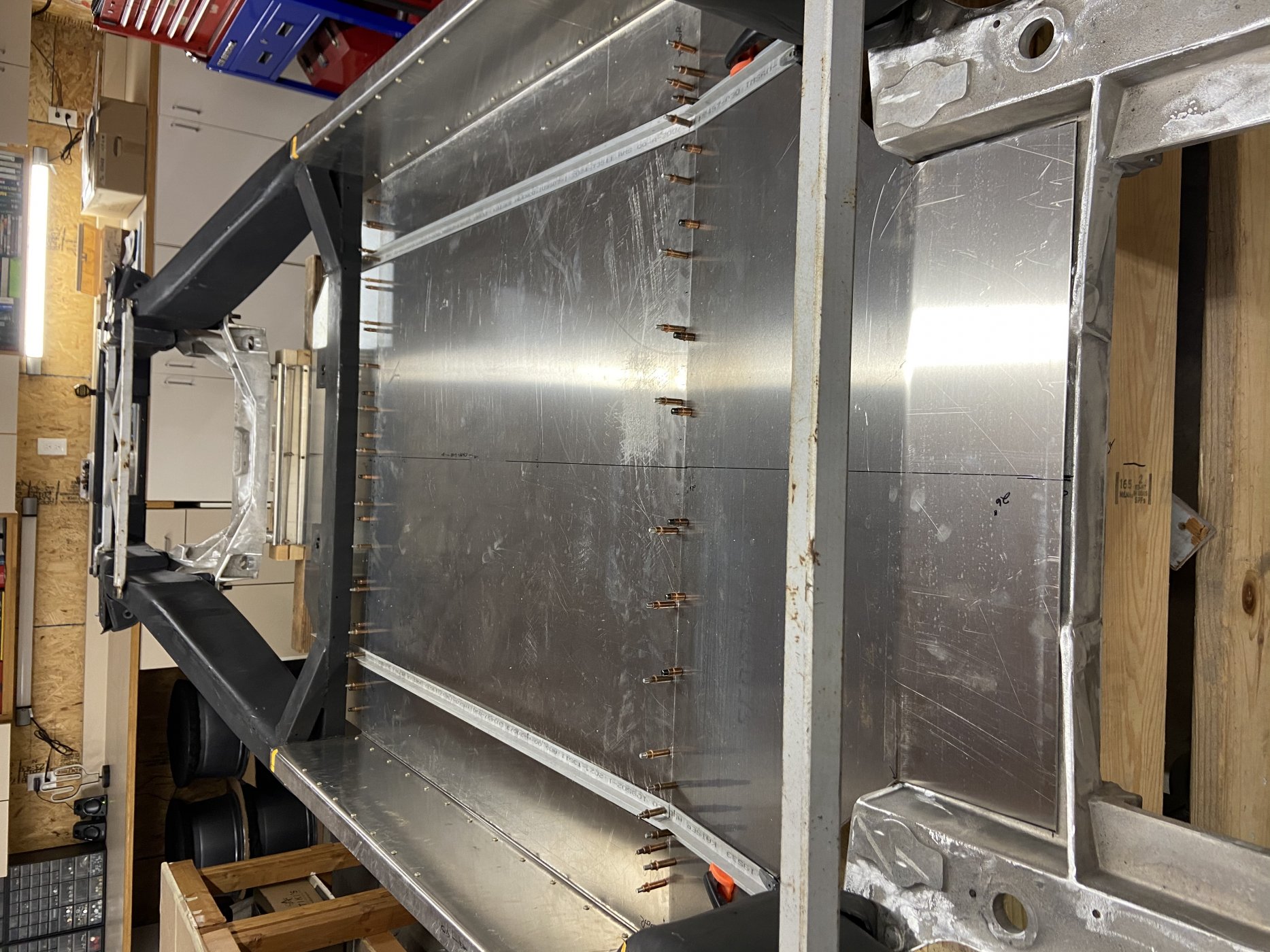

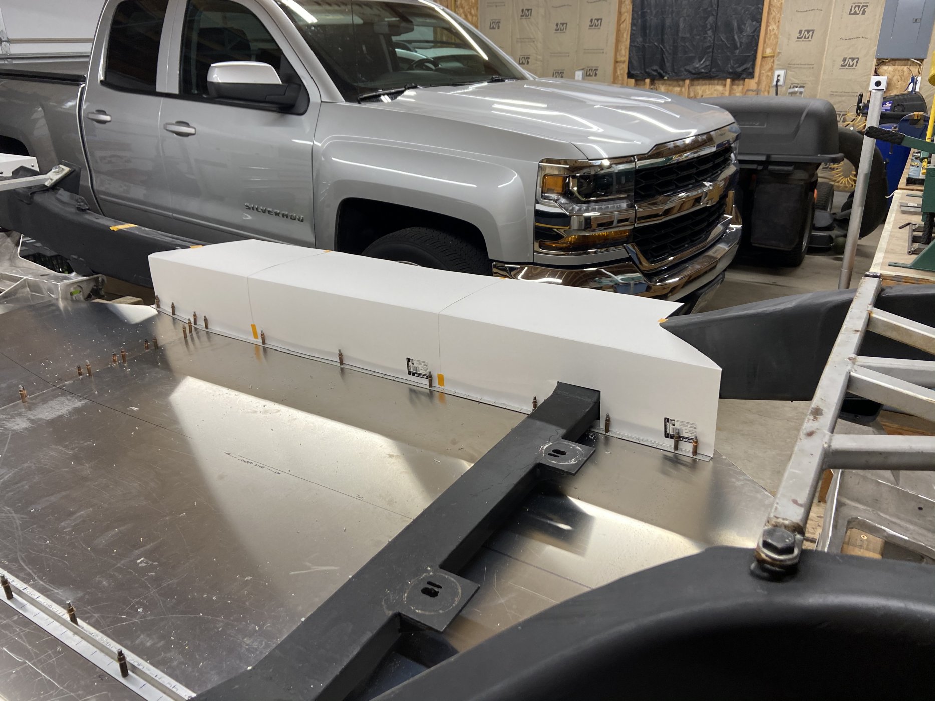

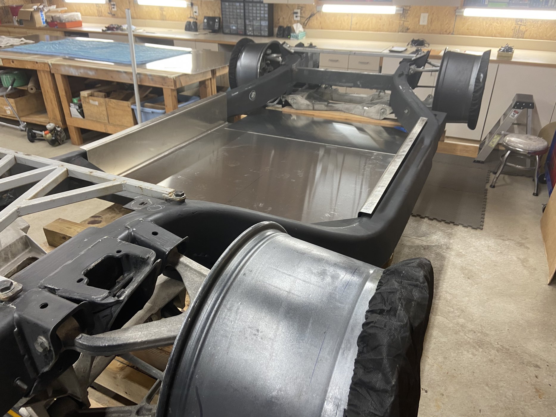

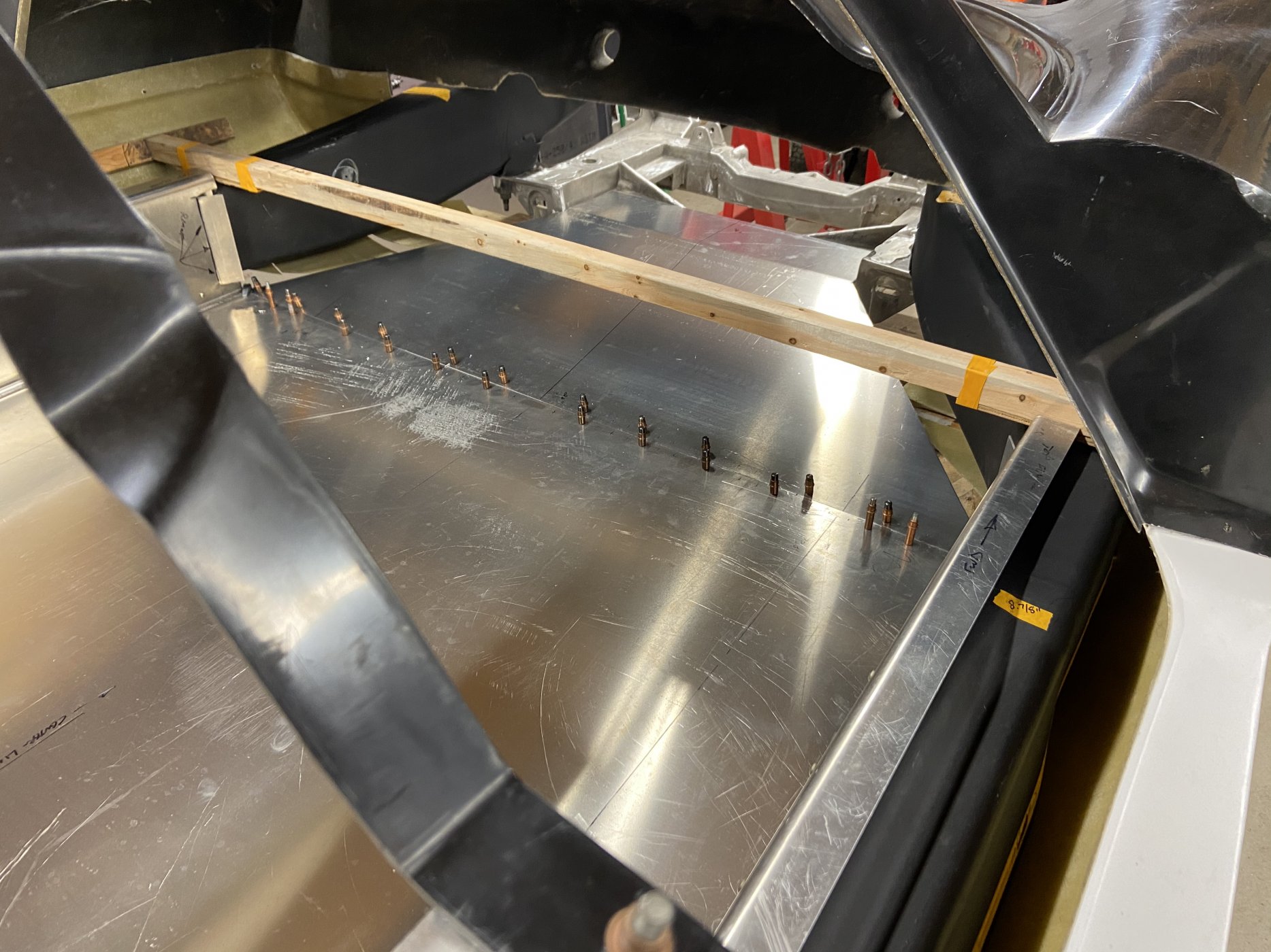

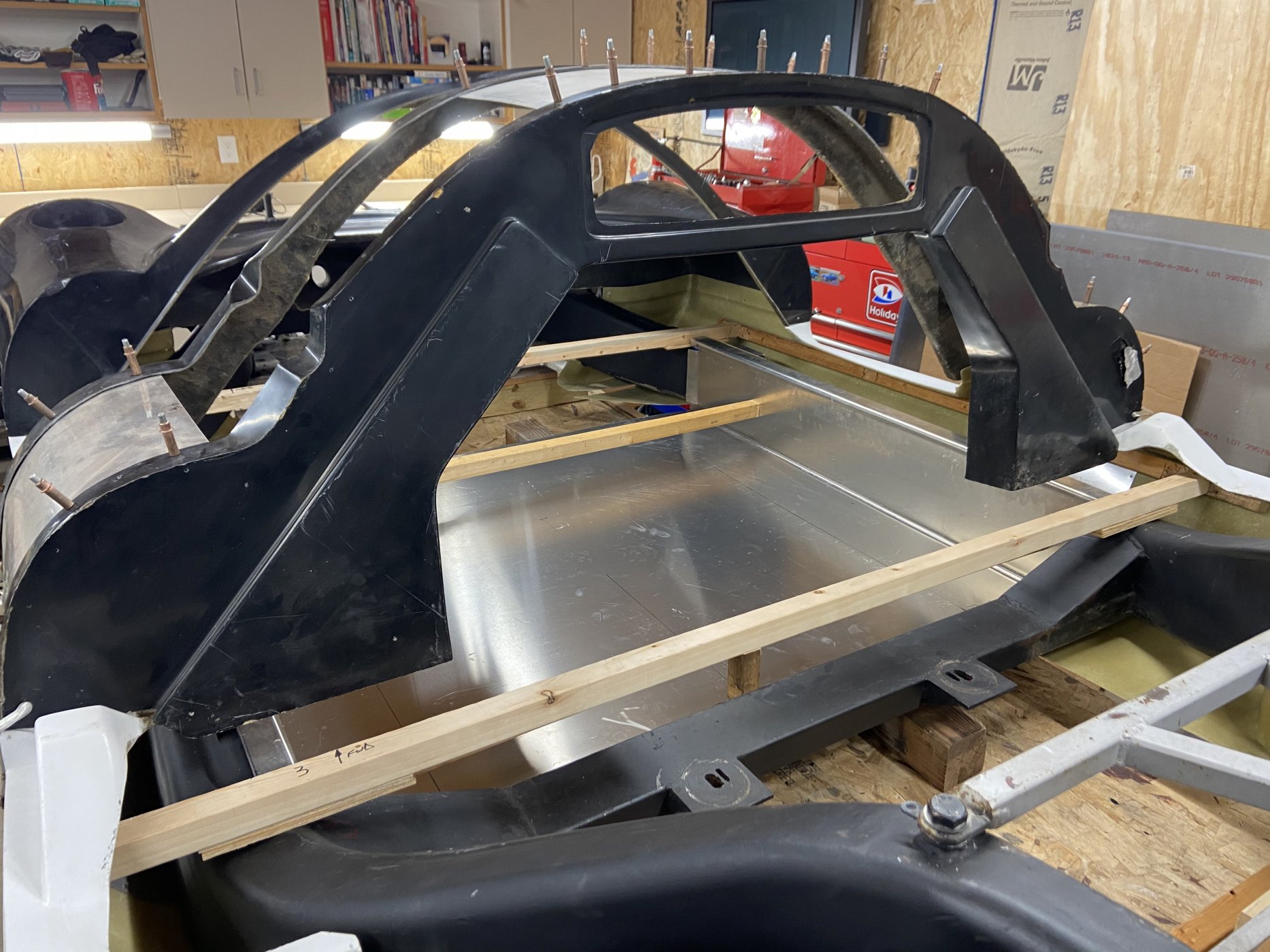

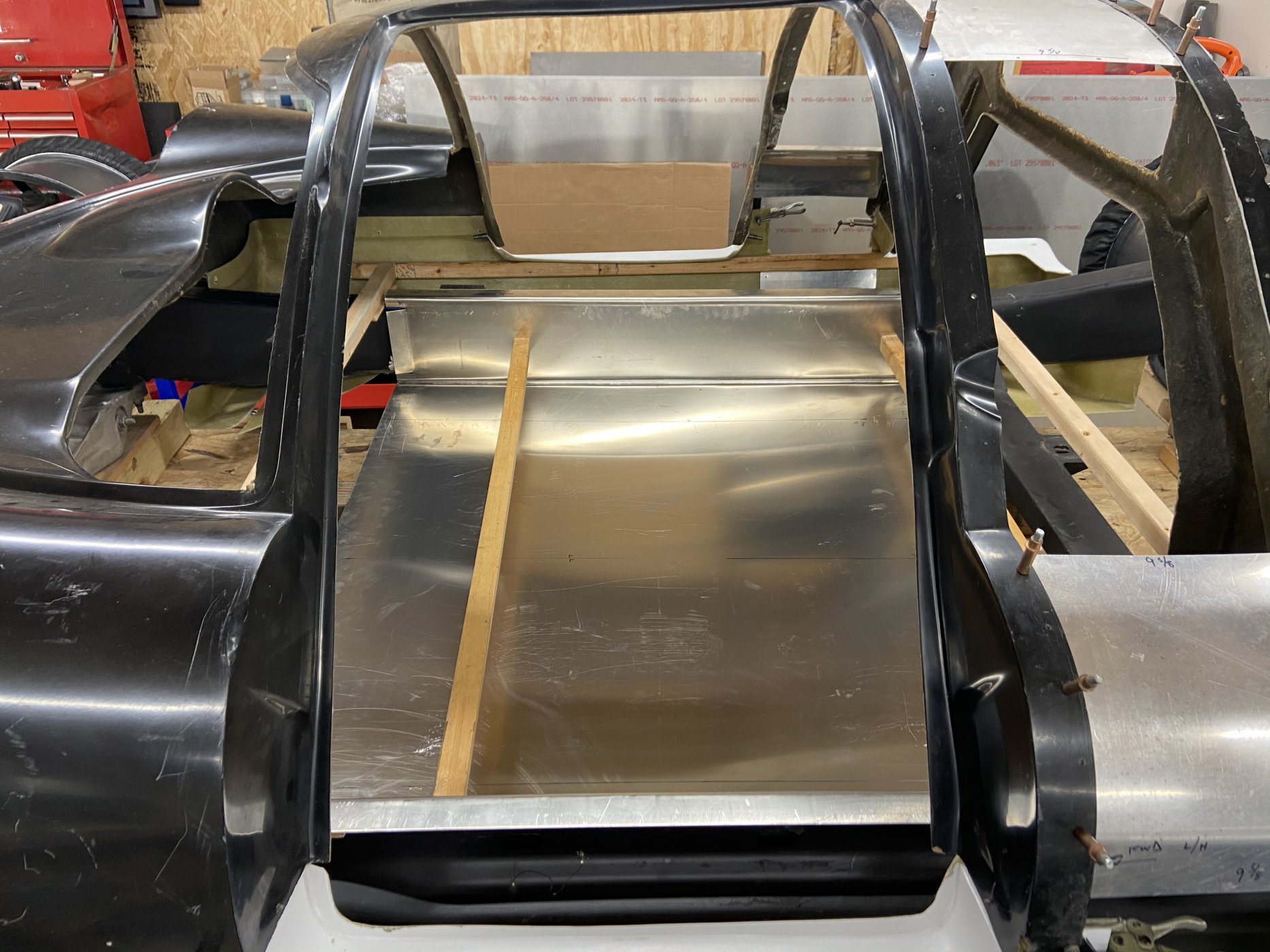

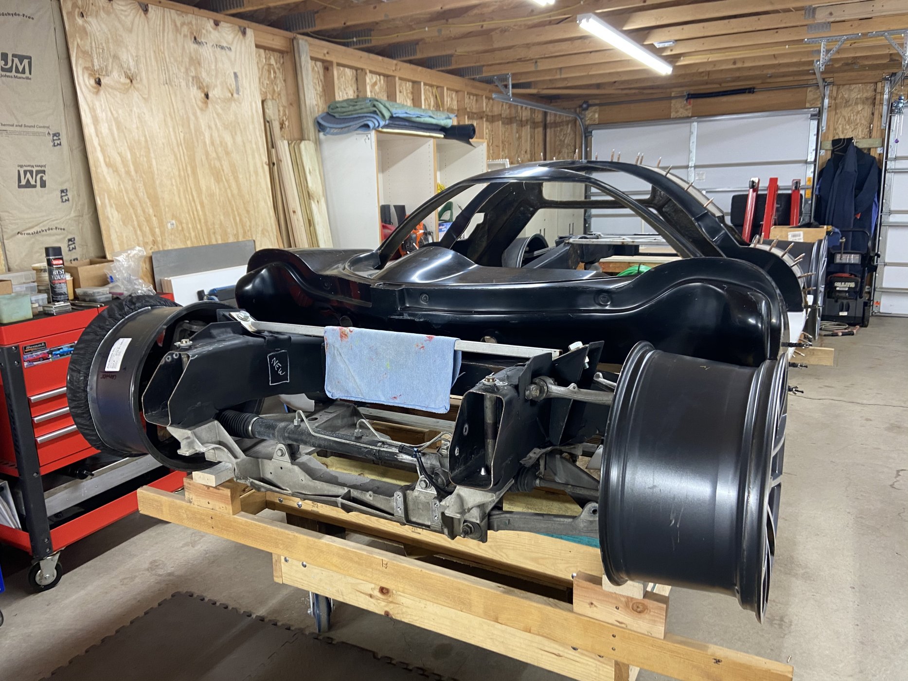

Material showed up for I fabricated main floor section. Real happy with the results so far. I’m fabricating toe board area & pedal box then side pod structure to mimic T70 fuel tank areas.

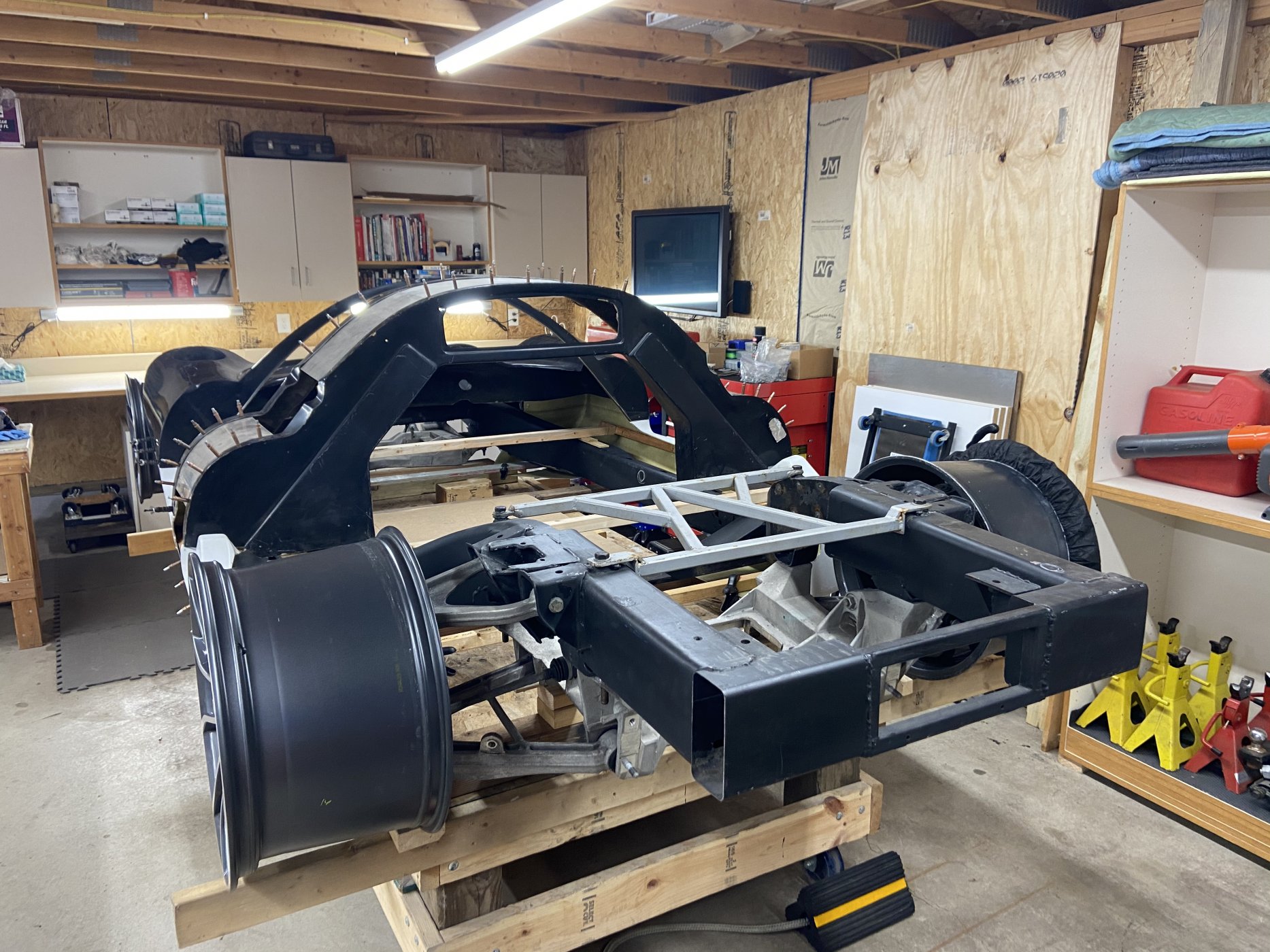

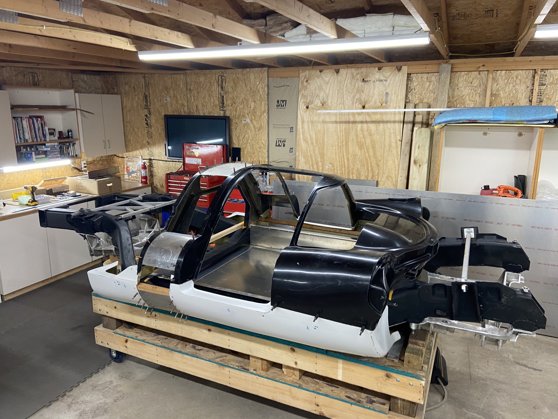

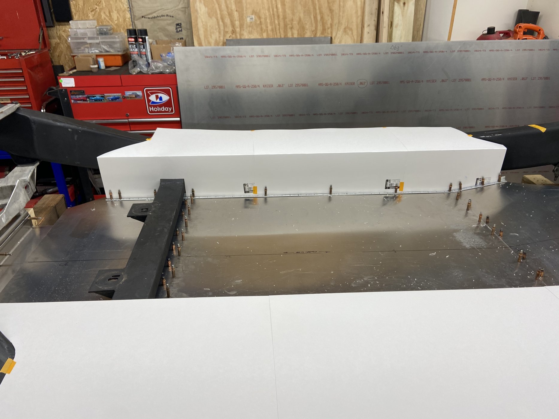

Lower T-cords are located & piloted, fabricated the tunnel patterns foe both side pods tonight. I’ll cut them out soon & work on the seat back & floor hump under my knees.
