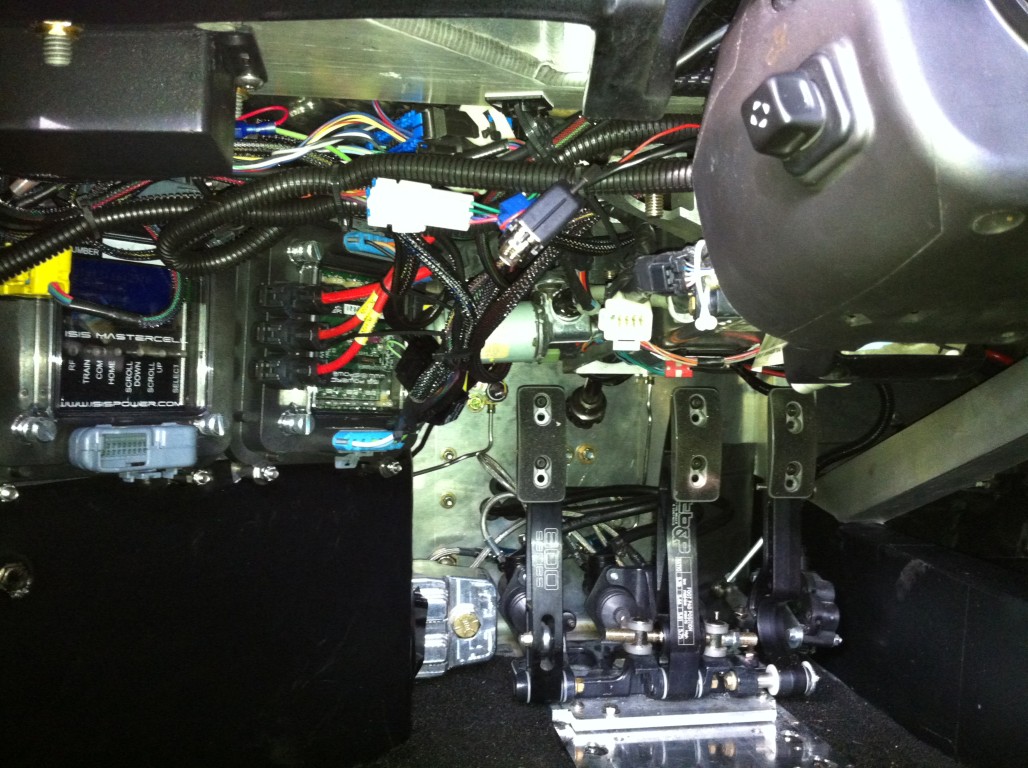

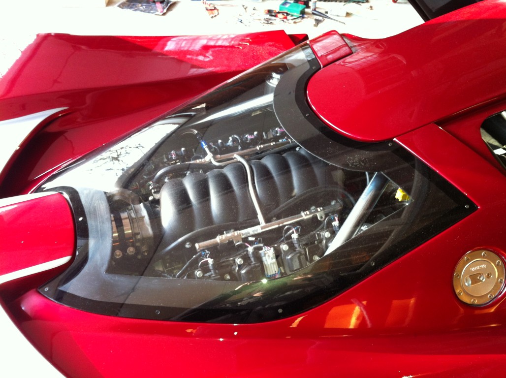

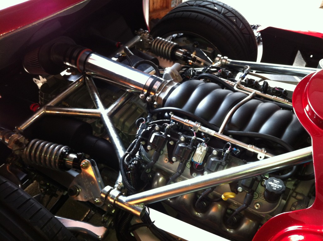

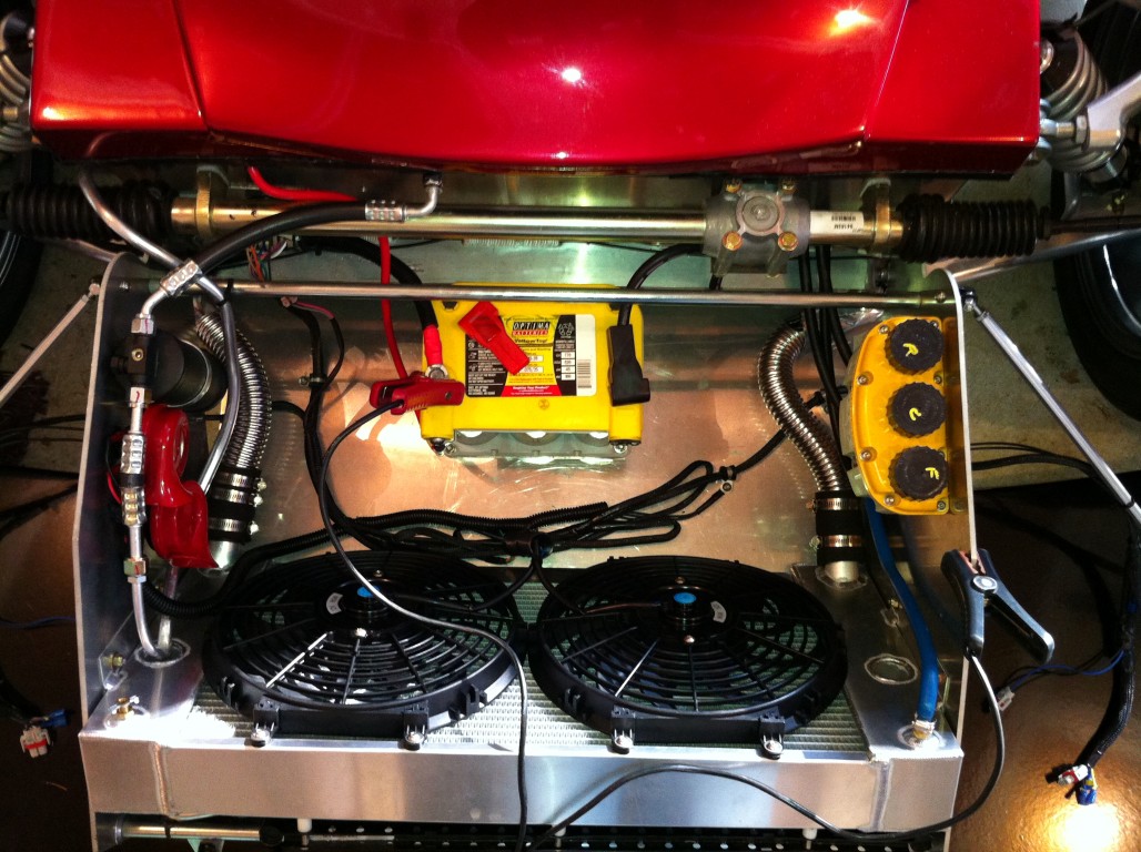

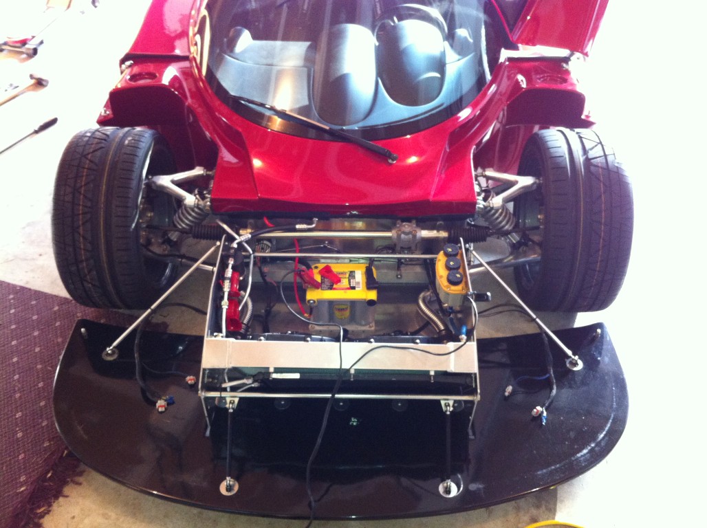

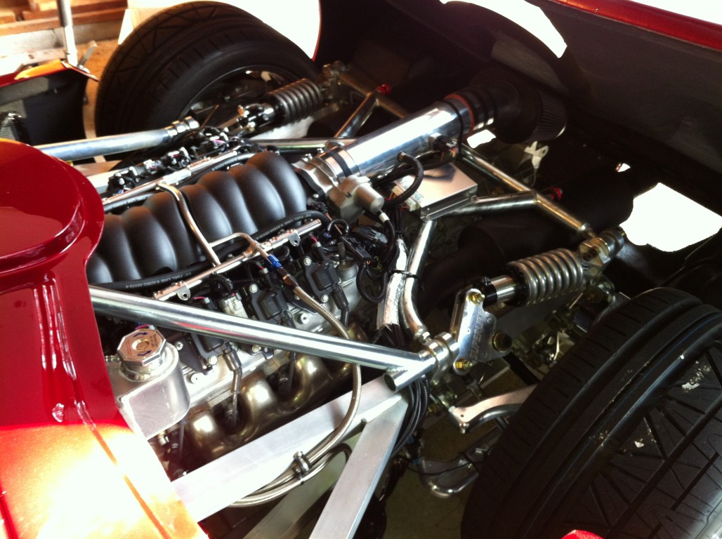

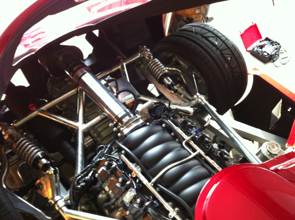

Figured to post some interior & engine bay pictures. This is a straight forward street build. The only thing I splurged on was a Racelogic traction control unit and moveable foot pedal mount.

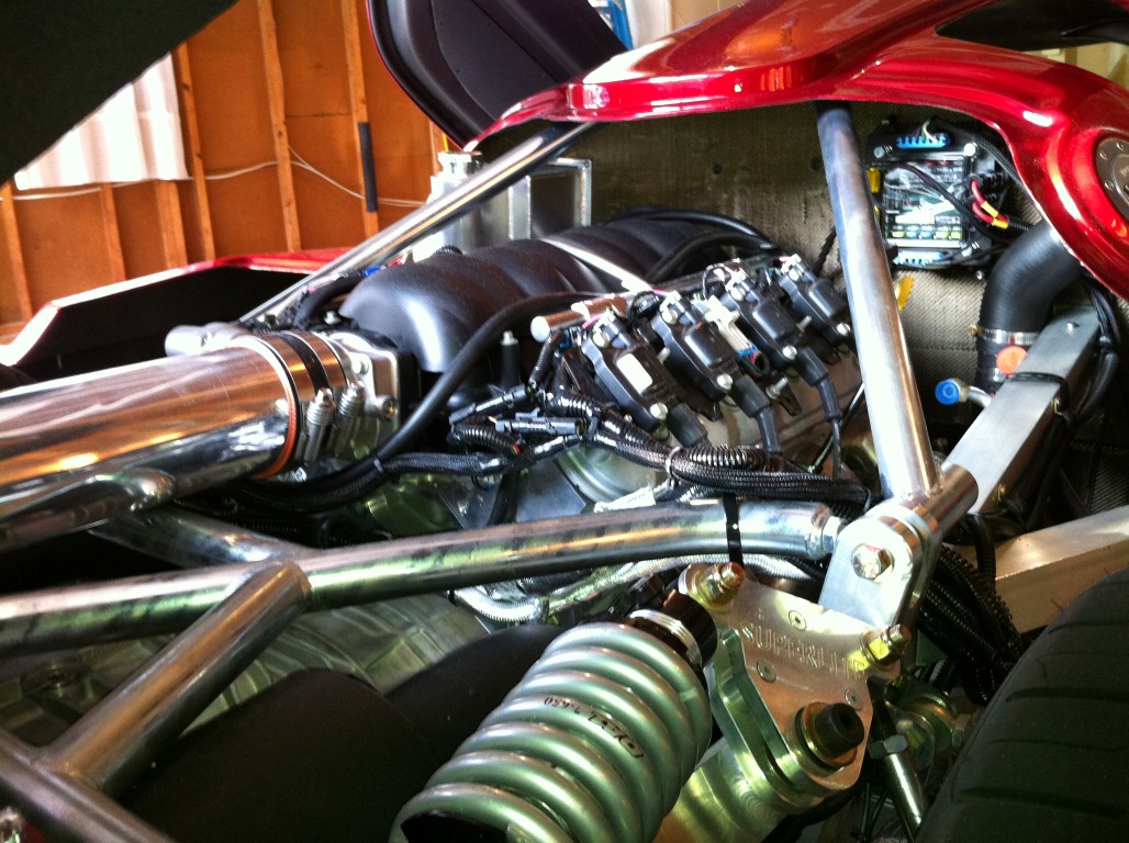

2nd batch

Pics look great Mike. Question, on the last pic of the 'first batch' you just uploaded it looks like the rear window has the black paint border and then a second border. Can you explain or provide more detail? I like the look!

Pictures look great Mike. I don't recommend using 3/8" fuel hose for the PCV system though. It tends to collapse under vacuum.
Ken - good eyeballs. I never thought hose collapse. I have a moroso PCV air/oil vapor separator left over from my other car, which I'm going to hook up to the SLC. It comes from moroso with regular rubber hose....hmmm. Do you know how much vacuum we're talking about. I'll check into it --- Thanks - Mike.

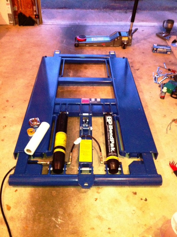

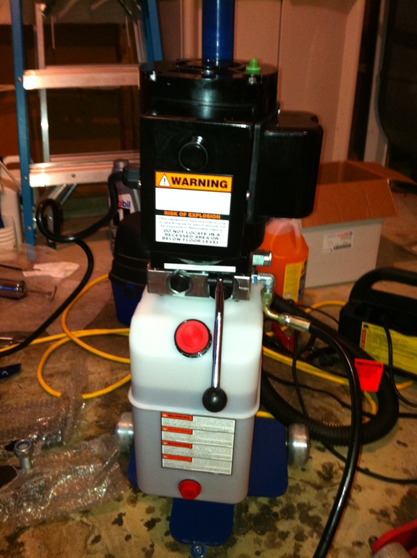

Got a new garage tool today. They weren't kidding about having it on it's own circuit with a 25 amp breaker. Turned on for a milli-second and poof.... darkness. Oh well -- something else to do.

Dave Lindemann
Mike - Nice looking lift! If that unit is the only load on the circuit you'll need a 31.25 amp breaker if it's a 25 amp load - or a 25 amp breaker if that's what is specified. Then there's the wiring....do you have a good electrician? Sometimes these things are more complicated than anticipated......

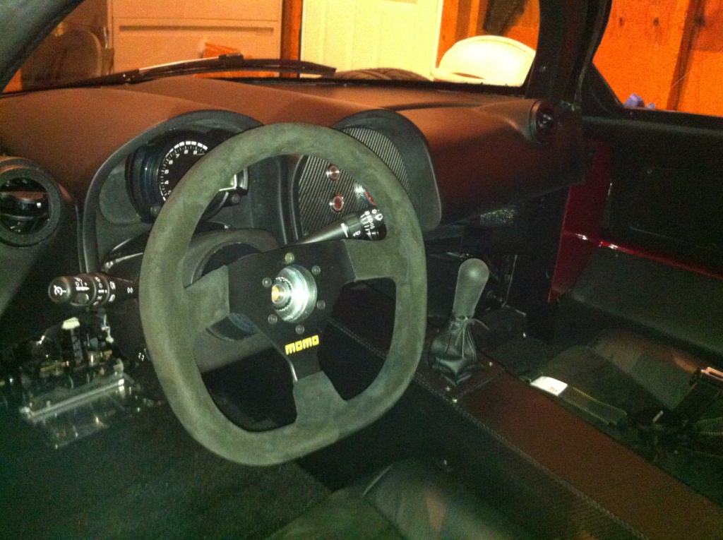

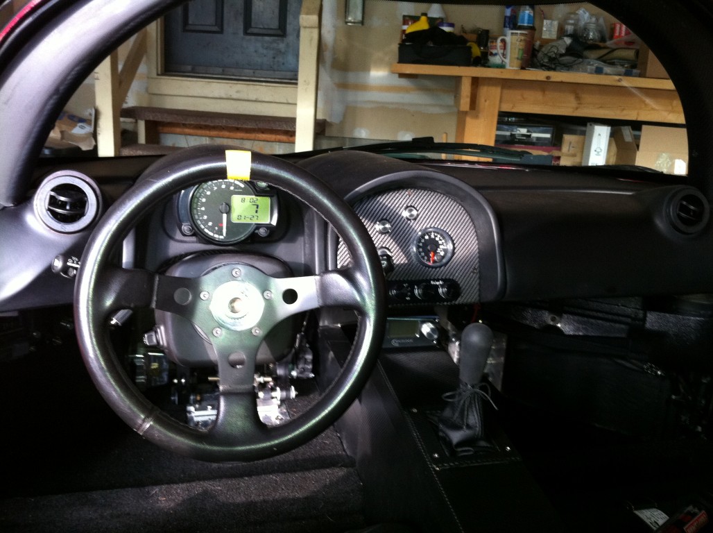

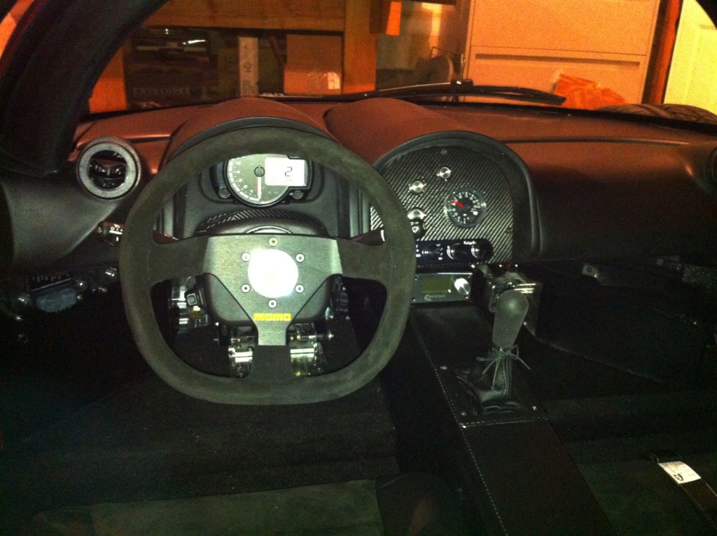

After reading Yos's thread on steering wheels - I had to look into it. I used the Grant 4009 momo to grant adapter and the wheel is the Momo R1988/32s Racing - MOD88.
This wheel feels right!

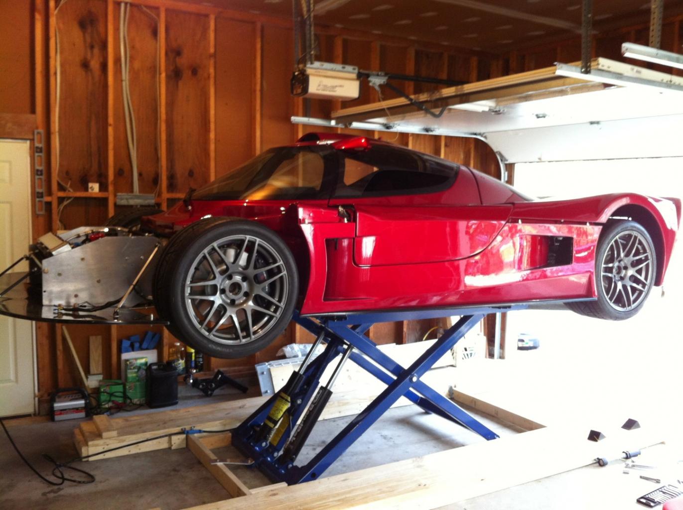

Put in a dedicated 30amp line in the garage -- lift works fine. I plan to park over the lift - so this weekend I'll build wood ramps to park and clear the lift. The ramps only need to be about 5.5 to 6" high. The lowest point of the vehicle is the dropped floors under the seat area -- not much clearance under these cars.
You'll need pretty long ramps. about 9.5 degrees is all you can hope for
unless you have the front lift kit.
You got that right. I have 5.5' alum. ramps that will be detachable/pinned. The base/platforms I'll make this weekend. I do not have the front lift kit.
Thanks for the heads-up.

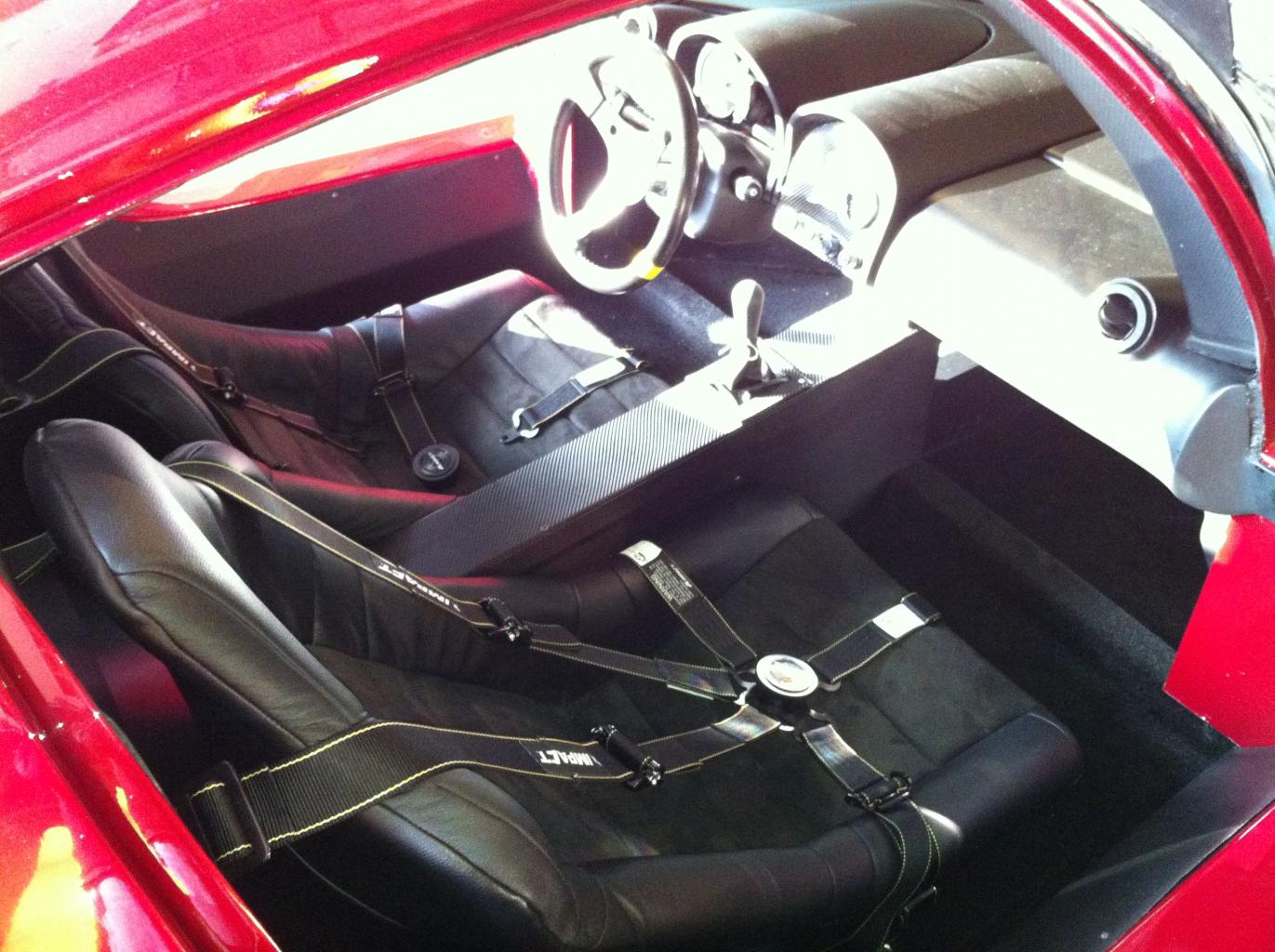

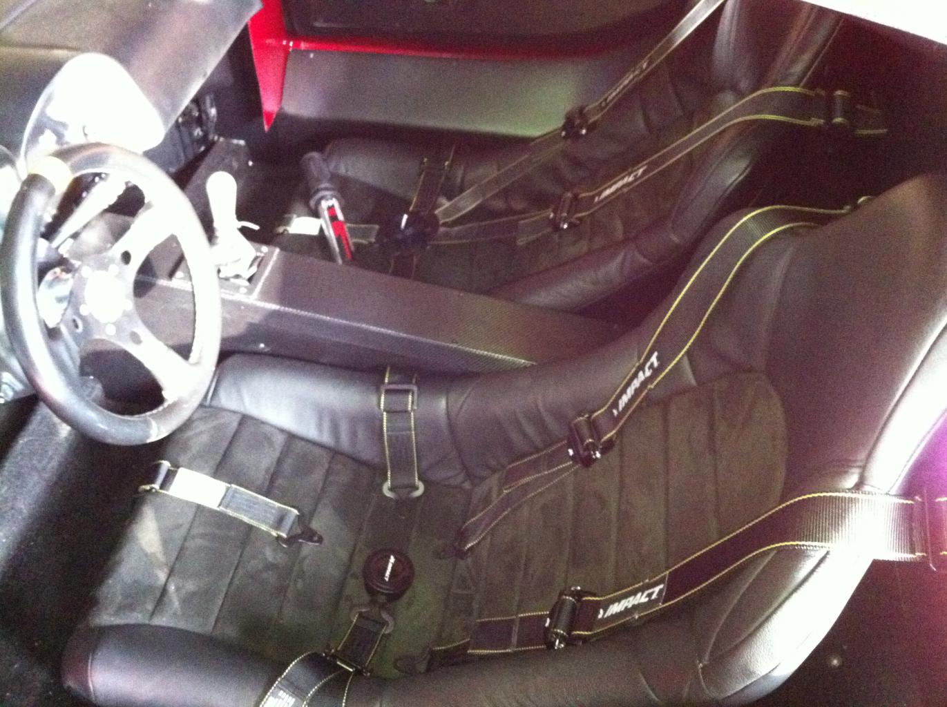

Hello Mike could you add some pictures of your seats and the make of them ?
The seats are factory five GTM II seats (the gen I seats may have some FFR badging IIRC-- the gen II seats do not). They really need harness cut outs though. I can get pics this weekend when I have decent lighting in the garage.
For Sale: multiple old floor jacks.... kidding. This thing is awesome--
