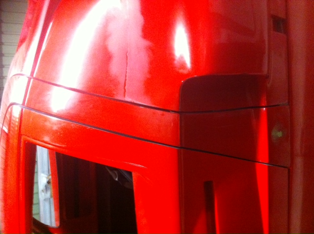

Not being someone who can just look at it and tell if it is a good and even surface like a pro-bodyman may, I have to use my hands, close my eyes and rub my hand over the body gently in the powdery dust "feeling" for high or low spots. Feeling for consistency in the contours. If the line is already cut between the panels, it upsets the movement of my hand and I lose track of the contour..
Maybe I'm nuts, but it's the best way I have found to do this.
Not at all! In fact, this method works better than using other senses until I do a wet sand where the sheen reflects the straight-tube florescent shop lights (per Fred'a note) to show deviations of thousandths of an inch. Finding a perfect material for an idiot stick or sanding block is as much the art as is feeling the surface. 3M make some really good foam pads that come in a variety of stiffnesses, as well as some interesting stiff-foam longer sanding blocks that I've seen up to 18" long for those very slight curves used on our cars.
Here is a wet-sanded surface after rinse-off. The water stayed on it long enough to push it into the garage and review the work under the florescent tubes. They were very telling. This first photo looked pretty good.
This second photo (the other side of the rear panel) showed the flaw I felt with my hand, but couldn't see. Notice how I sanded through a couple of different shades of primer, yet the hump (sharp bend in the reflection of some PVC tubing hung at the ceiling) in the center of the photo, was still there indicating I still had some work to do.

Thanks for the confirmation of my technique. Really good pictures you provided here that are quite telling!

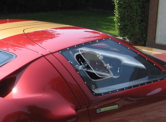

Roof-Ridge Update –
I was informed via email by a noted authority who viewed my build log that the originals did not have this ridge. I understand that the ridge was an agreed upon change with the first replica manufacturers.
After careful review of all my books as well as photos from the Racing Icons website, it has been confirmed. There are shadows and reflections that make it appear that there is a ridge in the spider that melds into the door at the top of the window, but they are optical illusions. I’m undecided at this point if I will blend the ridges in or not.
Here are some pictures of originals – with credit to Racing Icons

In regard to the body on my car - the ridge was for the most part non existent on the doors, the spider only faintly. The rear clip was pretty well defined.
I must say that the ridge is a nice addition, but I'm not going to spend the time it would take to get it as crisply defined as it is on the KVA pictured here

RF have this ridge aswell but I prefer the smooth look which is more original looking. That ridge makes it harder to align the panels.

In reference to the "ridge" the RCR40 does not have any of he GTD/CAV/KVA ridges.
Reason being we pulled the moulds from an unrestored original car.
The peak on the tail of the RCR is the same as the original Mk1s, in fact if you get a close look under the rear window you will see the small quarter sized indent of the drain hole, not visible on any other replica kit sold that I am aware of....showing indeed that the tail is pulled from an original car. You can also tell from the shape of the front wheel wells its an original shape , opposed to the much larger opening on some of the replica bodies.
