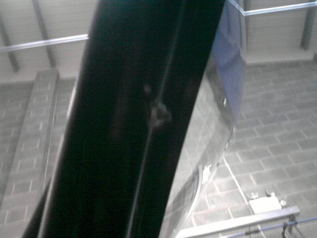

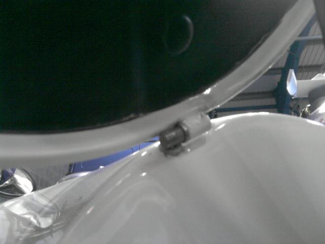

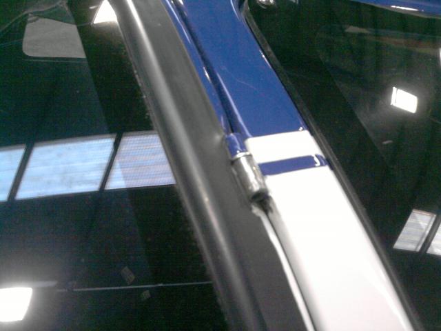

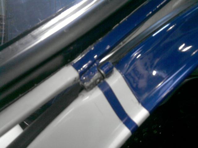

Hi Chris. Managed to get a couple of pics of hinges "in situ". They are a really basic hinge and just bolt through the door and center section framing. Hope they are of some help. Have been having a route around in the workshop as I'm sure we have a couple of sets somewhere to get a picture of unfitted. Anyway I'll keep looking. Oh, and where abouts are you in the UK?

Darren,
Those pictures show just how simple things can be with a race car.
I have a question for you.
Is the part of the hinge that is attached to the door bonded into the door between the inner and outer skins?
Also, what is the Diameter and length of the round portion of the hinge? They look about 7/16" or 1/2" and about 3/4" to 1" in length.

Hi Darren - brilliant, thanks! Next bit I need is detail of the striker plate and handle assembly etc - I have 1/2 the parts for that and Fran is sorting out the rest for me (he's a good bloke!). Pictures would be fantastic but maybe I could save you the hassle and arrange a 'photo shoot'?! My car is in Leicester but I split my time between Reading and Bristol (and Bristol is not a million miles from Devon!).
Mark, yes, I believe the hinge is bonded between the two skins - that's what I intend to do anyway.

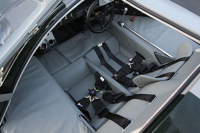

Sorry to drag up a really old thread but on one of the continuation cars I saw this picture of the Lola door hinge.
Does anyone know where Lola purchases these door hinges?
Mark

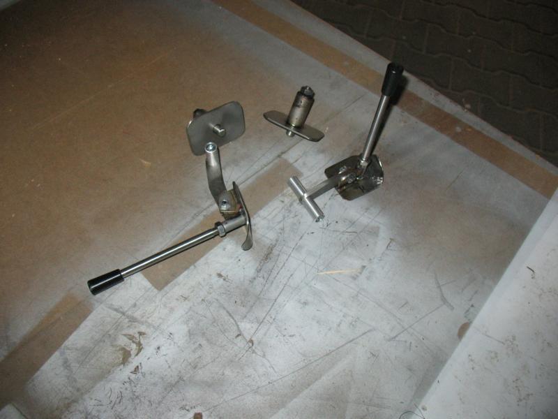

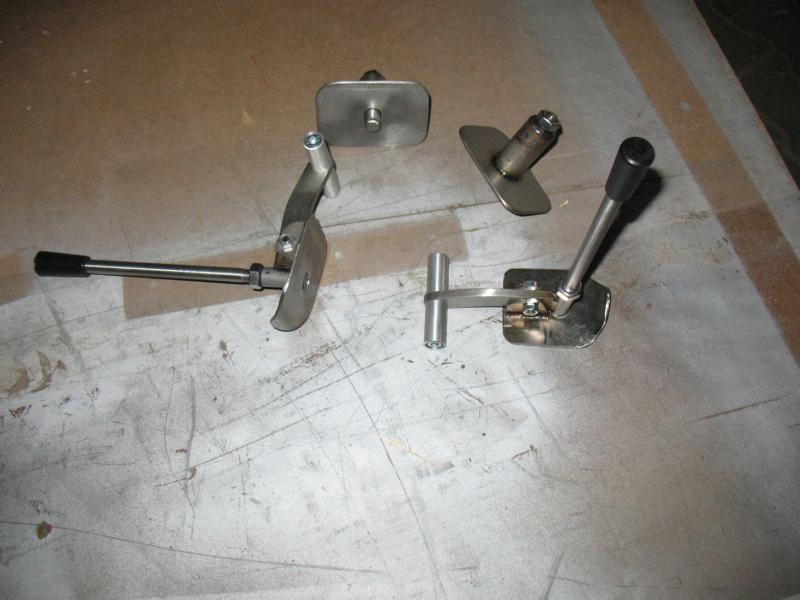

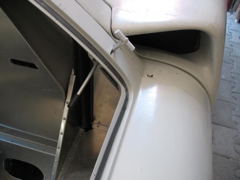

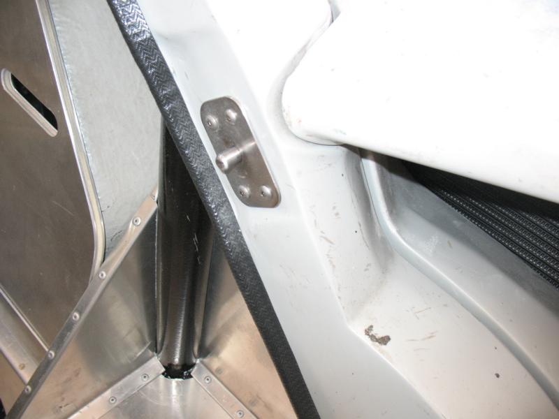

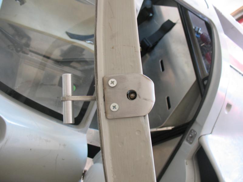

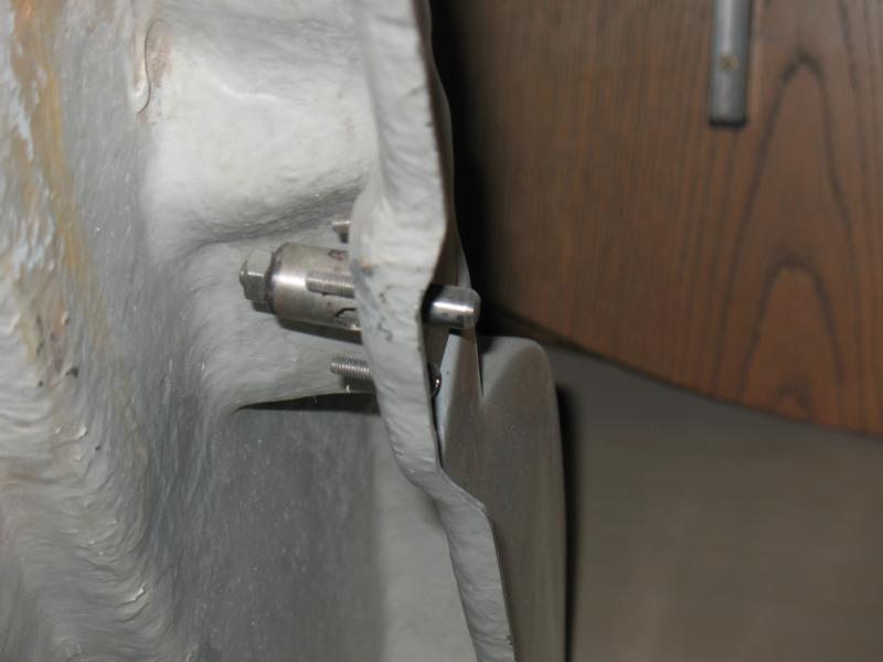

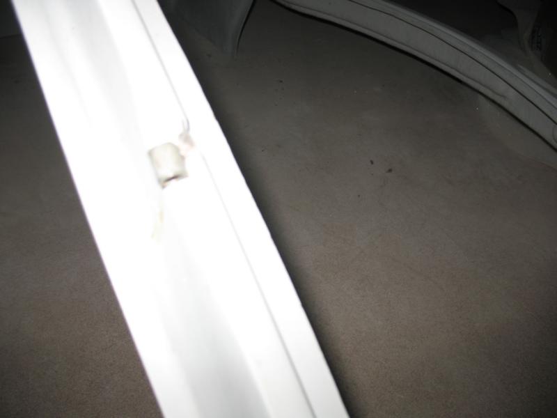

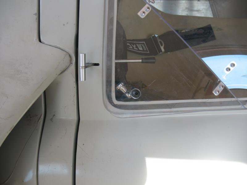

Hi cris, so sehen die türbänder und das türschloß bei meiner lola t70 mk3b aus. das türschloß habe ich selber gebaut.
gruß meinolf

noch mehr fotos
