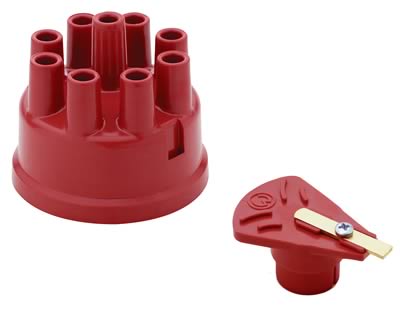

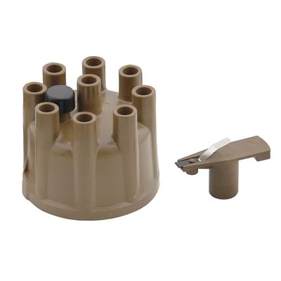

Inside the cap
Is there a center button (copper or carbon) or a carbon sprung contact? (If a sprung carbon contact is the carbon contact jammed?)
If it is a copper button (or carbon not on spring) then any variation in height between the center terminal and rotor needs to be taken up by adjustment of the rotor pick up See pics below (borrowed from Summit)
Now you may have an unsprung distributor cap contact and a rotor that expects the sprung carbon contact. In such instances there is no contact. And no spark
Basically mismatched parts
Try removing rotor and packing center hole with 1/4 inch of cardboard. (This will lift the rotor further from the crank and closer to the cap).
Refit cap
Test for spark using Paul's method (Don't crank engine)
If you get a spark to spark plug lead you have mismatched parts
Then you'll need to get parts matched
I'd not try running with cardboard packing except for a get you home job!

I have solid carbon node and the rotor has the spring steel contact which can be "bent" or adjusted upward if not making contact (similar to the tan cap you pictured). I have a new matched set. I'll check this though.
