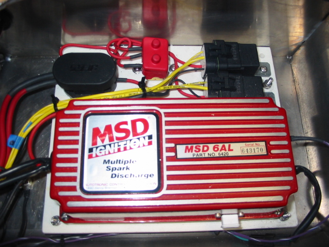

It is almost like there was not enough energy to fire the entire system, like the MSD box was running at half strength. I am puzzled and looking for ideas. Am I missing something??

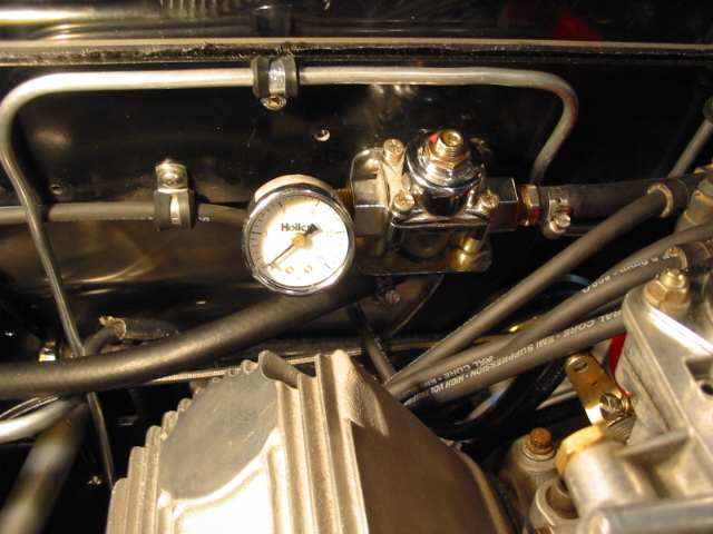

I wonder if the fuel pressure may be too low, and perhaps the pressure gauge is giving a false reading. But the blackened plugs don’t look like an over lean condition. Yet that seems like a plausible possibility. I am using a Holley regulator and pressure gauge.
<o:p></o:p>
I see no point in ‘fine tuning’ the carb adjustments until we sort out these issues. Adjusting the mixture screws does not seem to have much affect at this point.
Sorry for rambling on . . . .

With that said, I just read the fine print in the MSD 6AL instruction manual. It states that the magnetic pick up wires should be routed away from the other wires and located near a metal surface to shield it from stray signals. I bundled that pair of wires with everything else in a nice, tight package adjacent to the coil wires (carrying a few hundred volts) and the #8 chassis bus wire (carrying several amps). So . . . . . . . .
<o:p></o:p>
First plan is to reroute that pick up wire by itself to see if it was picking up a stray signal, hence the erratic firing.
<o:p></o:p>
Second, MSD makes a shielded harness for the magnetic pick up wires which I plan to install: perhaps over kill, but can’t hurt. (Part number 8862).
<o:p></o:p>
Third, I have ordered a new distributor cap. The old one looks fine, although it did have some nasty oxidation on the contacts which was easily cleaned away. I wanted a black cap anyway, so this is a good excuse to replace it.
<o:p></o:p>
Finally, checked the clearance between the magnetic pickup inside the distributor – supposed to be .030. It looked fine.
<o:p></o:p>
I am still a bit suspicious about the MSD 6AL box, but will defer that expense until the less costly options have been ruled out. Has any one had one go bad? What sort of strange things do they do before they completely quit??
