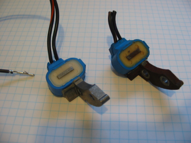

Recived the replacement MSD Magnetic Pickup from Jegs today. Replacing it was straightfoward. But the directions said nothing about the gap. I gapped it at .025 (other posts had suggested between .025 and .030) using a brass feeler gauge (thanks Randy). Works just fine. It still seems odd to me that it would suddenly fail after only two years and 5500 miles. A pic of the old and the new side by side is attached.
While we were at it the distributor cap and rotor were also replaced.
Time to get out and DRIVE!!!!
